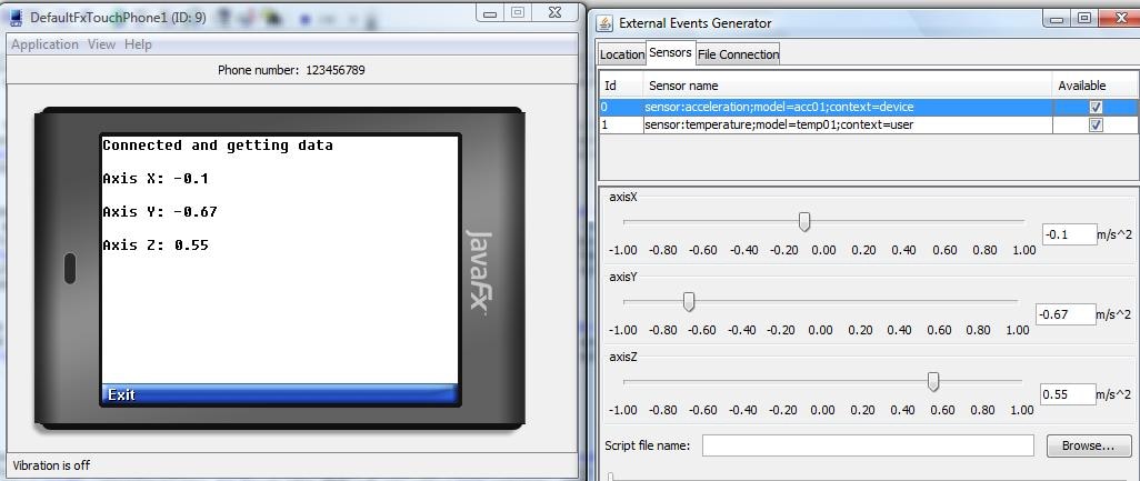

Using the information that we have so far, it is easy to create a simple MIDlet that echoes the current tilt of the device. The following code snippet shows the TiltCanvas class that captures and shows this information.

As you can see, the tilt canvas needs to look for the tilt sensor using the keyword acceleration for the quantity and SensorInfo.CONTEXT_TYPE_DEVICE for the context type. This is the only combination that works for the Java ME SDK 3.0, and you will need to find the correct values to use using the previous SensorFinder MIDlet if you run this code on other devices or emulation platforms. The canvas implements the dataReceived method to capture the data events sent by the acceleration sensor attached to the emulator. Since we know which channel is for what axis (we can find this out by trial and error, as I did, or from the documentation that comes with the emulator), we can assign the channel data to the correct axis. In this case, data[0] is axis X, data[1] is axis Y, and data[2] is axis Z.
Figure 1 shows this MIDlet running in the emulator.
Figure 1: MIDlet Captures External Sensor Event to Provide Device's Current Tilt
