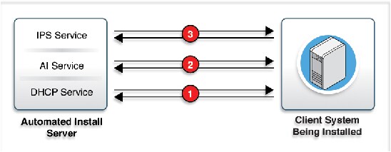

There are three significant steps involved in the AI installation process:
Each of the steps above can be accomplished by using various services that reside on the same physical or virtual system or they by services that reside on separate systems. In this article, the following services will reside on the same system, as shown in Figure 1:
Note: In environments where DHCP is not permitted, there are alternative methods for getting the network identity to the system manually, such as the use of network configuration arguments through the boot PROM on SPARC systems.
In this article, we will take an existing Oracle Solaris 10 system being used as JumpStart server and use it to host an AI environment for the purpose of installing Oracle Solaris 11 on a remote install client.
Figure 1. Client system installed by the automated install server.
Our first system, depicted on the left in Figure 1, will be used to install the installation environment where we run our JumpStart server and the AI, IPS, and DHCP services.
The second system, shown on the right in Figure 1, will be created and installed for the purpose of demonstrating automated installation. For our examples, the AI server will have an IP address of 192.0.2.1, and our install client will have an IP address of 192.0.2.2. Our DHCP server resides on the AI server, so it will have an IP address of 192.0.2.1.
