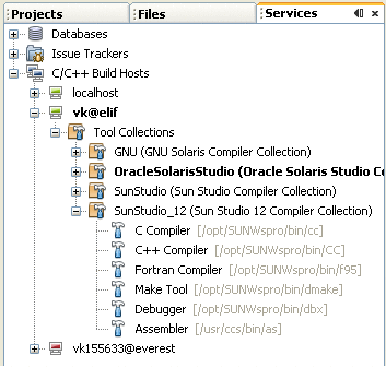

sshd.You can manage your remote hosts in the Services window of the IDE.
Figure 1. Services Window

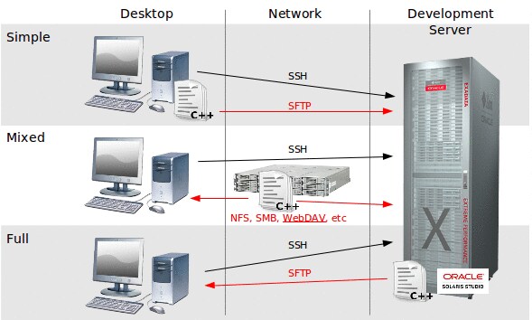

The IDE offers three modes of remote development: simple, mixed (also called shared), and full. The main difference between the modes is where the source files reside. Figure 2 shows where the source files reside and how the IDE accesses them in each mode.
Figure 2. Location of Source Files
In simple mode, the source files reside primarily on your local host. When you build your project, the source files are delivered on demand to the remote host using SSH File Transfer Protocol (SFTP).
In mixed or shared mode, the source files reside in a location that is shared between the local host and remote host using NFS, Samba, WebDAV, or another file sharing system.
In full remote mode, the source files reside on the remote host. The IDE accesses the files using SFTP.

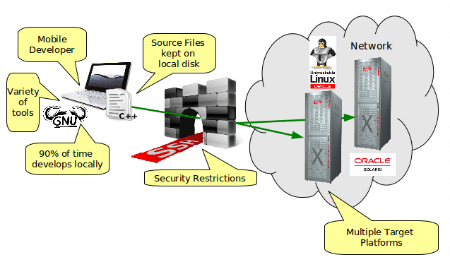

Simple mode might be the best remote mode for your needs if Figure 3 describes your development environment.
Figure 3. Good Environment for Simple Mode
In this environment, simple mode provides these benefits:

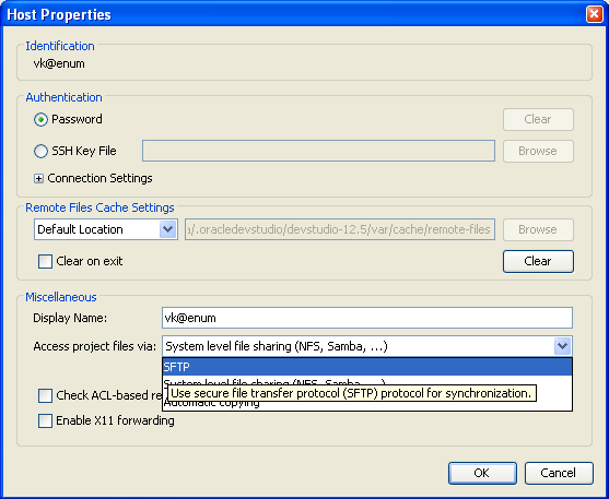

You can select simple mode or mixed mode for your remote host in the IDE using the Host Properties dialog box.

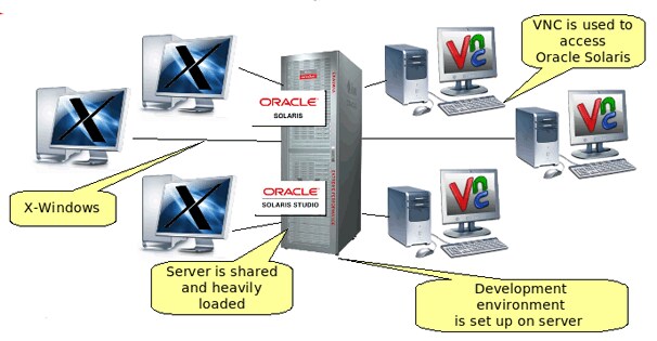

If you are doing remote development by running the IDE on a remote system using X-Window forwarding or VNC, you can achieve better IDE performance and response time using the desktop distribution of the IDE. You can run the desktop distribution on desktop systems with Microsoft Windows, Mac OS X, and Linux.
When you create the desktop distribution from your IDE, the desktop distribution is configured to work with the remote host to which you are connected, and it includes your user profile data (IDE settings and open projects).
You can create the desktop distribution while you are running the IDE or with the solstudio command you use to start the IDE.
solstudio command, use the --generate-desktop-distr option.When you unzip the desktop distribution zip file on your desktop system, you will be able to run the IDE locally without using X-Window forwarding or VNC, and you can compile, run, debug, and profile your code on a remote host.
