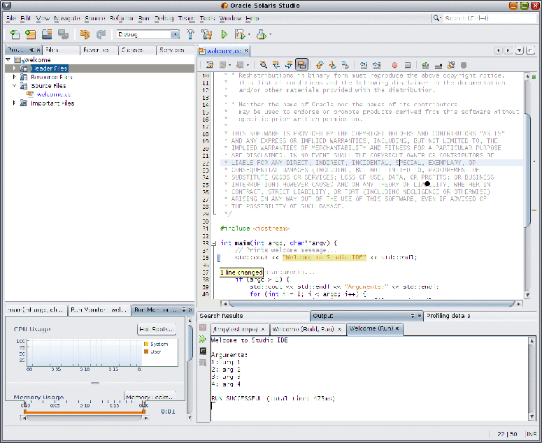

  11. Open the file welcome.cc in the Source Files folder and change the text on line 35 from "Welcome..." to "Welcome to Studio IDE."
  12. Save your changes and notice that the welcome.cc file is now shown in blue in the Projects window because it is a modified file under version control.
    Figure 3
    Figure 3. Modified File Under Version Control in IDE
  13. Build and run the project and you should see the new output.
    Figure 4
    Figure 4. New Build Output After the Program Was Edited
