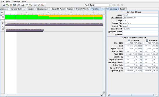

% cc -g -O -xopenmp -xvpara -xloopinfo mandle.c "mandle.c", line 13: not parallelized, call may be unsafe "mandle.c", line 25: not parallelized, loop has multiple exits "mandle.c", line 41: PARALLELIZED, user pragma used "mandle.c", line 43: not parallelized, loop inside OpenMP region
The resulting code is then run with the environment variable OMP_NUM_THREADS set to equal 2.
% export OMP_NUM_THREADS=2 % timex ./a.out real 8.72 user 11.92 sys 0.08
In this case, it is important to note that the user time is the same (11.92 seconds), because the same amount of work is performed. However, the real (or wall-clock) time is reduced, because there are now two threads performing the work. Unfortunately, the performance doesn't double, because the work is unbalanced between the two threads. One thread finishes first, so the performance improvement is limited by the slower thread. This behavior can be checked by collecting a profile using the Performance Analyzer and looking at the timeline view, as shown in Figure 1. (For more information on using the Performance Analyzer, see How to Analyze and Improve Application Performance.)
Figure 1. Viewing the timeline in the Performance Analyzer reveals that the thread work is not evenly split between the two threads.
The OpenMP directive schedule(guided) changes the scheduling used for the loop. Rather than statically dividing the work across the threads equally, this directive dynamically divides the work at runtime so that each thread takes about the same amount of time. Once this minor source code change is made and the application has been recompiled, the runtime performance improves even further, dropping from a high of over 33 seconds to less than 7 seconds.
