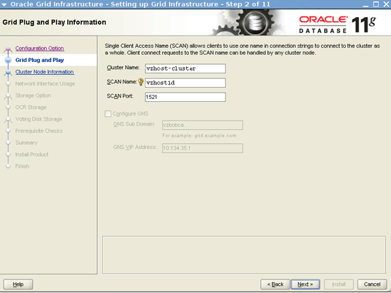

vzhost1d, IP address 10.134.35.99, is used for SCAN IP.vzhost1e, IP address 10.134.35.100, is used as VIP for vzhost1c.vzhost2e, IP address 10.134.35.101, is used as VIP for vzhost2c.vzhost3e, IP address 10.134.35.102, is used as VIP for vzhost3c.vzhost4e, IP address 10.134.35.103, is used as VIP for vzhost4c./etc/hostname.e1000g0 and /etc/hostname.e1000g1 settings for an IPMP group called SC_ipmp0 from the global zone:cat /etc/hostname.e1000g0 phyhost1 netmask + broadcast + group sc_ipmp0 up cat /etc/hostname.e1000g1 group sc_ipmp0 standby up

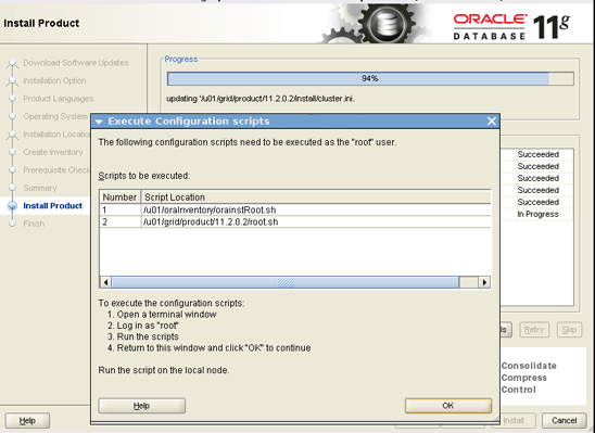

oinstall.The Execute Configuration Scripts dialog box asks you to execute the /u01/oraInventory/orainstRoot.sh and /u01/grid/product/11.2.0.2/root.sh scripts as root, as shown in Figure 2.
Figure 2. Execute Configuration Scripts Dialog Box
# /u01/oraInventory/orainstRoot.sh

Figure 3. Grid Plug and Play Information Page
Hostname Virtual IP Name vzhost1c vzhost1e vzhost2c vzhost2e vzhost3c vzhost3e vzhost4c vzhost4e

The Execute Configuration Scripts dialog box asks you to execute the GRID_Home/root.sh script on each node as root, as shown in Figure 10.
Figure 10. Execute Configuration Scripts Dialog Box
# /u01/grid/product/11.2.0.2/root.sh

Adding daemon to inittab
ACFS-9459: ADVM/ACFS is not supported on this OS version: 'Solaris Container: Solaris 10 update 9'
ACFS-9201: Not Supported

Configure Oracle Grid Infrastructure for a Cluster ... succeeded
Listing 13. Executing the Scriptroot.sh from the remaining nodes, as shown in Listing 14.
Listing 14. Running root.shroot.sh script has been completed on the last node, proceed to the next step of the Oracle Universal Installer.Note: There will be an error: [INS-20802] Oracle Verification Utility failed. You can ignore this error by selecting OK, selecting Skip, selecting Next, and selecting Yes to the continue in spite of the [INS-32091] warning messages, as shown in Figure 11 through Figure 14.

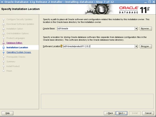

$ export DISPLAY=<hostname>:<n> $ cd 10098816_112020_SOLARIS64/database $ ./runInstaller
Figure 15. Specify Installation Location Page
Figure 16. Privileged Operating System Groups Page

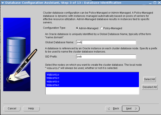

$ u01/oracle/product/11.2.0.2/bin/dbca
Figure 19. Database Identification Page

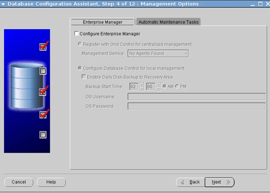

Figure 20. Enterprise Manager Tab
Figure 21. Automatic Maintenance Tasks Tab
