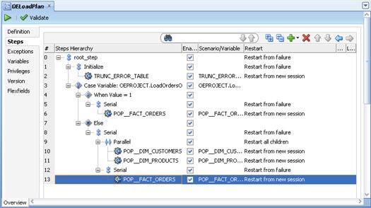

    Then click back on Serial step under the Else step, click the add step (+) button to add a new Serial step under it, and then drop the Pop.Fact_Orders interface onto it. Once complete, your load plan should look like the one in Figure 2.
Figure 2: The initial load plan

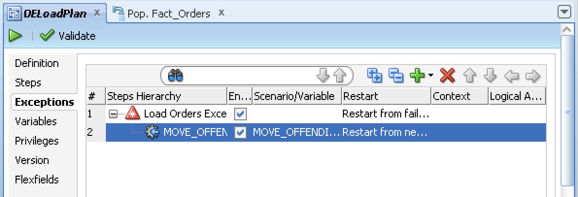

  1. With the load plan open in the Designer navigator, click the Exceptions tab, click the add step (+) button, and select Exception Step from the menu.
  2. Double-click the new Exception step to rename it, and call it Load Order Exception. To add the Oracle Data Integrator procedure that moves the rows to the error table, drag and drop the Move Offending Items procedure from the Projects pane onto the new Load Order Exception step, so that it is added as a scenario to the load plan, as shown in Figure 4.
    Figure 4: Defining the Exception step
  3. Now locate the steps in your load plan that run the scenarios that load the FACT_ORDERS table—in Figure 2, these are steps 6 and 13—and change their restart type in the Property Inspector from Restart from New Session to Restart from Failed Step.
  4. Navigate in turn to each of these step’s parent steps—in Figure 2, these are steps 5 and 12—and in the Property Inspector, change the Exception step value to Load Order Exception, the exception you defined in the previous step.
    Choosing these settings ensures that in the event of an error, the Move Offending Items procedure will run to remove the erroneous rows and the load plan can be restarted at this point, skipping all the previous steps.

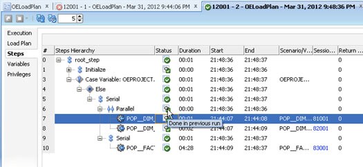

Now save the load plan and run it again. In the details of the load plan run in the Operator navigator, you will see that it has again failed. Run your new Exception step to clear out the erroneous rows, and click the Restart button at the top left corner of the load plan run. Your load plan will now restart and complete successfully, but more importantly, the plan will rerun only the step that failed (and subsequent steps, if there were any) rather than all the steps in the load plan, as shown in Figure 5.
Figure 5: The restarted load plan, rerunning only the failed step
