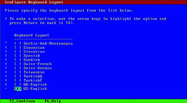

After a few seconds, you are presented with the keyboard layout configuration in case you don't have a standard keyboard or if you have a localized keyboard. If you have a US keyboard, press the [F2] key; if not, select the right language using the arrow keys to move up or down, make your selection with the [space bar] and then press [F2] to continue.

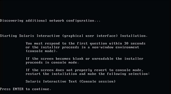

Immediately, you'll see the following message. Press ENTER to continue.

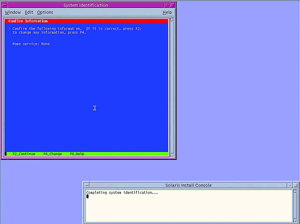

  11. The Name Service window appears. Select NONE using the arrow keys and pressing the space bar to select, then press [F2] to continue.
  12. For confirmation of your selection, press [F2] and continue to the next screen.

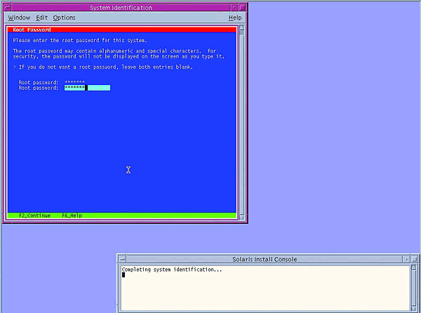

  20. The Root Password window appears. Set the root password. Note the password typed remains invisible. Re-enter the password in the second box and press [F2] to continue.

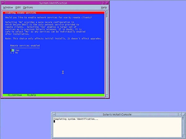

  22. The Remote Services window appears. In this window, you can choose a "Secure by default" Solaris installation, but afterwards individual services should be enabled. If you are unsure of your type of installation, follow the default "Yes" to enable all remote services and press [F2] to continue.

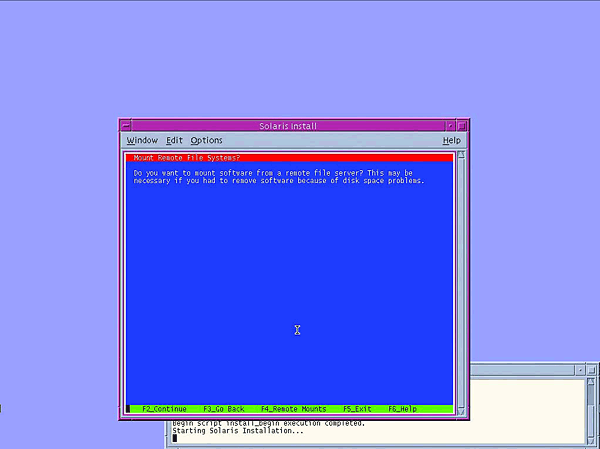

  35. The Remote Mounts window appears. Use the default and press [F2] to continue.
