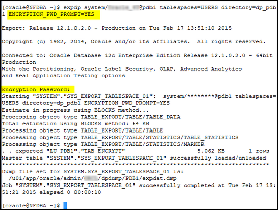

You want to perform the operation with Data Pump export in TTS mode. To perform the TTS export, you need to set the tablespace in READ ONLY mode.
Export the
USERStablespace of the PDB1 on-premises 12c PDB in TTS mode.
Remark: Passwords are blurred due to security rules. -
Note: Observe that the operation fails because the tablespace has encrypted columns and this operation type is not supported.
- Export the
USERStablespace of thePDB1on-premises 12c PDB in conventional mode.
Remark: File location is blurred and refer toORCLsubdirectory.
Note: Observe that the operation succeeded because the tablespace is exported with the conventional mode.
Be aware of the warning message telling you that encrypted data has been stored unencrypted in the dump file set. While the export takes place in a conventional mode, encrypted data is selected and read and therefore unencrypted.
You can use Data Pump export parameters to ensure that the data is reencrypted in the dump file. -
