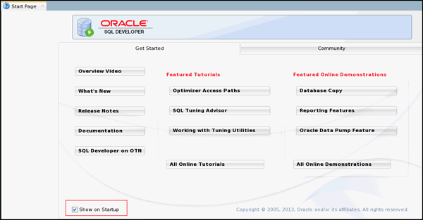

  1. Double-click the SQL Developer icon from the Desktop.
  2. The first time SQL Developer is open, the "Start Page" is displayed.  You can deselect the Show on Startup checkbox to turn it off.

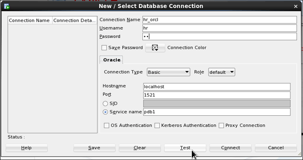

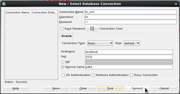

  3. In the Connections tab, right-click Connections and select New Connection.
  4. A New / Update Database Connection dialog opens. Enter the connection details as follows and click Test.
    Connection Name: hr_orcl
    User Name: hr
    Password: <your password> (Select the Save Password checkbox)
    SID: <your own SID>
    Note: In this tutorial the Service Name is specified instead of SID.
  5. The status of your test is 'Success'. Click Connect in the New/ Update Database Connection dialog to create the connection.

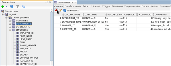

  1. Expand the EMPLOYEES table. Notice that the column definitions are listed.
    If you performed the previous tutorial on Oracle SQL Developer Data Modeler, note that the COST_CENTER column you added to the DEPARTMENTS table in the relational model does not currently exist. Also the PROJECTS and TASKS tables do not exist in the schema currently. In the next topic, you run the script to modify the hr schema.
  2. Click the DEPARTMENTS table in the navigator.
  3. Notice that the information in the EMPLOYEES tab was replaced by the DEPARTMENTS table information. If you want the table information in the tab to remain frozen, select the Pin icon to Freeze the pane.
  4. Then click the EMPLOYEES table again in the navigator.
  5. Notice this time you have 2 tabs, one for each of the tables because the DEPARTMENTS table pane is frozen.

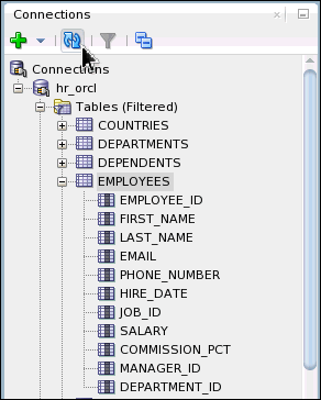

  7. Click the Refresh icon to refresh the list of tables.
  8. Notice that the new tables PROJECTS and TASKS are contained in the list. Expand the DEPARTMENTS, PROJECTS and TASKS table nodes and review the results. In the next topic, you create a procedure and run it.

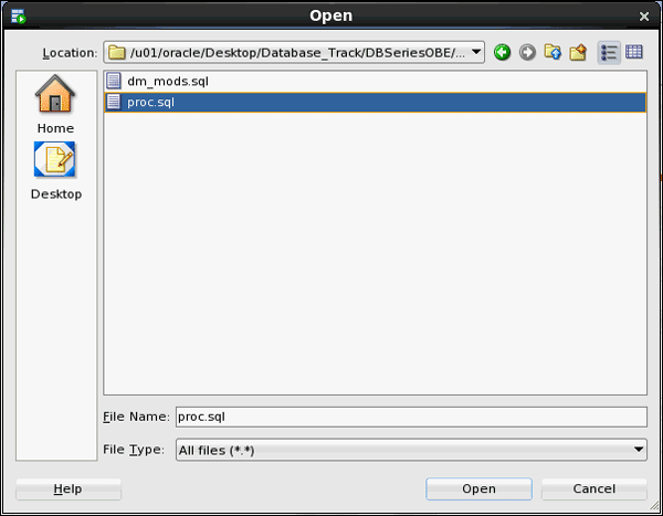

  1. A script with the procedure has already been created so you want to open the file. Select File > Open.
  2. Locate the proc.sql  and click Open.
  3. Click the Run Script icon to create the AWARD_BONUS procedure.

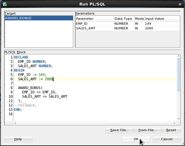

  11. The Run PL/SQL dialog window appears. Notice that the values for EMP_ID and SALES_AMT are currently set to null.
  12. Change NULL to 149 for EMP_ID and 2000 for SALES_AMT and click OK.
  13. Note that the procedure ran successfully and the value for salary was changed. To see how debug works, you want to create a breakpoint. Click the line number 7.

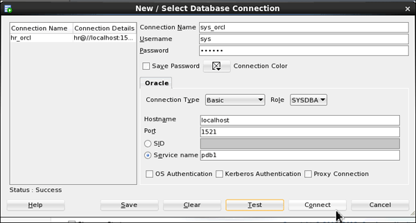

  1. Create a connection for the SYS User. Right-click Connections and select New Connection.
  2. Enter the following information and click Connect.
    Connection Name: sys_orcl
    Username: sys
    Password: oracle
    Select Save Password checkbox
    Role: SYSDBA
    Service Name: pdb1

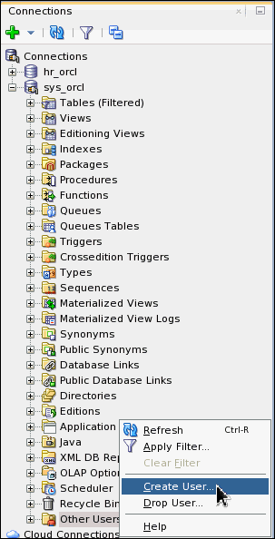

  3. Your connection was created successfully. Collapse the hr_orcl connection. Expand the sys_orcl connection and right-click Other Users and select Create User.
  4. Enter the following information and select the Granted Roles tab.

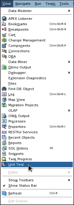

  1. Select View > Unit Test.

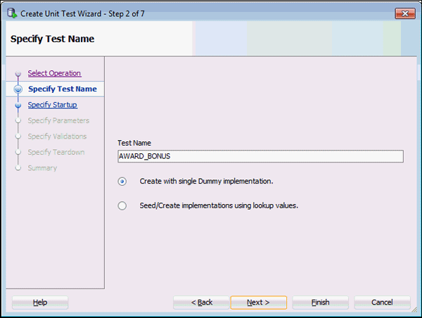

  5. In Specify Test Name window, make sure that AWARD_BONUS is specified for Test Name and that Create with single Dummy implementation is selected, then click Next.

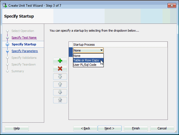

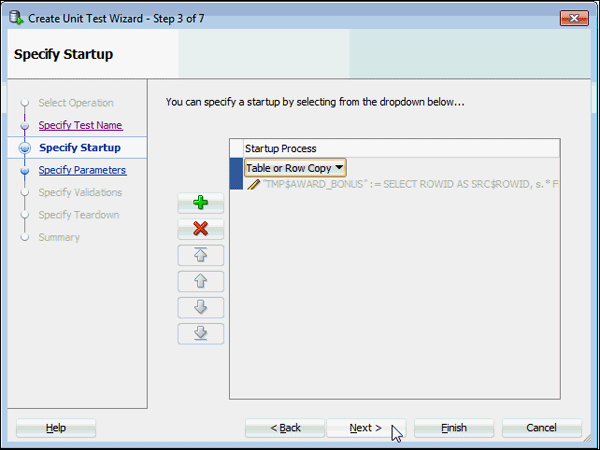

  6. In Specify Startup window, click '+' icon and select Table or Row Copy from the drop down list box.
  7. Enter EMPLOYEES for Source Table and click OK. Note that the table affected by the test will be saved to a temporary table and the query to the table is automatically generated.
  8. Click Next.

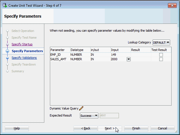

  9. In the Specify Parameters window, change the Input string for EMP_ID to 149 and SALES_AMT to 2000 and click Next.

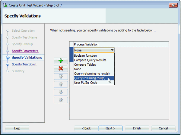

  10. Select the '+' icon to add a validation and select Query returning row(s) from the drop down list.
  11. Specify the following query and click OK. This query will test the results of the change that the unit test performed.
    SELECT * FROM employees
      WHERE employee_id = 149
    AND salary = 11700;

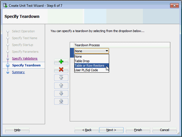

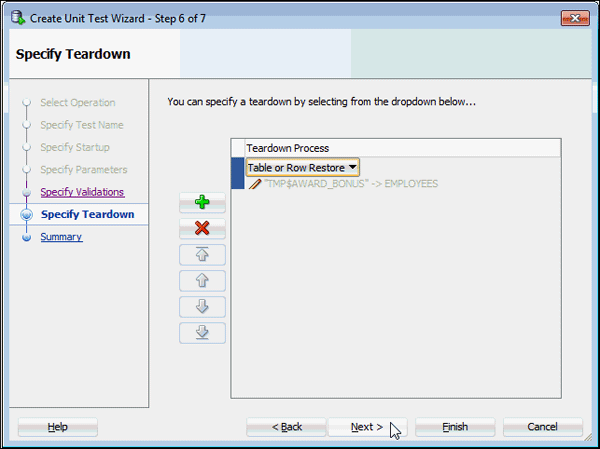

  13. In the Specify Teardown window,click the '+' icon and select Table or Row Restore from the drop down list.
  14. Leave the Row Identifier as Primary Key and click OK.
  15. Click Next.
