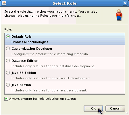

If the Select Role window appears, leave it selected as Default Role. and click OK. This enables all JDeveloper technologies.

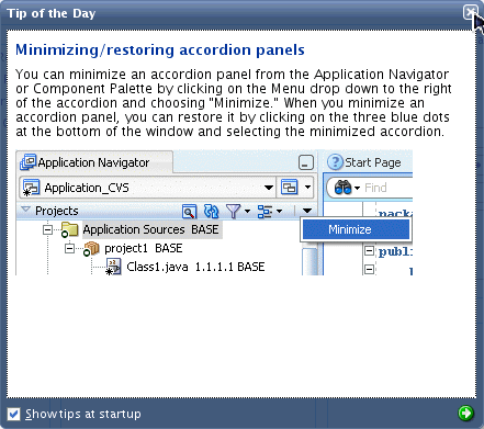

If the Tip of the Day window appears, close it. Optionally, you can uncheck the Show tips at startup checkbox to avoid this message again.

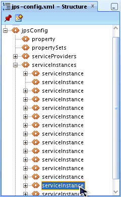

Hint: You can use the Structure view to easily find elements in the file. Expand the jpsConfig and serviceInstances nodes, and select the next to last serviceInstance which should be the correct element for the idstore.xml instance.
<serviceInstance provider="idstore.xml.provider" name="idstore.xml">
  <property value="./jazn-data.xml" name="location"/>
  <property value="OBFUSCATE" name="jps.xml.idstore.pwd.encoding"/>
  <property value="jazn.com" name="subscriber.name"/>
</serviceInstance>

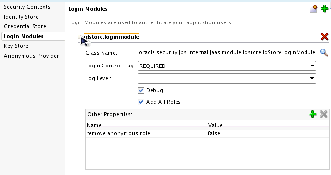

Click the Login Modules tab to display the configuration for login modules. Expand the plus sign next to the idstore.loginmodule entry to display the configuration for the idstore.loginmodule service instance.
The parameters in the screen shot are defined below:
Parameter Description
Class Name: Contains the fully-qualified class name that implements the LoginModule. In this case, it is an Oracle internally-defined LoginModule that works with ADF application development.
Login Control Flag: The control flag that indicates how this authentication provider behaves.
Log Level: A set of logging levels that determine how much logging information to output.
Debug: A boolean setting whether or not to allow debugging of the LoginModule code.
Add All Roles: Tells OPSS to add all roles associated with the user to the Subject.
Other Properties: Allows you to configure other properties to pass to the LoginModule.
remove.anonymous.role A property that is used to tell the LoginModule not to remove the anonymous-role from the user's Subject.

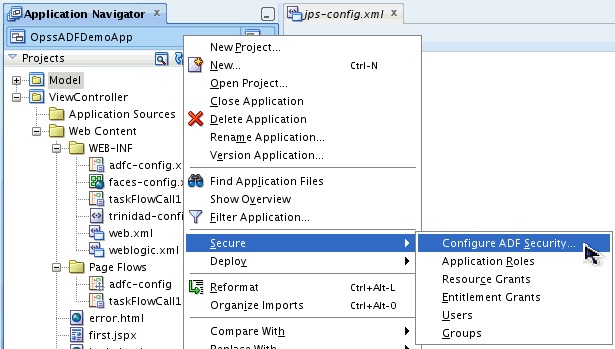

Configuring ADF to use OPSS Security

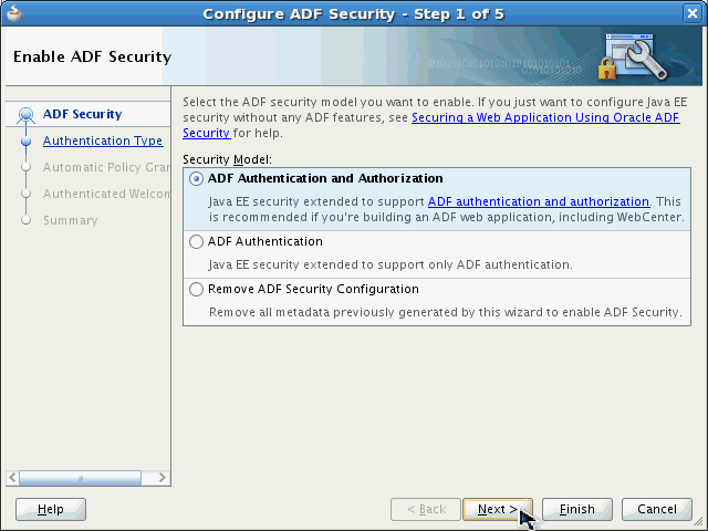

You can use the JDeveloper IDE to configure the type of security your ADF application uses. Right-click the application in the Application Navigator tab, then select Secure > Configure ADF Security.
NOTE: We are not actually changing the setting here, however we did want to show you how this configuration is done.

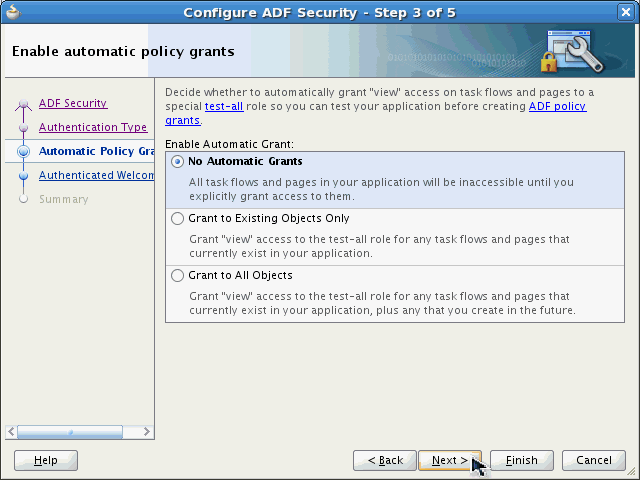

The Configure ADF Security wizard is displayed. The first screen alows you to choose the Security Model of the application. There are three choices:
  • ADF Authentication and Authorization
  • Remove ADF Security Configuration
For detailed explanations of each of these selections, click the ADF authentication and authorization link shown on the first wizard page. This opens up the related JDeveloper inline help system. Click Next when ready.

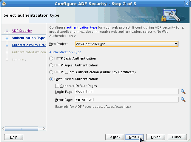

The next step in the wizard allows you to select the authentication type used by the web-based aspect of the application. For detailed explanations of each of these selections, click the authentication type link shown on this wizard page. This opens up the related JDeveloper inline help system on these settings. Click Next when ready.
The next step in the wizard allows you to elect how the application will manage policy grants. For detailed explanations of each of these selections, click the ADF policy grants link shown on this wizard page. This opens up the related JDeveloper inline help system on these settings. Click Next when ready.

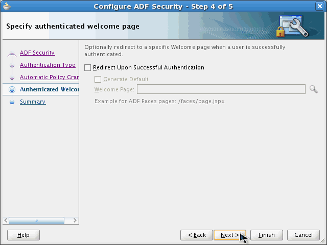

The next step in the wizard allows you to select the welcome page for a successfully authenticated user of this application. Leave everything as the default, with nothing configured, and click Next when ready.

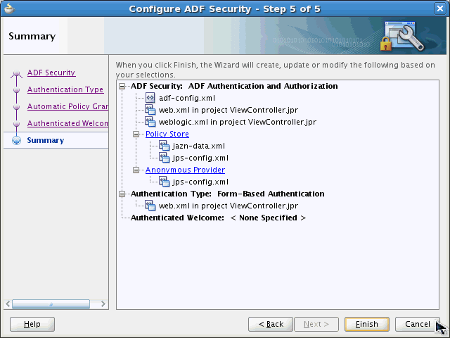

The wizard then displays a summary of the configuration selections made up to this point. This screen shows where the ADF, Java EE, WebLogic extensions, and OPSS configuration files are located and where they are packaged within the application. Because ADF security is already configured the way we want it to be, click Cancel to ignore these settings.

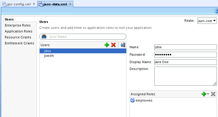

Users Configuration

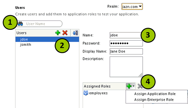

The Users tab displays the users configured for the ADF development environment that are defined as part of the jazn.com security realm. This page provides controls to do the following:
  1. Searching for a particular user
  2. Managing users in the identity store
  3. Managing the details of a user in the identity store
  4. Managing the mapping of users to enterprise roles (groups) and application roles
Take a few minutes and explore this page to become familiar with it. Move on to the next step when you are ready.

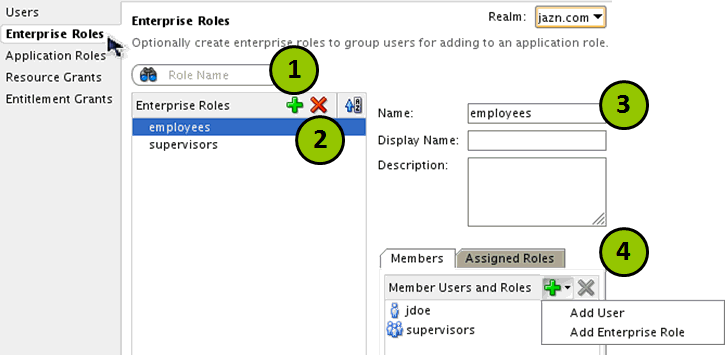

Enterprise Roles Configuration
Click the Enterprise Roles tab to display the configuration for the enterprise roles configured in the identity store. This page provides controls to do the following:
  1. Searching for a particular enterprise role by name
  2. Managing the enterprise roles in the identity store
  3. Managing the details of enterprise roles in the identity store
Take a few minutes and explore this page to become familiar with it, and answer the following questions:
  • Which users and groups are mapped to the employees enterprise role?
  • Are there any application roles assigned to the employees enterprise role? If so, what are they?
  • Which users and groups are mapped to the supervisors enterprise role?
  • Are there any application roles assigned to the supervisors enterprise role? If so, what are they?

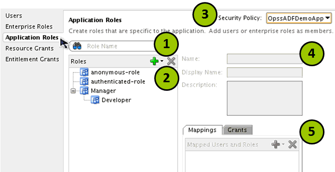

Application Roles Configuration
Click the Application Roles tab to display the configuration for the application roles configured in the OPSS security store. This page provides controls to do the following:
  1. Searching for a particular application role by name
  2. Managing the application roles in the OPSS security store
  3. Specifying which application configured application roles are scoped to
  4. Managing the details of application roles in the OPSS security store
  5. Managing the mapping of users to application roles, and viewing permission grants assigned to application roles
Note that in the screen shot below the Manager role has already been expanded to show that the Developer role is a child role. This is an example of an application role hierarchy. Policies created for the Manager role automatically apply to the Developer role as well.
  • Are there any users or roles mapped to the anonymous-role? Why or why not?
  • Are there any users or roles mapped to the authenticated-role? Why or why not?
  • What permission is granted to the authenticated-role?
  • Are there any users or roles mapped to the Manager application role? If so, what are they?
  • Are there any users or roles mapped to the Developer application role? If so, what are they?
  • Do the Manager or Developer roles have any permissions granted to them?

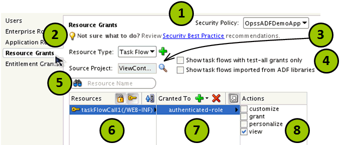

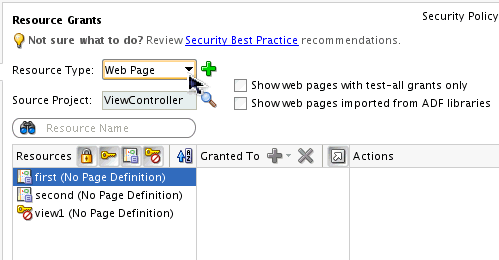

Resource Grants Configuration
Click the Resource Grants tab to display the configuration for the policies configured in the OPSS security store that grant access to application resources. This page provides controls to do the following:
  1. Specifying which application configured resource grants are scoped to
  2. Linking to the JDeveloper help system for Security Best Practices to consider when using this page
  3. Specifying the Resource Type and Source Project the grant applies to
  4. Specifying whether only task flows with test-all grants or task flows from imported ADF libraries should be displayed
  5. Searching for a particular resource by name
  6. Managing the resources in the OPSS security store
  7. Managing the grantees of the resource grant, such as application roles, users, enterprise roles, or code sources
  8. Managing the actions (or privileges) that will be granted as part of this policy
This is where the policy for granting view privileges to the taskFlowCall1 task flow for all users in the authenticated-role is defined. If the policy, or resource grant, is not visible, click the icon to show all the resources that have grants configured.
Take a few minutes and explore this page to become familiar with it, then continue with this step.
JDeveloper is aware that this is an ADF application, and the graphical view of the jazn-data.xml file has an ADF focus. The resource types available out-of-the-box are Task Flow and Web Page. When one of these resource types is selected, the view shows the available ADF application resources of that resource type so that you can configure security policies for them. Just as you are able to see the resource grant for the taskFlowCall1 resource, you can change the resource type to Web Page, which causes the web pages of the ADF application to be displayed, as shown in the screen shot below. What can also be seen is that none of the web pages in this application have any policies defined for them.
Select Web Page as the Resource Type and select each of the web page resources listed to see that there are no policy authorization grants.
The source project for this screen is currently set to ViewController. You could click the search icon next to Source Project to add the Model source project to the filter to cause all of its resources to display in the list. However, there is no source of any kind in the Model project so this would be a waste of time at the moment.
You can also create a resource type of your own by clicking the icon next to the Resource Type drop down list box. However, any resource instances created and derived using this new resource type will have to include an API call within the code to enforce any policies granted to the custom resource because they are unknown to ADF.

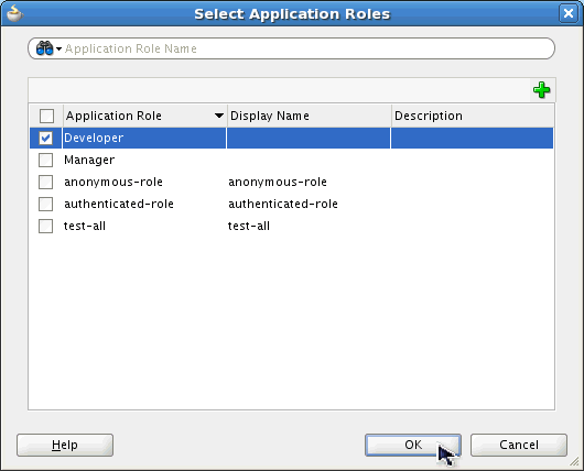

    Now, let's create a new resource grant:
  • Click the add icon in the Granted To pane, and select Add Application Role .
  • The Create Application Roles window appears.
  • Select Developer as the role.
  • Click OK to finish selecting roles for this grant.
  • Verify that the grant is created. You should now see that the Developer role is the grantee for this resource displayed in the Granted To pane. You should also see that the Actions pane is now populated with the actions you created for this resource type. Now you need to select which action, or actions, you want to grant to the Developer role.
  • Select all three actions to grant the Developer role access to all privileges for your new resource.
  • Now that you have created a new resource type, created a resource instance based on that type, and created a resource grant that allows the Developer role access to view, update, and delete privileges on this resource; you can view the source of the jazn-data.xml file to see what this configuration looks like.

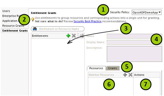

Click the Entitlement Grants tab to display the configuration for the policies configured in the OPSS security store that grant access to application resources. This page provides controls to do the following:
  1. Specifying which application configured entitlement grants are scoped to
  3. Specifying the entitlements that are configured within the policy store
  4. Display information for a selected enititlement
  5. Tabs for switching between the resources and grants included in this entitlement
  6. Managing the resources included in the entitlement. If the Grants tab was selected, then this would allow for managing the grantees of the entitlement grant, such as application roles, users, enterprise roles, or code sources
  7. Managing the actions (or privileges) that will be granted as part of this policy
This application currently does not use any entitlements. This page is here just to show you where to find the entitlements configuration tool. If desired, you can click the plus icon in the Entitlements section to try to create an entitlement of your own.
