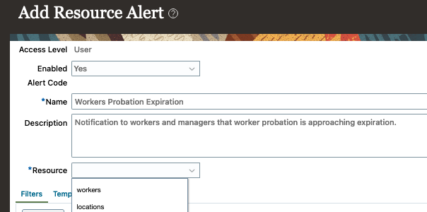

  5. Click on the down arrow next to Add.
  6. Click on Resource Alert.
  7. Validate the Access Level is User.
  8. Select Yes from the Enable drop-down.
  9. Enter 'Workers Probation Expiration' in the Name field.
  10. Enter 'Notification to workers and managers that worker probation is approaching expiration.' in the description field.
  11. Select 'workers' in the resource drop-down.

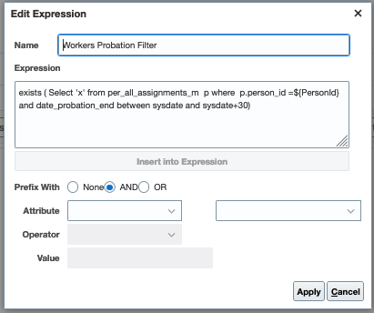

  7. In the Edit Expression window, type 'Workers Probation Filter' in the Name field.
  8. Copy this line in the Expression box:
  9. exists ( Select 'x' from per_all_assignments_m  p where  p.person_id =${PersonId} and date_probation_end between sysdate and sysdate+30)
  10. The screen should look like this:
  11. Click the Apply button.

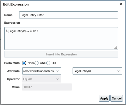

Optionally, you can add a second filter. You will need the legal entity ID you exported in the Make a Test REST Call section of this document.
  1. Go to the Filters tab to add a criterion for triggering the notification.
  2. Click on the Add Filter button.
  3. Select workers/workRelationships in the Resource drop-down.
  4. Under the Resource, select Match All to ensure the alert applies all the filters to trigger the notification.
  5. Click on Add Expression. A line item is added.
  6. Click on the Edit icon of the new line.
  7. In the Edit Expression window, type 'Legal Entity Filter' in the Name field.
  8. Select workers/workRelationships from the Attribute drop-down.
  9. Select LegalEntityId from the drop-down to the right.
  10. Select Equals from the Operator drop-down.
  11. In the Value field, enter the legal entity ID.
    1. You obtained it from the REST call.
  12. Click on Insert into Expression.
  13. Click on Apply.

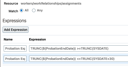

  14. Create two more filters on assignments resource to provide criteria for the probation expiration date.
  15. Review the filters.

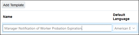

  1. Click on the Templates tab.
  2. Click on Add Template. A line item is added.
  3. Click on the name field and enter 'Manager Notification of Worker Probation Expiration'.
  4. Validate that American English is the Default Language.
  5. Validate that the Enable field is Yes.
  6. Click on the Edit drop-down and select 'Manage recipients and message'.

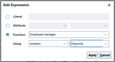

  9. Click on the XYZ button.
  10. Click on the Function radio button.
  11. In the Function drop-down, select 'Employee manager'.
  12. In the using drop-down, select 'workers'.
  13. In the next drop-down, select 'PersonId'.
  14. Click on apply.

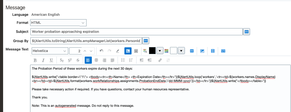

Edit the message for the first template.
  1. In the Message section, click on the subject field.
  2. Enter 'Worker probation approaching expiration'.
  3. Click on the Group by field.
    1. The Group By option will group the employee notifications in a single email for the manager. Do not use Group By if you want the manager to receive individual emails.
  4. Enter this string:
  5. ${AlertUtils.toString(AlertUtils.empManagerList(workers.PersonId).WorkEmail)}
  6. In the body of the message, insert this message:
    1. Alerts Composer's Templates support Groovy expressions to substitute variables and add conditions based on the values provided at runtime.
    2. For more information on Groovy expressions, please refer to the Groovy documentation.
  7. The screen should look like this.
  8. Click on Apply.

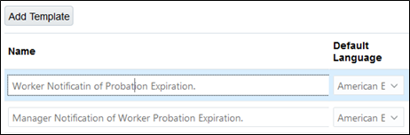

Creating the second Template.
  3. Click on the name field and enter 'Worker Notification of Probation Expiration'.

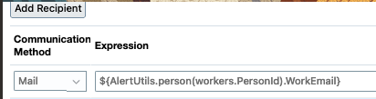

  7. Click on Add Recipient.
  8. Validate the Communication Method is Mail.

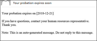

  9. Enter '${AlertUtils.person(workers.PersonId).WorkEmail}' in the expression.
Edit the message for the second template.
  2. Enter 'Your probation expires soon'.
  3. In the body of the message, insert this message:
  4. Your probation expires on ${AlertUtils.formatDate(workers.workRelationships.assignments.ProbationEndDate,'dd-MMM-yyyy')}.
    If you have questions, contact your human resources representative.
    Thank you.
    Note: This is an auto-generated message. Do not reply to this message.

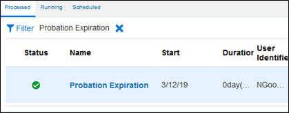

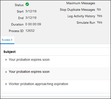

Validate the Alert
The previous step configured the alert to run as a simulation. It will not send emails.
  1. On the left bar, click on the Alerts History icon.
  2. Click on the Filter icon.
  3. In the Name field, type 'Probation Expiration'.
  4. Click on Apply.
  5. Validate you see the Probation Expiration alert ran successfully.
    1. You may have to click refresh a few times.
  6. Click on 'Probation Expiration' name to see the results of the alert's history.
Note that the alert sent no emails.

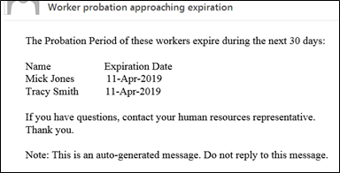

The current setup of the alert will not send emails to the employees and managers. See the Set Run Option section of this document to change the configuration.
If you configure the alert with the Simulate Run setting to 'No', the alert will send emails. The employee would receive an email like this one:
The manager would receive an email like this one:
