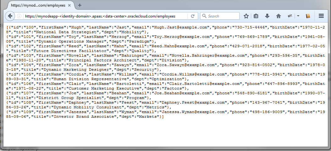

  4. To test your application, enter the application’s URL in a web browser and verify that the output shows 10 employees in a JavaScript Object Notation (JSON) format.
    MyNodeApp response
