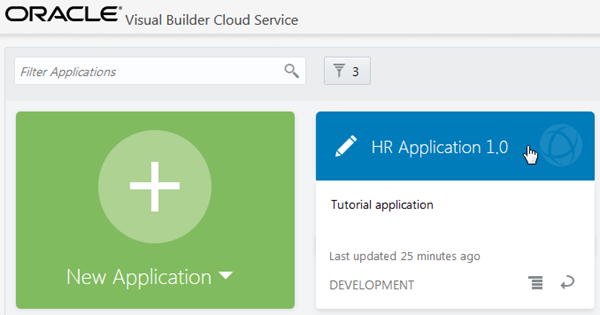

  2. On the Home page, click HR Application 1.0.

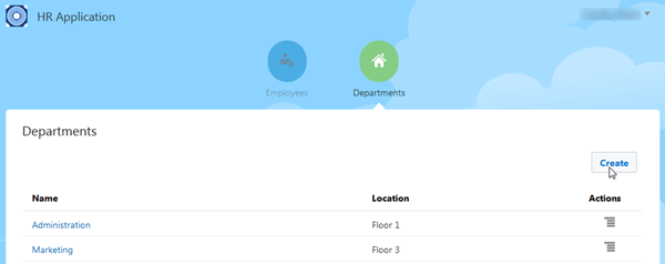

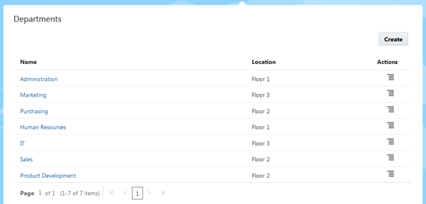

  5. On the Departments page, click Create.
    Departments page in Test Application mode
    Description of this image

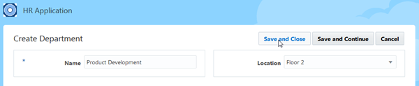

  6. On the Create Department page, enter Product Development in the Name field, and select Floor 2 from the Location drop-down list. Finally, click Save and Close.
    Create Department page in Test Application mode
    A success message appears, and the new department appears at the end of the Departments table.

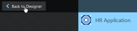

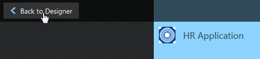

  7. Click Back to Designer to return to the Page Designer.
    Back to Designer button
    The Departments page of the Page Designer also displays the new department.

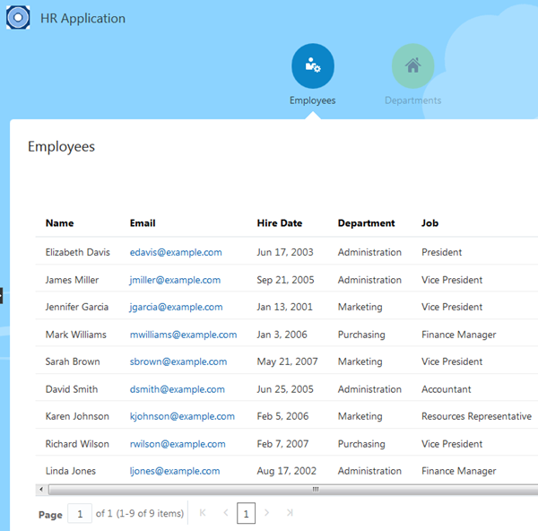

  1. In the Page Designer, open the page menu and select Employees. Notice that no employees are assigned to the Programmer job yet.

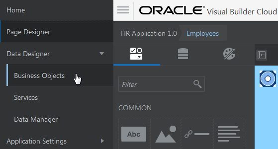

  2. Click Main Menu, expand Data Designer, and select Business Objects.
    Business Objects in Main Menu

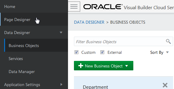

  6. Click Main Menu, then click Page Designer.
    Page Designer in Main Menu

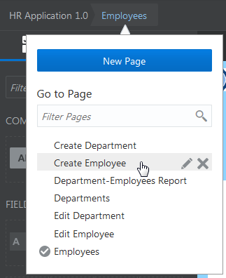

  1. From the page menu, select Create Employee.
    Page menu

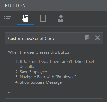

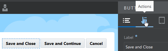

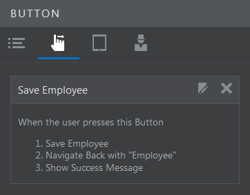

  2. Click the Save and Close button, then click the Actions tab in the Button Property Inspector.
    Button Actions tab
    The Actions tab displays the default actions performed when a user clicks the button:
    • Save Employee
    • Navigate Back with "Employee"
    • Show Success Message
    We want to add the creation of a default job and department.
    Default Button actions

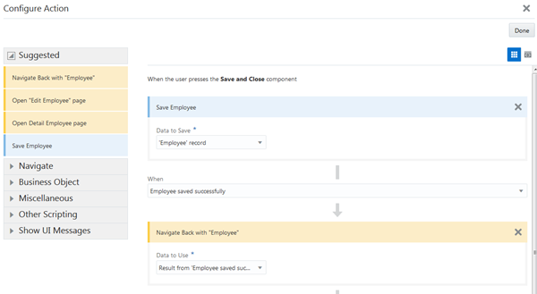

  3. Click the Edit button to open the Configure Action page.
    Configure Actions dialog box

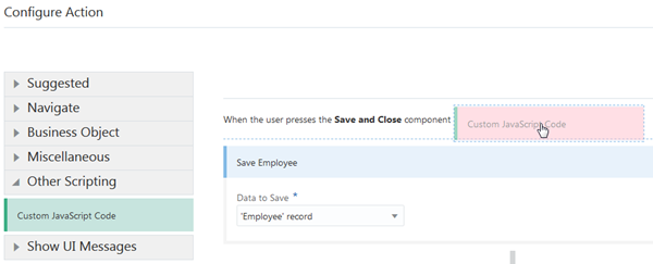

  4. Expand Other Scripting in the left column, then drag Custom JavaScript Code above the Save Employee action.

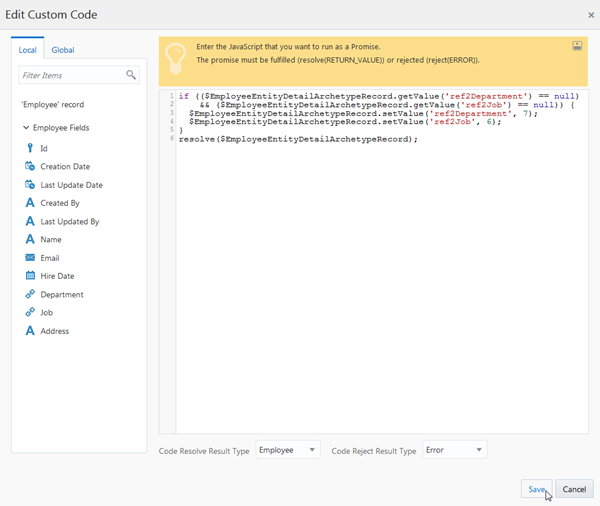

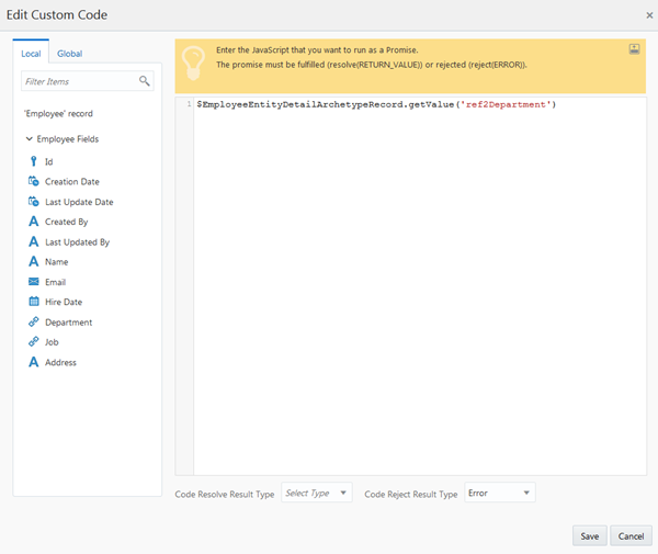

  6. In the Edit Custom Code dialog box, expand the Employee Fields node and click Department. A getValue call for the Department reference appears in the code window.
  7. Add a space after the getValue call and then click Job to get another getValue call. Then add code to perform the logic you need. The final code looks like this. (You can just paste the following code into the text area to avoid mistakes.)
    if (($EmployeeEntityDetailArchetypeRecord.getValue('ref2Department') == null)
        && ($EmployeeEntityDetailArchetypeRecord.getValue('ref2Job') == null)) {
      $EmployeeEntityDetailArchetypeRecord.setValue('ref2Department', 7);
      $EmployeeEntityDetailArchetypeRecord.setValue('ref2Job', 6);
    resolve($EmployeeEntityDetailArchetypeRecord);
    If both the Department and Job fields are empty, call setValue to set the Department to the correct Id value for Product Development (7), and call the same method to set the Job to the correct Id value for Programmer (6). Make sure that you finish with a call to resolve to fulfill a promise.
  8. At the bottom, select Employee from the Code Resolve Result Type drop-down list, then click Save to return to the Configure Actions dialog box.

  9. Click Done to return to the Create Employee page. Verify that the list of button actions reflects your changes:
    • If Job and Department aren't defined, set defaults
    • Save Employee
    Modified button actions
