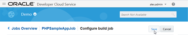

  8. Click Save.
    Description of this image

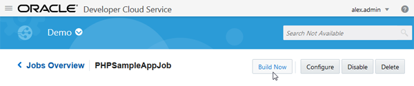

  9. In the Job Details page, click Build Now.

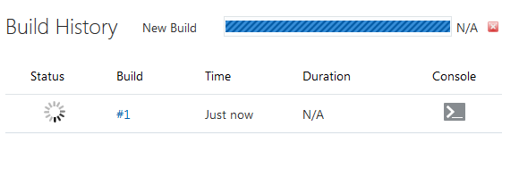

  10. In the Build Hisotry table, track the build's status.
After the build is successful, you will notice the archive file in the Artifacts of Last Successful Build section.

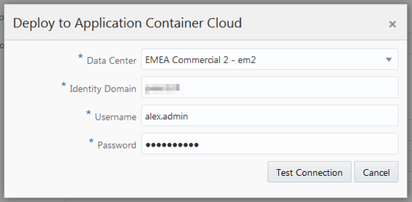

    If you want to create a deployment target, click New and select Application Container Cloud.
    Enter the details in the dialog that opens and then click Test Connection. When the connection is successful, click Use Connection.

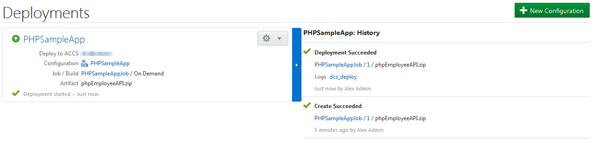

  4. Click Save and Deploy.
Wait for the deployment to complete. Click the configuration name to open the deployed application in the browser.
