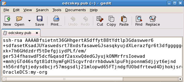

Copy the string value of the key to a text file and save the text file as
odcskey.pubon your machine.
Description of this image Instead of copying the string value, you may also redirect the cURL command output to the
odcskey.pubfile.

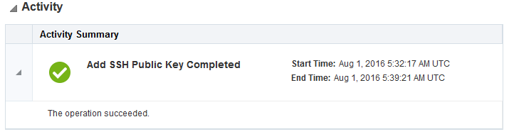

In the header of the Overview page, click
next to the Oracle Java Cloud Service instance name and select SSH Access.
In the Add New Key dialog, with Upload a new SSH Public Key value from file selected, click Browse.
Select the Oracle Developer Cloud Service SSH public key file that you saved and click Add New Key.
In the Add New Key dialog, click Submit.
The Oracle Developer Cloud Service SSH public key is added to the authorized_keys file of the Oracle Java Cloud Service VM. After adding the public key, the VM will restart automatically. This will take some time. You can track the restart activity in the Activity Summary section of the Overview page. When the instance has restarted and the activity is complete, you will see the Add SSH Key is Completed in Activity Summary.

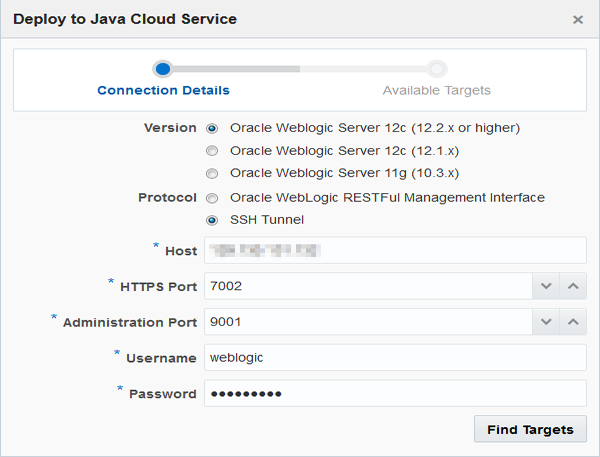

In the Connection Details page of the Deploy to Java Cloud Service wizard, enter the following information:
Version: Select the version of the Oracle Java Cloud Service WebLogic instance that you are subscribed to.
Protocol: Select
SSH Tunnel. -
Host: Enter the host name or the public IP address of the Oracle Java Cloud Service instance VM.
HTTPS Port: Enter the HTTPS port number of the WebLogic Server that runs on the Oracle Java Cloud Service instance.
Administration Port: Enter the admin port number of the WebLogic Admin Server that runs on the Oracle Java Cloud Service instance. The default port number is
9001. -
Username: Enter the user name of the Oracle Java Cloud Service WebLogic Administration console.
Password: Enter the password of the Oracle Java Cloud Service WebLogic Administration console.

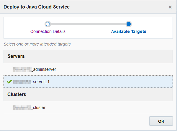

Click Find Targets.
In the Available Targets page of the wizard, select the servers or the clusters you want to deploy the application to. You can select more than one option.
Description of this image -
Click OK.

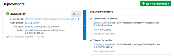

On Demandas the Type, click Save and Deploy. If you selectedAutomaticas the Type, click Save.
After you save the deployment configuration, it appears in the Deploy page.
Note: If you
selected Automatic as the Type,
run a build to deploy the specified artifact
automatically. To deploy the artifact manually,
click the
icon, and select Start.

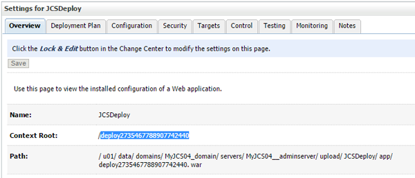

Get the context root of the application from the
application.xmldeployment descriptor for EAR deployments and from theweb.xmldeployment descriptor for WAR deployments.If there is no such descriptor, get the context root from the Oracle Java Cloud Service WebLogic Administration console.
Open the Oracle Java Cloud Service WebLogic Administration console.

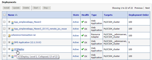

Click Deployments in Domain Structure.
Click the deployed application name.
In the Overview tab, copy the context root.

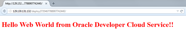

To construct the application's access URL, use the content URL and the context root.
For example, if the content URL is
http://129.130.131.132and the context root isdeploy2735467788907742440, the application's access URL would behttp://129.130.131.132/deploy2735467788907742440/. - Enter
the generated URL in the address bar of the
browser to access the application.
