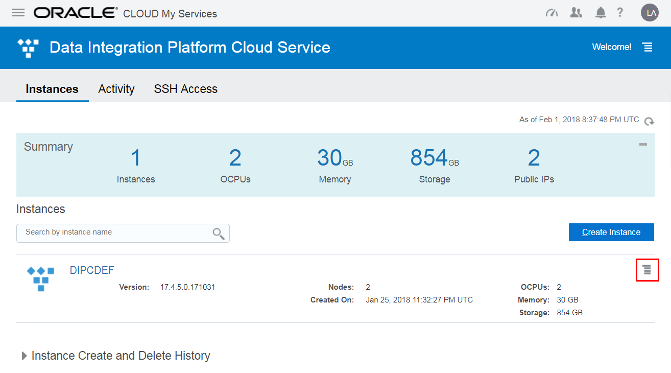

  1. From the Data Integration Platform Cloud Services page, select a service instance and then click Manage this service.

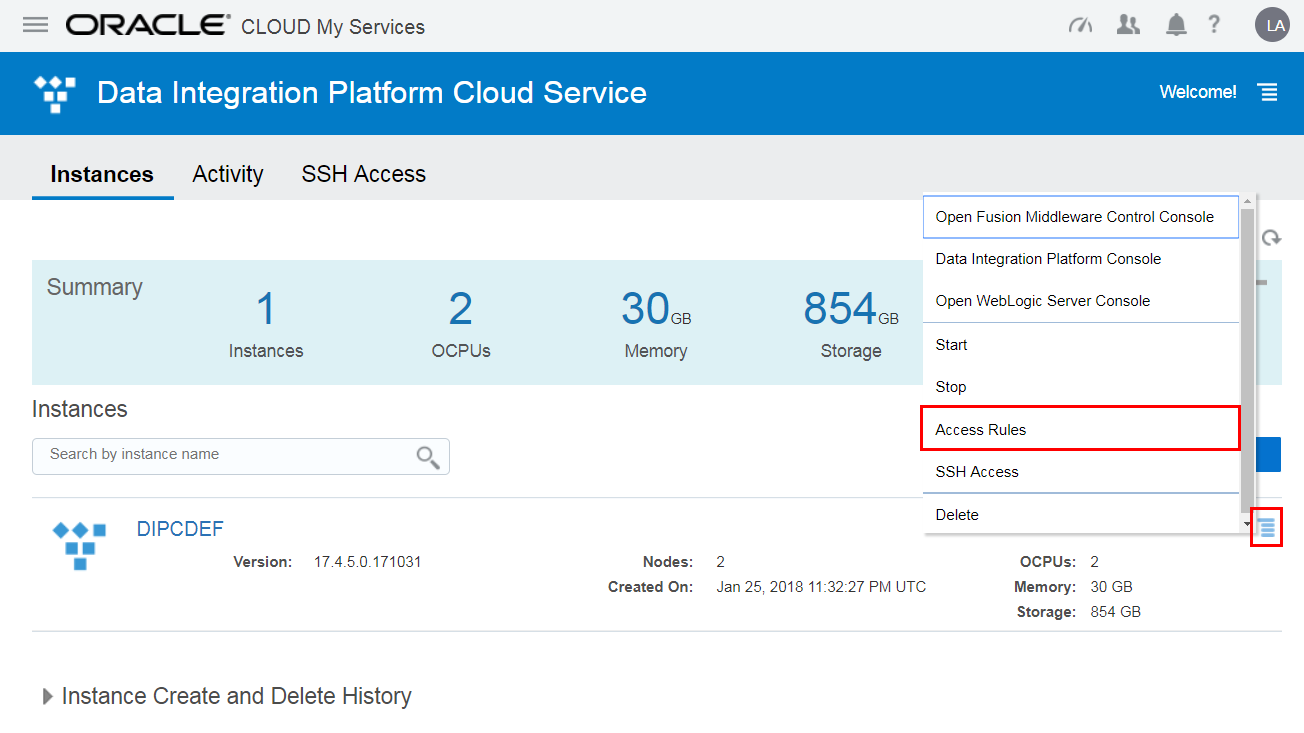

  2. From the Manage this service menu, select Access Rules.
    Manage this service menu - Access Rules
    Description of this image

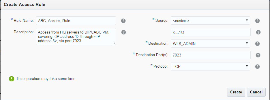

  4. Complete the fields as follows, and then click Create:
    • Rule Name: ABC_Access_Rule
    • Description: Access from HQ servers to DIPCABC VM, covering <IP address 1> through <IP address 3>, via port 7023
    • Source: Select <custom. To enter a valid IP address range, write the first IP address, append a slash and then enter the last number of the range. For example, for <ip address ending in 1> through <same ip address, except for the last number being 3>, you wtrite x......1/3in the field that appears for custom IP addresses when you select <custom>.
      By using slash, you are providing a range of custom IP addresses. You may also just write one IP address, or separate the IP addresses with commas.
    • Destination: Select WLS_ADMIN.
    • Destination Port(s): 7023
      Note:  In addition to the listed ports on the Access Rules page, to find out if other ports are taken on your VM, use the netstat command. With this command you'll find out which process or program is using a certain port. If that port is taken, then assign a different port for the destination. For example, for port 7023, the command is:
      $ netstat -na | grep 7023
    • Protocol: Select TCP.
    • Create an Access Rule

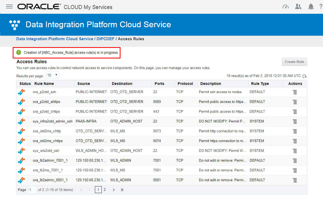

  5. Confirm that a message appears that the Creation of [ABC_Access_Rule] is in progress.
    Access Rule creation in progress.

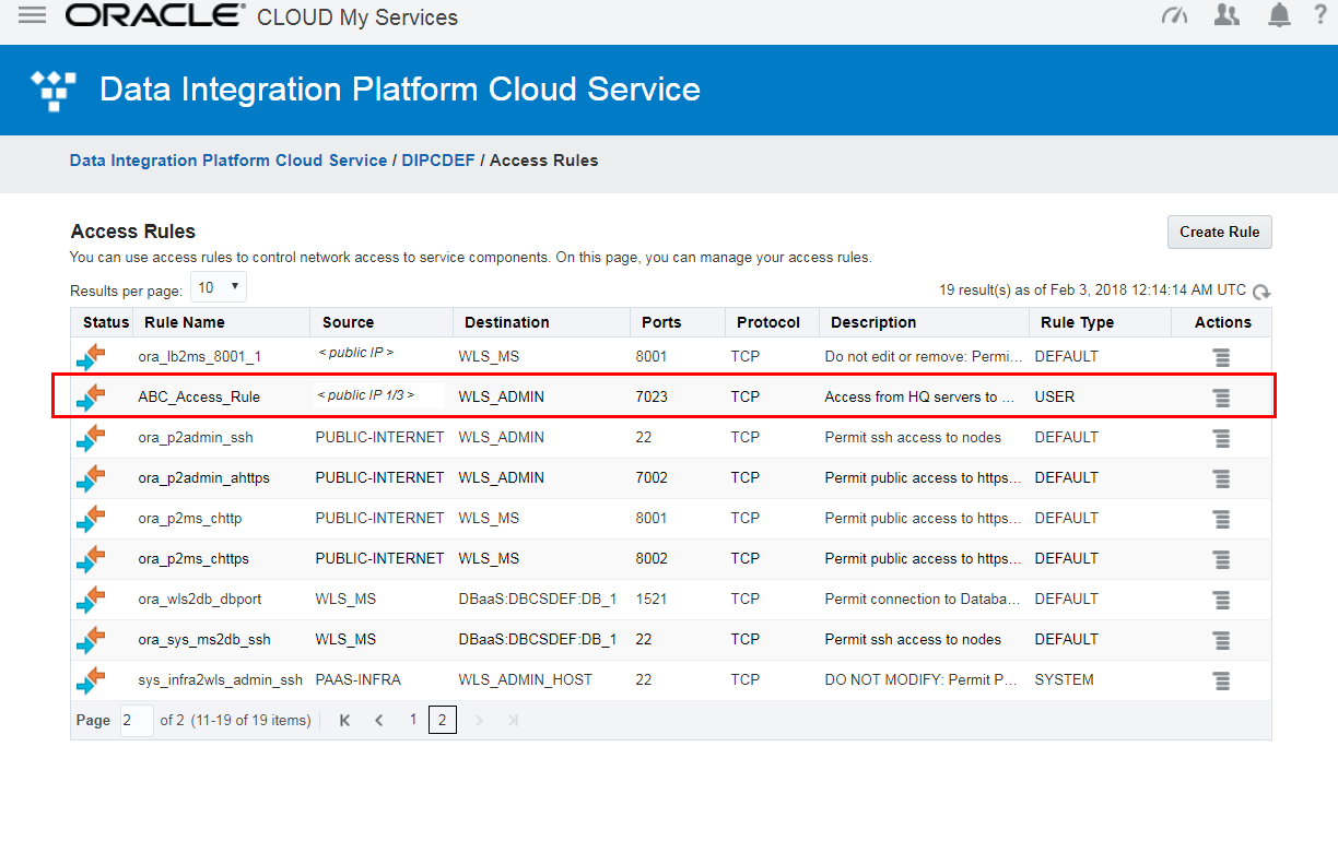

  6. Refresh the page until the rule appears in the list of Access Rules for your instance.You may need to go to the second page to find the rule.
    User Access Rule created
Click the Actions Menu  for your access rule to disable, enable or delete it.
