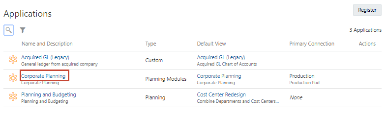

  1. On the Enterprise Data Management Cloud home page, click Applications.
  2. Click Corporate Planning to open the inspector.
    Enterprise Data Management Cloud applications

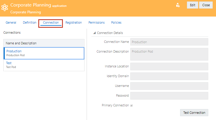

  3. Select the Connection tab.
    Enterprise Data Management Cloud Corporate Planning application inspector Connection tab
  4. Select the Production connection, then click Edit.

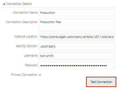

  5. Modify the connection details for your Planning instance:
    Field Valid Values Example
    Instance Location Enter a connection URL to your Planning instance in the format:
    https://ServiceName-IdentityDomain-ServiceType.DataCenter.oraclecloud.com
    https://planbudget-uscompany-entplan.US11.oraclecloud.com
    where
    • ServiceName is planbudget
    • IdentityDomain is uscompany
    • ServiceType is entplan
    • DataCenter is US11
    Identity Domain Enter the identity domain of your Planning instance.
    Note: This is the same Identity Domain used in the Instance Location.
    uscompany
    Username Enter an authorized user name.
    Note: The user must be a Service Administrator of the Planning instance.
    tom.smith
    Note: You must enter the identity domain in either the Identity Domain or Username fields. For example, enter uscompany in Identity Domain or uscompany.tom.smith in Username.
    Password Enter the user's password. xxxxxxxx
  6. Select Primary Connection to make this connection the default for importing and exporting.
  7. Click Test Connection.
    Enterprise Data Management Cloud connection setup and test
    The message "Connection Successful" is displayed.
    If your connection test is not successful, check your connection information and try again.
  8. Click OK, then click Save.

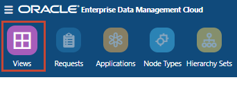

  1. Click Views (located in the icons along the top of the page).
    Enterprise Data Management Cloud Views card

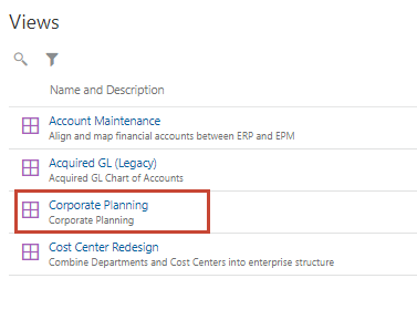

  2. Click Corporate Planning to open the view.
    Enterprise Data Management Cloud list of views

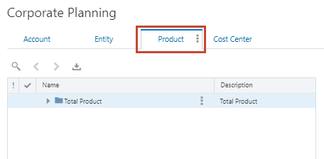

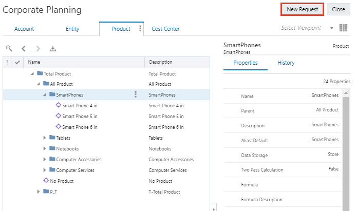

  3. Select the Product viewpoint.
    Enterprise Data Management Cloud Product viewpoint

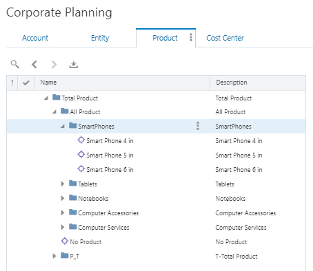

  4. In the Product hierarchy, expand Total Product, then All Product, and then SmartPhones.
    Enterprise Data Management Cloud Product viewpoint with hierarchy expanded

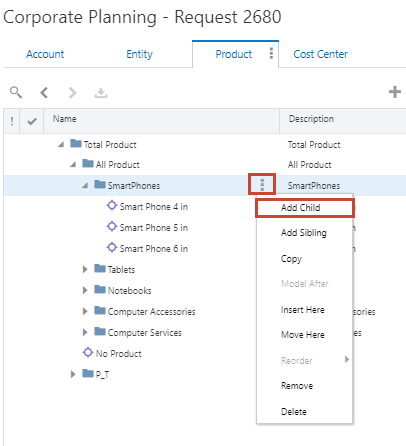

  5. Click New Request to start a request to add a product.
    Enterprise Data Management Cloud Product viewpoint with hierarchy expanded and New Request button highlighted

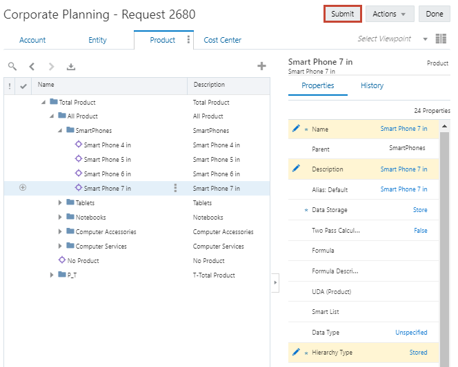

  6. In the SmartPhones row, click the Actions icon and select Add Child.
    Enterprise Data Management Cloud request adding a child

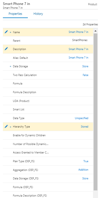

  7. Enter property values for the new product (for any properties not listed in the table, use the default value):
    Property Value
    Name Smart Phone 7 in
    Description Smart Phone 7 in
    Hierarchy type Stored
    Enterprise Data Management Cloud properties for the new product
  8. Click Submit to commit the changes.
    Enterprise Data Management Cloud submit request
    You receive a message that the request was successfully submitted.
    Enterprise Data Management Cloud request successfully submitted message
    Submitting the request validates your changes. If there are no validation issues and there is no approval workflow defined, the changes are immediately commited to the dimension.

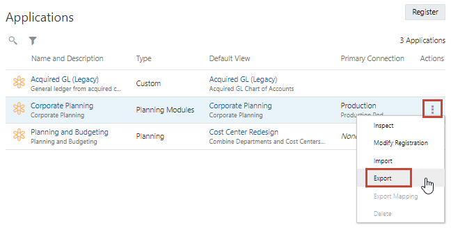

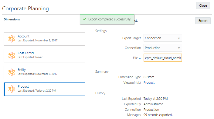

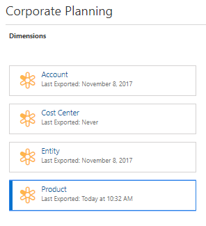

  1. On the Enterprise Data Management Cloud home page, select Applications.
  2. In the Corporate Planning application row, click the Actions icon, and select Export.
    Enterprise Data Management Cloud applications action: export Corporate Planning

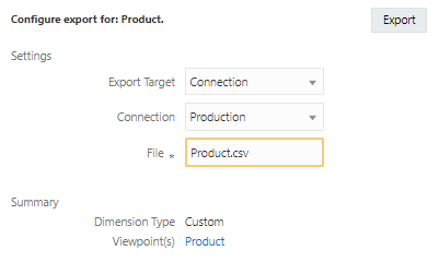

  3. Select the Product dimension.
    Enterprise Data Management Cloud export dimensions with Product selected
  4. Configure the export:
    • Export Target: Connection
    • Connection: Production
    • Export file name: Product.csv
    Enterprise Data Management Cloud export Product configuration
  5. Click Export.
    You get a message that the export completed successfully.
    Enterprise Data Management Cloud export Product completed successfully

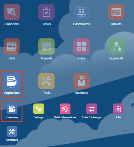

  1. Open a new browser tab and log in to your Planning instance. From the home page, select Application, and then select Overview.
    Planning home page with Application and Overview highlighted

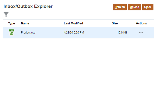

  2. Click Actions, then select Inbox/Outbox Explorer.
    Planning - open the Inbox/Outbox explorer
  3. Notice that the Product.csv file has been exported from Enterprise Data Management Cloud to Planning.
    Planning Inbox/Outbox explorer with the Product.csv file displayed

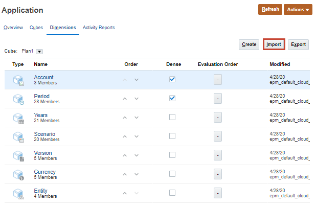

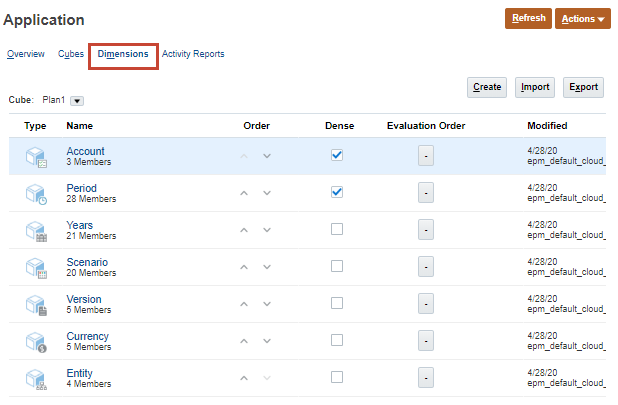

  1. Select the Dimensions tab.
    Planning Application Dimensions tab
  2. Click Import to display the Import Metadata dialog box.
    Planning Application Dimensions tab with Import highlighted

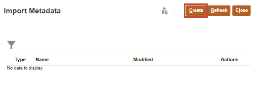

  3. Click Create.
    Planning Import Metadata dialog box with Create highlighted

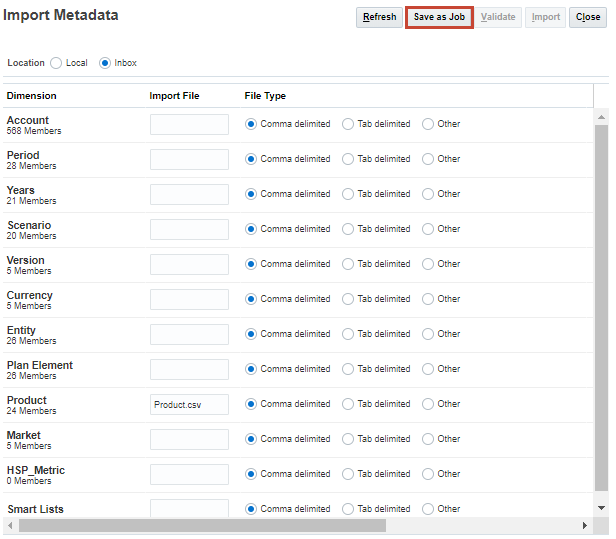

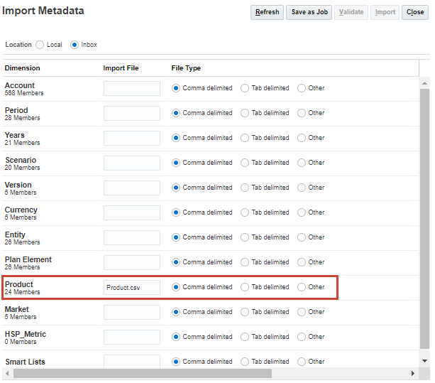

  4. For Location, select Inbox.
    Planning Import Metadata dialog box with Inbox location highlighted
  5. In the Product dimension row, enter Product.csv, and accept the default (Comma delimited) for the File Type.
    Planning Import Metadata dialog box with the Product dimension row highlighted
  6. Click Save as Job.
    Planning Import Metadata dialog box with Save as Job highlighted

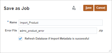

  7. Configure the job:
    • Name: Import_Product
    • Error File: edmc_product_error
      This file provides information about the metadata records that were not imported for each dimension. If you specify an error zip file, a separate error file is created for each dimension, then the error files are zipped together, and the zip file is stored in the Outbox where you can download the file using Inbox/Outbox Explorer.
    • Refresh Database if Import Metadata is successful: Selected
    Planning Save as Job dialog box with values entered
    You must refresh the database after modifying dimensions and members. In a production environment, Oracle recommends that you notify all users, asking them to save their work and close the application, before you refresh the database. For more information on database refreshes, please see Before Refreshing the Database in Administering Planning.
  8. Click Save, then click OK to close the information message.

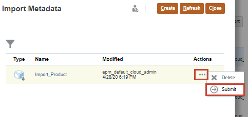

  10. In the second Import Metadata dialog box, click Refresh to view the list of saved import metadata jobs.
    Planning import metadata jobs list
    The job you created is displayed in the list.
Running the import job and viewing results
In this section, you run the saved import job and verify that the new product is added to Planning.
  1. In the row for the import job, click the Actions icon and select Submit.
    Planning Import Metadata submit job
    A message that the job was submitted is displayed.
    Planning Import Metadata submit job - job submitted successfully
  2. Click OK to close the message, then click Close to close the Import Metadata dialog box.

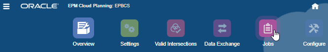

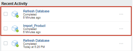

  3. Click the Jobs card (located at the top of the page) to verify that the job completed successfully.
    Planning Jobs card
  4. Notice that the top two jobs listed in Recent Activity are the metadata import and the subsequent database refresh. The jobs completed successfully.
    Planning Jobs list with jobs completed successfully

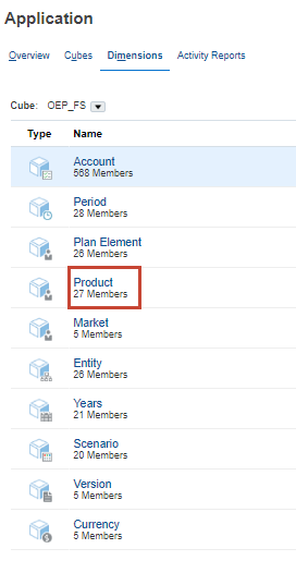

  5. Click the Overview card to return to the application overview, then select the Dimensions tab again.
  6. In the Cube drop-down, select OEP_FS.
    Planning Application Dimensions tab, selecting a cube
  7. Click Product to view the Product dimension.
    Planning Application Dimensions tab, selecting the Product dimension

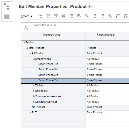

  8. Expand Total Product, then All Product, and then SmartPhones.
    Planning OEP_FS Product dimension, with the new product displayed
    The new product, Smart Phone 7 in, was added to the dimension.
