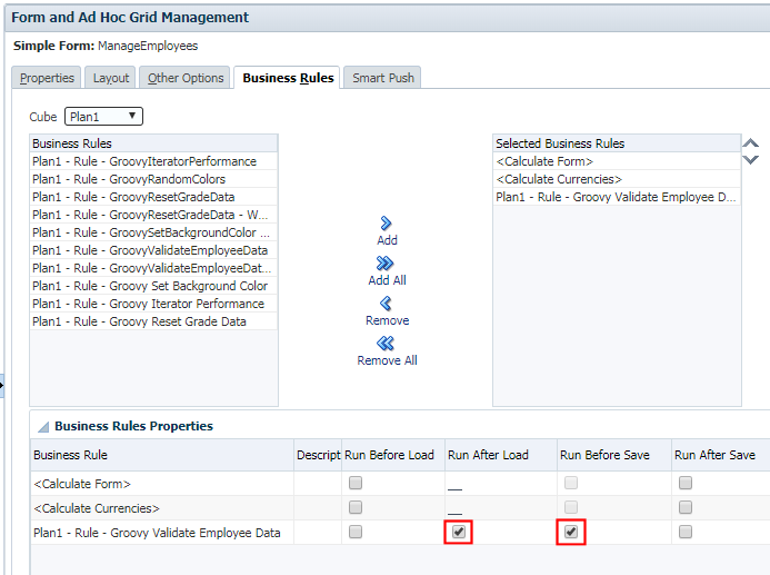

- In the Form Manager, edit the ManageEmployees form and associate the Groovy Validate Employee Data rule to be run After Load and Before Save (you may need to select Plan1 from the Cube list first).
- Save the form and close the Form Manager window.

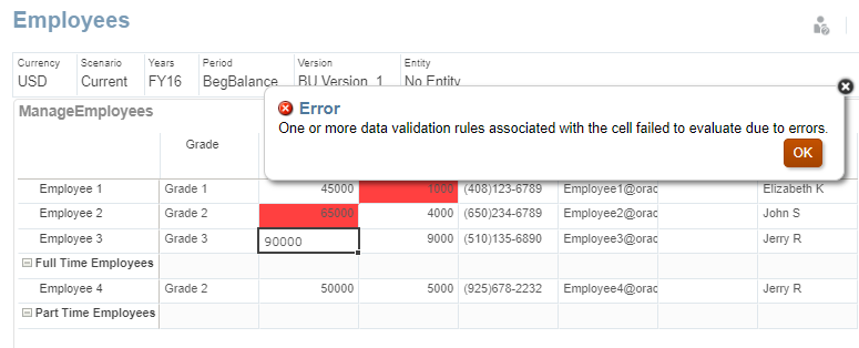

- Open the Employees dashboard. Add a Bonus of 1000 for Employee 1, increase the Salary for Employee 2 to 65000. On the form toolbar, click
(Save).
- In the Error message dialog box, click OK.
- Hover the mouse over the red cells to see the detailed error messages as tooltips.

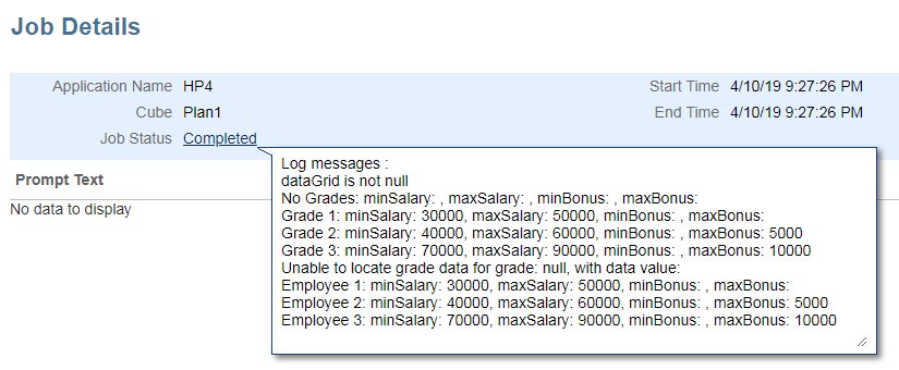

Close the dashboard and open the Jobs console.
Click Groovy Validate Employee Data to display the job details. Click the Completed status to see the grade data loaded from the lookup cube and the grade data per each employee's grade.
