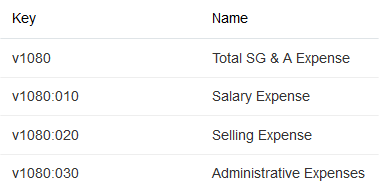

Subaccounts key and name
Subaccount IDs are displayed after the main account number, separated by a colon. A main account number drives the accounting integrity of the model. If there is a related account it is the two digit number after the first decimal place. The subaccount id is at the end after a colon.

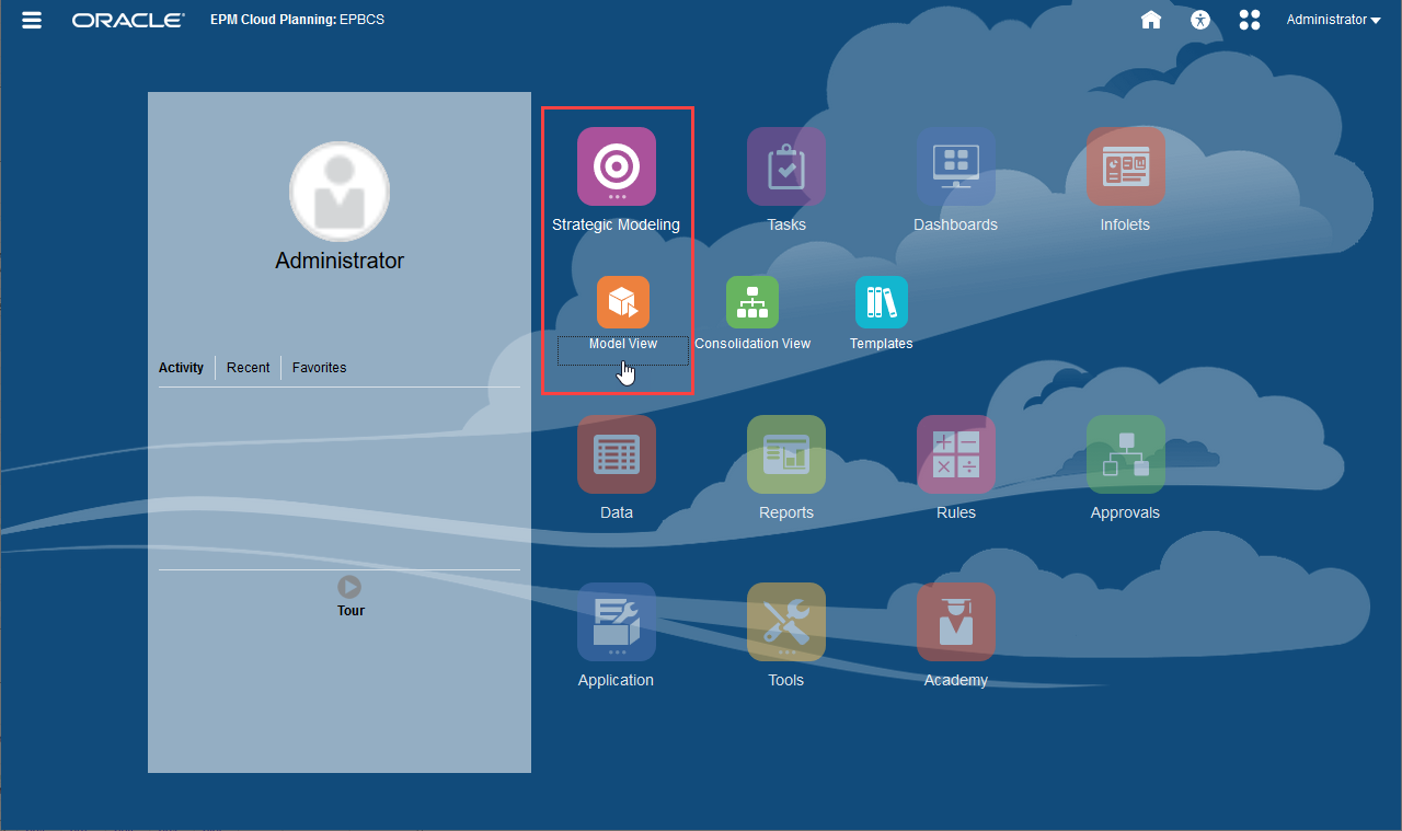

  1. On the Planning home page, click Strategic Modeling and then Model View.
  2. Home Page

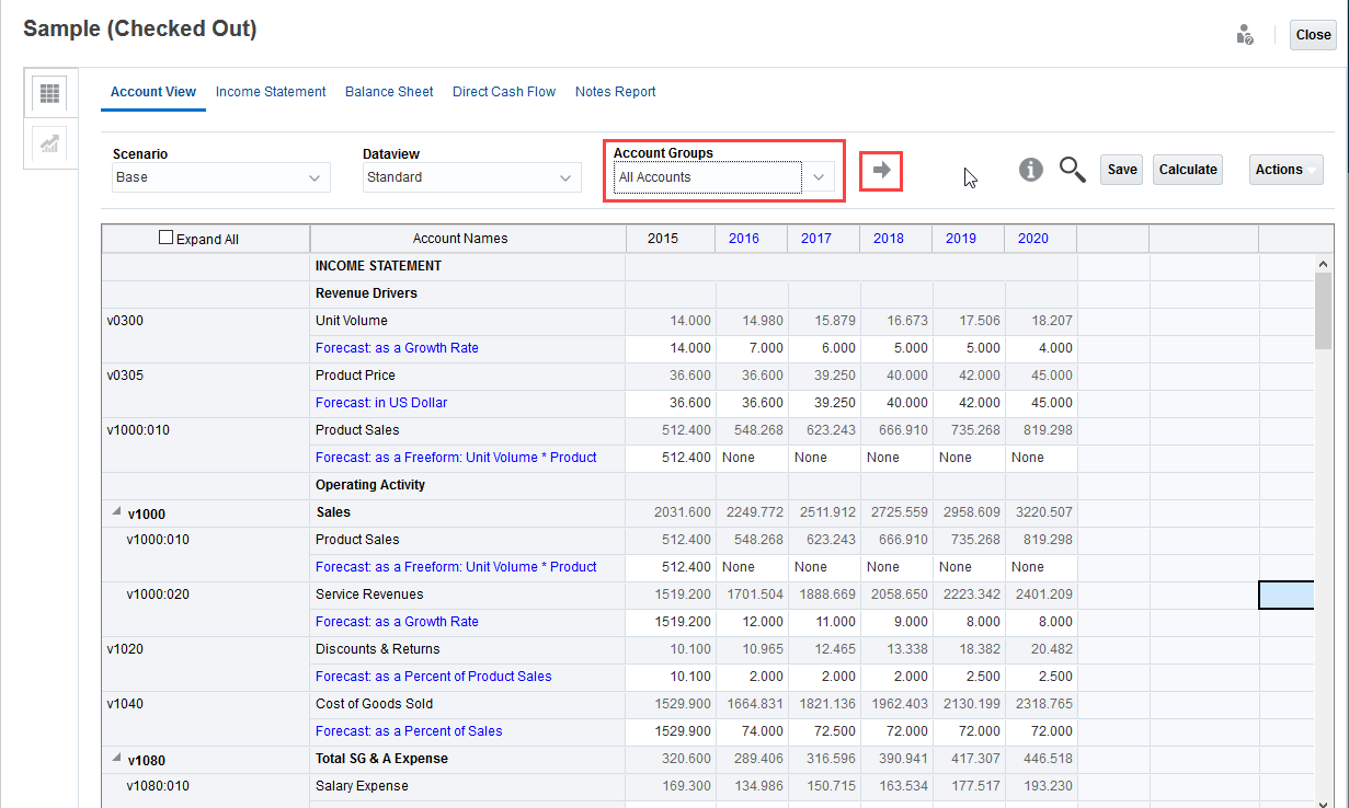

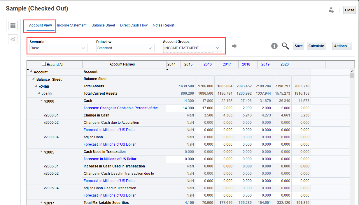

  5. In the Account View, set the POV as follows:
    • Scenario: Base
    • Dataview: Standard
    • Account Groups: INCOME STATEMENT
    Account View POV

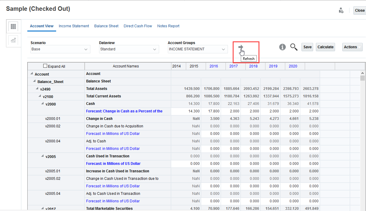

  6. Click Refresh Icon (Refresh).
  7. Refresh Account View
  8. Scroll to v1080. Notice that the Salary Expense account is a subaccount of Total SG & A Expense. Its account number includes the main account 1080 and the subaccount 10.

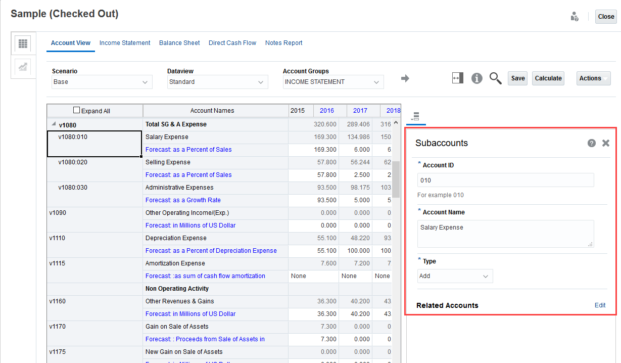

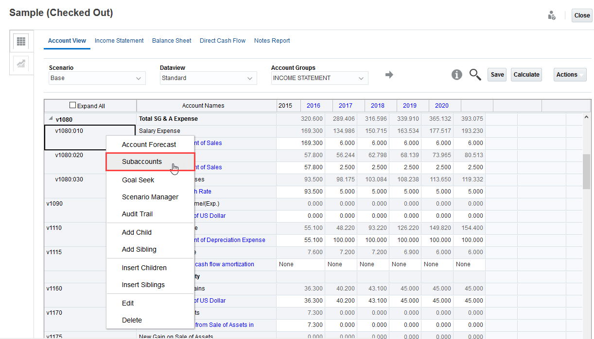

Reviewing Income Statement subaccounts
In this section you review subaccounts for Income Statement accounts.

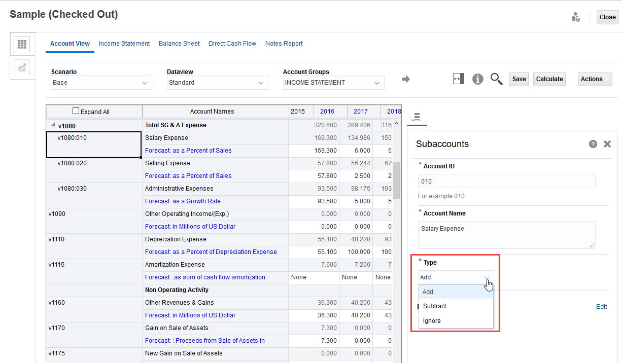

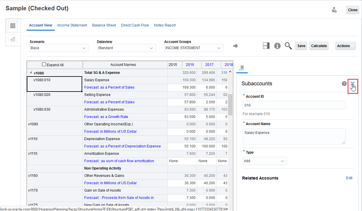

  1. Right-click v1080:010.and select Subaccounts.
  2. Right-click account and select Subaccounts
  3. Review the subaccount information. The subaccount is displayed in the Account ID, and the name of the account is displayed in Account Name. Type is set to Add. Values for salary expense are additive and increase the Total SG & A Expense value.
  4. Subaccounts Frame
  5. Open the Type drop-down list. For subaccounts, you can select Subtract to subtract the value from its parent, or you can select Ignore if the subaccount is independent of its parent.
  6. Type drop-down list
  7. Leave Type set to Add and click X to close Subaccounts.
  8. Close Subaccounts

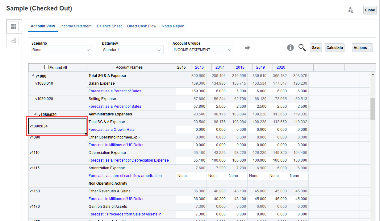

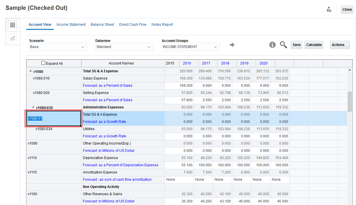

Adding a subaccount by adding a child member
You can add subaccount members to the account hierarchy by adding a child or a sibling member to the selected account. In this section you add a Utilities subaccount by adding a child member.

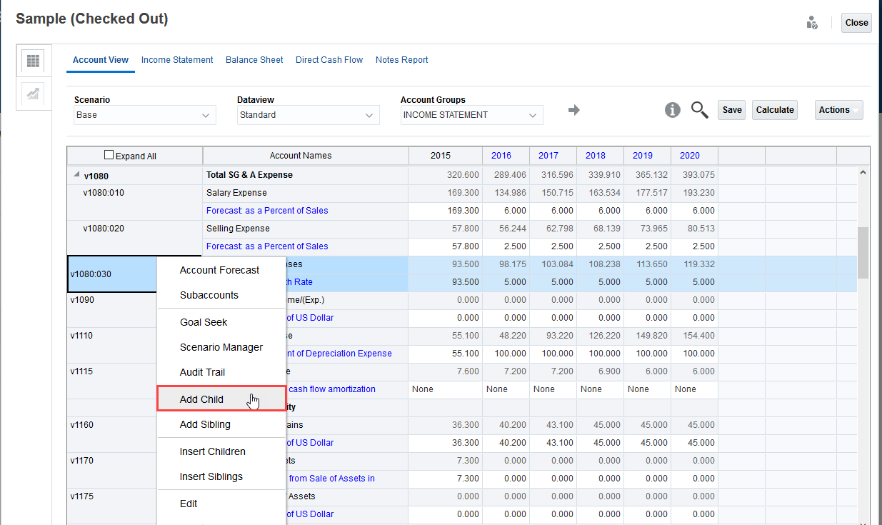

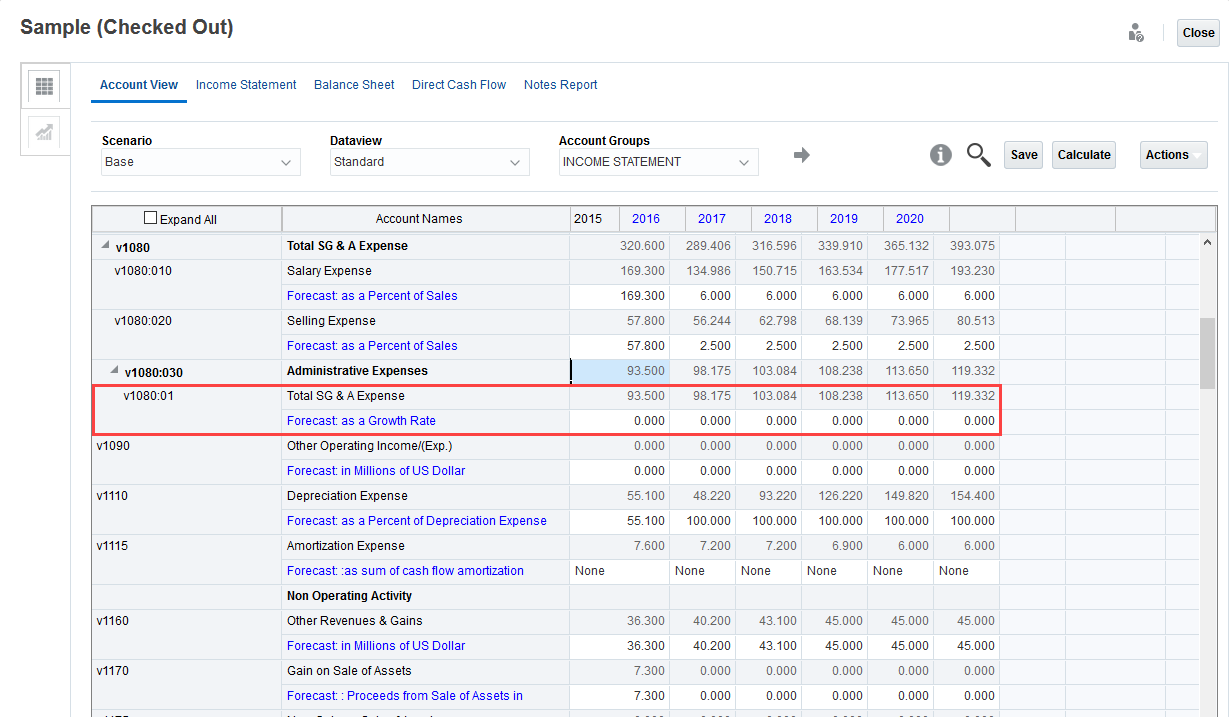

  1. Right-click v1080:30, and select Add Child.
  2. Add a child
  3. Notice that a new row v1080:01 is displayed.
  4. New subaccount displayed

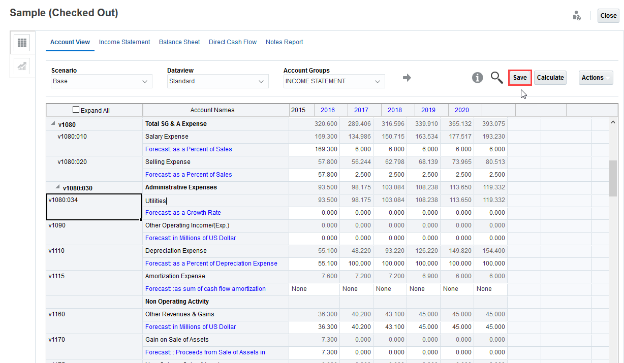

  5. Select v1080:01 and change the account id from 01 to 034.
  6. Change Account ID

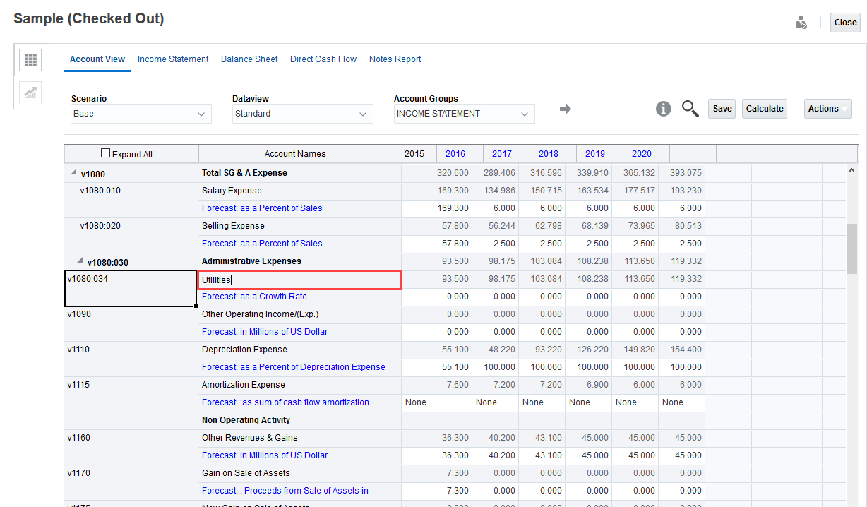

  7. In the v1080:034 row, change the account name from Total SG & A Expense to Utilities. In this case, you will track expense data for Utilities separately, however it will roll up into Administrative Expenses.
  8. Rename Account
  9. Click Save.
  10. Save subaccount

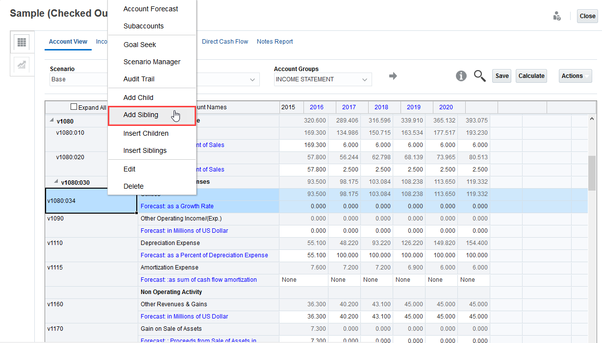

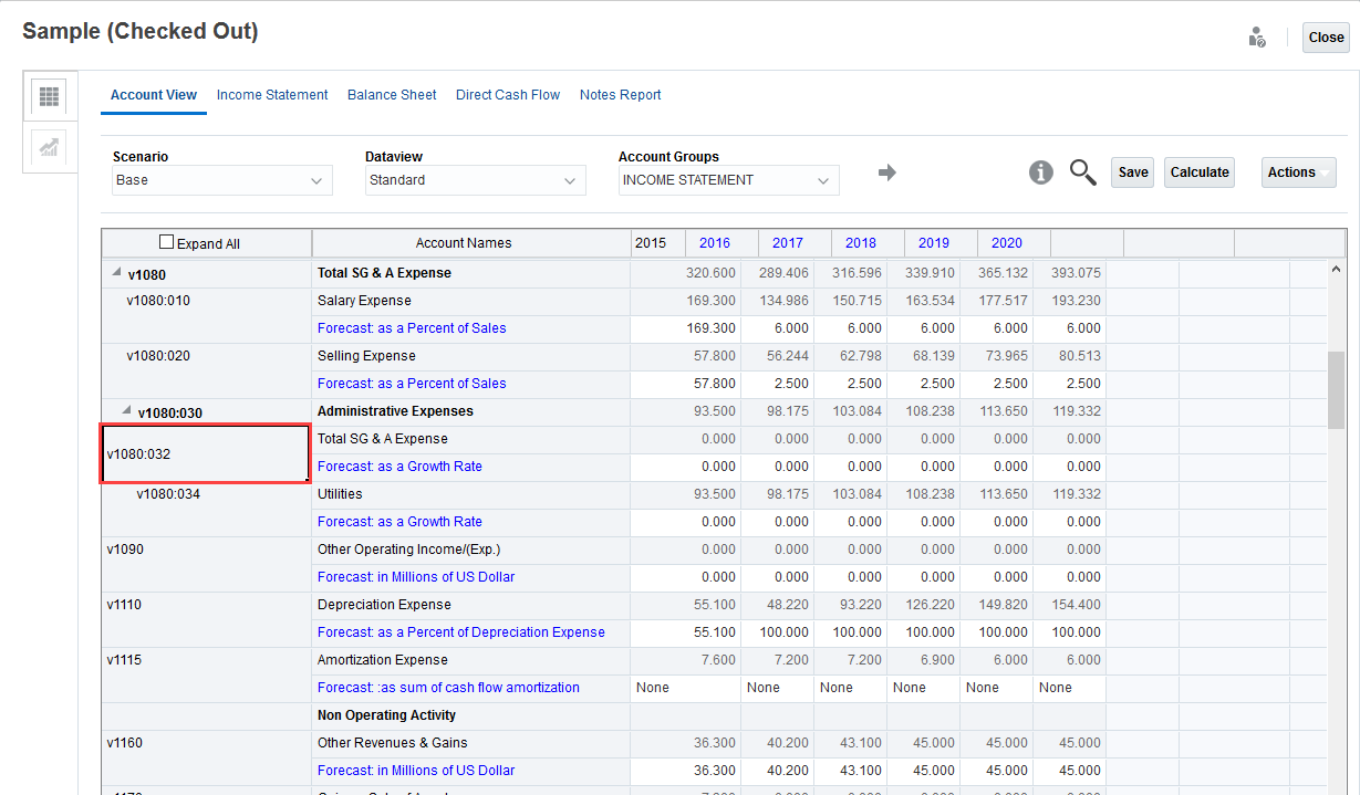

Adding a subaccount by adding a sibling member
In this section you add a subaccount using a sibling member to track expense data for Rent separately.
  1. Right-click 1080:034, and select Add Sibling.
  2. Add Sibling
  3. In the added row, select v1080:01.
  4. Select sibling row
  5. Change the account id from 01 to 032.
  6. Change subaccount ID

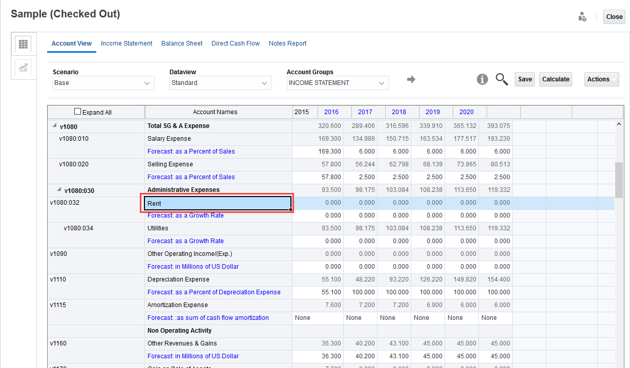

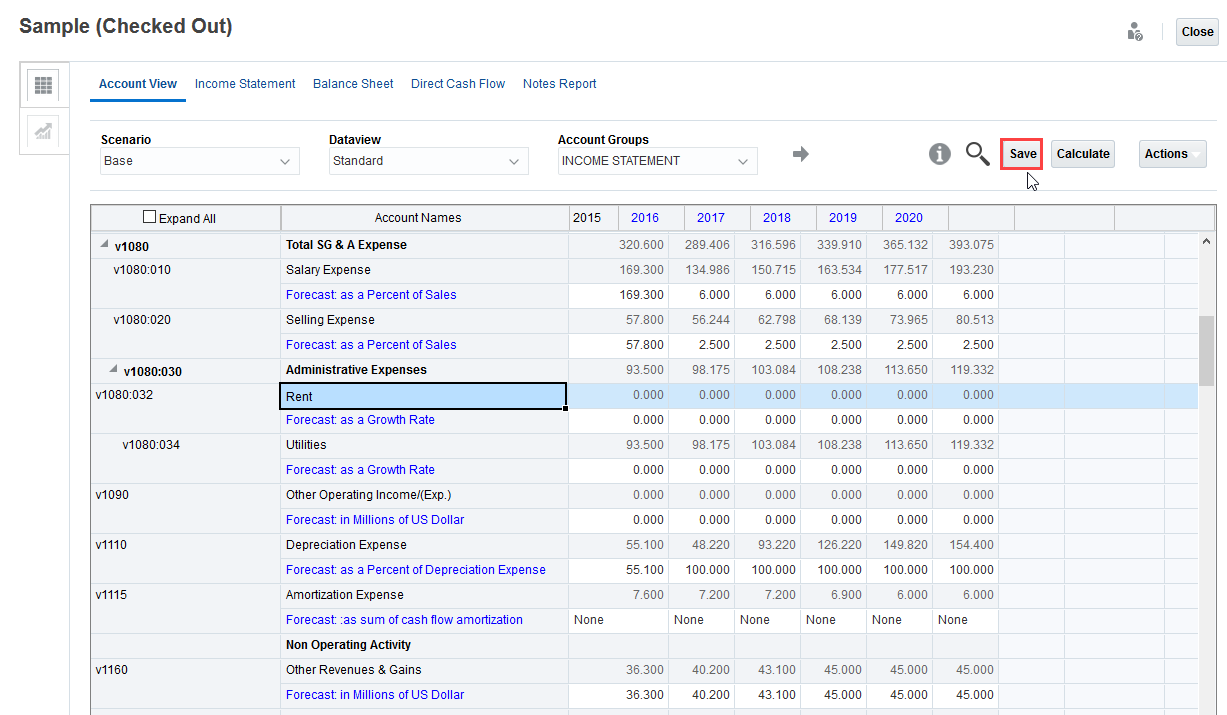

  7. Change the Account Name for the row to Rent.
  8. Change subaccount name
  9. Click Save.
  10. Save changes

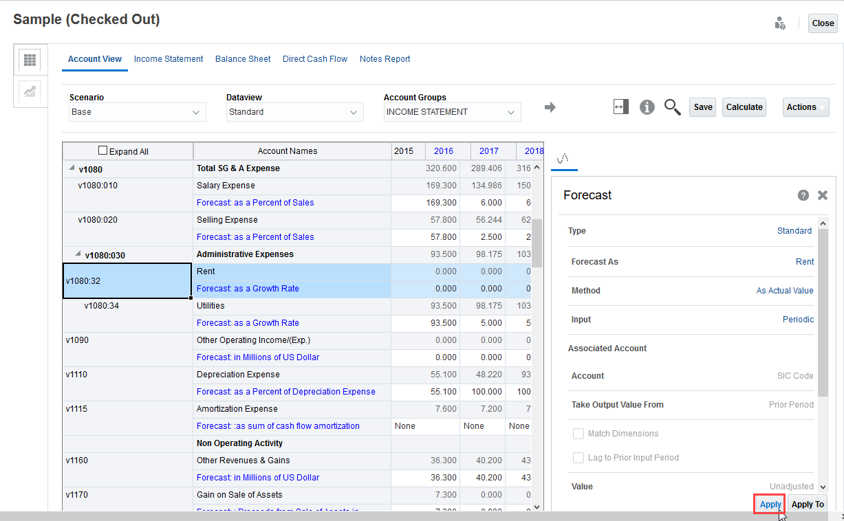

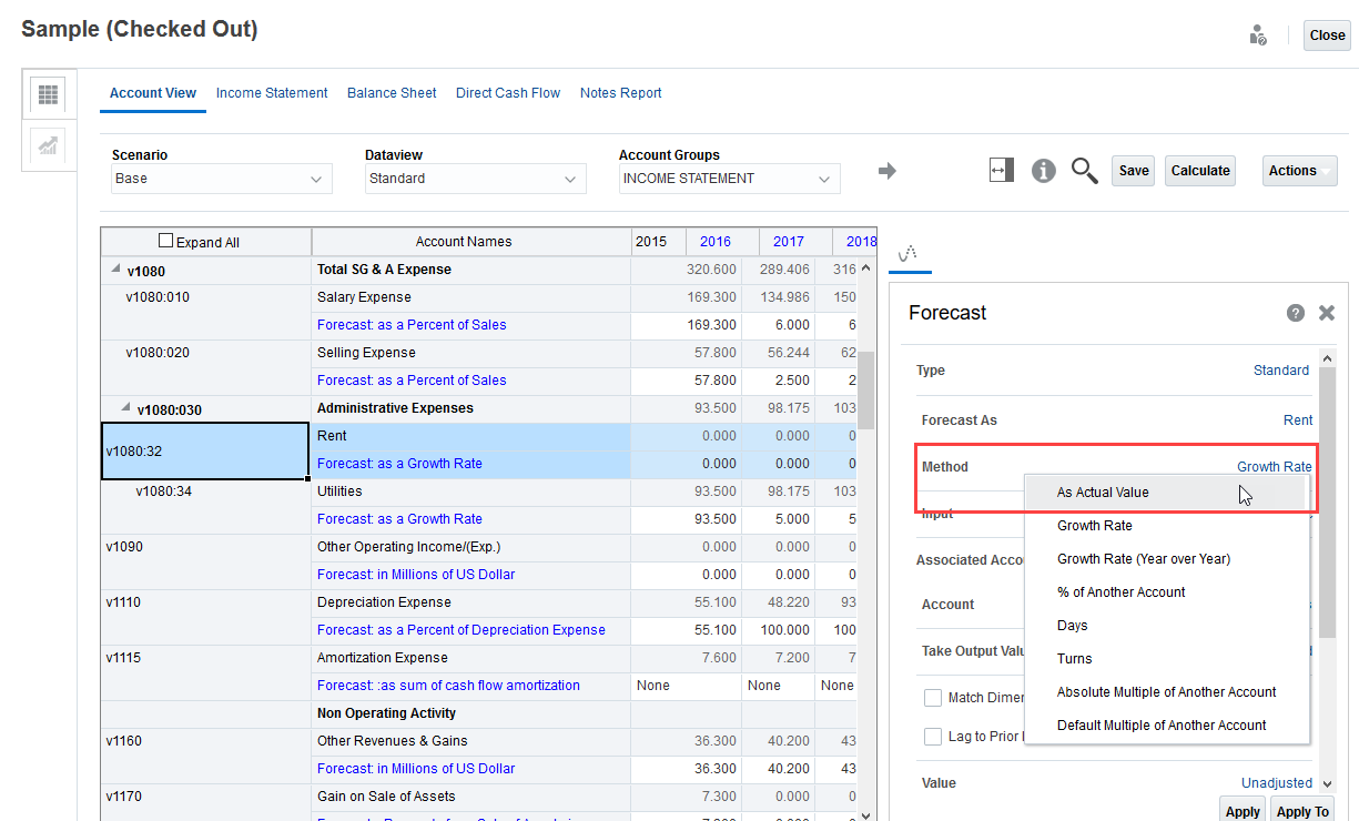

Changing a forecast method
In this section you change the forecast method for the Rent subaccount.

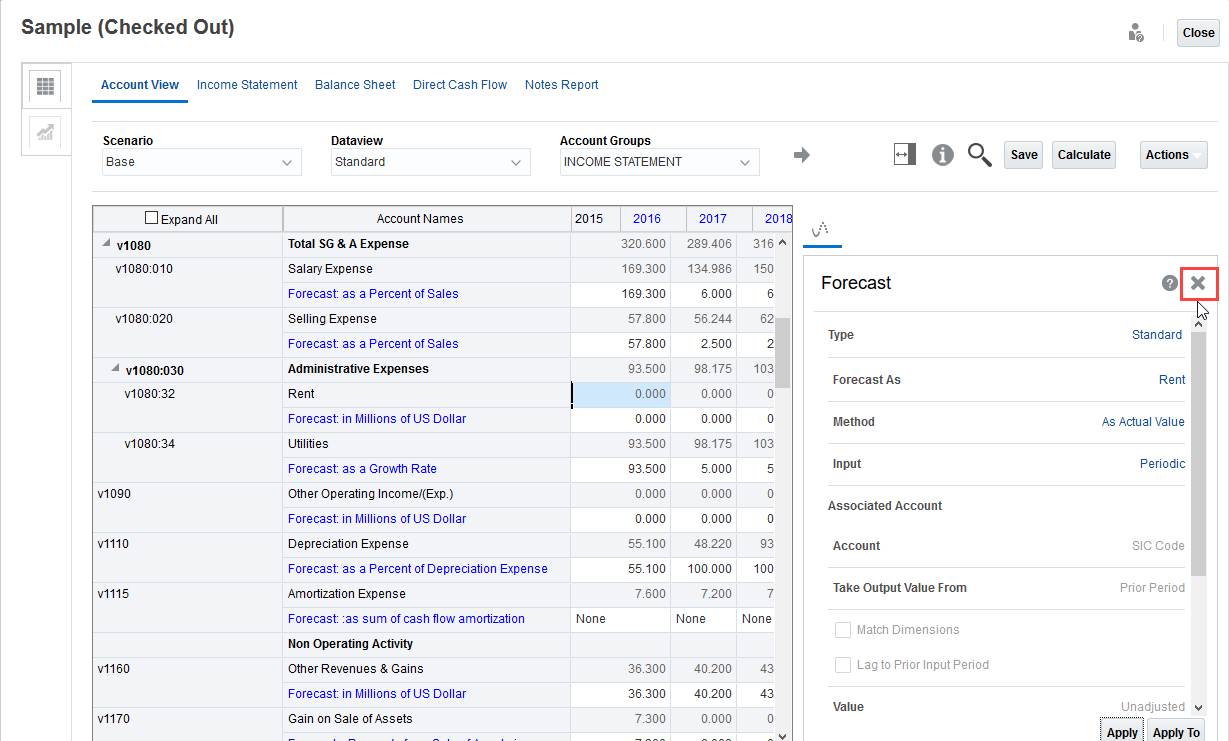

  1. Right-click 1080:032, and select Account Forecast.
  2. Add Sibling
  3. In the Forecast panel, change the forecast method from Growth Rate to As Actual Value.
  4. Add Sibling
  5. Click Apply.
  6. Add Sibling
  7. Click X to close the Forecast panel.
  8. Add Sibling

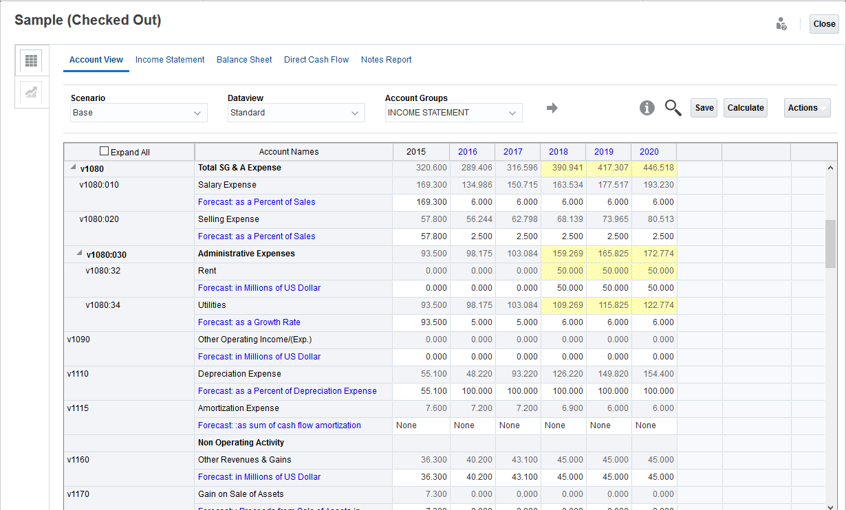

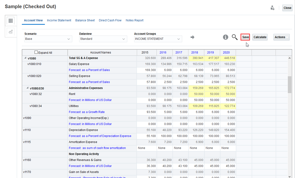

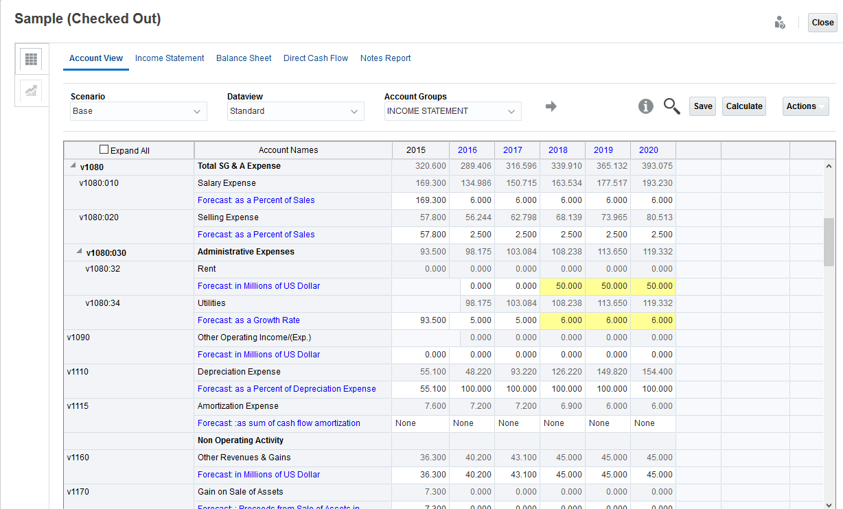

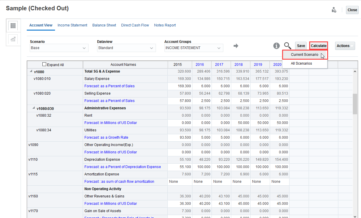

Entering subaccount data
In this section you enter data for the subaccounts Rent and Utilities.

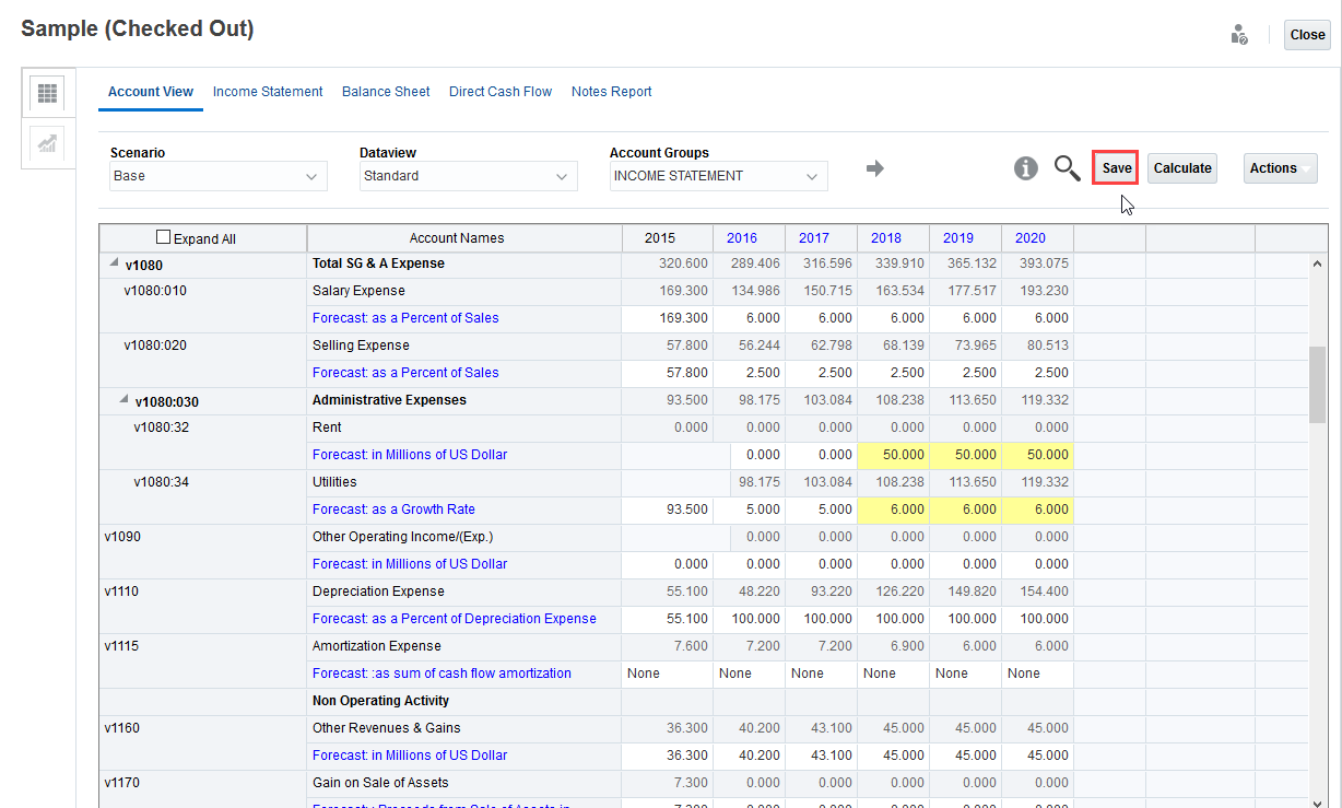

  1. For Rent, enter 50 for 2018, 2019, and 2020.
  2. Enter subaccount data
  3. For Utilities, enter 6 for 2018, 2019, and 2020.
  4. Enter subaccount data
  5. Click Save.
  6. Save changes
  7. Click Calculate and select Current Scenario.
  8. Calculate current scenario
  9. Notice that the subaccount data rolls up to Administrative Expenses, and data for Administrative Expenses rolls up to the main account, Total SG & A Expense.
  10. Subaccount data rolls up
  11. Click Save.
  12. Save changes

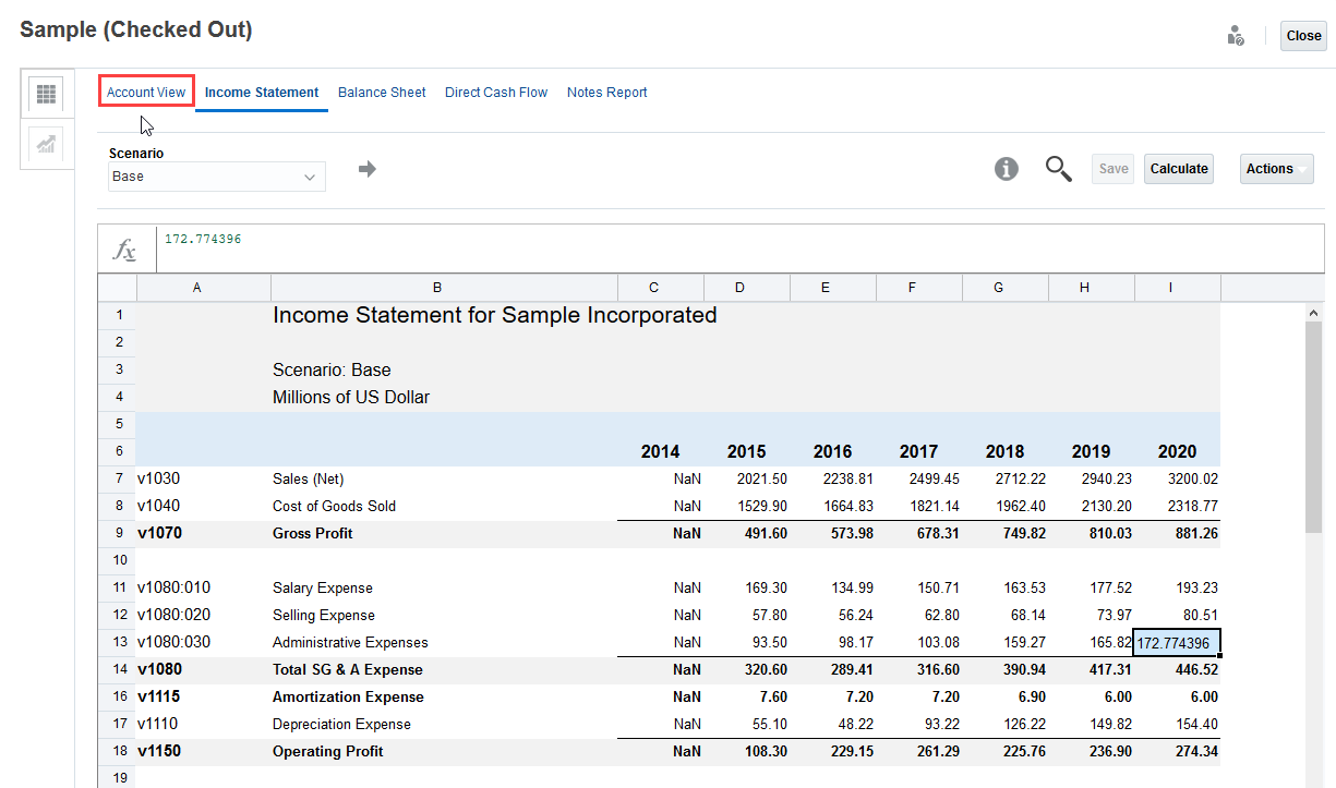

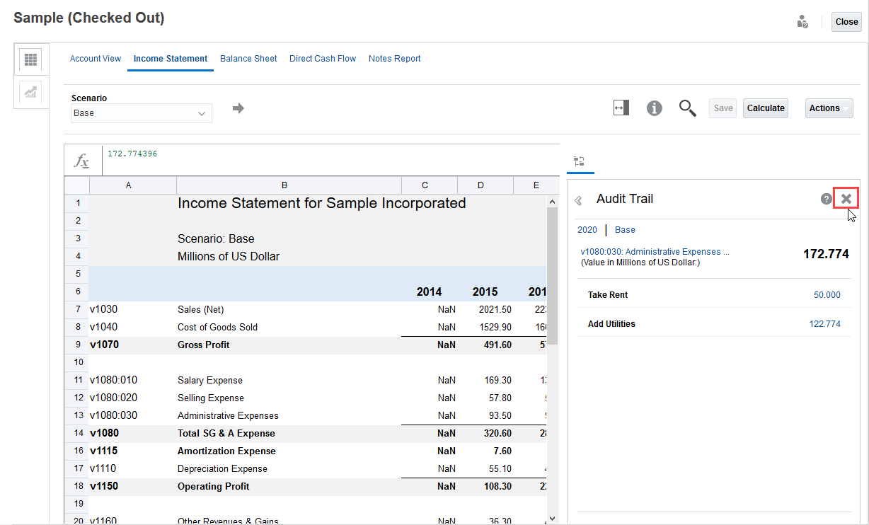

Verifying subaccount data in reports
In this section you verify subaccount data in the Income Statement.
  1. Click the Income Statement tab.
  2. Select Income Statement tab
  3. Right click the 2020 value for Administrative Expenses, and select Audit Trail.
  4. Right-click and select Audit Trail
  5. Notice that the Audit Trail panel displays the subaccount data.
  6. Audit Trail panel displays subaccount data
  7. Click X to close the Audit Trail panel.
  8. Close Audit Trail panel

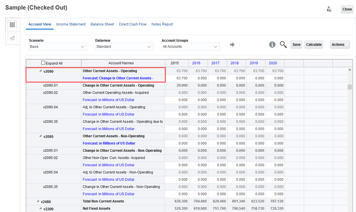

Reviewing subaccounts for Balance Sheet accounts
In this section you review subaccounts for Balance Sheet accounts.
  1. Let’s take a look at an example of subaccounting on the balance sheet. Click the Account View tab.
  2. Open Account View
  3. Change the Account Group to All Accounts and click Refresh Icon (Refresh).
  4. Change Account Group to All Accounts and click Refresh
  5. Scroll to v2040. Notice that Total Inventories includes three subaccounts: Raw Materials, Work in Progress, and Finished Goods. The Raw Materials account has an account number that includes the main account 2040 and the subaccount 10.
  6. View subaccounts for Total Inventories

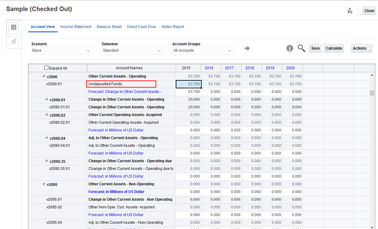

Adding subaccounts to other current assets
In this section you add subaccounts to Balance Sheet accounts.

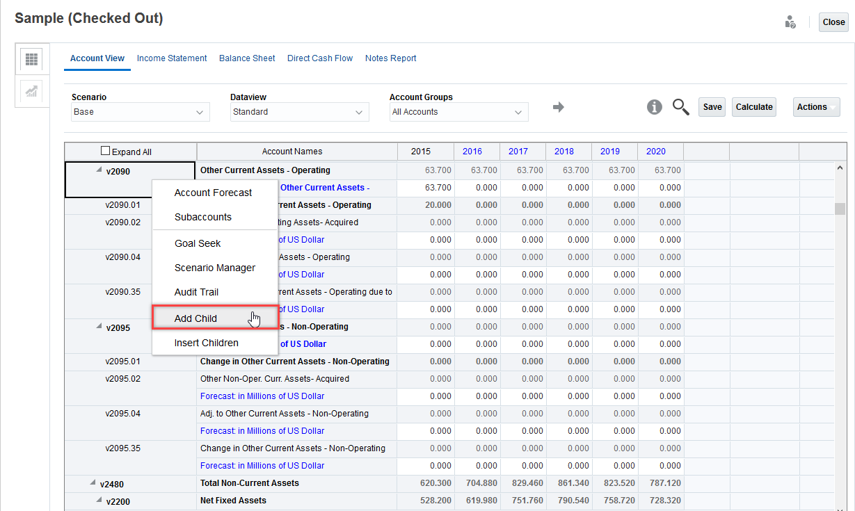

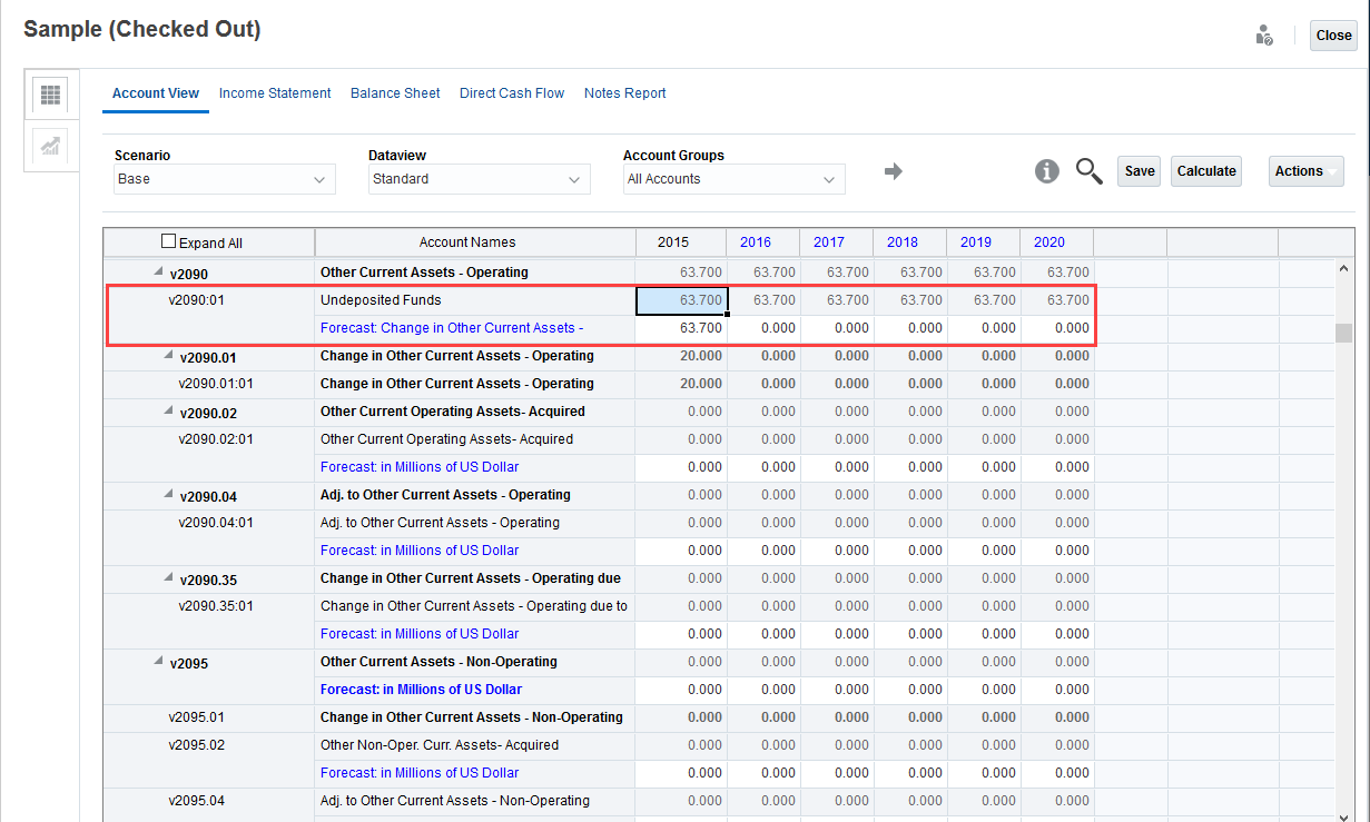

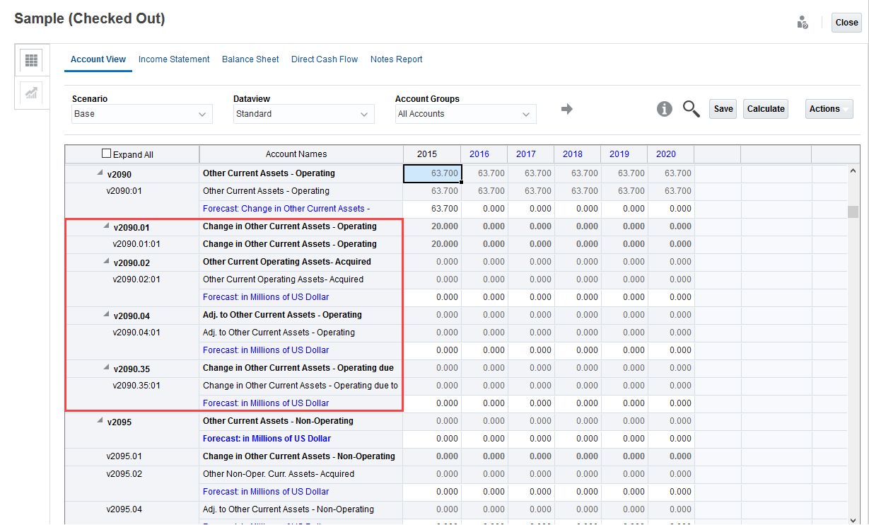

  1. Scroll to v2090 Other Current Assets - Operating.
  2. Select Other Current Assets - Operating
  3. Right-click v2090, and select Add Child.
  4. Add a child
  5. Notice that each related account now has a new subaccount. When you subaccount a financial account that has related accounts, all of the related accounts are subaccounted automatically.
  6. Each related account has a new  subaccount

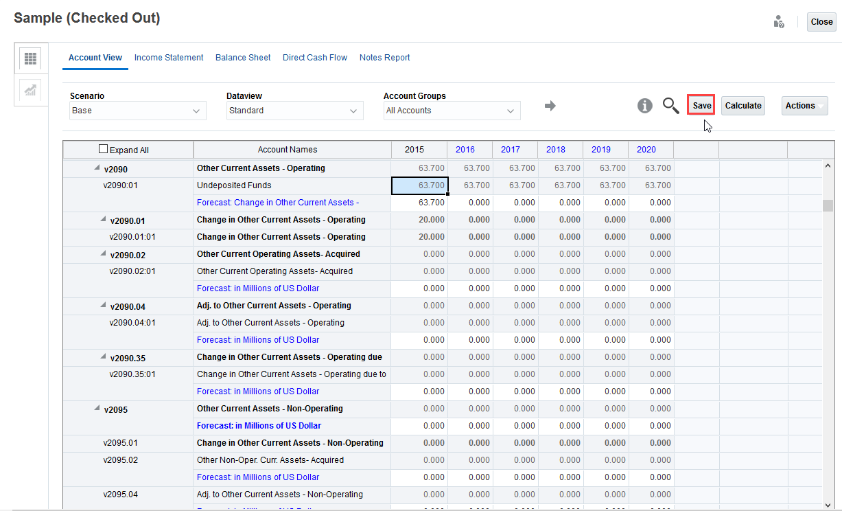

  7. For the v2090:01 row that you just added, enter the Account Name Undeposited Funds to better reflect what the data for this account represents.
  9. Click Save.
  10. Save changes
  11. Notice that the Account Names column now includes Undeposited Funds. Now you can track the part of Other Current Assets that is from undeposited funds separately, while still including its value in the total.
  12. Account Names column now includes Undeposited  Funds
