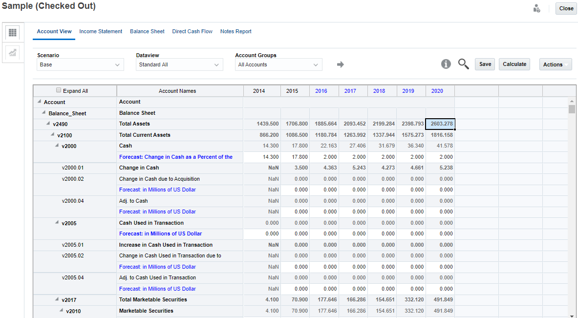

  1. On the Planning home page, click Strategic Modeling then Model View.
    Navigating to Model View in Strategic Modeling
    The Models page is displayed.
  2. For Sample, click (...) Action and select Open-Check Out.
    Actions menu
    When you check out a model, you can save changes to the data and the model. When you work with a copy of a model, you can't save changes to the data or the model
    The model is opened in Account View.
    Account view

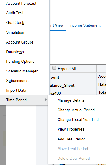

  3. To start managing time period details, click Actions, and then select Time Period.
    Time Period action menu options
    The Time Period menu options include Manage Details, Change Actual Period, Change Fiscal Year End, View Properties, Add Deal Period, and, if a deal period exists, Move Deal Period and Delete Deal Period. You define and manage sub periods, trailing periods, and period-to-date in Manage Details.
  4. Select Manage Details.

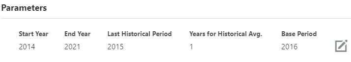

Defining model time period parameters
  1. Click ( Edit ) Edit.
  2. You can add or delete years from the beginning or end of financial model timelines, and set the last historical period, number of years to use for historical averages, and the base period.
  3. Change the end year. From the End Year dropdown list, select 2021.
  4. Click ( Apply ) Apply.
    Changes to the time period parameters were saved.
    Time period parameters
    To apply or commit changes to the model, you must click Apply on the top-right area of the dialog box and run calculations. You will be performing this task in a later section.

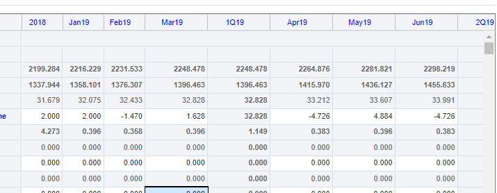

    When you apply your changes, you can select whether to calculate inputs for all scenarios, only for the current scenario, or not to calculate any inputs.
    Calculation options
  2. Accept the default selection: Calculate Inputs for All Scenarios, and click OK.

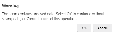

  3. If you are prompted with a warning message regarding unsaved data, click OK.
    Unsaved data warning

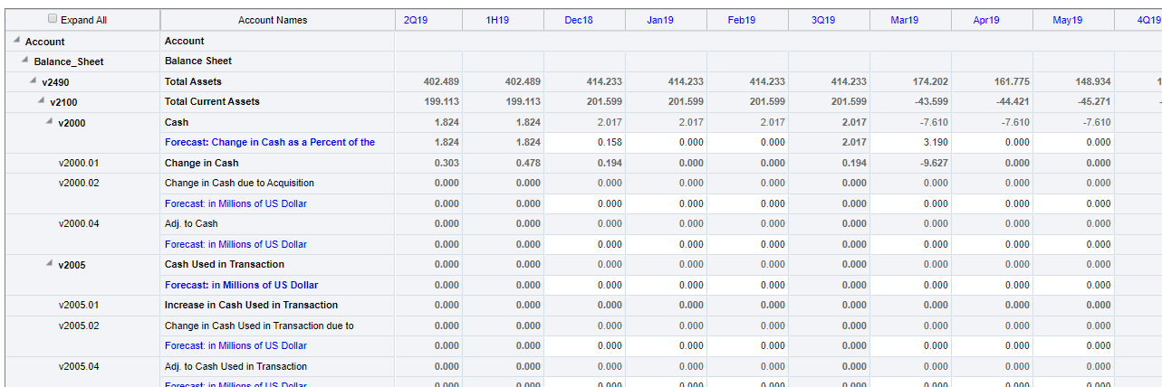

    The added time periods were calculated and displayed in Account view.
    Account view updated with added periods

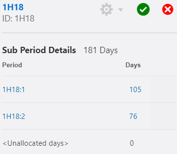

  5. On the right, for 1H18, click ( Setings ) Settings, then select Sub Period .
    Adding sub periods
    Sub Period Details are displayed. You can add sub periods and allocate days until the Unallocated Days is zero.
    Sub period details
  6. Click Add Period.
    The 1H18:1 is added in Sub Period Details.
    The 1H18:1 sub period was added
  7. Double-click in Days for 1H18:1, change the value to 105, and press Enter.
    Allocating days
    Sub periods must be at least one day long.
  8. Create more sub-periods and allocate days until Unallocated Days is zero. Click Add Period.
  9. For 1H18:2, double-click in Days and change it to 76, and then press Enter.
    The final sub period allocation should allocate 105 days to 1H18:1 and 76 days to 1H18:2.
    Sub period allocations

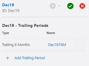

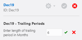

  1. In Account view, click Actions, then select Time Period, and then Manage Details.
  2. Expand 2019, then 2H19, then 4Q19, and then select Dec19.
  3. Click ( Setings ) Settings and select Trailing Period.
  4. Trailing period details are displayed.
  5. Click Add Trailing Period.
  6. For the length of trailing period in Months, enter 6 and click ( Apply ) OK.
    Enter length of trailing period in Months
    Trailing period added
  7. Click ( Apply ) Apply.
  8. Expand Dec19 to verify that the Dec19:T6M trailing period was added.
    Verify that the trailing period was added.

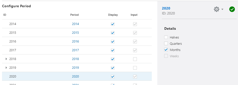

  2. Modify period details for 2020. Select the 2020 row.
  3. In Details, select Months, and click ( ) Apply.
    Adding sub periods
  4. Expand 2020 and verify that monthly periods were added.
    2020 monthly periods

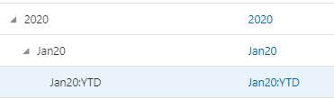

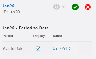

  5. Select Jan20.
  6. In Details, click ( Settings ) Settings and select Period-to-Date.
  7. Click Add Period To Date.
    The Year to Date period is added.
    Ading period to date
  8. Click ( Apply ) Apply.
  9. In Configure Period, expand 2020, and then Jan20 to display the Jan20:YTD period.
    YTD period added

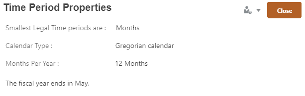

Changing the actual period and fiscal year end
You can change the last actual period and the fiscal year ending month. Change the fiscal year end to specify the end of the fiscal year in models.
Here are some considerations:
  • Changing the fiscal year end results in partial years at the beginning and end of the model. Partial-year data is discarded during conversion. To retain the data, add a year at the end and/or beginning of the model.
  • To retain historical and forecast data in the years, define the years before and after the historical boundary in monthly detail.
  • To ensure accuracy for years containing aggregate values such as year-to-date or trailing periods, make sure there is enough time detail in each year.

  1. In Account view, click Actions, then select Time Period, and then Change Fiscal Year End.
  2. In Change Fiscal Year End Month, select the new fiscal year end month: May.

  4. In Calculation Options, accept default selections and click OK.
    Calculated data is displayed based on updated time periods.
    Updated data based on new fiscal year end month
Viewing time period properties
View Properties displays the model’s smallest time periods available, the calendar type, the number of months per year, and what month the fiscal year ends.
  1. In Account view, click Actions, then select Time Period, and then View Properties.
    Time Period properties
  2. When finished reviewing, click Close.
