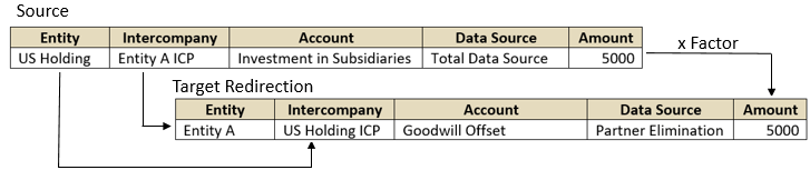

Configurable Consolidation rules with partner eliminations enable you to write data directly to a sibling of the entity currently being consolidated, if the sibling is its intercompany partner, or if one of the sibling’s descendants is its intercompany partner.
In the example, US Holding has an investment in Company A, its sibling, recorded in the Investment in Subsidiaries account, with Company A as the intercompany partner member. Using partner elimination, the value in the Investment in Subsidiaries account for US Holding is written to Company A's Goodwill Offset account, with US Holding as the intercompany partner member.
Example
Note that if the intercompany partner is a descendant of a sibling, rather than a sibling, the data is written to the sibling, not to the descendant.

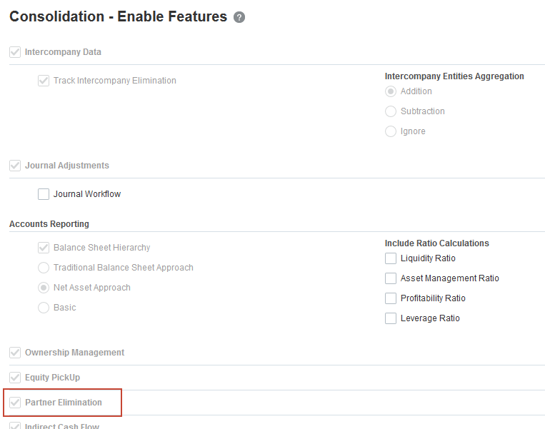

Verifying the feature is enabled
You enable Partner Elimination for consolidation rules using the Setup Wizard during business process creation, or from the Configuration page afterward. Enabling the feature adds the Partner Elimination member to the Data Source dimension. In order to enable Partner Elimination, the Track Intercompany Elimination and Ownership Management features must also be enabled.

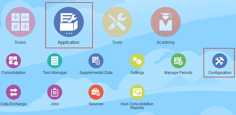

  1. From the Home page, click Application, then Configuration.
    Configuration Card

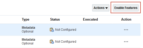

  2. Click Enable Features.
    Enable Features button
  3. Verify that Partner Elimination is selected in the Accounts Reporting area.
    Enable Features dialog box
  4. Click Close to return to the Application Overview page.

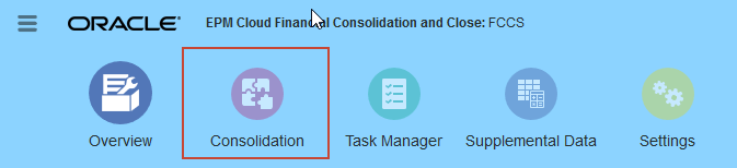

  1. Click Consolidation.
    Consolidation Card

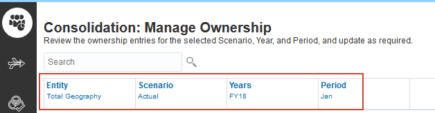

  2. Verify that the POV is set to Total Geography, Actual, FY18, Jan.
    Ownership Management POV

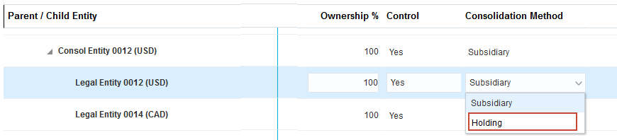

  3. In the row for Legal Entity 0012 (USD), select Holding in the Consolidation Method list.

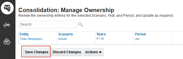

  5. Click Save Changes.
    Save Changes button

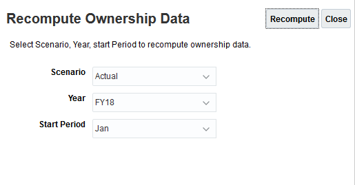

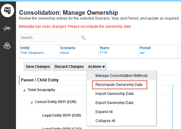

  7. On the Manage Ownership page, select Actions, and then Recompute Ownership Data.
    Recompute Ownership Data option
  8. Make the selections below, then click Recompute.
    • Scenario: Actual
    • Year: FY18
    • Start Period: Jan
    recompute ownership
  9. When completed, click OK.

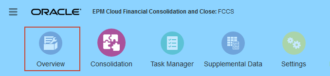

  1. Click Overview to open the Application Overview page.
    Overview card

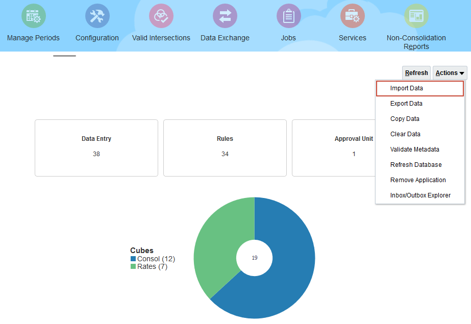

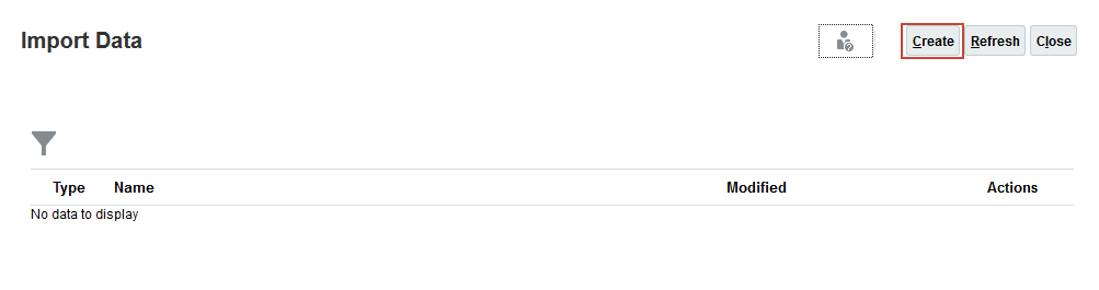

  2. On the Application Overview page, click Actions, and then select Import Data.
    Actions Menu
  3. In Import Data dialog, click Create.
    Create Button

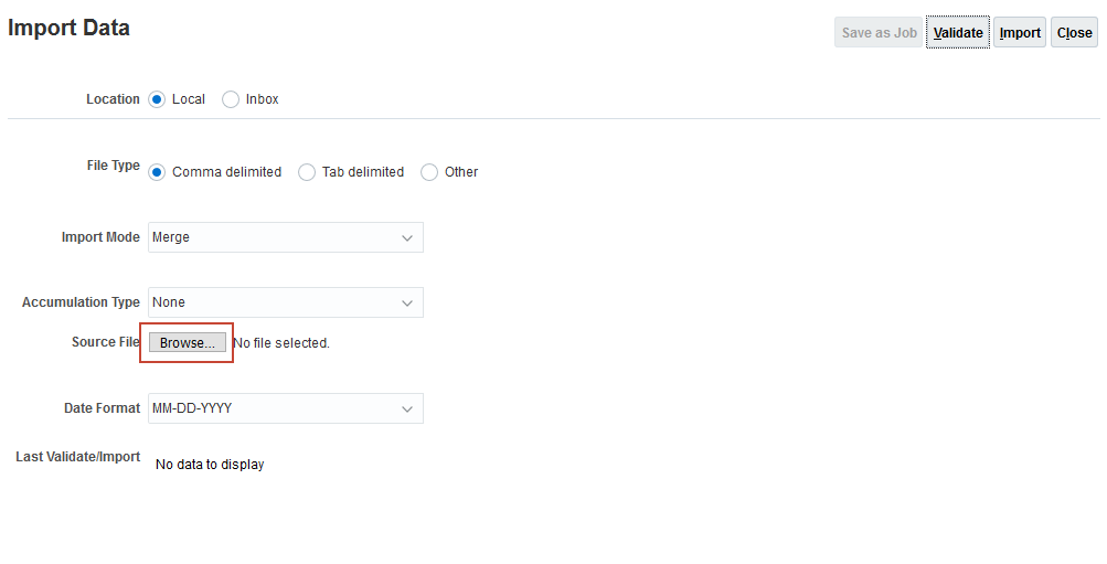

  4. Keep all the default selections, and click Browse to select a file.
    Browse Button

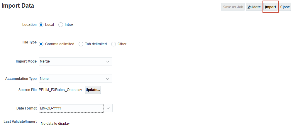

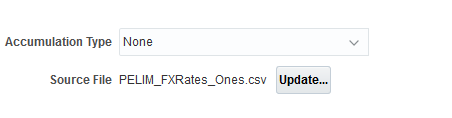

  5. Locate and select FXRates_Ones.csv, and click Open.
  6. Click Import.
    Import Button

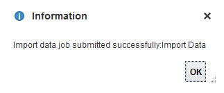

  7. At the information dialog, click OK.
    Information Prompt

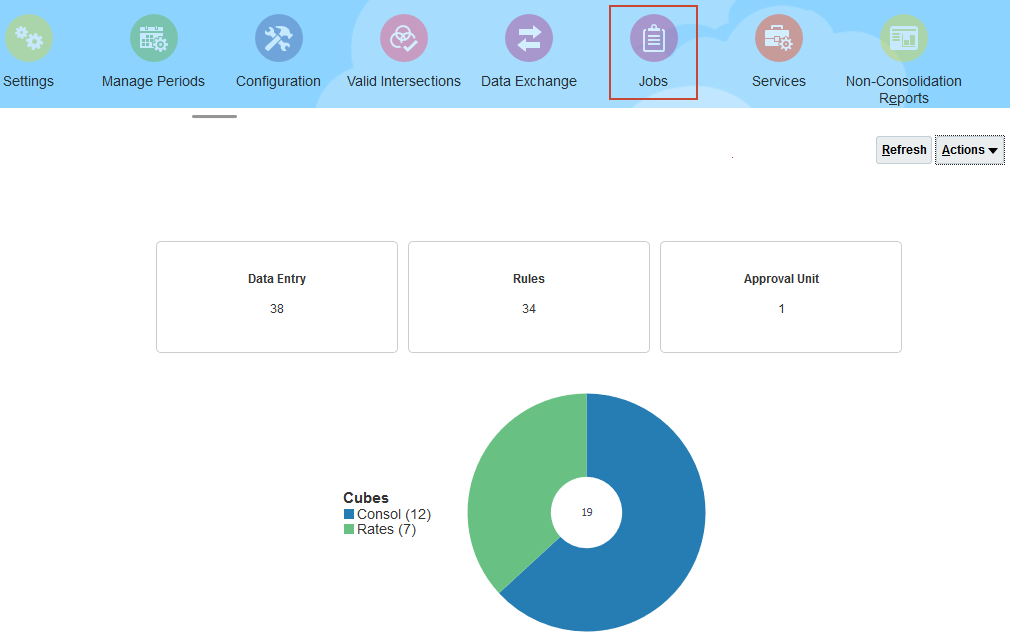

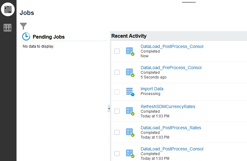

  13. Click Jobs.
    Jobs Icon
  14. Verify that the jobs completed successfully.
    Jobs Page

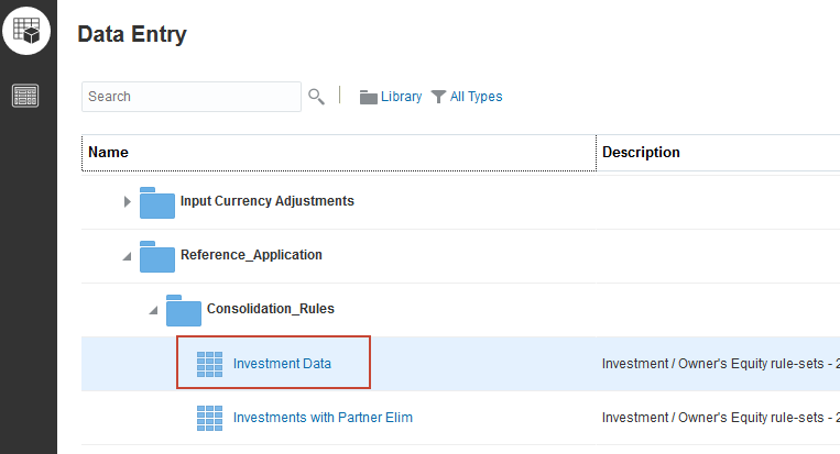

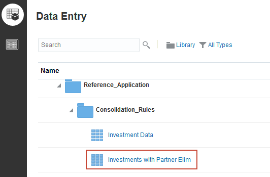

  17. Open the Reference_Application folder, then the Consolidation_Rules folder, and click Investment Data.
    Forms list
  18. Review the data.

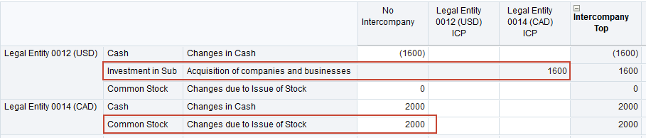

    Legal Entity 0014 has issued 2000 in Common Stock. Legal Entity 0012 has invested 1600 in Legal Entity 0014, recorded in the Investment in Sub account with Legal Entity 0014 as the partner. This represents an 80% ownership share.
    Consolidation Results
  19. Click Close to close the form and return to the forms list.

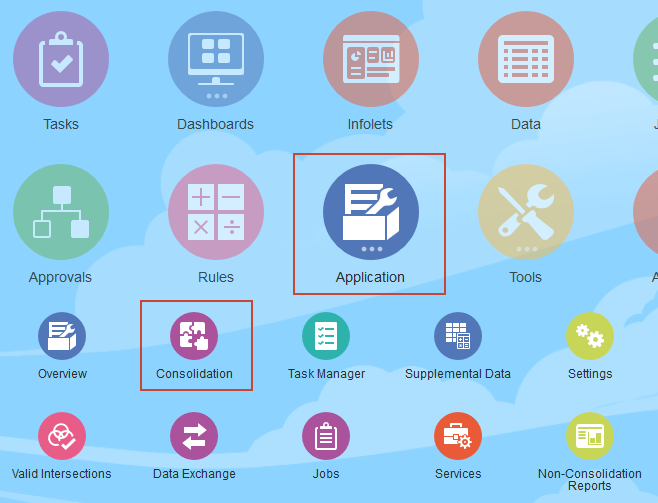

  1. On the Home page, click Application, and then Consolidation.
    Consolidation card

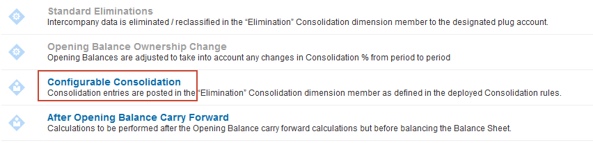

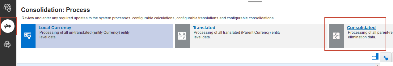

  2. Click the Consolidation Process vertical tab to display the Consolidation Process page, then click Consolidated.
  3. Click Configurable Consolidation to open the Manage Consolidation Rules dialog box.
    Configurable Consolidation option

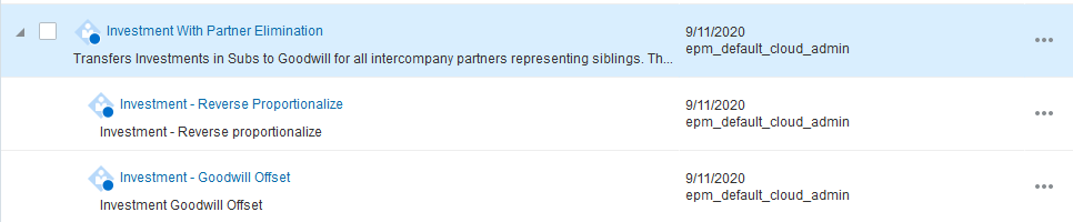

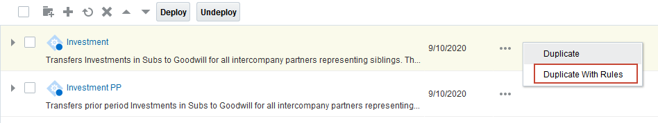

  4. Click the ellipsis for the Investment rule-set, then select Duplicate With Rules.
    Duplicate With Rules option

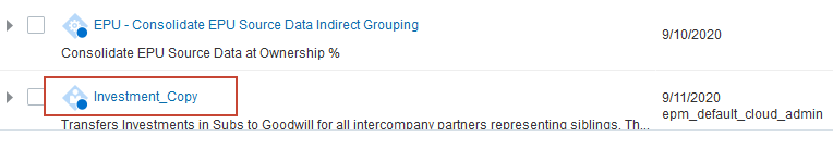

  5. Scroll to the bottom of the rule-set list and click Investment - Copy.
    Investment - Copy rule-set

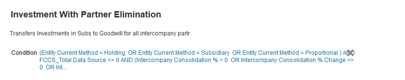

  6. Change the name of the rule-set to Investment With Partner Elimination.
    Rule-set name field

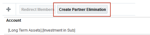

  7. Click Create Partner Elimination to enable partner eliminations for the rules in the rule-set. Note that the Entity dimension is added to the scope. The Entity, Intercompany, and Data Source dimensions are required in the scope for partner elimination rules.
    Create Partner Elimination button
  8. Click Save and Close to return to the rule-set list.

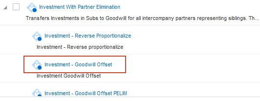

  1. In the rule-set list, expand the Investment With Partner Elimination rule-set.
    If your cannot see the new rule-set in the list, expand the last rule-set in the list and then scroll.

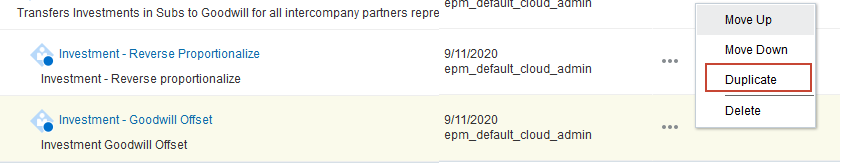

  2. Click the ellipsis for the Investment - Goodwill Offset rule and select Duplicate.
    Create Rule icon
  3. Click Investment - Goodwill Offset_Copy to open the copy and change the rule name to Investment - Goodwill Offset PELIM.

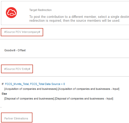

  4. Click Enable Partner Elimination.
    Enabling partner elimination adds the Source POV Intercompany keyword as the target redirection for Entity. This redirects the target for the Entity dimension to the intercompany partner entity of the source. The Source POV Entity keyword is added as the target redirection for Intercompany. This redirects the target for the Intercompany dimension to the Source entity member. The Data Source member is redirected to Partner Eliminations. The selections for Entity, Intercompany, and Data Source cannot be modified.

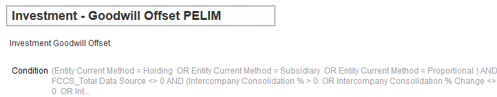

  1. In the Investment with Partner Eliminations rule-set, click Investment - Goodwill Offset to open the rule.

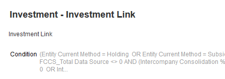

  2. Change the name of the rule to Investment - Investment Link and the description to Investment Link.
    Rule Name

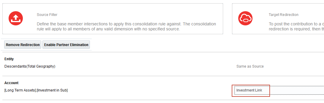

  3. In the Target Redirection area for Account, replace Goodwill Offset with Investment Link. You can enter the member name or browse to select it from a list.
    Account Redirection

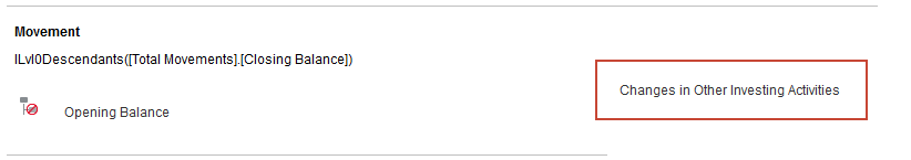

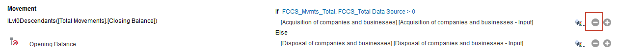

  4. In the Target Redirection area for Movement, click minus (-) to remove the existing condition.
    Remove button
  5. Replace the existing value with Changes in Other Investing Activities.
    Movement Redirection

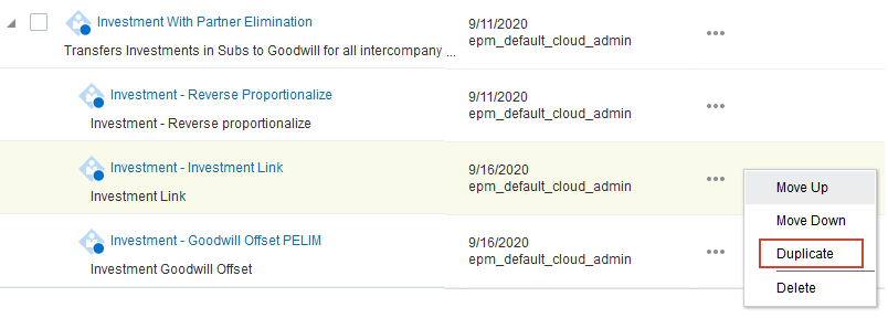

  7. Click the ellipsis for the Investment - Investment Link rule and select Duplicate.
    Duplicate Option
  8. Click Investment - Investment Link_Copy to open the duplicate and change the rule name to Investment - Investment Link PELIM.
    Rule Name

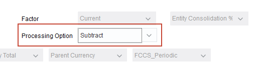

  9. In the Processing Option list, select Subtract.
    Processing Option

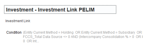

  10. Click Enable Partner Elimination.
    In the Target Redirection area, the Source POV Intercompany and Source POV Entity keywords are added, and the Data Source member is set to Partner Eliminations.
  11. Click Save and Close to return to the rule-set list.

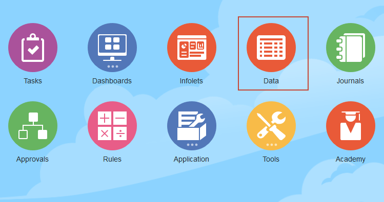

  1. From the Home page, click Data.
    Data card

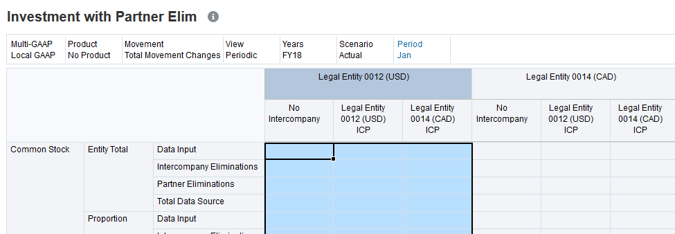

  2. Open the Reference_Application folder, then the Consolidation_Rules folder, and click Investments with Partner Elim.
    Forms list
  3. In the data form, select the column for Legal Entity 0012 (USD).
    Legal Entity 12 column

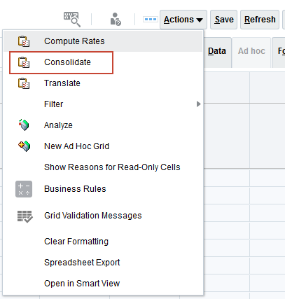

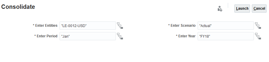

  4. From the Actions menu, select Consolidate.
    Actions Menu
  5. Verify the following member information in the Consolidation dialog box, and then click Launch.
    • Entity: LE-0012-USD
    • Scenario: Actual
    • Period: Jan
    • Year: FY18
  6. At the Information dialog box, click OK.

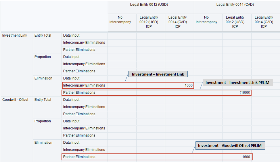

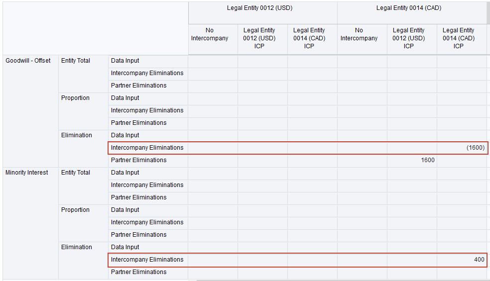

  7. Scroll the rows to review the data for Investment Link and Goodwill Offset.
    Note that the consolidation process for Legal Entity 0012 wrote data to both Legal Entity 0012 and its partner, Legal Entity 0014. The Investment - Investment Link rule wrote the value for Legal Entity 0012 > Investment in Sub > Legal Entity 0014 ICP to Legal Entity 0012 > Investment Link > Legal Entity 0014 ICP > Intercompany Eliminations. The Investment - Investment Link PELIM rule used partner elimination to write a reversing entry to the subsidiary: Legal Entity 0014 >Investment Link > Legal Entity 0012 ICP > Partner Eliminations. The Investment - Goodwill Offset PELIM rule used partner elimination to write the value for Legal Entity 0012 > Investment in Sub > Legal Entity 0014 ICP to the Investment Link account of the subsidiary: Legal Entity 0014 > Investment Link > Legal Entity 0012 ICP > Partner Eliminations.

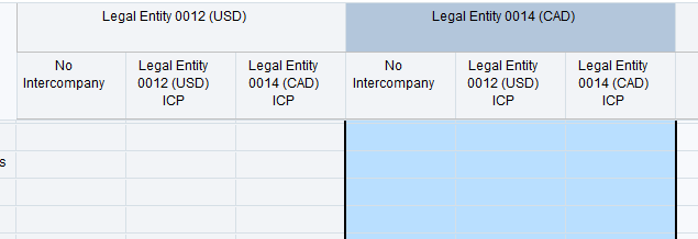

  8. In the data form, select the column for Legal Entity 0014 (USD).
    Consolidation Entity 12 column
  9. Repeat steps 4 to 6 to consolidate Legal Entity 0014 (CAD).
  10. Review the consolidation results.
    For Legal Entity 0014, the Owners Equity - Goodwill Offset rule in the Owners Equity (Subsidiary/Proportional) rule-set applied the holding company's ownership percentage to Total Equity, and wrote the amount to the Goodwill Offset account. The sign was reversed because the rule is posting from an Equity account to an Asset account. This offsets with the entry written to Legal Entity 0014's Goodwill Offset account by the partner elimination from Legal Entity 0012. The Minority Interest rule in the same rule-set applies the minority interest ownership percentage to Total Equity and writes it to the Minority Interest account.
