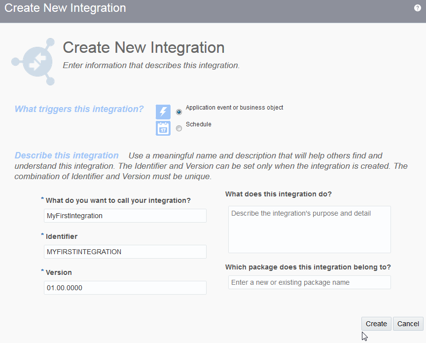

  3. In the upper right corner, click Create.
  4. Select Orchestration as the pattern to use. The Create New Integration dialog is displayed.
  5. In the What do you want to call your integration? field, enter MyFirstIntegration, then click Create.
    Description of the illustration create_new_integration
The integration canvas is displayed. You are now ready to design your first integration.

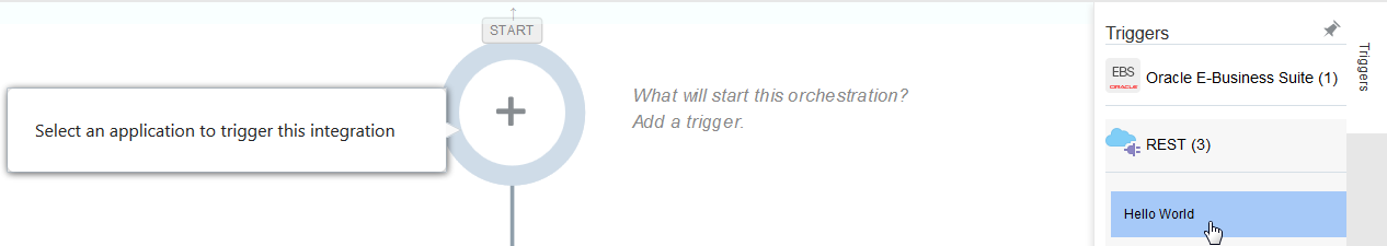

  1. In the right navigation pane, click Triggers.
  2. Click REST, then drag the Hello World connection to the + sign.
    Description of the illustration rest_adapter_drag

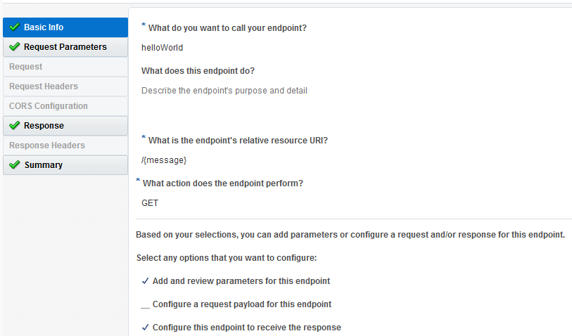

  3. On the Basic Info page, enter the following details, then click Next:
    Field Description
    What do you want to call your endpoint? helloWorld
    What is the endpoint's relative resource URI? /{message}
    What action does the endpoint perform? GET
    Select any options that you want to configure Select the following:
    • Add and review parameters for this endpoint
    • Configure this endpoint to receive the response
    Description of the illustration rest_adapter_basic

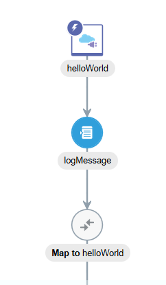

  10. In the right navigation pane, click Actions.
  11. Drag a Logger action immediately below helloWorld. A + sign is displayed.
  12. Place the Logger action inside the + sign. The Create Action dialog is displayed.
  13. In the Name field, enter logMessage, then click Create.
  14. In the Log section, click Always.

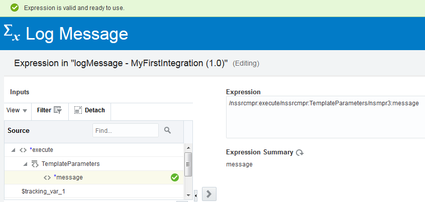

  15. In the Logger Message section, click the Edit icon.
    Description of the illustration logger_expression
  16. Select the message element in the Source tree and  click the > sign. The syntax /nssrcmpr:execute/nssrcmpr:TemplateParameters/nsmprnumber:message is displayed in the Expression field.
  17. Click the Refresh icon to the right of Expression Summary. The message element is displayed.
  18. Click Validate to show a message at the top indicating that the expression is valid, then click Close.
    Description of the illustration logger_syntax
  19. Click Close to return to the integration canvas.
    Description of the illustration integration_partial

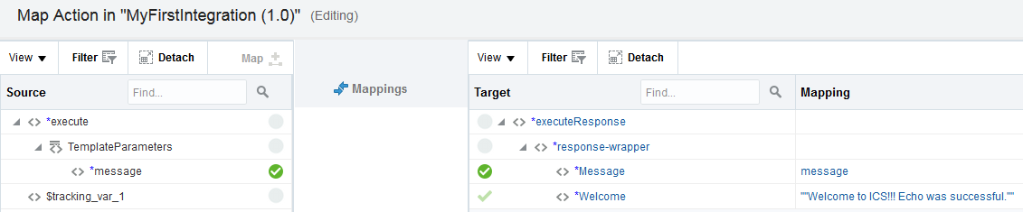

  20. Click the Map to helloWorld icon, then click the Edit icon. The mapper is displayed. The mapper enables you to map the source data structure to the target data structure.
  21. In the Source section, drag the message element to the Message target element. A green line connecting the two elements is displayed.
    Description of the illustration mapper_mapping
  22. In the Target section, click the Welcome element. The Build Mappings page is displayed.
  23. Replace -- Drag and Drop or Type value here... with the following text: "Welcome to ICS!!! Echo was successful."
  24. Click Save, then click Close to return to the mapper.
  25. Click Validate. The following message is displayed: Mapping is valid and ready to use.
  26. Click Close, then click Apply if prompted to apply your changes before exiting.

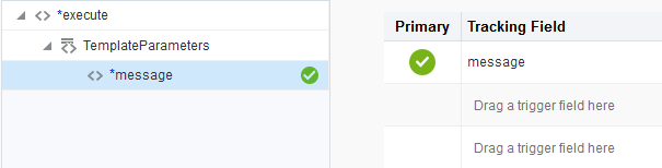

  27. From the Actions menu in the upper right, select Tracking. Business identifiers enable runtime tracking of messages.
    Description of the illustration tracking_action
  28. In the Source section, drag the message element to the first row of the Tracking Field column, then click Save.
    Description of the illustration business_id

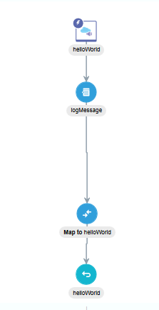

  29. View the completed integration.
    • A REST Adapter is configured as a trigger (inbound) connection to invoke the integration.
    • A logging message is created and logged to the activity stream. A browser response is sent to you.
    • A mapper is configured to map the source and target data structures.
    Description of the illustration designed_integration
  30. Click Save, then click Close. Design is now complete.
