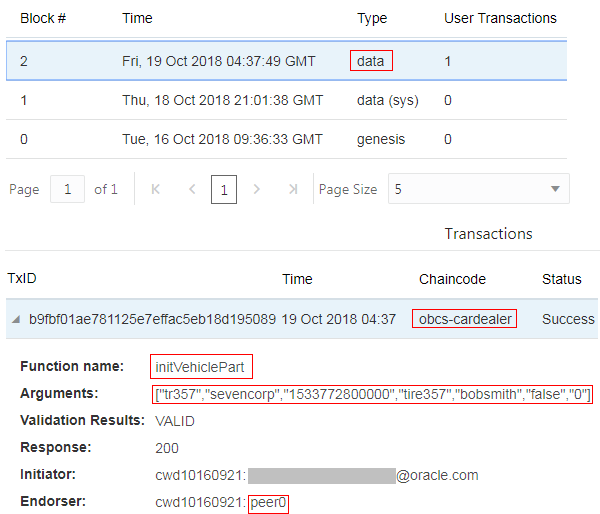

- On the Invoke Chaincode window, create a tire using the
following information, and click then Execute:
- Channel:
default - Action:
Produce vehicle part - Serial Number:
tr357 - Owner:
bobsmith - Name:
tire357 - Assembler:
sevencorp - Assembly Date:
08/09/18
Description of the illustration invoke-create-part.png - Channel:
- On the Channels tab, locate and click the
defaultchannel. - Open the Ledger pane, and locate the block number indicating that a data invocation occurred.
- Select the block, and confirm that in the Transactions table
you see
Successin the Status column. - Click the arrow icon beside the transaction ID to display
more information about the transaction.
Because you're invoking the Car Dealer chaincode, the
obcs-cardealerchaincode is listed in the transaction. The function name isinitVehiclePartbecause you've created a new part, and the transaction is endorsed bypeer0because that's the only peer you have chosen to endorse transactions on this channel. - On the Developer Tools tab, open the Samples pane, locate the Car Dealer sample, and click Invoke.

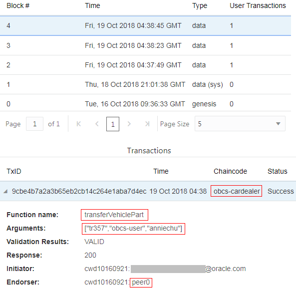

readVehiclePart), and endorsing peer (peer0) should be listed. - On the Developer Tools tab, open the Samples pane, locate the Car Dealer sample, and click Invoke.
- On the Invoke Chaincode window, enter the following values
to transfer the ownership of the tire to a new user, and then
click Execute:
- Channel:
default - Action:
Transfer vehicle part - Serial Number:
tr357 - Owner:
anniechu
- Channel:
defaultchannel. - Open the Ledger pane, and locate the block number of the most recent transaction.
- Click the block, click the arrow icon next to the
transaction ID to display more information about the
transaction, and confirm that in the Transactions table you
see
Successin the Status column.The correct chaincode, function name (
transferVehiclePart), and endorsing peer (peer0) should be listed.
