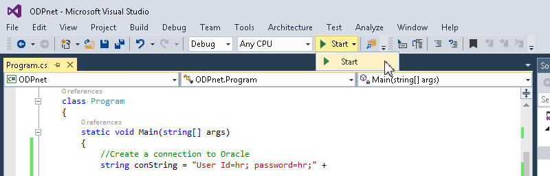

  10. Click the Start button or press the F5 key to run the application.
    ODPnet
    Description of this image

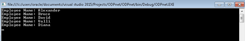

  11. Observe the output. The list of employees in department '60' is displayed in the console.
    ODPnet
    Note: Close the command prompt to stop the application.

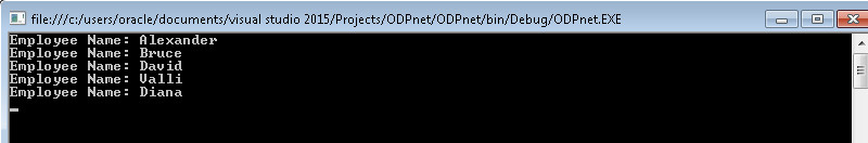

  4. Click the Start button or press the F5 key to run the application.
    ODPnet
  5. Observe the output. The list of employees in department '60' is displayed in the console.
    ODPnet

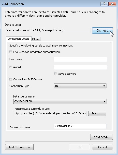

  4. The Add Connection dialog box opens. If Data Source is not already set to Oracle Database (ODP.NET, Managed Driver), click Change...
    ODPnet
  5. In the Change Data Source dialog box, select Oracle Database as the Data Source and ODP.NET, Managed Driver as the Data Provider. Click OK. This step is required only if Data Source is not already set to Oracle Database (ODP.NET, Managed Driver).
    ODPnet
  6. Enter the following details in the Add Connection dialog box and click OK.
    • User name: HR
    • Password: HR
    • Data source name: ORCL
    ODPnet
    Note: The connection information may be different for your specific database setup.
  7. Expand the Data Connections. Observe HR.ORCL under it.You can now use ODP.NET, Managed Driver to browse and modify the HR schema.

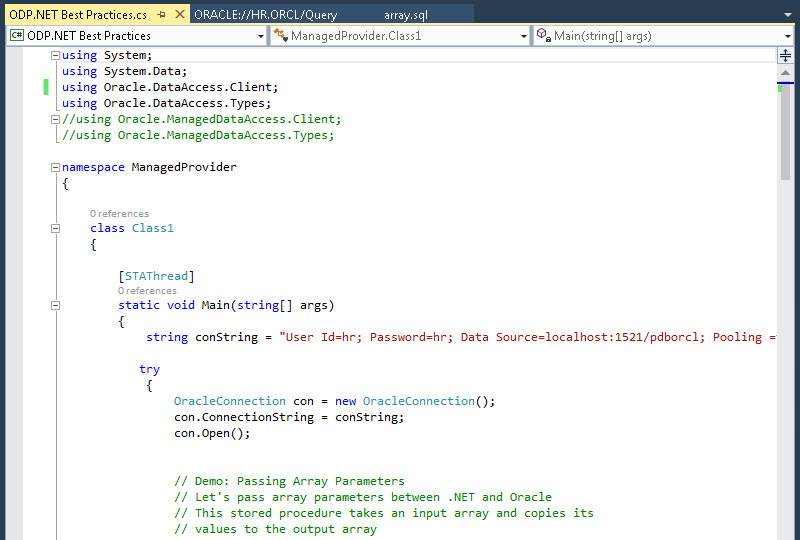

  1. Open Solution Explorer. Double click on ODP.NET Best Practices.cs to open it.
    ODPnet
  2. Observe the screen. The ODP.NET Best Practices.cs file opens up. Review the code. Review the connection string.
    ODPnet
    Note: The data source name mentioned in the connection string is pdborcl. You should change it to the data source name that you are using. The first part of the demo uses the MYPACK.MYSP stored procedure we created previously. It first creates an input array parameter and an output array parameter before executing the stored procedure. Finally, it shows the output array's values in the console. The second part of the demo shows how to use batch SQL, REF Cursors, and multiple active result sets from ODP.NET. As you can see, the code uses advanced ODP.NET features. You will migrate this code to ODP.NET, Managed Driver to show that you can use these features from the managed driver.
  3. Click the Start button or press the F5 key to run the application. Observe the output. This will demonstrate that the code runs successfully with the unmanaged driver.
    ODPnet

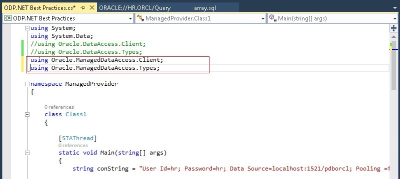

  7. Uncomment the following lines of code. These namespaces specify that the application uses ODP.NET, Managed Driver.
    using Oracle.ManagedDataAccess.Client;
    using Oracle.ManagedDataAccess.Types;
    ODPnet

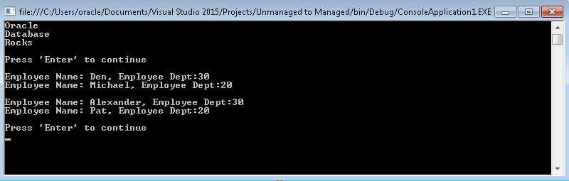

  8. Click the Start button or press the F5 key to run the application. Observe the output. This will demonstrate that the code runs successfully with the managed driver.
    ODPnet
    Note: The results when running with ODP.NET, Managed Driver will be exactly the same as when you earlier ran with ODP.NET, Unmanaged Driver.
