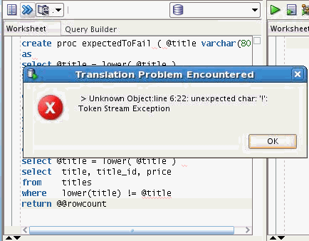

In this tutorial, the sample database has been seeded with one procedure that fails to convert. The following steps outline how to go about identifying the issue and complete its conversion. The steps used here are the same for any type of conversion failure.

Select Tools > Migration > Translation Scratch Editor.
Paste the copied text from the expectedToFail procedure in the left side text box.
Click the drop-down list and select Sybase T-SQL To PL/SQL.
Also, select the project model from the drop-down list.
Click Translate
You get an error as expected. Click OK
Commenting out statements until the procedure translates will help
you identify the problematic statement. In this case there is a new
line between the bang and equals -"where lower(title) != @title".
A quick solution would be to remove the space, but a more generic approach
for all issues would be to comment out the clause with a TODO comment.
Then manually replace it once in Oracle. Now, fix the bug and click
Translate
