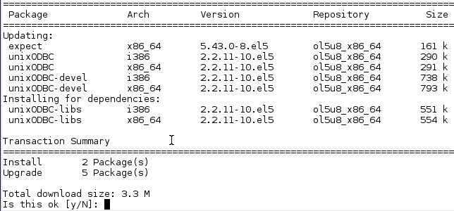

Update all packages:
yum update -
When prompted for confirmation, enter y.

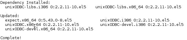

Verify that the packages were successfully updated.
