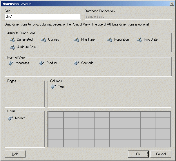

In Reporting Studio, create a report and insert a grid. In this example, you select the Essbase database connection, Sample:Basic, add the Market dimension to the rows, and the Year dimension to the columns.

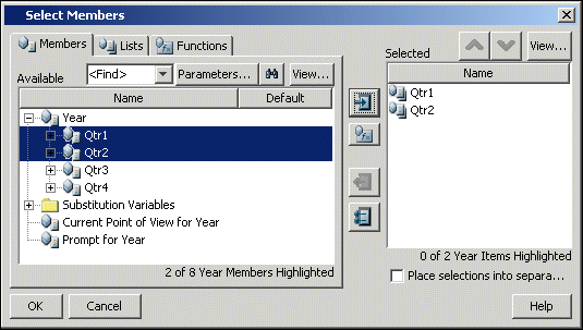

For the Year dimension in column A, select Qtr1 and Qtr2.

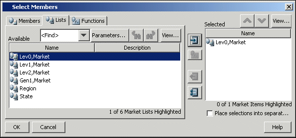

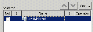

For the Market dimension in row 1, select the Lev0,Market list to display all the level 0 members of the Market dimension.

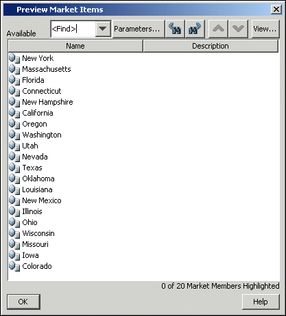

In the Selected area of the Select Members dialog box, click the View button, and select Preview.
The Preview Market Items window displays a list of the 20 level 0 members of the Market dimension. These members have small, medium, or large populations.
Click OK to return to the Select Members dialog box. In the Selected area, click the View button, and select Advanced.

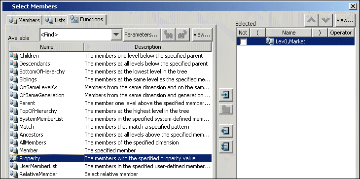

In the Select Members dialog box, select the Functions tab, and select the Property function.

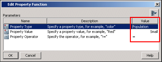

Add the Property function to the Selected area. In the Edit Property Function dialog box, select the options listed in the following table:

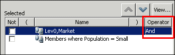

Click OK to return to the Select Members dialog box. In the Selected area, change the Boolean operator from Union to And.

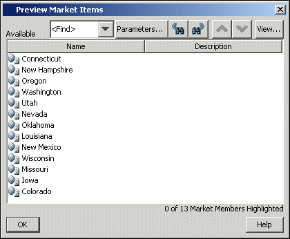

In the Selected area, click View, and select Preview. The Preview Market Items dialog box displays the 13 level 0 members that have a small population.

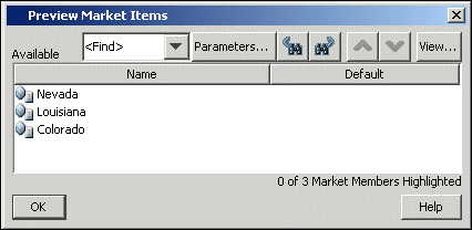

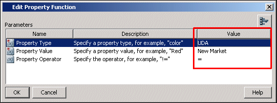

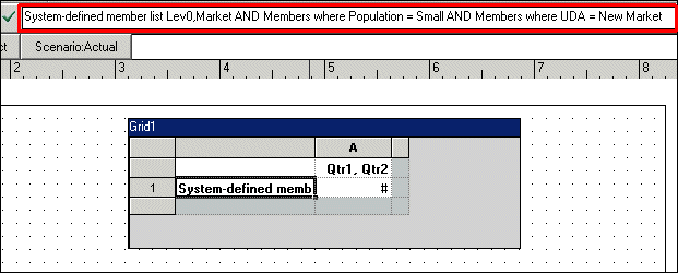

Click OK to return to the Select Members dialog box. From the Functions tab, select the Property function and add it to the Selected area. In the Edit Property Function dialog box, select the options listed in the following table:
Click OK to return to the Select Members dialog box. In the Selected area, change the Union Boolean operator to And.
In the Selected area, click View, and select Preview. The Preview Market Items dialog box displays the 3 level 0 members that have a small population and are new markets.
Click OK twice to return to the report workspace. With the row heading selected, the member selection is displayed in the formula bar.
In the user POV bar, set the Point of View to the members listed in the following table:
Preview the report to display the 3 level 0 members that have a small population and are new markets.

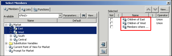

You continue to work with the same report. You modify the advanced member expression to specify that one of two conditions must be met. You select Market members that are children of East or children of West. You also specify that the members must have a small population.
To populate a grid with the AND and OR Boolean operators in expressions, perform the following steps:

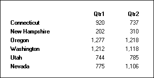

For the Market dimension in row 1, open the Select Members dialog box. From the Selected area, remove the Lev0,Market member and the Members where UDA = New Market member. From the Available area, add Children of East and Children of West to the Selected area. Position the selected members in the following order:

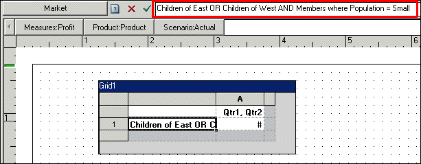

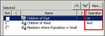

In the Selected area, to the right of Children of East, change the Boolean operator from Union to Or. To the right of Children of West, change the Boolean operator from Union to And. This expression selects the children of East or children of West that have a small population.
In the Selected area, click View, and select Preview. The Preview Market Items dialog box displays the 6 members that are the children of East or West and have a small population.
Click OK to close the Select Members dialog box. With the row heading selected, the member selection displays in the formula bar.
Preview the report to display the 6 East or West children that have a small population.

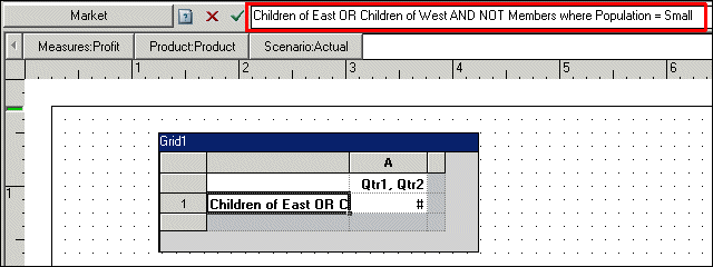

You continue to work with the same report. You modify the advanced member expression to specify the inverse of one condition. The Market members must be children of East or children of West, and the members must not have a small population.
To populate a grid with the NOT Boolean operator in expressions, perform the following steps:

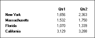

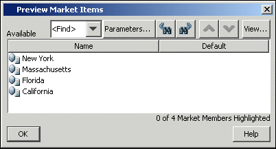

For the Market dimension in row 1, open the Select Members dialog box. In the Selected area, to the left of Members where Population = Small, select the Not check box. This expression selects the children of East or children of West that do not have a small population.
In the Selected area, click View, and select Preview. The Preview Market Items dialog box displays the 4 members that are children of East or children of West, and do not have a small population. These members have a medium or large population.
Click OK to close the Select Members dialog box. With the row heading selected, the member selection is displayed in the formula bar.
Preview the report to display the 4 East or West children that do not have a small population.
