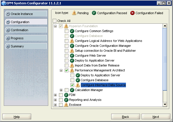

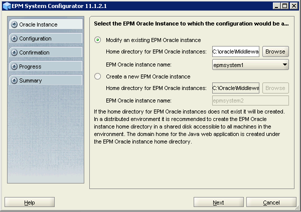

Start EPM System Configurator.
On the Oracle Instance page, accept the default selections and click Next.

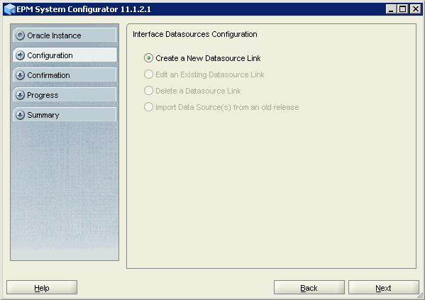

On the Configuration page, perform the following actions:
Ensure that Create a New Datasource Link is selected, click Next.
Select the database type for your interface table, and click Next. In this example, Oracle is selected.

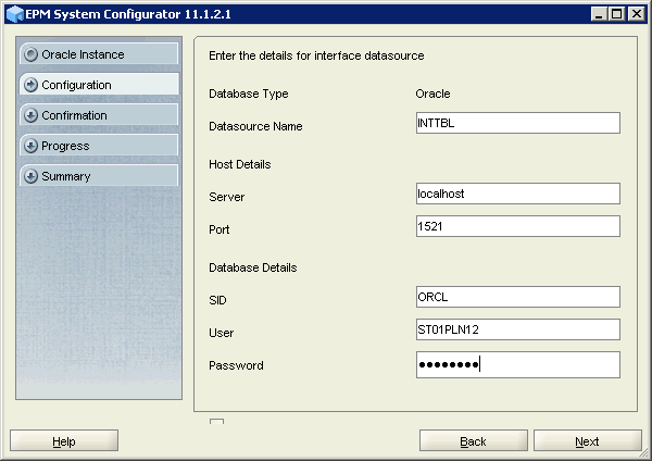

Enter the connection details for your interface data source:
Click Next.

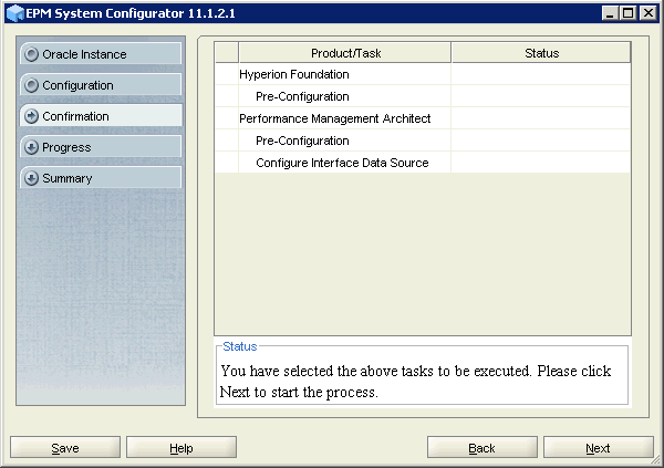

Review the contents of the Confirmation page and click Next.

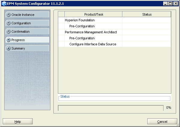

The configuration takes a few minutes.

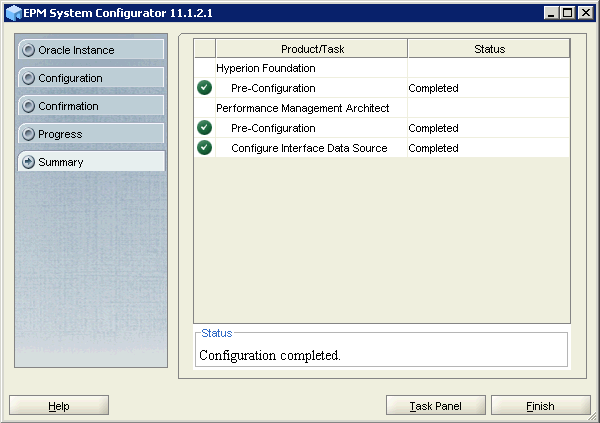

A status of Completed is displayed if the configuration ran successfully.
Click Finish.

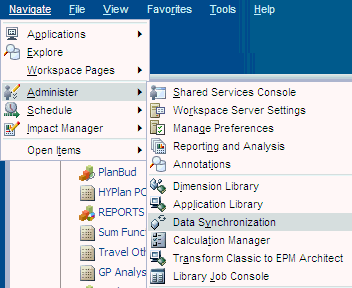

Select Navigate, then Administer, and then Data Synchronization.

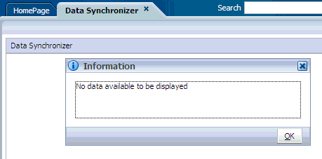

Data Synchronizer is displayed.
If you are prompted that no data is available to be displayed, click OK.

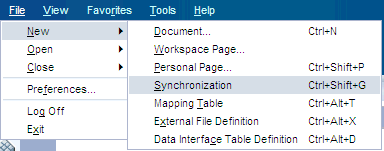

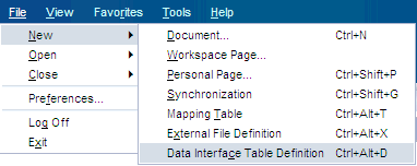

In Data Synchronizer, select File, then New, and then Data Interface Table Definition.

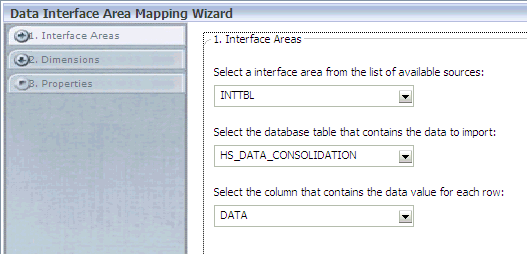

On the Interface Areas page of Data Interface Area Mapping Wizard, perform the following actions:

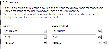

On the Dimensions page, select the columns (dimensions) that you want to map, and enter a display name for each entry. Click the Add New Row icon to the right of each row to insert additional rows. In this example, the Scenario, Year, and Period dimensions are selected.

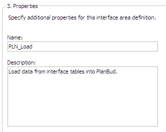

On the Properties page, enter a name and description for the interface area and click Finish.

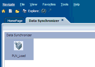

The data interface area is displayed in Data Synchronizer.

In Data Synchronizer, select File, then New, and then Synchronization.
New Synchronization Wizard is displayed.

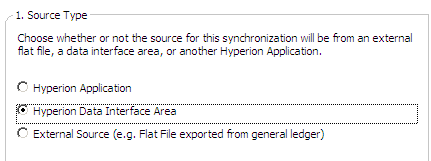

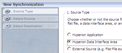

On the Source Type page, select Hyperion Data Interface Area and click Next.

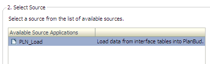

On the Select Source page, select an interface area and click Next.

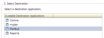

On the Select Destination page, select a Planning application and click Next.

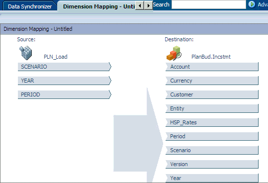

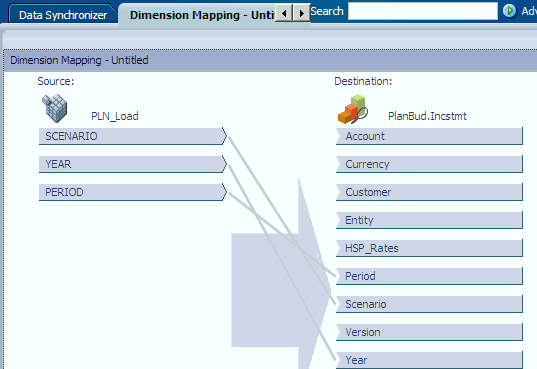

The Dimension Mapping page is displayed.
After you create a synchronization, you must map the dimensions that comprise each source and destination.
You use Dimension Mapping to create, modify, or delete links between source and destination dimensions. Data Synchronizer automatically links common dimensions between applications. You can drag and drop to dynamically create or change links between source and destination dimensions. When defining a detailed synchronization, you can create links, leverage a predefined mapping table, or assign default values to dimensions that are not required to be mapped.
To map dimensions:
On the Dimension Mapping page, review the source and destination dimensions. Notice that there are no links between dimensions.
Click and drag source dimensions to destination dimensions to create mapping links.
You can create one-to-one, one-to-many, or many-to-one relationships between source and destination dimensions. The line types represent relationships between the source and destination dimensions:

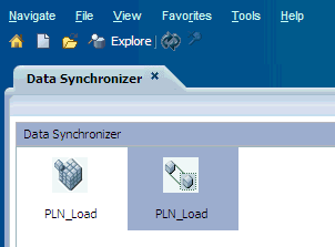

The synchronization is displayed in Data Synchronizer.

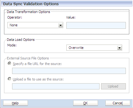

In Data Synchronizer, right-click your synchronization and select Validate Synchronization. In this example, the validation process is run against PLN_Load.
In the Data Sync Validation Options dialog box, perform one of the following actions and click OK:

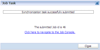

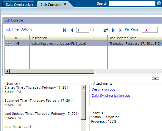

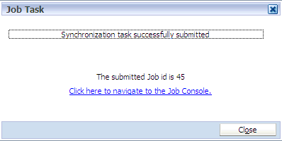

In the Job Task dialog box, click the Click here to navigate to the Job Console link.
In Job Console, refresh the page until the status displays completed and progress is at 100%.

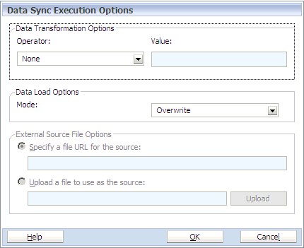

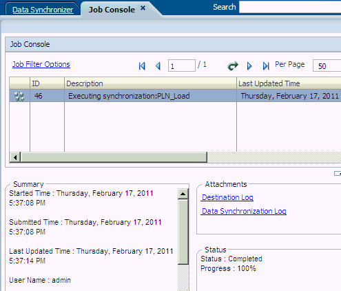

Right-click your synchronization, and select Execute Synchronization. In this example, the PLN_Load synchronization is run.
In the Data Sync Execution Options dialog box, peform one of the following actions and click OK:
