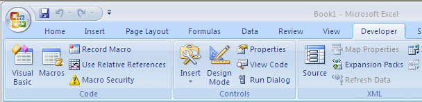

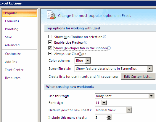

In Excel, click the Office button, select Excel Options, and under Popular, check Show Developer tab in the Ribbon.
The Developer tab is displayed in Excel.

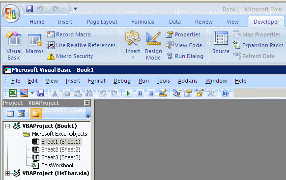

In Excel, on the Developer tab, click Visual Basic.
Visual Basic Editor opens in a separate window within Excel.
Select File > Import File.
Select c:\oracle\SmartView\Bin\smartview.bas, and click Open to import the file.

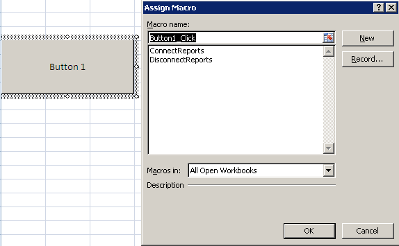

On the Developer tab, click Insert, and select the Button icon.
Place the crosshairs in the grid, and drag to draw a button.

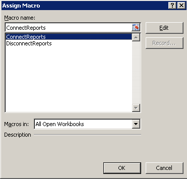

The Assign Macro dialog box is displayed.
Select the ConnectReports function, and click OK.
You are returned to the worksheet.
Select the button text, and enter Connect to Reports.

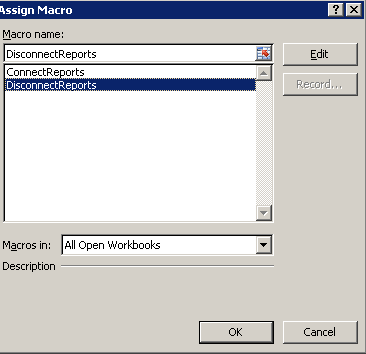

Repeat steps 4, 5, and 6 to create another button and assign the DisconnectReports function to it.
Select the button text, and enter Disconnect Reports.

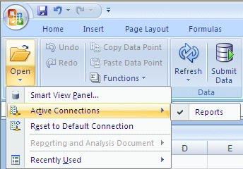

On the Smart View tab, click Open > Active Connections to verify that you are connected to the data source.
Click the Disconnect Reports button.
On the Smart View tab, select Open > Active Connections to verify that you are disconnected from the data source.
