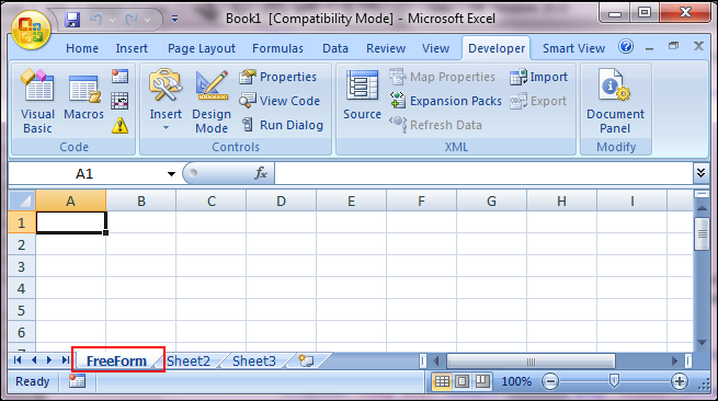

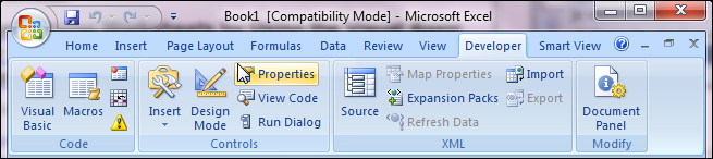

  1. In Excel, click the Office button, select Excel Options, and under Popular, check Show Developer tab in the Ribbon. Click OK.
    The Developer tab is displayed in Excel.
  2. In Excel, on the Developer tab, click Visual Basic.
    Visual Basic Editor opens in a separate window.

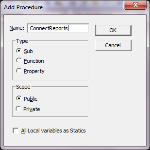

  1. In VBA Editor, select Insert > Module.
  2. Select Insert > Procedure.
  3. In the Add Procedure dialog box, perform these actions:
    1. In the Name box, enter ConnectReports. (You can substitute the name of your application for "Reports")
    2. Under Type, select Sub.
    3. Click OK.
    A sub procedure is created.

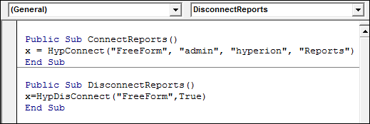

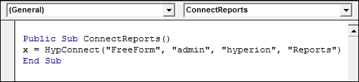

  4. Within the sub procedure, enter x=HypConnect("SheetName","Username","Password","Connection").
    • Sheetname is the name of the worksheet to operate on.
    • Username is the name of a valid user for the data source provider.
    • Password is the password for this user.
    • Connection is the connection name of the data source.

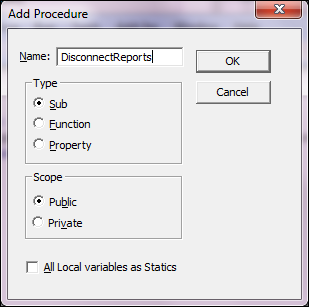

  5. Select Insert > Procedure.
  6. In the Add Procedure dialog box, perform these actions:
    1. In the Name box, enter DisconnectReports. (You can substitute the name of your application for "Reports")
    3. Click OK.

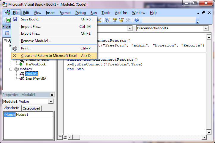

  7. Within the sub procedure, enter x=HypDisConnect("SheetName",True).
    The Disconnect function is declared.
  8. Select File > Close and Return to Microsoft Excel.

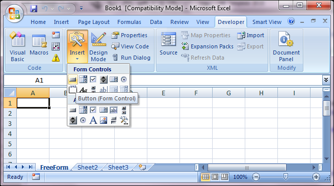

  3. In Excel, select the Developer tab.
  4. On the sheet tab, select the current name, and type FreeForm.

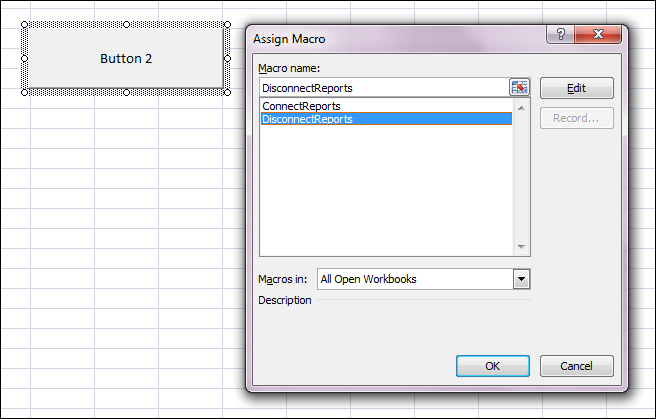

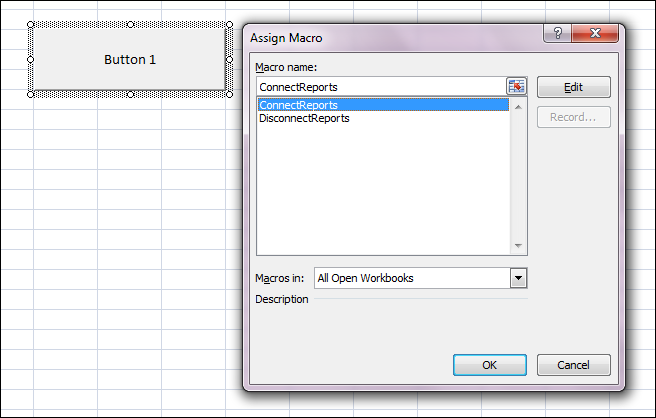

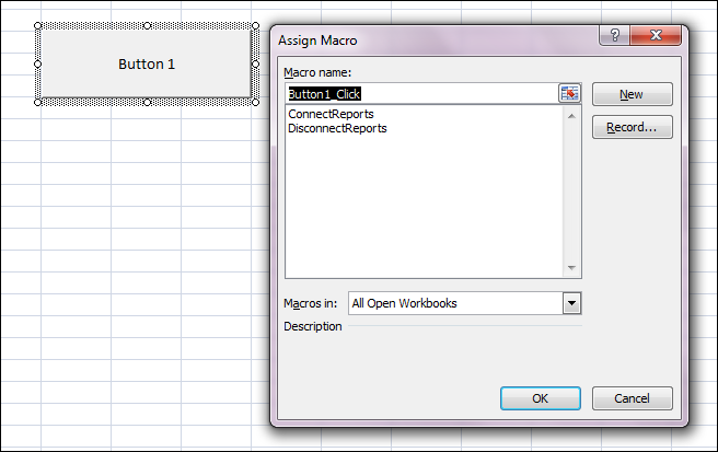

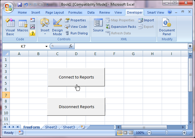

  5. On the Developer tab, click Insert, and select the Button icon.
  6. Place the crosshairs in the grid, and drag to draw a button.
    The Assign Macro dialog box is displayed.
  7. Select the ConnectReports function, and click OK.
    You are returned to the worksheet.
  8. Select the button text, and enter Connect to Reports.
  9. Repeat steps 4, 5, and 6 to create another button and assign the DisconnectReports function to it.
  10. Select the button text, and enter Disconnect Reports.

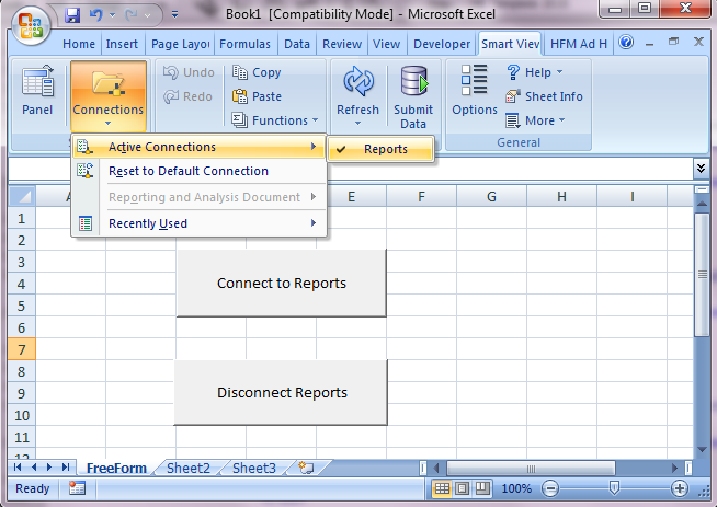

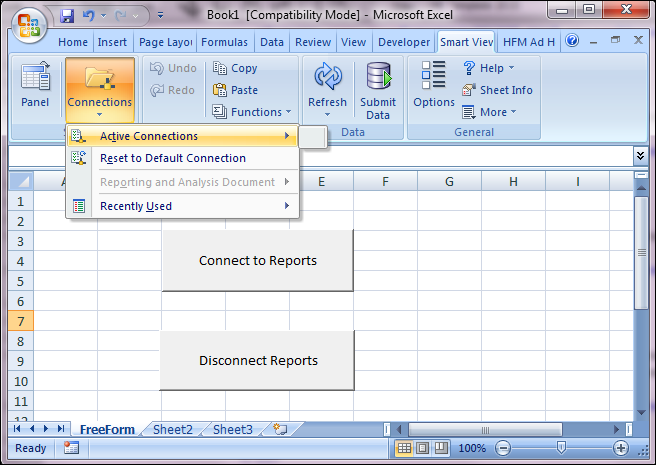

  11. Click the Connect to Reports button.
  12. On the Smart View tab, click Connections > Active Connections to verify that you are connected to the data source.
  13. Click the Disconnect Reports button.
  14. On the Smart View tab, select Connections > Active Connections to verify that you are disconnected from the data source.
    You have completed the tutorial.
