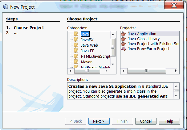

  1. Select File > New Project.
  2. In the New Project dialog box, perform the following steps on the Choose Project page:
    1. Select Java from Categories.
    2. Select Java Application from Projects.
    3. Click Next.

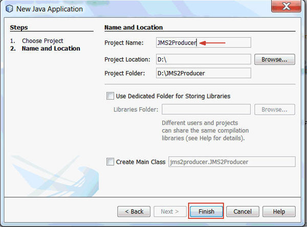

  3. On the Name and Location page:
    1. Enter JMS2Producer as the project name.
    2. Click Finish.
      Note: Uncheck Create Main Class option if it is already checked.
    3. The JMS2Producer project is created in NetBeans.

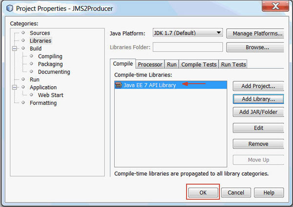

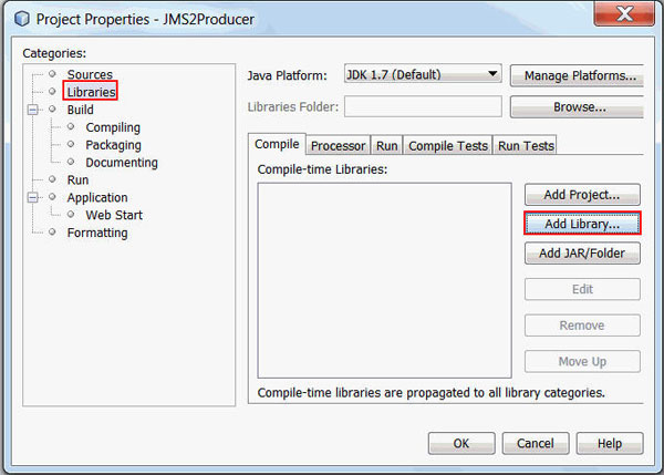

  1. On the Projects tab, right-click JMS2Producer and select Properties.

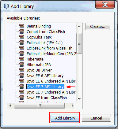

  2. In the Project Properties dialog box, select Libraries from Categories and click Add Library.
  3. In the Add Library dialog box, select Java EE 7 API Library and click Add Library.
  4. Click OK in the Project Properties dialog box.

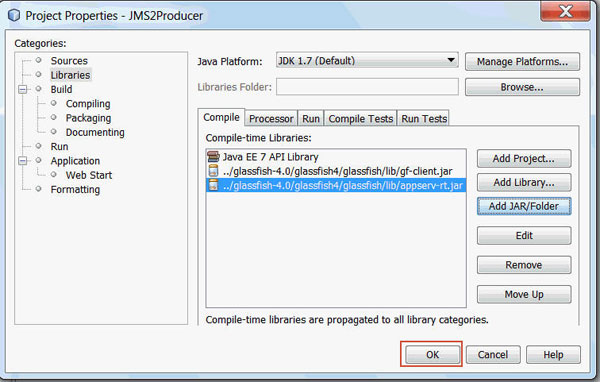

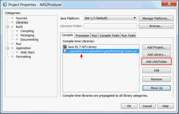

Adding the gf-client.jar and the appserv-rt.jar Libraries

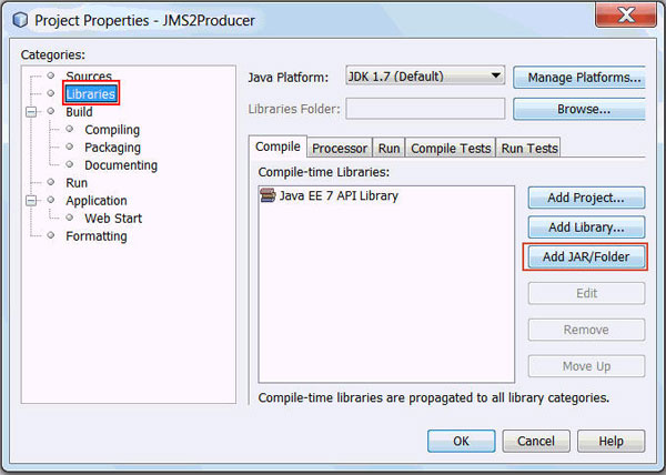

  2. In the Project Properties dialog box, select Libraries from Categories and click Add Jar/Folder.

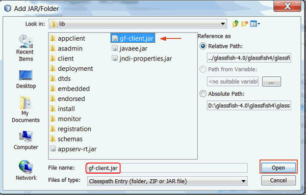

  3. Perform the following steps to add gf-client.jar:
    1. Browse to $GLASSFISH_HOME/lib. $GLASSFISH_HOME points to the GlassFish 4 installation directory.
    2. Select gf-client.jar.
    3. Click Open.

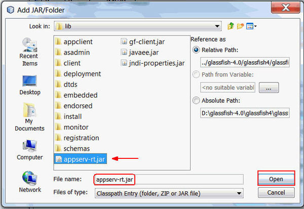

  4. Perform the following steps to add appserv-rt.jar:
    1. In the Project Properties dialog box, click Add Jar/Folder.
    2. Browse to $GLASSFISH_HOME/lib. $GLASSFISH_HOME points to the GlassFish 4 installation directory.
    3. Select appserv-rt.jar.
    4. Click Open.
  5. Click OK in the Project Properties dialog box.

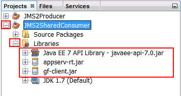

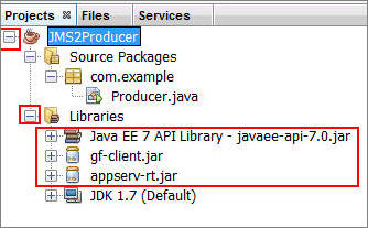

  6. Perform the following steps to verify that the libraries were added to the project:
    1. On the Projects tab, select the JMS2Producer project.
    2. Expand the Libraries folder to view the listed libraries.
  7. Repeat steps 1 through 6 to add the three libraries to the JMS2SharedConsumer project.

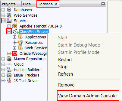

  1. Perform the following steps to log on to the GlassFish Admin console:
    1. On the Services tab, expand the Servers folder.
    2. Right-click GlassFish Server and select Start.
      Note: If your instance of GlassFish has a green triangle next to the fish icon, the server is already started and the Start option is disabled.
    3. Right-click GlassFish Server and select View Domain Admin Console.

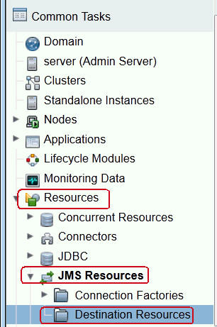

  2. In the GlassFish Admin console, perform the following steps to configure the topic.
    1. In the navigation bar, expand the Resources node and select JMSResources.
    2. Expand JMS Resources and select Destination Resources.
      alt description here
    3. Expand Destination Resources.

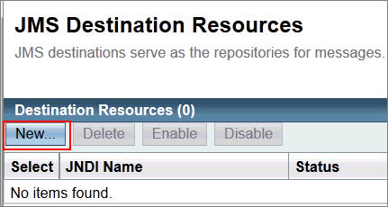

    4. On the JMS Destination Resources page, click New.

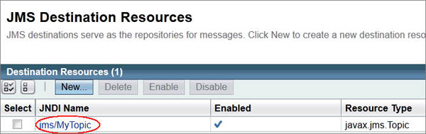

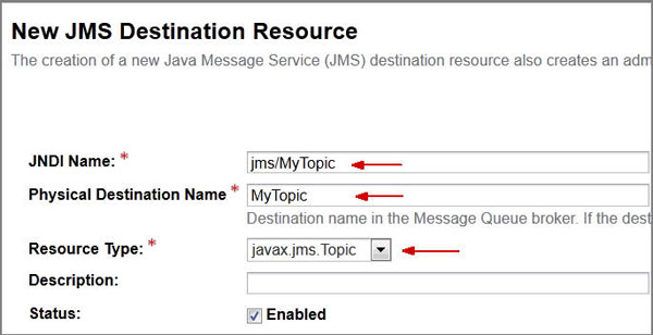

    5. On the New JMS Destination Resource page, enter or select the following :
      JNDI Name: jms/MyTopic
      Physical Destination Name: MyTopic
      Resource Type: javax.jms.Topic
    6. Click OK.
      The JMS Resources page displays jms/MyTopic in the Destination Resources table.

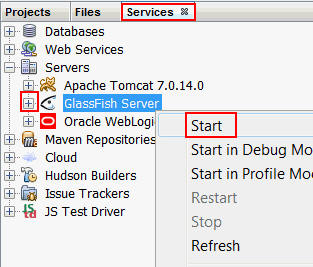

  1. Perform the following steps on the Services tab:
    1. Expand Servers.
      Note: If your GlassFish instance displays a green triangle next to the fish icon, the server is already started and the Start option is disabled.
      In the Output window, the GlassFish Server console indicates that GlassFish has started.

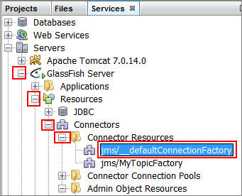

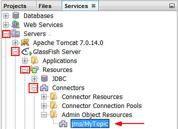

  2. Perform the following steps:
    1. Expand the Servers > GlassFish Server folders.
    2. Expand the Resources > Connectors folders.
    3. Right-click Admin Object Resources and select Refresh to display the jms/MyTopic resource.
    4. Expand the Connector Resources folder.
      The jms/_defaultConnectionFactory resource is displayed.

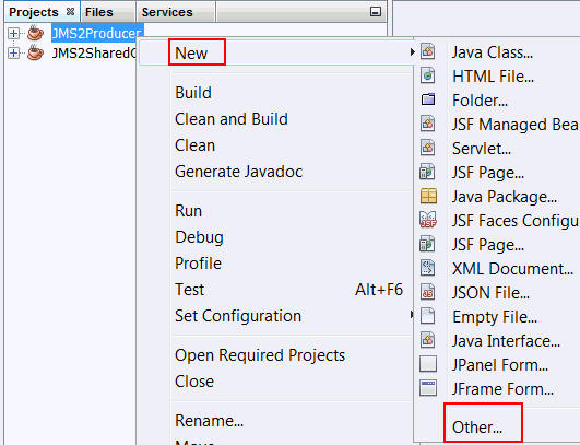

Perform the following steps to implement the Producer class:
  1. On the Projects tab, right-click JMS2Producer and select New >Other.

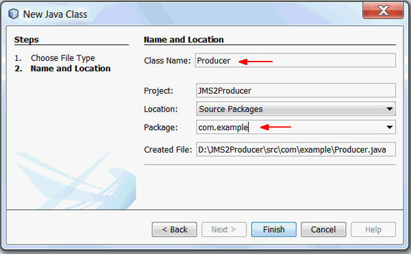

  3. On the New Java Class page, perform the following steps:
    1. Enter Producer as the class name.
    2. Enter com.example as the package name.
    3. Click Finish.

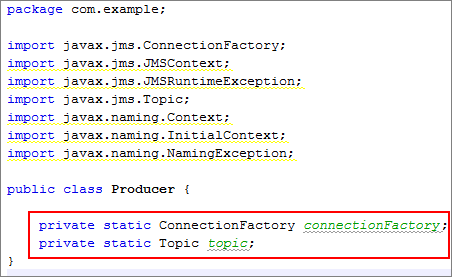

  4. Import the following packages:
    import javax.jms.ConnectionFactory;
    import javax.jms.JMSContext;
    import javax.jms.JMSRuntimeException;
    import javax.jms.Topic;
    import javax.naming.Context;
    import javax.naming.InitialContext;
    import javax.naming.NamingException;
  5. Declare the following variables:
    private static ConnectionFactory connectionFactory;
    private static Topic topic;

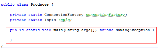

  6. Add the main() method  to the class.
    public static void main(String[] args) throws NamingException {

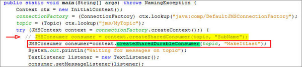

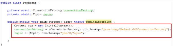

  7. Add the following lines of code to the main() method:
    Context ctx = new InitialContext();
    connectionFactory = (ConnectionFactory)
    ctx.lookup("java:comp/DefaultJMSConnectionFactory"); topic = (Topic) ctx.lookup("jms/MyTopic");
    The code looks for the JMS resources (connection factory and topic) by using the Java Naming and Directory Interface (JNDI).

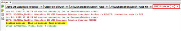

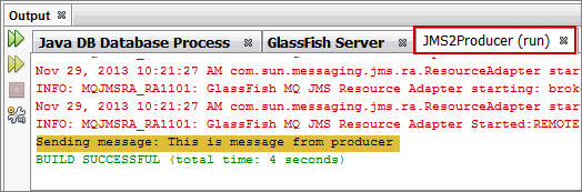

  8. Add the following lines of code to the main() method:
    try (JMSContext context =connectionFactory.createContext();)
    { String message = "This is message from producer";
    System.out.println("Sending message: " + message);
    context.createProducer().send(topic,message);
    } catch (JMSRuntimeException e) {
    System.err.println("Exception occurred: " + e.toString());
    System.exit(1); }
    System.exit(0);

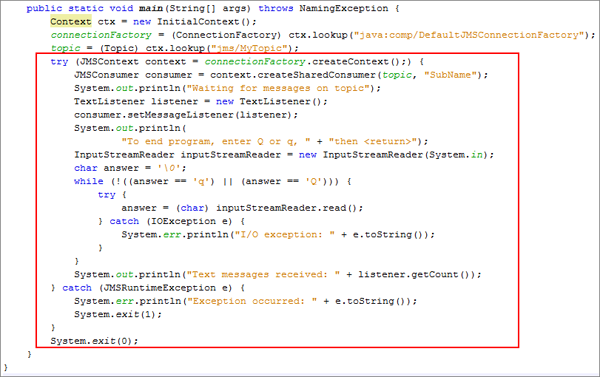

    The code does the following:
    1. Injects resources for a connection factory and topic.
    2. Creates a JMSContext in a try-with-resources block.
    3. Creates a consumer on a shared nondurable subscription, specifying a subscription name:
      consumer=context.createSharedConsumer(topic, "SubName");
    4. Creates an instance of the TextListener class and registers it as the message listener for the shared consumer.
    5. Listens for the messages published to the destination and stops when the user enters q or Q.
    6. Catches and handles any exceptions. The end of the try-with-resources block automatically causes the JMSContext to be closed.

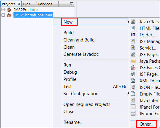

  1. On the Projects tab, right-click JMS2SharedConsumer and select New > Other.

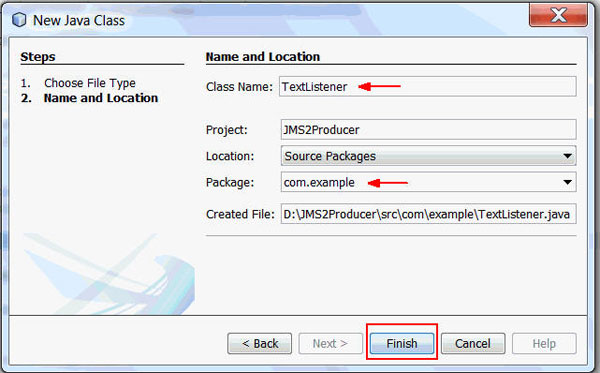

  3. On the Name and Location page, perform the following steps:
    1. Enter TextListener as the class name.
    3. Click Finish.

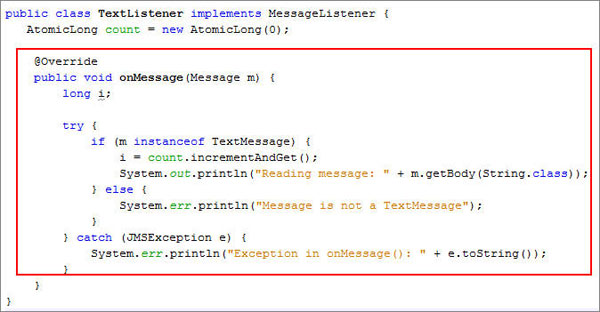

  6. Add the onMessage() method.
     @Override
        public void onMessage(Message m) {
            long i;
            try {
                if (m instanceof TextMessage) {
                    i = count.incrementAndGet();
                                    System.out.println("Reading message: " + m.getBody(String.class));
                } else {
                    System.err.println("Message is not a TextMessage");
            } catch (JMSException e) {
                System.err.println("Exception in onMessage(): " + e.toString());

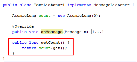

  7. Add the getCount() method.
    public long getCount() {
    return count.get();

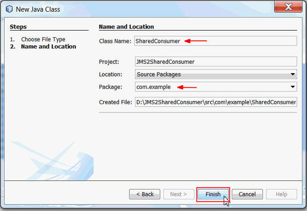

In this section, you develop a shared nondurable subscriber, the SharedConsumer class, which uses a topic to receive messages by using asynchronous message delivery. It uses the TextListener message listener.
This section describes how to use a shared consumer to distribute messages about a topic among multiple consumers. All consumers share the same subscription.
Perform the following steps to implement the SharedConsumer class:

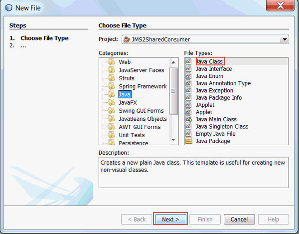

  2. In the New File dialog box, perform the following steps on the Choose File Type page:
    2. Select Java Class from File Types.
    3. Click Next.
    1. Enter SharedConsumer as the class name.
    3. Click Finish.

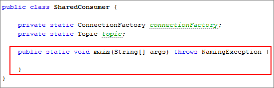

  6. Add the main method to the class.
    public static void main(String[] args) throws NamingException { }

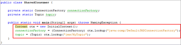

  7. Add the following lines of code to the main method:
    connectionFactory = (ConnectionFactory) ctx.lookup("java:comp/DefaultJMSConnectionFactory");
    topic = (Topic)ctx.lookup("jms/MyTopic");
    The code looks for the JMS resources (connection factory and topic) by using JNDI.
  8. Add the following lines of code to the main method:
    try (JMSContext context = connectionFactory.createContext();) {
                JMSConsumer consumer = context.createSharedConsumer(topic, "SubName");
                //JMSConsumer consumer=context.createSharedDurableConsumer(topic, "MakeItLast");
                System.out.println("Waiting for messages on topic");
                TextListener listener = new TextListener();
                consumer.setMessageListener(listener);
                System.out.println(
                        "To end program, enter Q or q, " + "then <return>");
                InputStreamReader inputStreamReader = new InputStreamReader(System.in);
                char answer = '\0';
                while (!((answer == 'q') || (answer == 'Q'))) {
                    try {
                        answer = (char) inputStreamReader.read();
                    } catch (IOException e) {
                        System.err.println("I/O exception: " + e.toString());
                System.out.println("Text messages received: " + listener.getCount());
                System.exit(1);
            System.exit(0);
    2. In a try-with-resources block, creates a JMSContext.
      JMSConsumer consumer=context.createSharedConsumer(topic, "SubName");
    6. Catches and handles any exceptions. The end of the try-with-resources block automatically causes JMSContext to be closed.

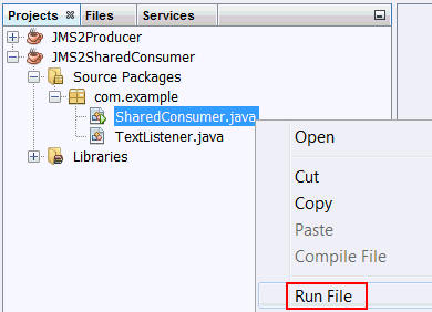

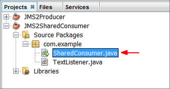

  1. Perform the following steps to run SharedConsumer.java:
    1. Expand the JMS2SharedConsumer project.
    2. Expand Source Packages > com.example.
    3. Right-click SharedConsumer.java and select Run File.

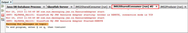

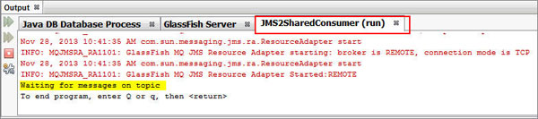

      In the Output console, one instance of JMS2SharedConsumer is running.

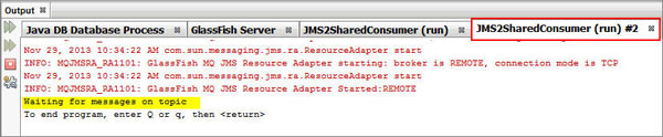

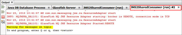

    4. Right-click SharedConsumer.java and select Run File to execute another instance of JMS2SharedConsumer.
      In the Output console, the second instance of JMS2SharedConsumer is running.

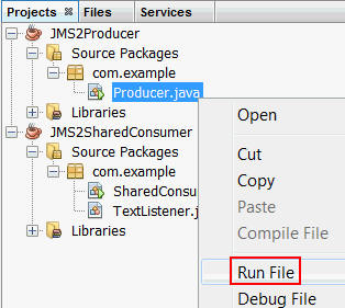

  2. Perform the following steps to run the JMS message producer.
    1. Expand the JMS2Producer project.
    3. Right-click Producer.java and select Run File.
      In the Output console, one instance of JMS2Producer is running.

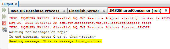

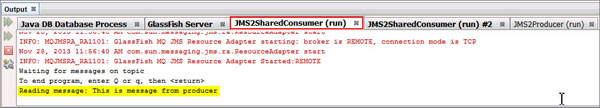

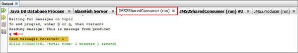

  3. Perform the following steps in the Output console:
    1. Click JMS2SharedConsumer(run).
      The message sent from the producer has been consumed.

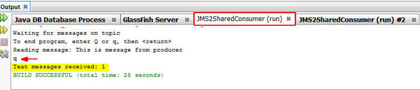

    2. Enter q or Q to quit.
      The number of received messages is displayed.

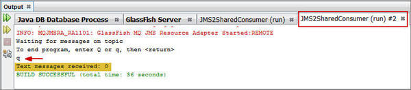

  4. Perform the following steps in the Output console:
    1. Click the JMS2SharedConsumer(run)#2 tab.
      You can see it is still waiting for messages.
      The number of messages received is 0.

    4. Perform the following steps to modify the main() method:
      1. Comment the following line of code:
      2. Add the following line of code:
      3. Creates a consumer on a shared durable subscription, specifying a subscription name:

  1. Perform the following steps to run Producer.java:
    2. Expand Source Packages -> com.example.
      In the Output console, one instance of the JMS2Producer is running, and a message was sent to the JMS/MyTopic topic.
