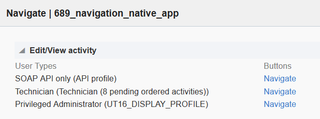

Forms and Plugins Screen Improvements
Earlier, you had to open a Form or plug-in to see the user type or button that is configured and to navigate to the layout where it is configured. Starting with Update 19D, the number of buttons configured for a Form or plug-in is displayed on the Forms and Plug-Ins page:
Forms & Plugins Screen Showing the Count of Configured Links
When you click the number, you can see the screen, the user types, and the buttons for which the Form or plug-in is configured.
Context Menu Showing the Details of the Configured Links for the Navigate Plug-In
In addition, you can click the button to open the Visual Form Editor on which the button is configured and see the button highlighted.

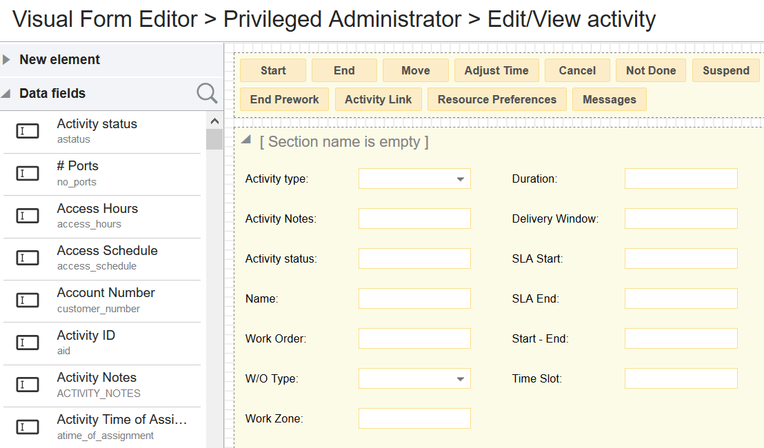

Visual Form Editor Configuration Improvements
Earlier, when you had complex forms that contained a large number of fields, you could not:
- See all the configured elements as an aggregated list.
- See which data fields were already added.
- Find an item in the editing area.
With update 19D, several improvements are made to simplify the way you use the Visual Form Editor:
- A new accordion type panel is added with these options to help you add, edit, and search for elements:
- New element: All the element types that you can use in this context are listed here. To add a new element, drag it from this section and drop it to the desired location on the form. You can also use the search option to search for an element within this section. This screenshot shows the New element panel:
New Element Panel
- Data fields: All the data fields that you can use in this context across all element types are listed in this section. Drag an element from this section and drop it to the form, to add the data field with a pre-configured binding to the data source. You can also use the search option to search for a data field within this section. This screenshot shows the Data fields panel:
Data Fields Panel
- Content navigator: All the fields you have used in the layout. Each field has an icon representing the GUI type of the element that is defined when you bind the field to a data source.
- Clicking an item scrolls the content to the appropriate item in the layout and highlights it without opening the context menu editor.
- Clicking an item in the layout focuses the list to the appropriate item, if the panel is active (not collapsed).
- If a field is present more then once in the content, you see a marker in a format (n / m). For example, (1 / 3) means first occurrence of 3 in total. Clicking the marker takes you to the item on the layout.
- The order in the list is according to the appearance on the configured form, top to bottom, left to right.
- The search option lets you search for a field within this section. This screenshot shows the Content navigator panel:
Content Navigator Panel

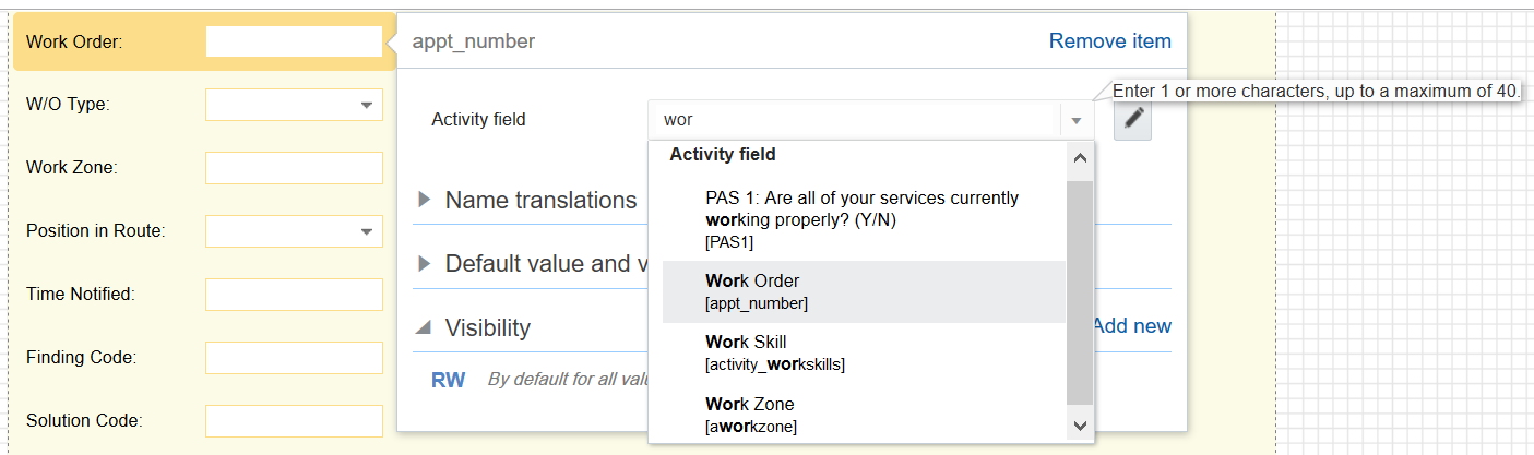

- Data binding is more intuitive, as you can access the possible options for binding and search through the options. The improvement for each field is as follows:
- Form field: As you start entering text in the Form field field, you can see only those fields that contain the entered text in their label or caption.
- Type: The application populates the Type field automatically, based on the field you select for Form field.
- Unbound field: If you do not bind the field to any entity, then the application provides an additional option to use the text as a form field label.
- Name translations: The number of languages in this section is same as the number of languages you have configured on the Configuration, Display page.
This screenshot shows the auto-suggested fields while binding:
Auto-Suggested Fields During Binding

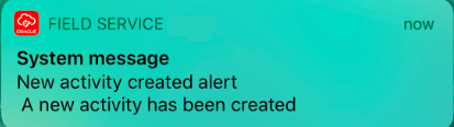

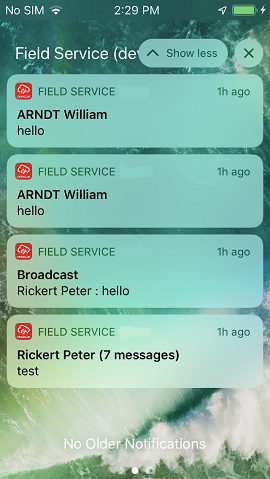

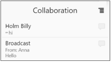

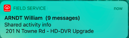

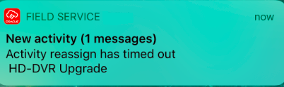

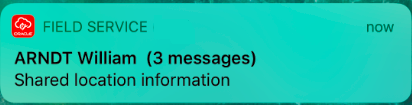

Collaboration Notifications in iOS App
Starting with update 19D, Collaboration messages and events appear in the notification center as badges for the users of Oracle Field Service Cloud installed iOS Application.
When an event occurs in the Installed iOS Application, the user gets an update in the notification area of the mobile device, though the user is not using the application, but the application must be active in the background. The events related to collaboration messages, activity updates, etc. are displayed in the notification area of the Installed iOS Application. The notifications appear in the status bar as an icon.
PREREQUISITES
- The Remote Notifications option must be enabled on the mobile device
- The Installed Application must be run at least once on the device
NOTIFICATION AS BADGE
The badge present on the application launcher icon is updated with unread collaboration chats as notifications in the application. These badges appear automatically when a new collaboration notification is received and disappear on clicking the application or notification banner.
Notification Badge
GROUPED NOTIFICATION
- Multiple notifications from the collaboration will be grouped together on the Lock screen.
- User can tap a set of notifications from collaboration or expand them to see all the notifications in the list.
- The group summary will provide the number of unread notifications. For example, "3 more notifications."
NOTE: For any app that supports notifications, user can enable or disable the feature entirely. User can also enable / disable the visibility in Notification Center, on the lock screen, app icon badging, and choose one of the notification styles. The user cannot view the notifications if the mandatory settings are not configured in the system.
NOTIFICATION MESSAGE – KEY COMPONENTS
By default, all the notification messages contain the following components:
Header Area – This component contains App Icon, App Name, and Timestamp.
Content Area – This component displays Content Title and Content Text. The Content Title will differentiate the type of Collaboration messages such as:
- Name of the sender- in case of a one to one message
- Conference -in case of a conference message
- Broadcast -in case of a broadcast message
- New activity - in case of activity broadcast message
The title also contains a count of unread chats in that conversation.
A Context Text- This can be the content of the text.
MULTIPLE NOTIFICATIONS

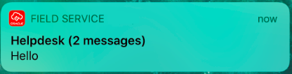

When there are multiple collaboration messages of the same category, the messages are grouped and summarized in the notification area. The information about the unread notifications will also be available. The user can expand the view and see all the remaining notifications by tapping the notifications. A sample multiple notification is shown below:
Multiple Notification

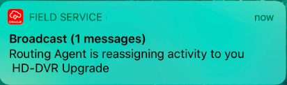

COLLABORATION NOTIFICATION EXAMPLES
Here are some collaboration notification examples:
Message Between Two Users
Message Example

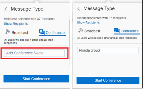

Conference
Conference Example

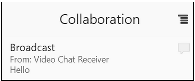

Broadcast Message
Broadcast Message Example
Automatic Broadcasting
Automatic Broadcasting Example
Collaboration Message from Message Scenario
Sharing Location Between Users
Users Sharing Location

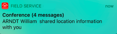

Sharing Location in Conference

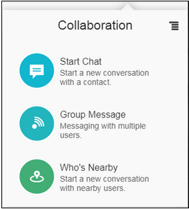

Collaboration User Interface and Usability Improvements
Starting with update 19D, these usability improvements are made in the Field Collaboration module:
- The Start Chat, Group Message, and Who’s Nearby icons are displayed in the Collaboration window when there are no chats active between users.
Collaboration Window
- The collaboration users can add a name for a Conference chat or edit the name of an existing Conference chat. The Conference chat names help users identify different active conference chats in the Collaboration window.
Conference Chat in Collaboration Window
- The Broadcast option (present in the legacy Core Manage application) is now available in the Core application for help desk operators.
As part of the 19D release, the following UI style and formatting changes are made in the Field Collaboration module:
- The look and feel of Broadcast chats are made similar to Conference chats where in the term, Broadcast is displayed as the header and the name of the sender is displayed as the description in the second line of the active chat.
Broadcast Chat

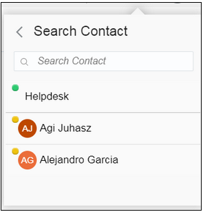

- The Helpdesk and Address Book contacts are only displayed in the Search Contact window.
Search Contact Window
- The Helpdesk name is displayed with a normal black color in active chat and Search contacts to unify the look and feel of collaboration elements.
Search Contact Window - Helpdesk Name
- The Helpdesk and Collaboration users will now have the following status icons:
(Green): Indicates that the Helpdesk or the Collaboration user is online.
(Yellow): Indicates that the Helpdesk or the Collaboration user is away.
- The Bold style used for user and helpdesk names is changed to Normal style across the Collaboration module.
Collaboration Module Showing Bold Style

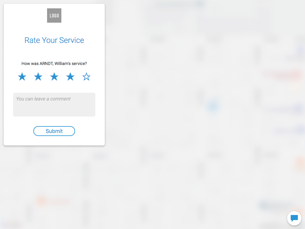

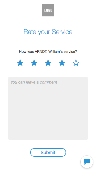

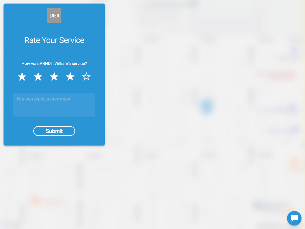

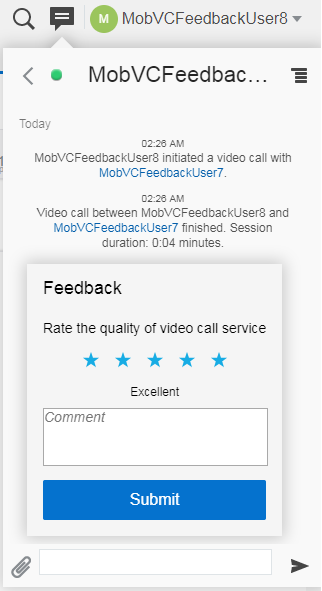

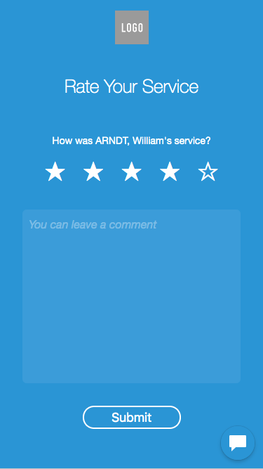

Provide Feedback for the Video Call Service
You can rate the quality of the service and provide feedback on the service at the end of a video call. Feedback provides insight into real life problems that the user encounters while using the service. An administrator can enable or disable the Feedback option using the Enable Video Call Feedback check box in the Configuration, User Types screen for a user type.
- When you finish a video call, the Feedback window displays:
Feedback Window
- Select one of the following options to provide your feedback:
- 1 Star: Indicates worst quality of service.
- 2 Star: Indicates bad quality of service.
- 3 Star: Indicates good quality of service.
- 4 Star: Indicates very good quality of service.
- 5 Star: Indicates excellent quality of service.
- Enter comments (if any) in the Comments section.
- Click Submit.
NOTE: There is a one-minute time out period for every feedback window and the feedback is only saved when the user submits a rating. Feedback is not a mandatory option for the user. Also, if a user initiates another video call service without providing feedback for the previous video call service, then the Feedback window is closed automatically.

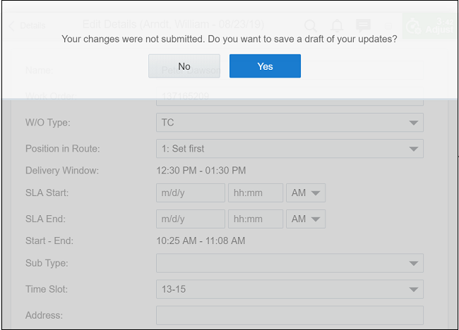

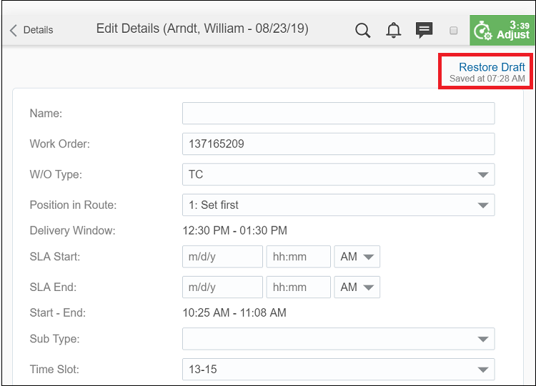

Ability to Resume Screen Completion from Draft
Starting with update 19D, users can save a partially filled form as a first draft. When you access the same form the next time, you can restore the draft and resume filling the information. When you submit a form, the draft is not available for future use. You can configure drafts for Forms and Tabs on the Activity details, Resource Inventory, and User screens in Core Application and the Installed Application (for Android and iOS platforms) only.
RESTORING PARTIALLY FILLED FORMS
You can save data on partially filled Forms or Tabs and restore the data at a later stage. You have this option available on the Activity, Resource, Inventory, and User screens.
NOTE: Drafts are supported in the serialized inventory and not supported in non-serialized inventory.
Follow these steps:
- When you edit or fill a form partially and try to navigate to another screen, a confirmation dialog appears on the screen.
Save Dialog
- Depending on your selection (either Yes or No), you can either save the draft or discard the changes.
- Click ‘No’, and you’re redirected to the previous screen and you’ll lose all the unsaved data.
- Click 'Yes', the application saves a draft of the changes and navigates you to the previous screen.
- After saving the draft, if you navigate back to the same screen, a ‘Restore Draft’ link appears on the screen. This indicates that a partially filled form already exists for the particular screen and the user can restore it. You can click the link to restore and use the existing draft.
Edit Details Dialog
NOTE: If the user’s device does not have enough browser storage or space, the application does not provide this option. The draft is only available in the user’s browser or device when it is saved, if the user logs in using another browser or device, the draft is not available.
All the existing drafts at the end of the day are automatically removed the next day. This is defined by the 'Overnight work' setting configured on 'Business rules' screen.
Drafts will be retained when Suspending activities and will remain for 'Pending' activity that is created upon 'Suspend' action when using the same browser or device.

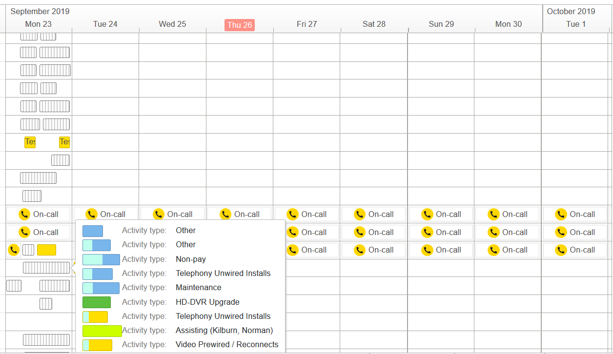

Earlier, the activity labels were shown only on Day, 2 Days, and Week views. Starting with update 19D, you can view the activity labels and icons for on-call shift on the Month view.
These are the guidelines based on which the activity labels and on-call shift icons display.
- Single activities and segmentable activities are now shown with the corresponding labels. If a segmentable activity is shown as two or more segments, you can highlight all the segments by pointing to one of the segments.
- When multiple activities are shown, it is possible that only the first few characters of the label appear. To view the complete information, click the individual activity hint.
- If there are no activities for a given day, and an on-call shift exists, the on-call shift is shown for the whole width of the day cell.
- If activities are planned for an on-call shift day, the shift shows as an icon. The icon appears before the activities, if the shift starts before the last activity for the day ends. The icon appears after the activities, if the on-call shift starts after the last activity for the day ends.
- When both on-call and activities are shown, the name of the on-call shift may not appear. To view the complete information of the shift, click the shift hint.
- Let’s say the shift is shown as an icon, or the name of the shift is truncated due to its length. You can click the shift icon to see the full name of the shift, its start and end time as a tool tip.
- If a resource doesn’t have activities, but has an on-call shift for a given day, the on-call shift icon and the shift name are shown. If a resource has one or more activities and an on-call shift, the on-call shift is shown only as an icon.
To display On-call shifts on the Month view screen, select the "Show on-call" check box in the View menu. To hide them, clear the check box.
This image shows the on-call icons, multiple activities planned for a day, and the activity hint:
Month View Showing On-Call Icons and Activity Hint for Multiple Activities
CONFIGURE THE ACTIVITY LABELS
You must configure the activity labels that you want to see on the Month view.
- Click Configuration, User Types.
- Select the user type for which you want to configure the activity labels.
- Click Screen configuration.
- Expand Legacy Manage and click Activity time view label.
- Click Click to Add. On the Add property window, select the properties that you want to display as labels.
- Click OK.
- In the [property] visibility section, click Add new visibility. Read-Only is selected by default.
- Click Save.
- Click Add new visibility in the [property] value visibilities section. By default, all the values for the property are visible. If you want to have it that way, click Save. If you want to add visibility to specific values, select the values and then click Save.
- Click Close. Go to the Month view either in Legacy Manage or Dispatch Console. The labels are displayed.

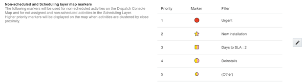

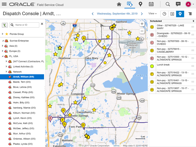

Non-Scheduled Activity Map Markers
Earlier, non-scheduled activities appeared on the Scheduling layer on the Route map and on the Dispatch Console map with big and small circles of different colors. You cannot differentiate between activities, or filter specific activities with these indicators. Now, you can configure the activity markers by associating predefined shapes with filter conditions. For example, you can configure a star to indicate installation activities, or a square for maintenance activities. These markers display for not assigned and non-scheduled activities on the Scheduling layer of the Route map and for non-scheduled activities on the Dispatch Console map.
MARKER CONFIGURATION ON THE BUSINESS RULES SCREEN
Here is the set of non-scheduled and scheduling markers configured on the Business Rules screen:
Non-Scheduled and Scheduling Layer Map Markers Field on Business Rules Screen
Here is an example: Route Map: Scheduling Layer, select 'Scheduling'
Route Map: Scheduling Layer - Scheduling Example
Example Dispatch Console Map: View, select 'Show non-scheduled activities'
Dispatch Console Map: View - Show Non-Scheduled Activities Example
NOTE: Markers are not available for activities on individual technicians’ routes.
Steps to Enable
CONFIGURE ACTIVITY MAP MARKERS
You can configure map markers to differentiate between the non-scheduled activities displayed on the Scheduling layer on the Route map and on the Dispatch Console map.
- Click Configuration, Business Rules.
- In the General section, go to Non-scheduled / Scheduling layer map markers. You can see that Urgent (red big circle) and Other (yellow small circle) are available by default.
- Click the pencil icon.

DEFAULT MARKERS: URGENT AND OTHER ACTIVITIES
By default, two markers are available:
- Urgent activities: Activities that are urgent. These activities appear as big red circles on the map. The property for urgent are considered based on the Activity priority setting on the Business Rules page. If the property for Urgent activity is not configured then the red marker does not appear on the map. However, the 'Urgent' item remains on 'Activity map markers' window.
- Other: Activities that are not urgent and do not meet any filter conditions associated with markers. They appear as yellow small circles or small pink circles on the map, when the activity is under risk.
NOTE: Activities under risk that are displayed as pink markers have higher priority than the normal activities with a configured marker.

HOW A MARKER IS DETERMINED FOR ACTIVITIES IN A CLUSTER
When multiple activities cluster on the map, the marker for the activities is determined based on the priority of the marker. These three examples show how markers are determined—the result described here is based on the descriptions provided in the Default Markers, Urgent and Other Activities section.
Activities under risk that are displayed as pink markers have higher priority than normal activities with configured marker.
Example 1
Here is an example:
- Activity 1 meets 'New installation' filter conditions and is not under risk.
- Activity 2 does not meet any filter conditions and is under risk.
Result on map: Activity 2 marker is displayed. Pink small round marker (priority 5 on configuration screen).
Example 2
Here is another example:
- Activity 2 meets only 'Days to SLA: 2' filter conditions and is under risk.
Result on map: Activity 2 marker is displayed. Pink square marker (priority 3 on configuration screen).
Example 3
Here is an example:
- Activity 1 meets criteria for Urgent activities.
- Activity 2 meets 'New installation' filter conditions and is under risk.
Result on map: Activity 1 marker is displayed. Big red marker (priority 1 on configuration screen).
DISPLAY ACTIVITY MARKERS ON THE MAP
You can display activity markers on the map, to differentiate between activities, and to view specific activities such as activities that are at risk.
- To view the markers for non-scheduled activities in the Dispatch Console:
- Click Dispatch Console.Click a bucket or group in the Resource tree.
- Click the Map icon and then select Non-Scheduled.
- To view the markers on the Route map:
- Click a bucket or group icon on the Resource tree.
- In the hint, click the Route icon.
- Click the map icon and then select the Scheduling layer. Higher priority markers display on the map, when these two conditions satisfy:
- There are many activities in the same location or activities are in a clustered location.
- Activities have different map marker priorities.
Markers with different priorities display separately in clustered locations as you zoom in on the map, unless the location is the same.

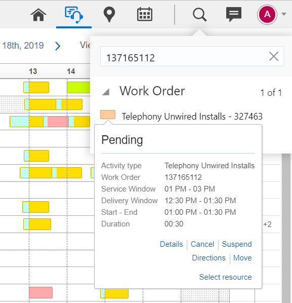

LINKS IN ACTIVITY HINT
One of the typical routines for Dispatchers is to search for activities to inspect details, adjust data or perform some actions with them. Going through this flow in Dispatch console is more easier now because the application starts to display links in hints for activities found in search results. The application configures links on 'Activity hint' context layout in configuration of User types and aligns them with hints displayed for activities on Time and List views. Dispatchers can now utilize search more efficiently and work with activities directly from it instead of looking for an activity across Time/List views in Dispatch console.
Activity Hint in Dispatch Console
NOTE: When searching for activities on other screens, the links do not appear on activity hints.

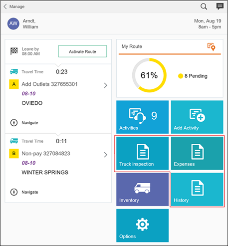

Presenting Forms on Landing Page
Starting with update 19D, forms configured in Oracle Field Service Cloud can be displayed on the Landing Page.
You should configure forms for the Activity List context layout on the Screen Configuration screen for selected User Type. These form links are presented as separate tiles on Landing Page. Such tiles contain action link name and predefined icon that cannot be changed. This can be useful when trying to capture information that is not related to an activity or inventory such as a Vehicle or Safety inspection or capturing some type of expense. You can configure the forms from the Activity List context layout structure for the selected User Type. You can create any form (except the ‘Forms History’) from the Screen Configuration section.
FORMS HISTORY
The ‘Forms History’ form can added from the ‘Standard action screen.’Forms History'. The Forms History screen can be displayed on the Landing Page. To display the Forms History screen on the Landing Page, You should configure this presentation by adding Forms History action link.
Landing Page Showing Forms History
Steps to Enable
Follow these steps:
- Click Configuration, User Types to navigate to the User Types configuration screen.
- Select the corresponding User Type.
- Select the Screen Configuration tab and select Activity list.
- Click Add new and select the Custom forms option for any form excluding Forms History.
NOTE: You can display Forms History by adding Forms history action link.
- Set up Add new visibility.
- Enter custom Name (optional).
- Log into the application under the user belonging to the configured User Type.
- Make sure the Landing Page displays the added links as tiles in the Landing Page with corresponding Names and icons.
NOTE: You cannot configure the added tile icon and color through the application but they correspond to the action link selected.
You may click Delete for the selected items to remove the forms you do not use.

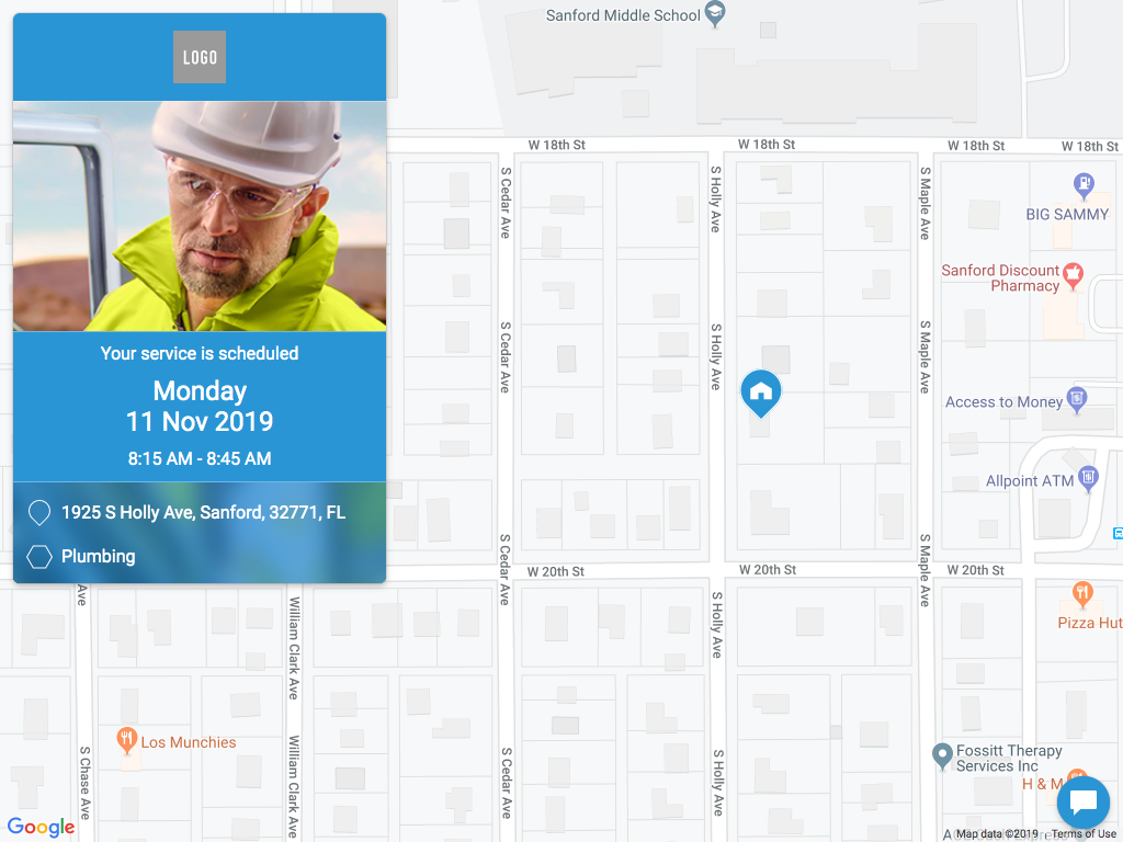

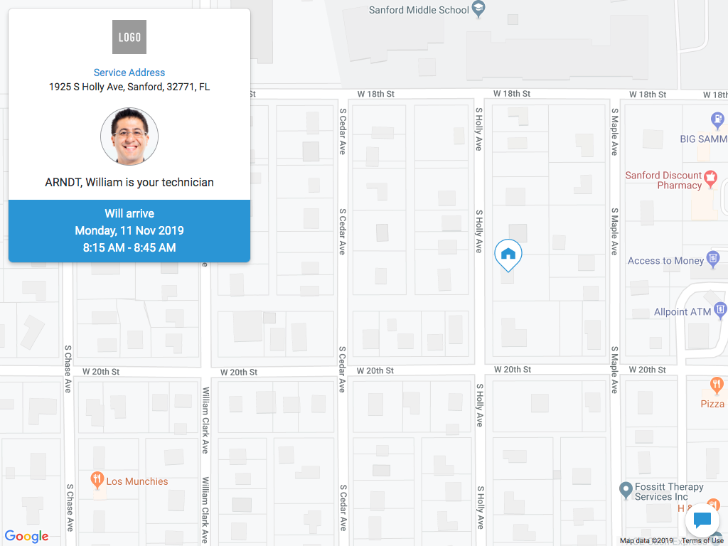

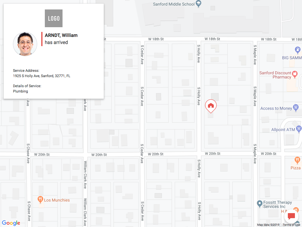

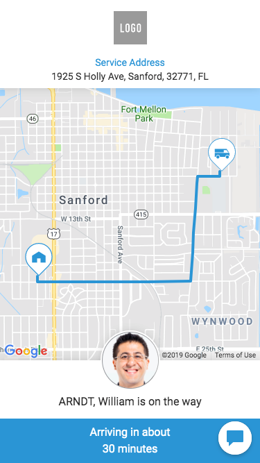

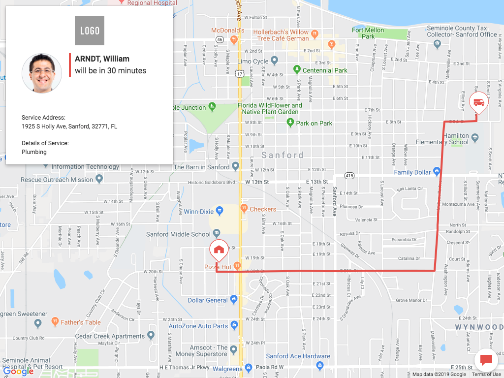

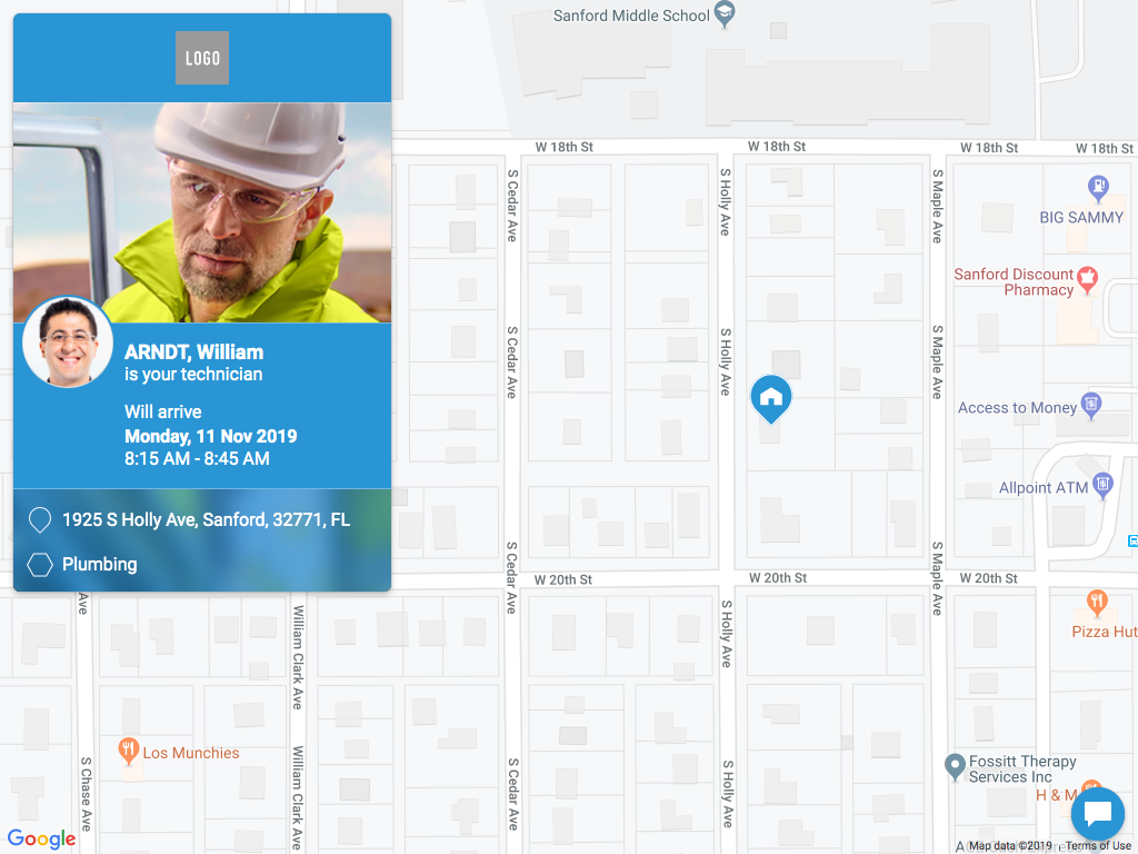

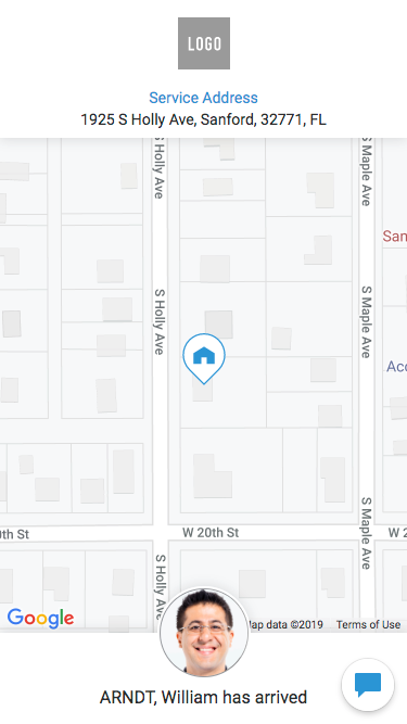

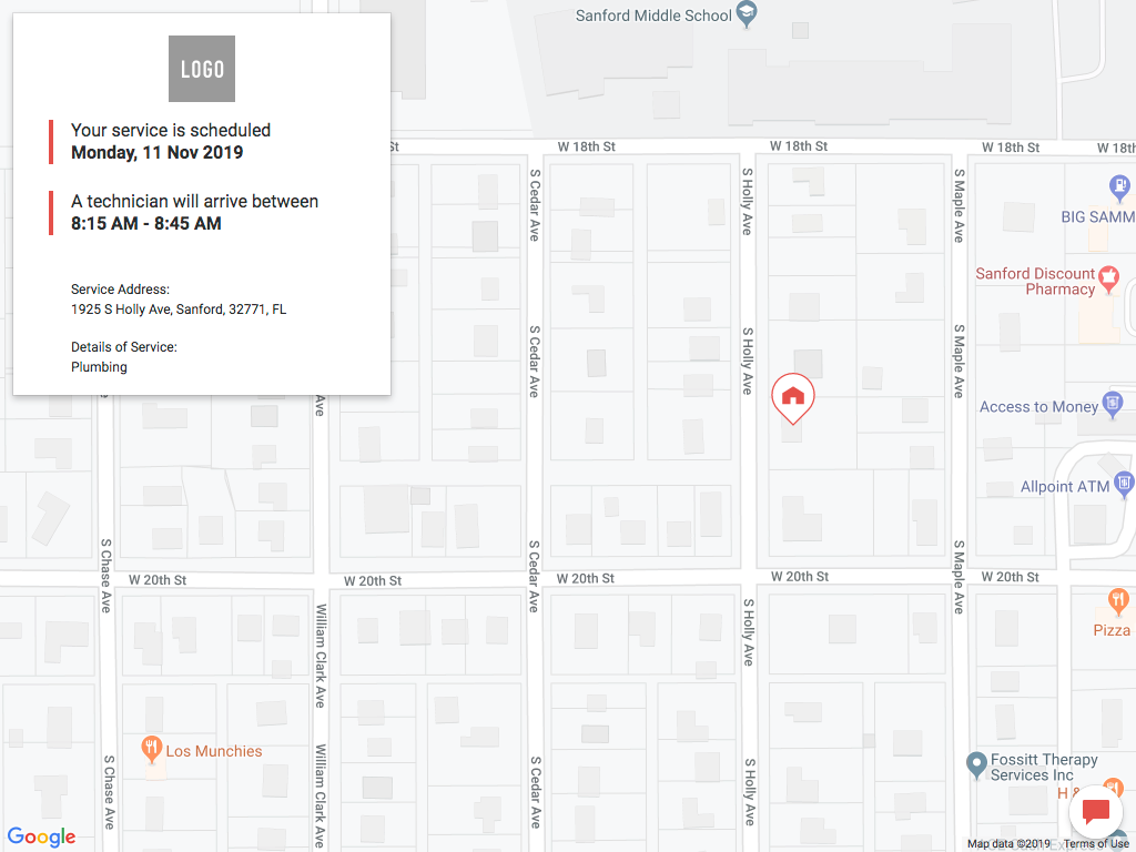

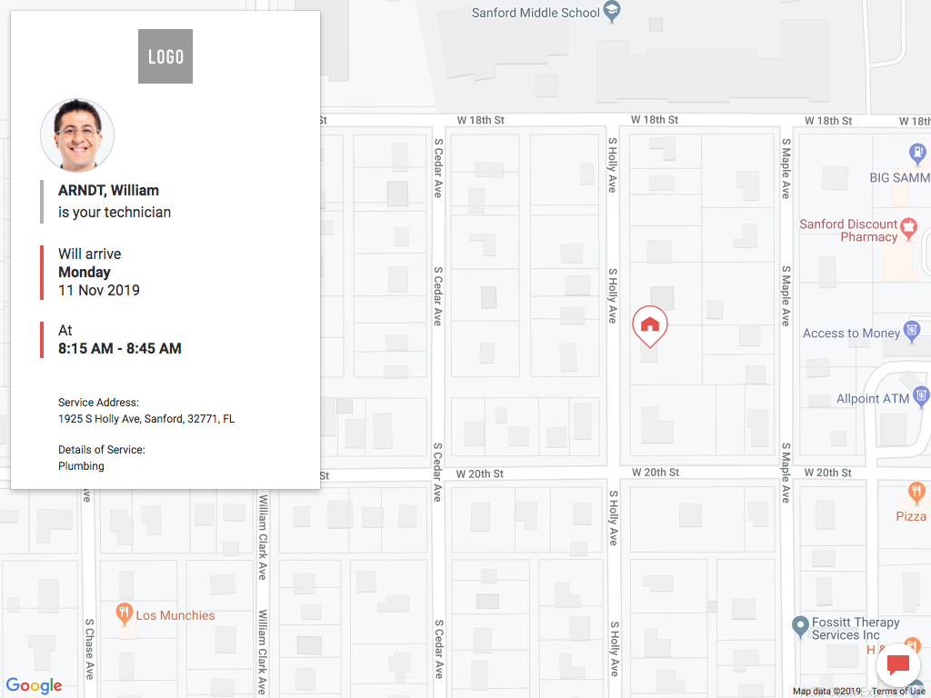

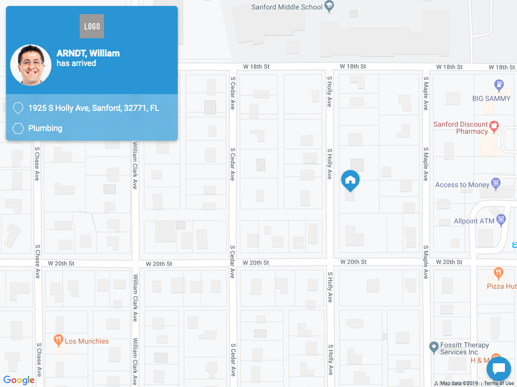

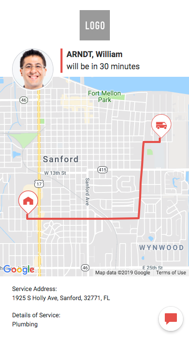

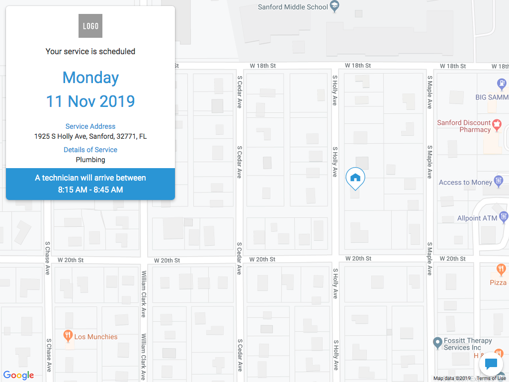

Earlier, your customers couldn't see a technician's location in real-time, track a technician's arrival time, or chat with a technician. Starting with update 19D, the new feature, ‘Where is My Technician’, lets you send a URL to your customers, through which they can track the status of their ordered service. ‘Where is My Technician’ is available as a theme on the Configuration, Themes page. You can configure the ‘Where is My Technician’ screens with your organization’s branding and set whether your customer can track a technician on the map, see the technician’s details, and provide feedback when the technician completes the job.
NOTE: The Where’s My Technician functionality is not available for Contingent Workers.
You can perform these tasks with the ‘Where is My Technician’ feature:
- Send a tracking URL in the appointment confirmation and reminder emails
- Show the details of the appointment, service address, and day/time of arrival
- Show a custom name for technicians, for example, Mr. William or Will
- Show or hide the technician’s photo
- Show or hide the technician’s position on the map
- Show custom technician and customer location markers on the map
- Show the estimated arrival time of the technician
- Let customers track the technician’s location in near real-time
- Allow or block providing feedback after a technician’s visit
- Allow chatting through the Smart Chatbot
- Configure branding for the tracking web page
- Customize the text for the tracking page
HOW TO USE THE FEATURE?

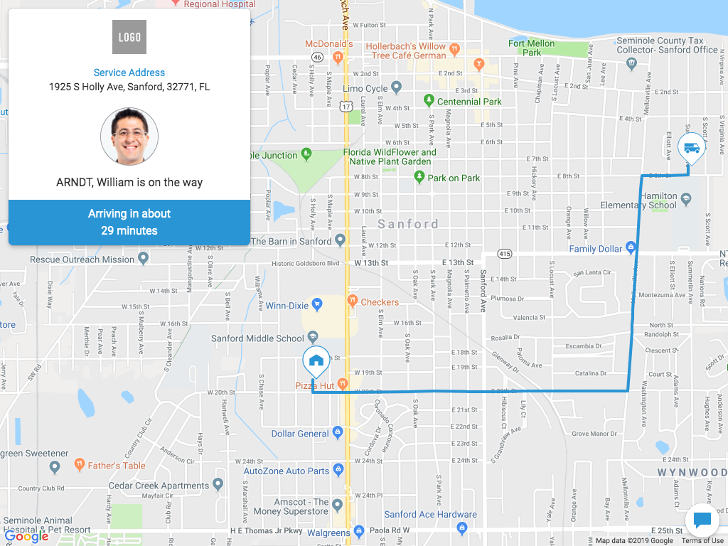

The Where is My Technician feature is available if you have an Oracle Field Service Cloud Professional or an Oracle Field Service Cloud Enterprise subscription with Google Maps. The feature is not yet available for your subscriptions with Oracle Maps, but is planned for a future update.
Where is My Technician is a theme that is available on the Configuration, Themes page. When you configure this theme, you can send a URL to your customers, which they can use to track the technician. When your customers open the tracking URL, the page refreshes automatically every five seconds to display the latest information. If you change the fields on the theme, the new fields display when the customer refreshes the tracking page. Your customers can start tracking the technician’s route only when the technician is on the way to the activity. To track the technician’s location on the map, we recommend that your customers use the Oracle Field Service Cloud Installed Application with location sharing enabled.
Although the Where is My Technician theme supports all types of activities, we recommend that you do not use it for segmentable activities. Your customers can see the Where is My Technician page for non-scheduled activities as well, but without the date and time of service. This theme includes the Scheduled, Days before, On the way, Arrived, and Feedback pages. However, for your customers it is just one page and the information on the page corresponds to the status of the activity at that time:

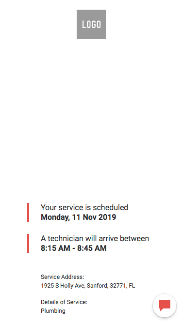

- Scheduled: The activity is created in a bucket and the Service window/Delivery window is set.
- Days Before: A technician is assigned (and can be also changed) and the Service Window is known.

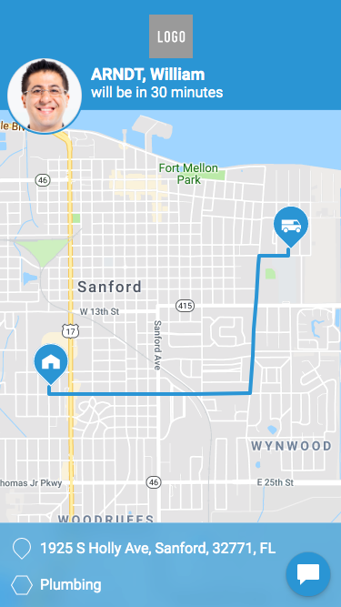

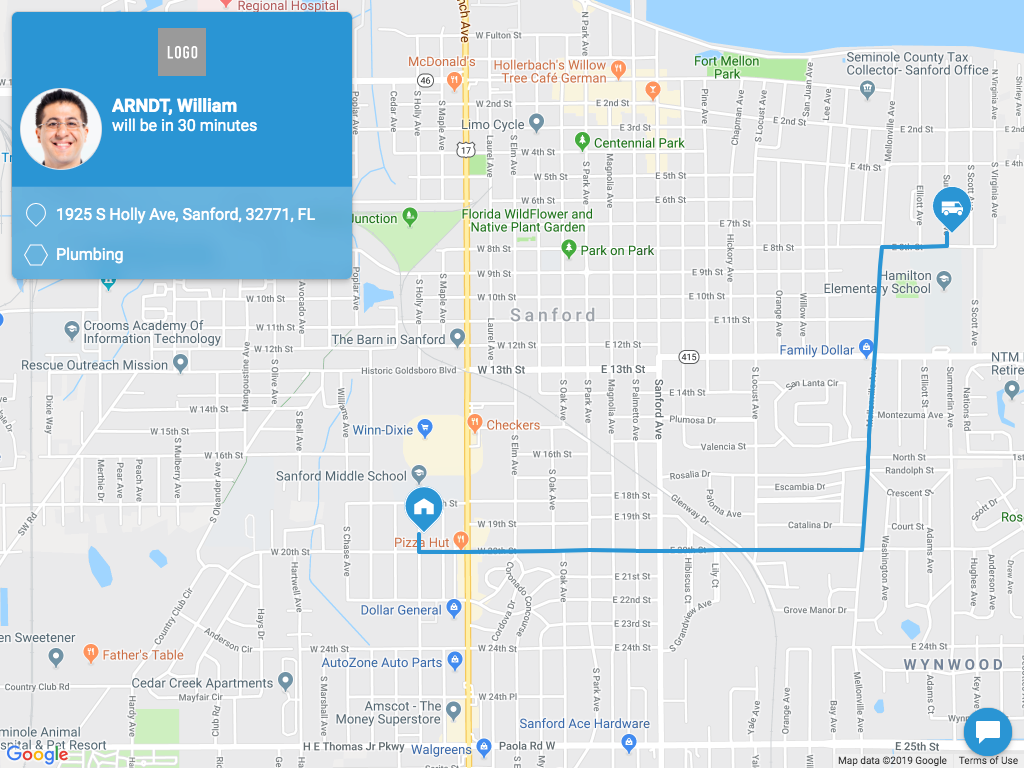

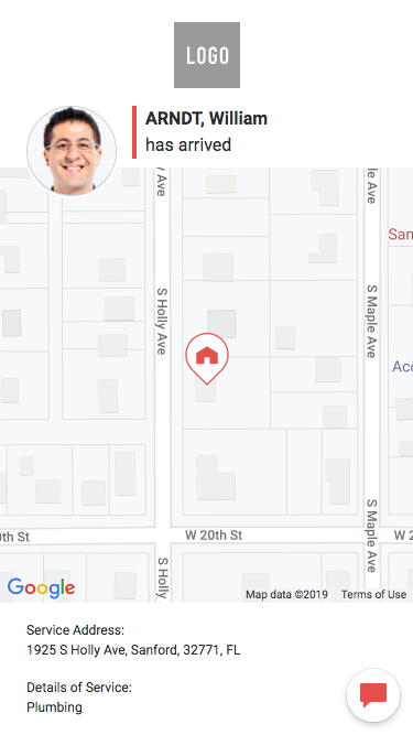

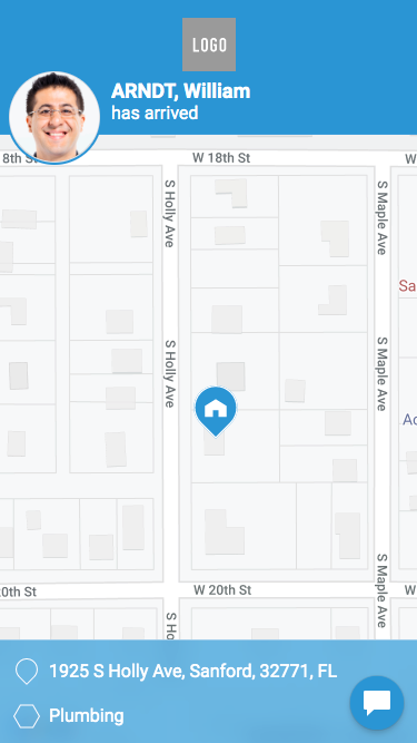

- On the Way: The technician is en route to the activity and the time of arrival (ETA) is available.

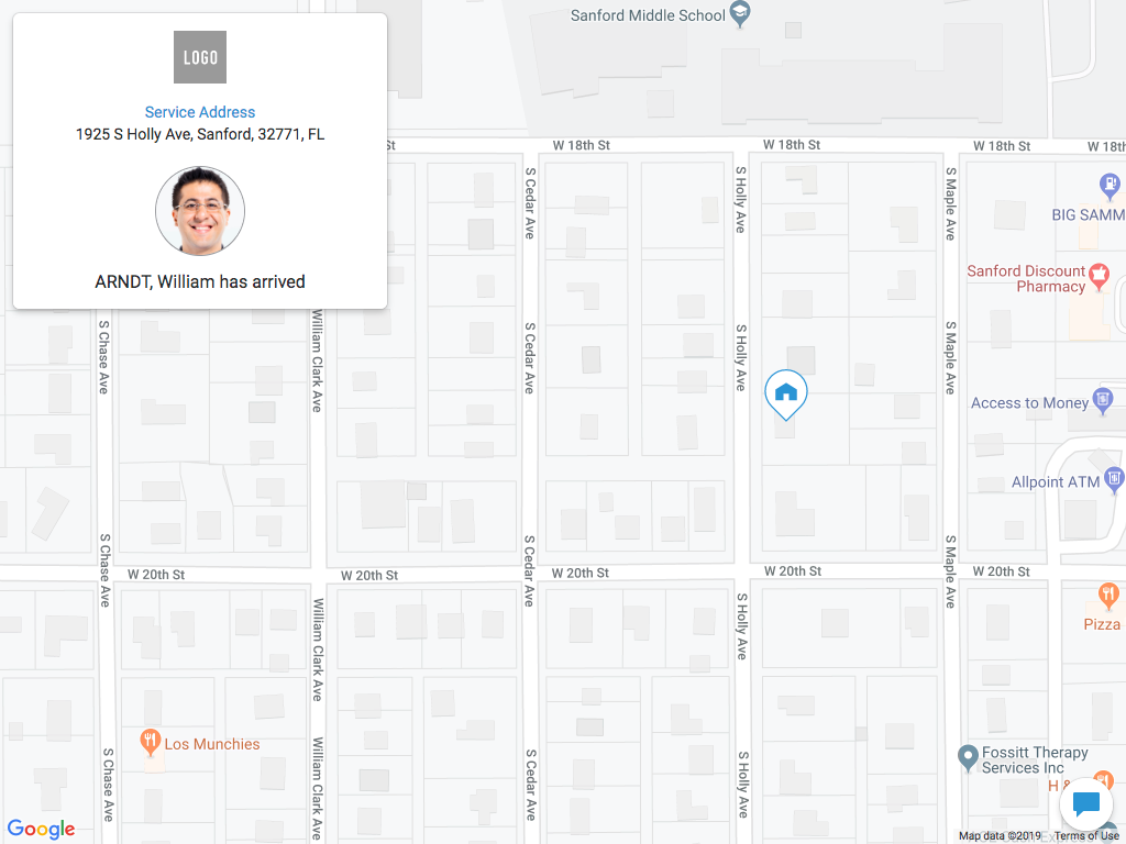

- Arrived: The technician has arrived and started the activity.

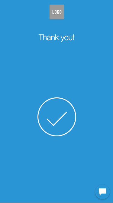

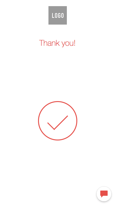

- Feedback: The technician has changed the activity to Complete, Not done, or Suspend.
To use the Where is My Technician feature, you must:
- Create a theme for Where is My Technician.
- Configure the theme with the required branding and other settings.
- Add a placeholder for the URL on your message text.
- Specify the theme label in the URL to determine the theme that you want to be accessed through the tracking link.
Other options that are added to themes in this update:
- Default theme: Now you can click the hamburger icon to set a theme as default. When you do so, ‘Default’ is displayed on the theme icon. You cannot delete a default theme.
- Disabling a theme: Now you can click the hamburger icon to disable a theme. When you do so, ‘Inactive’ is displayed on the theme icon. You can disable only those themes that are not used by any user.
CREATE A THEME FOR WHERE IS MY TECHNICIAN
You must create a theme for Where is My Technician to add the details that you want to show your customers. You can create multiple themes such as themes according to the services you provide (for example, telephone services, computer repair services), themes based on regional languages, or themes based on the preferences (such as location tracking enabled, feedback enabled). Users with the Oracle Field Service Cloud Professional subscription can create a maximum of five themes. And, users with the Oracle Field Service Cloud Enterprise subscription can create a maximum of 25 themes.
- Click Configuration, Themes.
- Under Where is My Technician, click Add new.
- On the Add WMT Theme page, enter a label for the theme. Later, you have to add this label to a message scenario to get the URL, so enter a meaningful label.
- Enter a description for the theme.
- Click Add. The Edit theme page appears. You can continue with creating the theme, or you can click Save and edit it later.
CONFIGURE A THEME
You must configure a theme after you create it. You configure a theme to select a template, specify your branding details, select the tracking details, and decide whether you want to let customers provide feedback for the technician and the service.
- Under Where is My Technician, click Edit on the stack icon for the Where is My Technician theme of your choice.

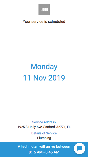

- To add branding to the theme, click Branding and:
- Select the template that you want to use from Bright, Hero, and Minimal templates. Notice that the Scheduled, Days before, On the way, Arrived, and Feedback pages refresh with each detail that you add to the theme.
- In the Main color field, click the hexadecimal number and select a color of your choice. This is the color in which the text is displayed.
- In the Background color field, click the hexadecimal number and select a color of your choice. This is the background color of the page. Your customers may access this page from their mobile phones and the screen width is limited, so choose the colors carefully. If you have selected the Hero template, you can use the Background picture option and upload a custom photo.
- In the Company logo field, click Browse and select a file with the extension JPEG, PNG, GIF, TIFF, or SVG. You can select a file of maximum size 100 KB. This logo is displayed at the top of the screen.
- In the Company favicon field, click Browse and select a file with the extension ICO or PNG. You can select a file of maximum size 30 KB. This is the small icon is displayed on the web page header. It is typically a smaller image of your organization or product logo.

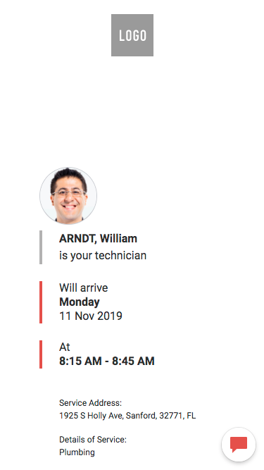

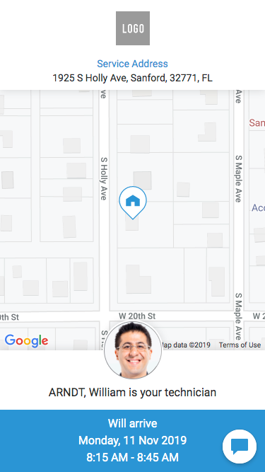

- To add the technician and map details, click Technician and Map and:
- In the Technician name field, select whether you want to display the technician’s name or the credence. You can choose any custom resource property that has the GUI set as Text element.
- Select the Show resource photo check box, if you want to display the technician’s photo. If you don’t select the check box, no photo is shown.
- Select the Show position on the map check box, if you want to let the customer track the technician’s location. If you don’t select this check box, only the customer’s location is shown.
- In the Technician icon field, select an icon from the drop-down list or, click Browse and select a custom icon. This icon indicates the technician’s location. If you select an icon from the drop-down list, its color changes to the colors you have selected in the Branding tab. If you select a custom icon, you can also select the position of the icon on the map. If a technician doesn’t share the location, or is offline for a long time, then only the customer’s location is displayed on the map. If neither the technician's location nor the customer's location is available, only a blue map is displayed.
- In the Location icon field, select an icon from the drop-down list or, click Browse and select a custom icon. This icon indicates the location of the activity. If you select an icon from the drop-down list, its color changes to the colors you have selected in the Branding tab. If you select a custom icon, you can also select the position of the icon on the map.
To customize the text, click Localization and:
- In each field, enter the text that you want to display, based on your business requirements.
- Click the question mark icon to view the description and default text of the field.
- Place the cursor at the required position, click the question mark, and then click Available placeholders. The data field is inserted at the selected location. Let’s say you want to change ‘{TECHNICIAN_NAME} is your technician.’ to ‘Your technician is ‘{TECHNICIAN_NAME}’. Delete the existing text and add ‘Your technician is’. Place the cursor after ‘is’. Click the question mark icon and then click ‘{TECHNICIAN_NAME}’ under Available placeholders.
- Optionally, clear the custom text to view the default text.

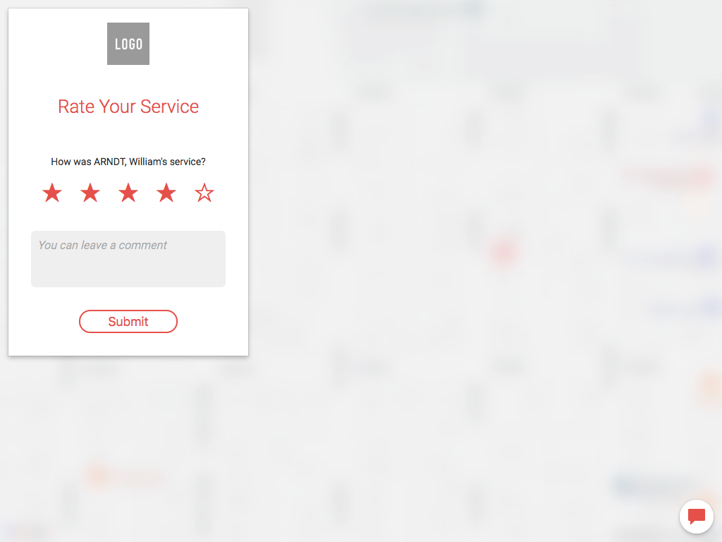

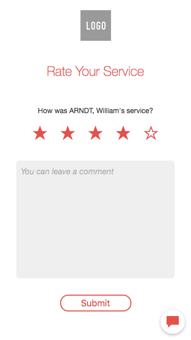

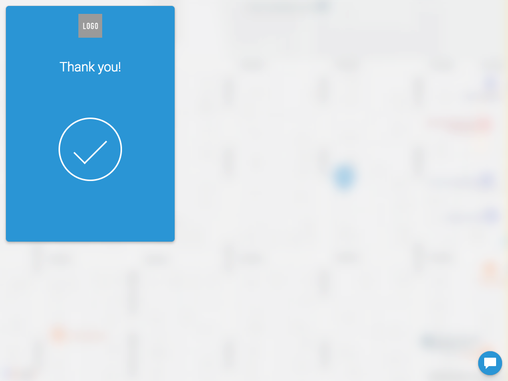

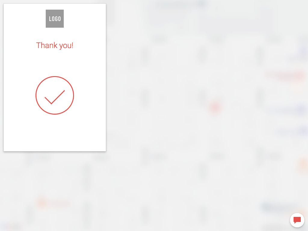

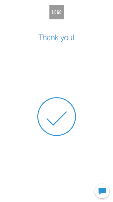

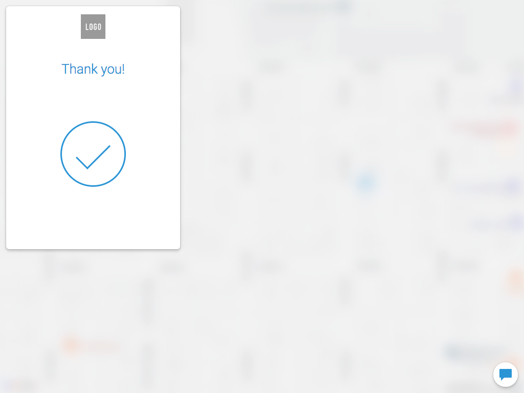

To add the Feedback page, click Feedback and:
- Select the Enable feedback check box to let your customers send feedback.
- Select an option for the Feedback mode field. You can choose from Comment and Rating, Comment, and Rating.
- In the Property for saving comments field, select the property that you want to use to store the comments.
- In the Property for saving rating field, select the property that you want to use to store the ratings.
- In the Localization field, customize the text that you want to display on the Feedback page. For more information on this, see Step 5.
If you want your customers to chat with a chatbot, ensure that you have a license for Oracle Digital Assistant. Verify that your administrator has created a web channel and configured the chatbot flow in Oracle Digital Assistant. Click Communication and:
- Select the Enable chatbot check box.
- Enter the Application ID of the Oracle Digital Assistant instance.
- Click Save. Your settings are saved and the Where is My Technician theme is created.

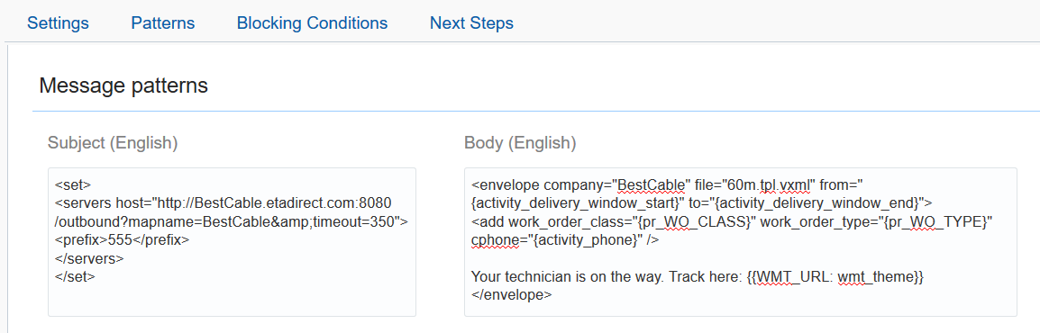

ADD A TRACKING URL TO A MESSAGE SCENARIO
You must add a placeholder to the 'Body' of the message step and specify the ‘Where is My Technician’ theme label to display the configured view and preferences on the tracking page.
- Go to Configuration, Message Scenarios.
- Click Modify on an existing message step or create a new step.
- Click Patterns and go to the Body section.
- Add the placeholder {{WMT_URL: label_theme}} (including the double braces) to the required position in the message body. Here, label_theme is the label of the Where is My Technician theme that you want to use.
A Message Scenario Body with the Placeholder for the Where Is My Technician Theme URL.
- Click Save. The WMT_URL placeholder is replaced with the tracking URL, when the message step is launched. The URL consists of the domain and a secure token that is specific for the activity. For example, https://w.etadirect.com/a784hk596 where https://w.etadirect.com/ is the domain and a784hk596 is the secure token. This URL is available for 90 days and expires after that. If your end-customer opens the URL after it expires, then they get the message, 'Oops. Seems that this URL is no longer valid and details are not available' on the page.

You can send the Where is My Technician tracking details through emails that are generated using Message Scenarios, email and SMS through gateway services, and through custom delivery channels. The custom delivery channels can be email or web-services that accept SOAP API requests.
- To use the email notification channel with Message Scenarios:
- Click Configuration, Message Scenarios.
- Create or modify a message step.
- On the Settings tab, Select "Email" for "Delivery Channel".
- Select 'Customer' for 'Recipient'.
- Open the Patterns tab and go to the 'Body' section.
- Add the placeholder {{WMT_URL: theme_label}} (with double braces) at the point where you want to add the link.
- Continue with creating or modifying the step.
- Click Save.

- Configure the ‘Messages' button for the Activity details screen.
- Open the Activity details screen for the activity for which the customer has to get the tracking URL.
- Click Messages.
- Use the Status, Delivery channel, Recipient filters. Or, use the 'Any' option. The messages that match the criteria appear.
- Find the message step for which you want to verify the URL.
- Click a line of the message step and verify the 'Body' text of the message. The URL must be present.

SCREENS OVERVIEW
Your customers view the tracking page according to the activity status and the theme configuration. The possible combinations of activity status and theme configuration are:
Screen: Scheduled Description: Information about a scheduled activity shown when the activity is in a 'pending' status and not assigned to the technician yet. Information:
- Activity date [date] is shown, when the activity is scheduled.
- Arrival time range - Delivery Window, or if it is absent, Service Window. This screen doesn't support SLA and Access hours.
- Service Address - a composition of activity address properties: Street address [caddress], City [ccity], Country Code [czip] and State Province [cstate].
- Details of Service - Activity Type [aworktype].
Screen: Scheduled; Template: Bright; Image: Mobile
Screen: Scheduled; Template: Bright; Image: Desktop
Screen: Scheduled; Template: Hero; Image: Mobile
Screen: Scheduled; Template: Hero; Image: Desktop
Screen: Scheduled; Template: Minimal; Image: Mobile
Screen: Scheduled; Template: Minimal; Image: Desktop
Screen: Assigned Description: Information about a technician is shown when the activity is assigned to a technician, but the technician has other work to finish first. Information:
- Technician's name - a resource property which is configured for a theme, Name [pname] - by default.
- Technician's photo (if "Show resource photo" option is enabled at the theme configuration).
- Activity date [date] - is shown, when the activity is scheduled.
- Arrival time range - Delivery Window, or if it is absent - Service Window. This screen doesn't support SLA and Access houres.
- Details of Service - Activity Type [aworktype]. This field is hidden for the Bright template.
Screen: Assigned; Template: Bright; Image: Mobile
Screen: Assigned; Template: Bright; Image: Desktop
Screen: Assigned; Template: Hero; Image: Mobile
Screen: Assigned; Template: Hero; Image: Desktop
Screen: Assigned; Template: Minimal; Image: Mobile
Screen: Assigned; Template: Minimal; Image: Desktop
Screen: On the Way Description: 'On the way' screen is shown when a technician completes a previous activity (if any), and goes to the end-customer’s location. Information:
- Technician's position and route to the activity address (if "Show position on the map" option is enabled at the theme configuration).
- Estimated time of arrival - a number of minutes or hours till the technician arrives. Is calculated as Activity Start Time [eta] - current time. If the technician is late - a phrase "in less than 1 minute" is displayed.
Screen: On the Way; Template: Bright; Image: Mobile
Screen: On the Way; Template: Bright; Image: Desktop
Screen: On the Way; Template: Hero; Image: Mobile
Screen: On the Way; Template: Hero; Image: Desktop
Screen: On the Way; Template: Minimal; Image: Mobile
Screen: On the Way; Template: Minimal; Image: Desktop
Screen: Arrived Description: Information about the technician is shown when the technician has started the activity. Information:
- Technician's name - a resource property which is configured for the theme, by default it's Name [pname].
Screen: Arrived; Template: Bright; Image: Mobile
Screen: Arrived; Template: Bright; Image: Desktop
Screen: Arrived; Template: Hero; Image: Mobile
Screen: Arrived; Template: Hero; Image: Desktop
Screen: Arrived; Template: Minimal; Image: Mobile
Screen: Arrived; Template: Minimal; Image: Desktop
Screen: Feedback Description: Feedback screen is shown, if the "Enable Feedback" option is selected on the theme configuration and the user hasn't provided the feedback yet. If the user has provided the feedback, or if the feedback form is disabled, the "Thank you!" screen is shown. This is the final screen.
Screen: Feedback--Rating and Comments; Template: Bright; Image: Mobile
Screen: Feedback--Rating and Comments; Template: Bright; Image: Desktop
Screen: Feedback--Thank you; Template: Bright; Image: Mobile
Screen: Feedback--Thank you; Template: Bright; Image: Desktop
Screen: Feedback--Rating and Comments; Template: Hero; Image: Mobile
Screen: Feedback--Rating and Comments; Template: Hero; Image: Desktop
Screen: Feedback--Thank you; Template: Hero; Image: Mobile
Screen: Feedback--Thank you; Template: Hero; Image: Desktop
Screen: Feedback--Rating and Comments; Template: Minimal; Image: Mobile
Screen: Feedback--Rating and Comments; Template: Minimal; Image: Desktop
Screen: Feedback--Thank you; Template: Minimal; Image: Mobile
Screen: Feedback--Thank you; Template: Minimal; Image: Desktop

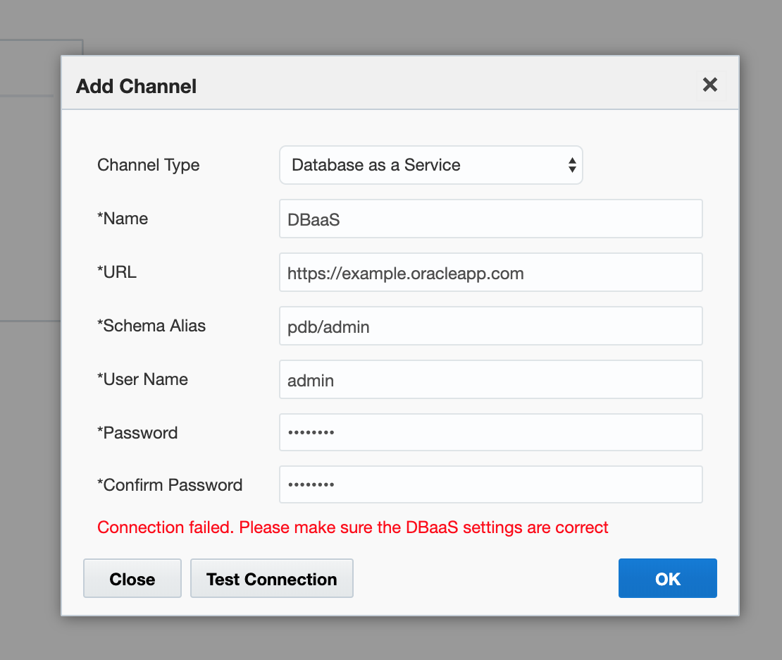

New Warning Messages in Outbound Channels
The Outbound Integration page has been enhanced with update 19D. It displays new error messages or warning messages related to Oracle Analytical Cloud (OAC) and Oracle Database as a Service (DBaaS) integration.
Here is the list of warning messages:
- Connection failure
- Configuration issue exists between ORDS and DBaaS
- Number of Columns exceeds 1000 warning message
- Host Unreachable Message

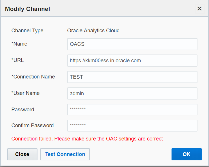

CONNECTION FAILURE
The system displays a warning message to indicate that it is a test connection failure.
Test Connection Failure Warning Message
Such warning messages occur due to the following reasons:
- the Database as a service connection is invalid or not configured in OAC
- the user name for Database as a service configuration contains uppercase characters.
- OAC returns 500 HTTP status code.
CONFIGURATION ISSUE EXISTS BETWEEN ORDS AND DBAAS
The system displays a warning message due to configuration issue between Oracle REST Data Services (ORDS) and DBaaS.
Configuration Issue Exists Between ORDS and DBaaS Warning Message

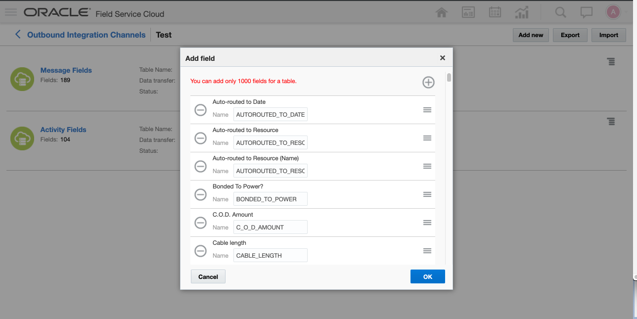

NUMBER OF COLUMNS EXCEED 1000 WARNING MESSAGE
In case of BICS/OACS/DBaaS configurations, the maximum fields you can add for an entity is limited to 1000. If you try to add more fields, the system displays a warning message.
Number of Columns Exceed 1000 Warning Message

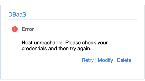

HOST UNREACHABLE MESSAGE
In BICS /OAC/DBaaS channels, the host must be reachable within 7 days. If the host is not reachable for more than 7 days, the system displays an error message.
Host Unreachable Warning Message
Fix the issue or change the current configuration and then try to establish the connection between Oracle Field Service Cloud and the Outbound channel.

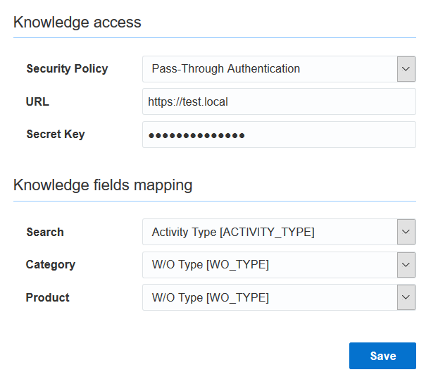

CONFIGURE PASS-THROUGH AUTHENTICATION (PTA)
Follow these steps to configure the PTA:
- Click Configuration, Oracle Knowledge.
- Oracle Knowledge is displayed on the Configuration screen, only if you have a license for it:
Configuration Settings for Oracle Knowledge Access in Oracle Field Service Cloud
- Complete these fields:
| Field | Description |
| Security policy | The security policy that you want to use to connect to Oracle Knowledge Advanced. Select Pass-Through Authentication. |
| URL | The URL to access the knowledge base. |
| User Name | User name is a concatenation of your Oracle Field Service Cloud user name and the string &p_li_passwd followed by the value of PTA_SECRET_KEY. For example, 'john.smith&p_li_passwd=ThisIsASecret'. |
| Password | Your Oracle Field Service Cloud password. |
| Knowledge fields mapping | Provides the possibility to configure the parameters of the context search and filtering, based on activity properties. Select the desired search, category, and product properties from the drop-down lists. |
- Click Save.
See the PTA guide (select the latest version) for more information about the configuration settings.

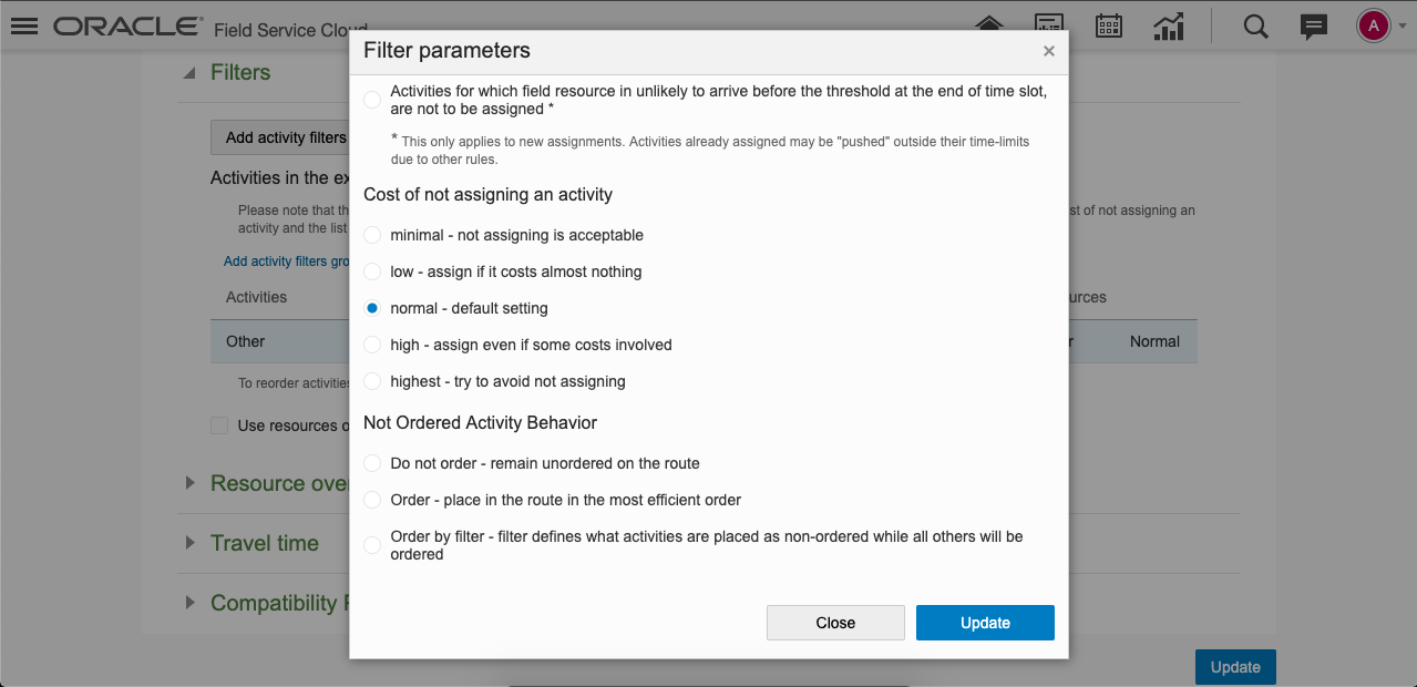

Starting update 19D, the Automatic Ordering feature is renamed to Not Ordered Activity Behavior. In addition to Order or Not Order you can select the Order by filter option in the Not Ordered Activity Behavior field in the Add or Edit Routing Plan dialog. The application places activities without service windows on the route in the most efficient order but does not assign a time slot. In this case, resources decide when to do the work. Not Ordered Activity Behavior can help you complete more activities over the course of the day, but it also reduces the resources’ ability to use their own judgment in completing activities.
Steps to Enable

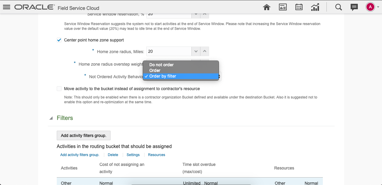

You can alter Not Ordered Activity Behavior option for the routing plan at a filter level.
Follow these steps:
- In the Add/Edit Routing Plan, navigate to the Not Ordered Activity Behavior field before the Filters section:
Edit Routing Plan Dialog
- In the Not Ordered Activity Behavior field, select the Order by filter option and click Update.
- Alternatively, you can set this option in the Filter Parameters dialog:
Filter Parameters Dialog
For each filter, select one of these options in the Not Ordered Activity Behavior field and click Update:
- Do not order option if you do not want to change the activity ordering status – status of all activities will be as Ordered after the routing,
- Order option if you want to make all of the activities as automatically ordered during the routing plan. This is a default value for new routing plans.
- Order by option if you want to make all eligible activities as automatically ordered or unordered during the routing plan.
By default, when you choose the Order by filter option for Not Ordered Activity Behavior on routing plan level, all activity filters will have their Not Ordered Activity Behavior set to Order. The same setting is default for newly added filters.
NOTE: When creating, routing plans will have Not Ordered Activity Behavior on routing plan level set up to Order. You must manually set this option.

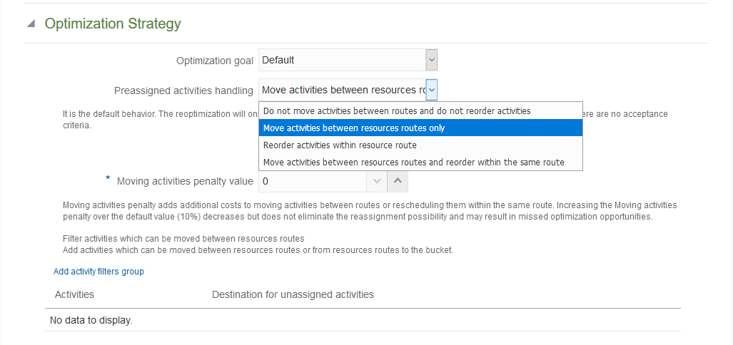

To set travel optimization within a single route, follow these steps.
- Navigate to the Routing screen.
- Select the routing plan that you want to modify in the list and click the Modify link.
- In the Modify routing plan dialog, expand the Optimization Strategy section and select an Optimization goal from the drop-down list:
Preassigned Activities Handling Field in the Optimization Strategy Section
- In the Preassigned activities handling field:
- Choose Do not move activities between routes and do not reorder activities option if you want routing plan to add activities to existing routes without moving existing preassigned activities either between resources or within the same route.
- Choose Reorder activities within resource route option for the routing plan to reorder activities within the same route but not moving them between different providers routes.
- Choose Move activities between resources routes only and reorder within the same route option for the routing plan to reassign activities but keep the order of activities in the same route unchanged.
- Choose Move activities between resources routes and reorder within the same route option so that the routing plan can both reassign and reorder activities.
- Based on the selected option, internal routing optimization strategy is tweaked for better achieving the goal.
- To manage chances activities being moved within different routes, set the value in the Moving activities penalty value field.
- If you set this value to 0, activities are moved whenever there are better routes according to selected optimization goal and routing plan settings.
- The higher this value is, the bigger gain such a reassignment should bring for being applied, otherwise routes remains unchanged.
- If the route reordering is applied, it allows routing improvement according to selected optimization goal and routing plan settings.
- Click Update to save your changes.
