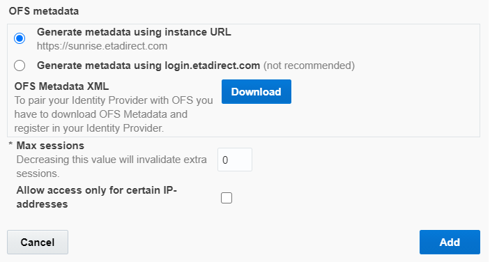

| Generate metadata using instance URL |
The URL to log in is constructed using the instance URL. This is the recommended way and is the default option for all new SAML Login Policies. The URL displayed in the screenshot that is given after this procedure is just an example. The URL for your organization is based on your instance name and is displayed under this field in the application. |
| Generate metadata using login.etadirect.com |
The URL to log in is login.etadirect.com. This is the non-recommended way and the option selected for existing SAML Login Policies. |

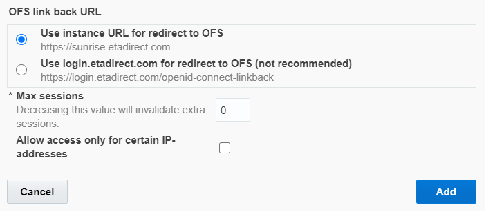

| OFS link back URL |
| Use instance URL for redirect to OFS |
The URL is constructed using the instance URL. This is the recommended way and is the default option for all new OpenID Connect Login Policies. The URL displayed in the screenshot that is given after this procedure is just an example. The URL for your organization is based on your instance name and is displayed under this field in the application. |
| Use login.etadirect.com for redirect to OFS |
The URL is login.etadirect.com. This is the non-recommended way and the option selected for existing OpenID Connect Login Policies. |
- In your OpenID application, configure a link back URL. Use the URL displayed on this dialog box for the option that you have selected. Your Identity Provider uses this link to redirect users to Oracle Field Service upon successful login.
- Click Add. The application generates the metadata based on the options you have selected. Use this metadata to link your identity provider with the instance. Note down the instance URL that you must use when setting up an external identity provider.
This screenshot shows the OFS metadata section for a Login Policy with the SAML authentication method:
OFS Metadata Section for a Login Policy with SAML Authentication Method
This screenshot shows the OFS link back URL section for a Login Policy with OpenID Connect authentication method:
OFS Link Back URL Section for a Login Policy with OpenID Connect Authentication Method

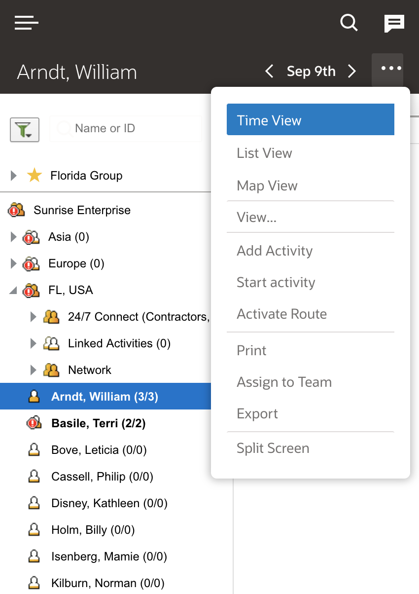

Print from Installed Applications

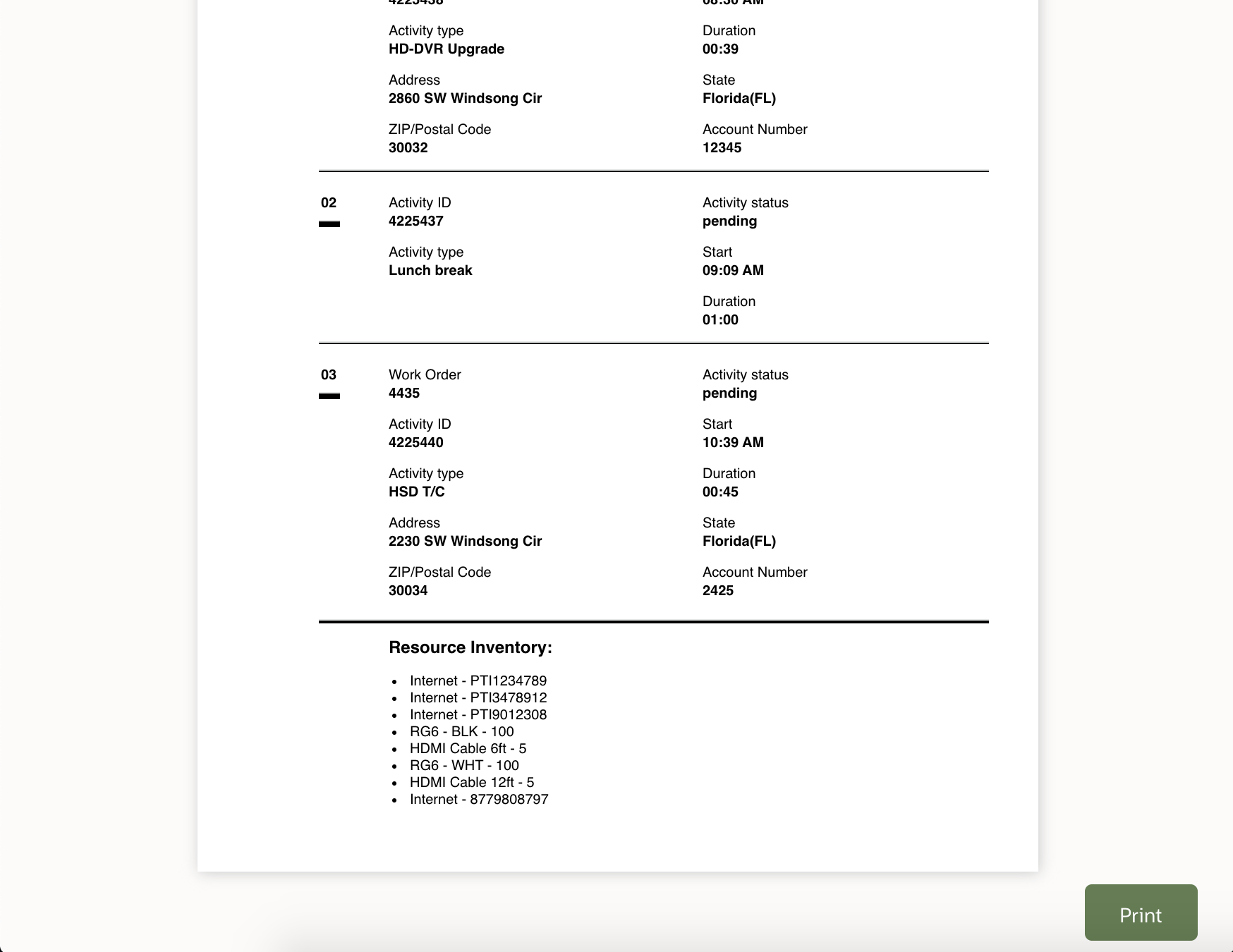

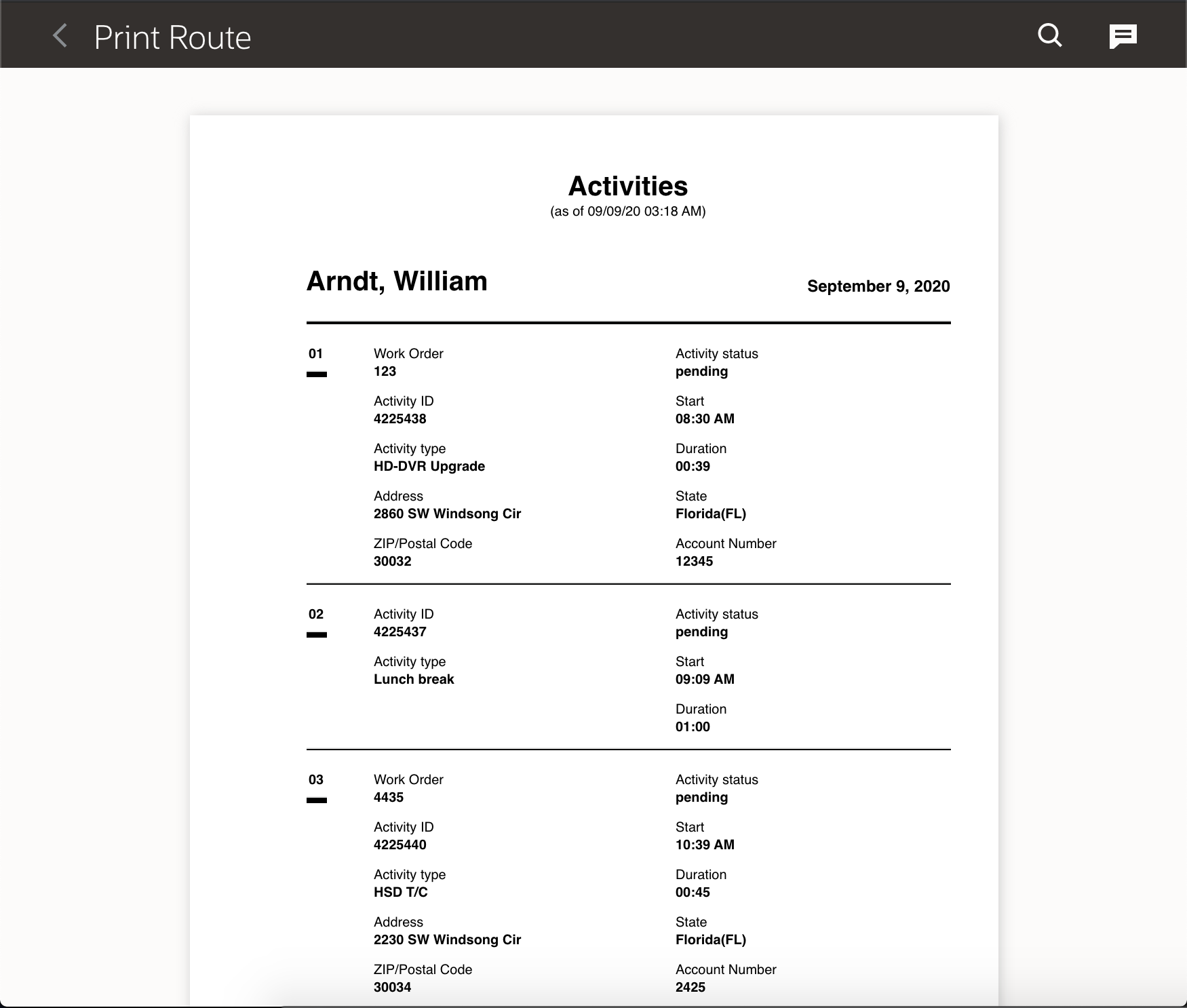

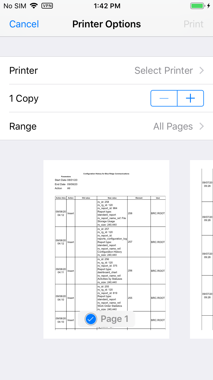

Starting Update 20D, you can now print files from within the installed application. All screens within the application that supports printing like Reports within Dashboards and the Print Route functionality are supported in the installed apps.
Print Functionality
The user can now click Print to access the device's native print functionality and print the file.
To print any screen, tap Print. A preview of the printed information appears. Tap Print to open the native Print functionality and complete printing.
Print with Custom Plugins
The users can use the openLink procedure of Plugin API to print files from within custom plugins. This procedure will open the link in the default system browser from where users can use the browser's print functionality to print the document.
The installed application allows you to print files using the standard Print dialog box.

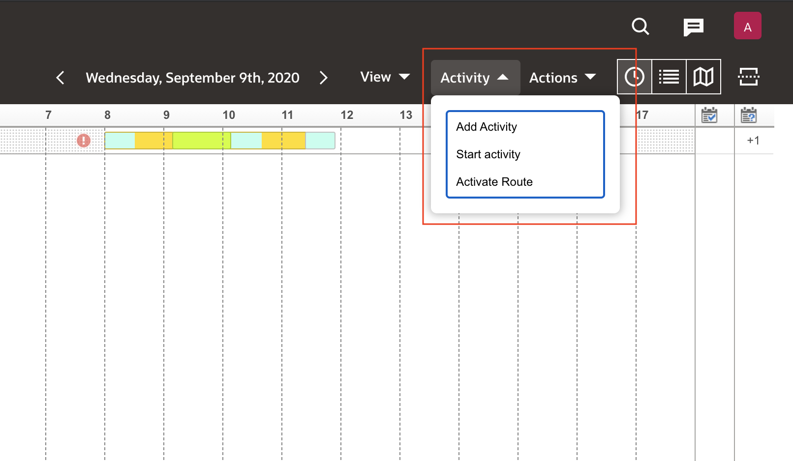

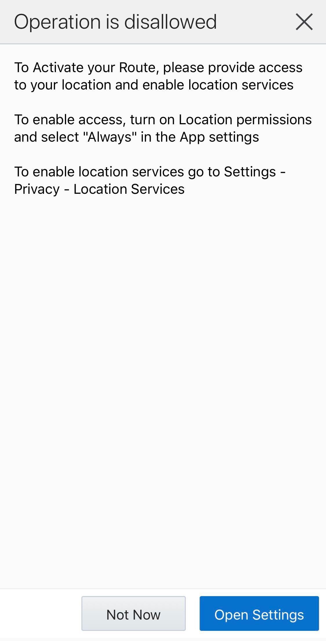

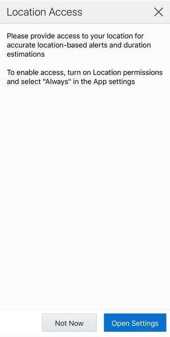

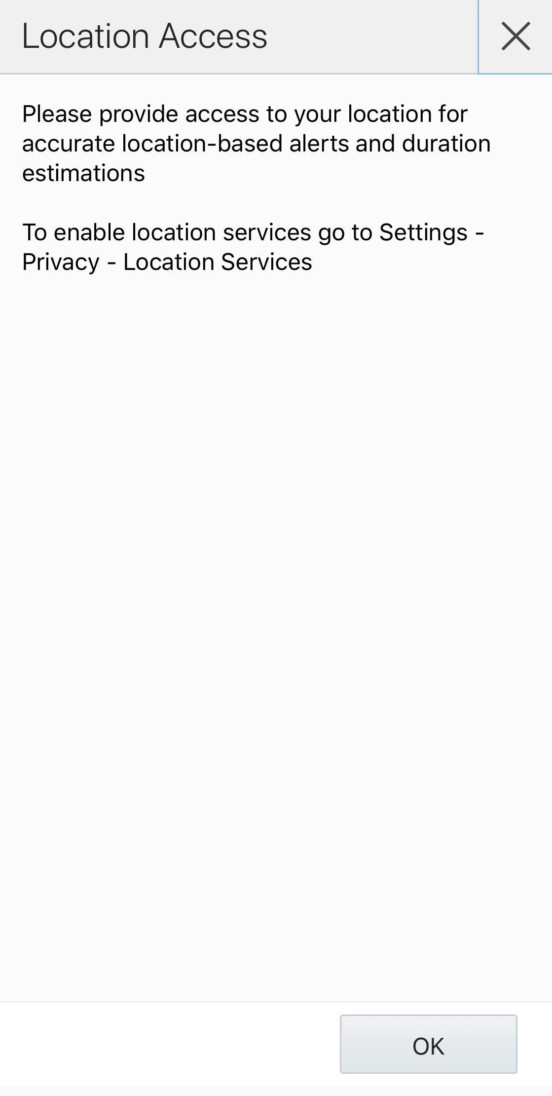

Request Location Permissions at Regular Intervals
The installed application need location permissions to access the location of the field resource to provide accurate location based alerts and duration estimations. If the field resource did not provide the location permissions previously, a prompt message to provide the required permissions appears when the user tries to activate the route.
If the 'Disable route activation when geolocation is not enabled on device' check box is disabled or, if the location services (GPS) is already turned ON but the field resource did not provide the location permissions, the application prompts the user to provide appropriate permissions. A prompt message displays the steps to provide location permissions. Click Open Settings to display the app settings screen where users can provide location permissions.
If the 'Disable route activation when geolocation is not enabled on device' is checked, the app identifies that the location services (GPS) are not turned ON and location permissions are not provided, the prompt message displays what needs to be done - notifies that the user has to provide location permissions and turn on location services. In such cases, users cannot Activate the route unless the location permissions are provided and the location services are turned ON.
If the 'Disable route activation when geolocation is not enabled on device' is unchecked, the user is not prevented from activating the route.
The installed application needs location permissions to access the location of the field resource to provide accurate location based alerts and duration estimations.

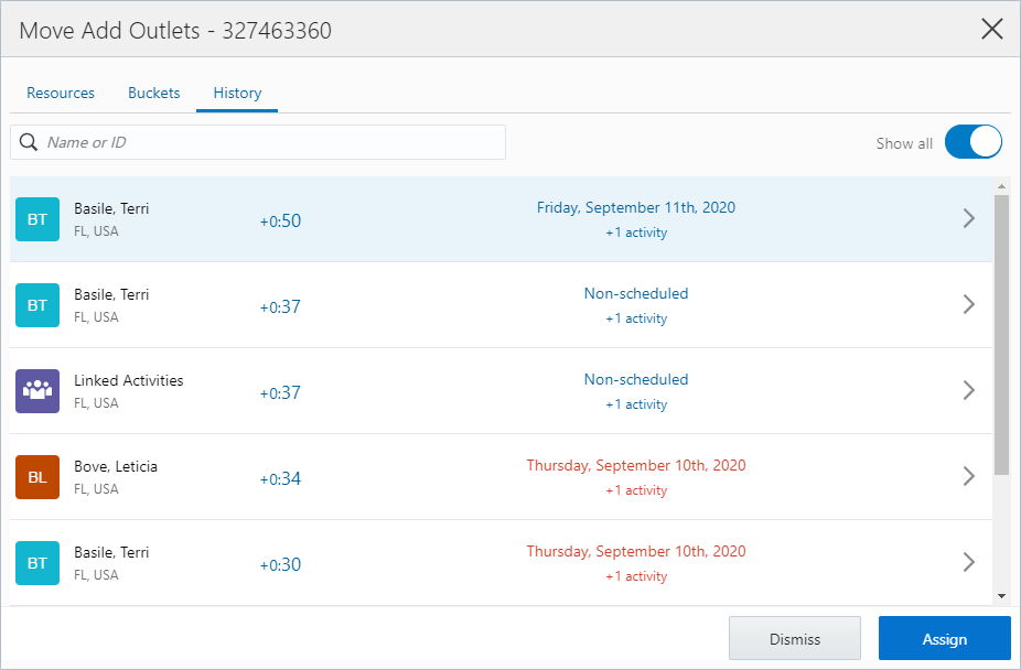

Link a Segmentable Activity with a Segmentable Activity using REST APIs
Starting with Update 20D, you can use the REST APIs to link a segmentable activity with another segmentable activity using the same link types that you use to link a regular activity with a segmentable activity.
This includes updates to the following Core API functions:
- Create an activity link: POST /rest/ofscCore/v1/activities/{activityId}/linkedActivities
- Replace an activity link: PUT /rest/ofscCore/v1/activities/{activityId}/linkedActivities/{linkedActivityId}/linkTypes/{linkType}
To route a linked segmentable activity:
- Run the multiday routing plan where the segmentable activities fit the filters.
- Set a Bulk routing plan running for a scheduled time to cover all the linked segmentable activities that you want to route.
NOTE: Only Bulk routing supports routing linked segmentable activities. Immediate routing ignores all segmentable activities that have links.
Supported Link Types and Constraints
Here are the link types and constraints that are supported for the links between segmentable activities:
- Simultaneous (Segmentable and Segmentable activities): No constraints available
- Segmentable activity Finish to Segmentable activity Start:
- Same Day: Earliest (as of calendar means) segment of a latter activity must start the same day as the latest (as of calendar means) segment of the former activity finishes
- Same Provider: All segments of the latter activity must be done by the same resource(s) that participated in any segment of the former activity.
- Different Providers: All segments of the latter activity must be done by different resource(s) than those that participated in any segment of the former activity.
- Segmentable activity Start to Segmentable activity Start:
- If you try to add an unsupported activity link type and/or a constraint, a warning is displayed and no link is added.
- For Segmentable Activity Start linked to Regular Activity Start (or the reverse):
REST APIs can now be used to link a segmentable activity with another segmentable activity.

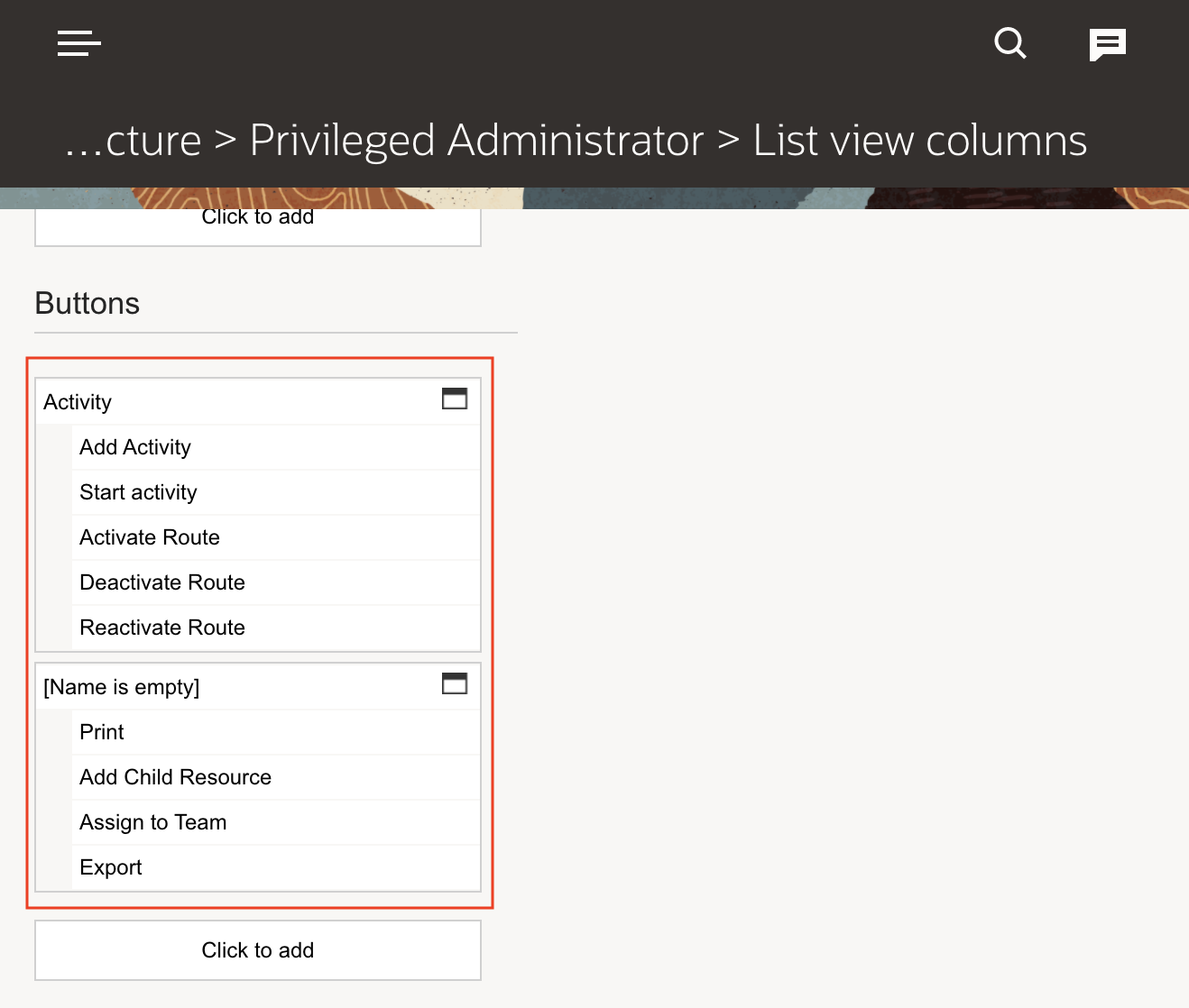

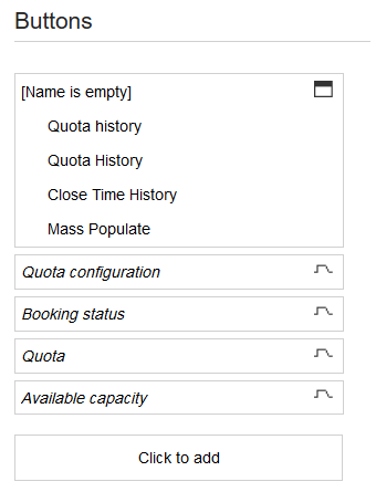

Configure Quota Page as Read-Only
Earlier, you could configure the visibility to the Quota page menu items such as Booking status, Quota, and Available capacity only in Legacy Manage. Starting with Update 20D, you can configure read-only or read-write access to each user type for the Booking status, Quota, and Available capacity pages in Core Application.
NOTE: The visibility level of the Main menu item does not control the access level for the Booking status, Quota, and Available capacity pages anymore. You must configure the visibility levels for each of these pages separately.
All the existing configurations will be migrated to maintain the previously-granted access level, so that the access level of each User Type to Quota page is the same after you upgrade to Update 20D.
Configure the Visibility for Booking Status, Quota, and Available Capacity Pages
- Click Configuration, User Types.
- Click the user type for which you want to add or modify the visibility for the Quota pages.
- Click Screen configuration.
- Expand Application screens and click Quota. Booking status, Quota, and Available capacity are displayed in the Buttons section. This screenshot shows the Booking status, Quota, and Available capacity buttons on the Quota context layout structure:
Booking Status, Quota, and Available Capacity Buttons on the Quota Context Layout Structure
- Click an item of your choice. Click Modify in the visibility table.
- Click the access mode of your choice and then click Save.
You can now configure read-only or read-write access to each user type for the Booking status, Quota, and Available capacity pages in Core Application.

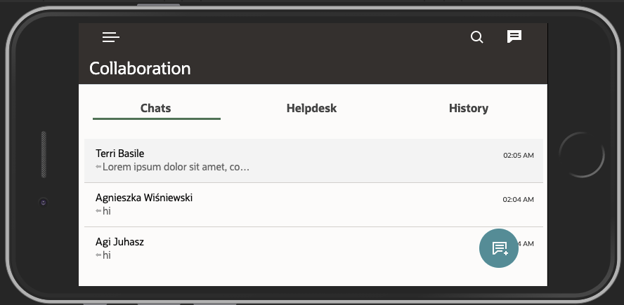

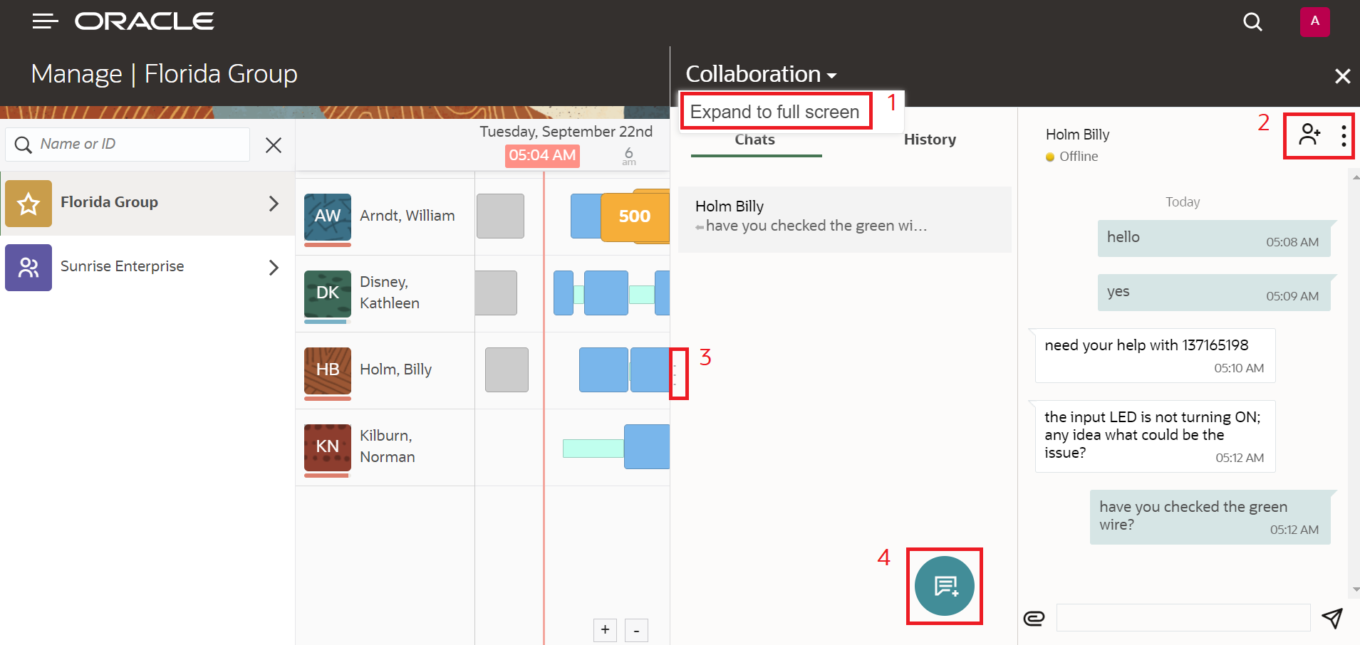

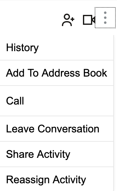

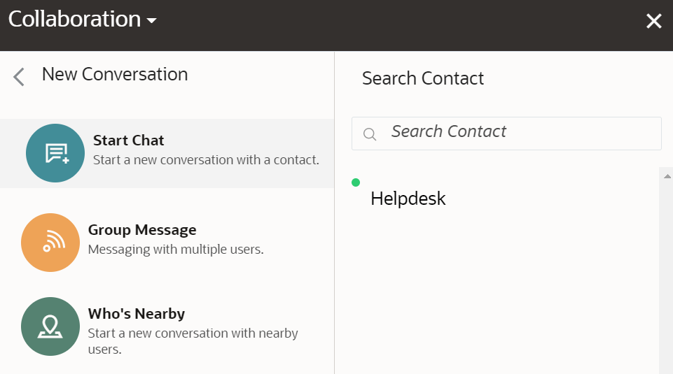

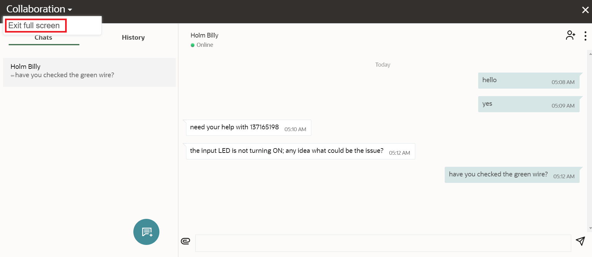

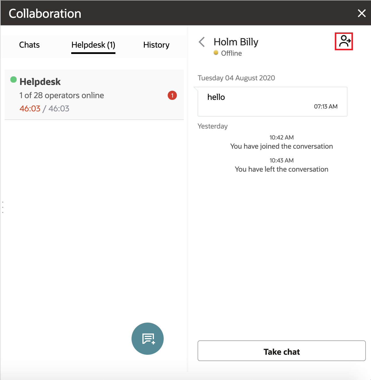

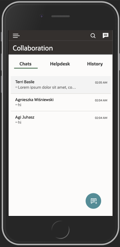

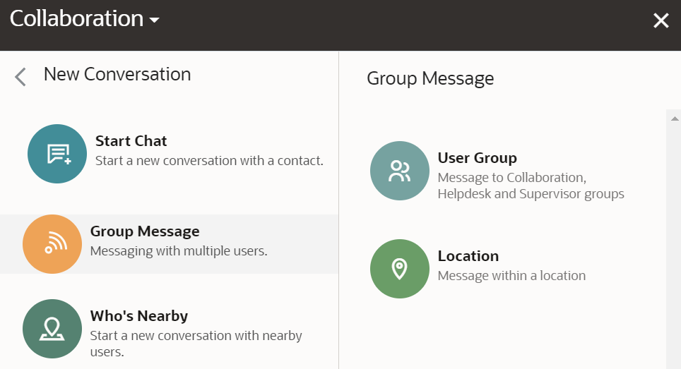

Collaboration Redesign and Improvements
Earlier, Collaboration opened as a new window. Starting with Update 20D, these improvements are available:
- You can attach the Collaboration window to your working page and view it in full-screen mode. All the message notifications are available on this page, so you don’t have to leave the page.
- If you are working with multiple monitors, you can open the Collaboration window in one monitor and the remaining Oracle Field Service pages in another monitor. You can also view the count of unread chats in the monitor were you have closed the Collaboration window.
- You can resize the Collaboration window by selecting the drag option highlighted in the image. Drag it to the left side of the monitor to increase the width. You can also use the Expand to full screen button to see the Collaboration window in full-screen mode. You can resize the window to a maximum of 60% of the screen size. However, the Collaboration window is always displayed in full-screen mode in small devices, regardless of whether the screen is Portrait or auto-rotate mode.
- The Collaboration window appears as a dual-pane with the left pane showing the list of the active chats, helpdesk chats (for a helpdesk operator), and history chats. The right pane shows the details of the selected chat.
- You can use "X " to close the Collaboration window.
- The chats and helpdesk tabs show the number of unread chats as badges on the corresponding tabs.
- You can start a new conversation by clicking the start chat icon. You can initiate a one-to-one conversation by selecting a contact from the contact list, a Group message by selecting a group of users, or a new conversation with nearby users by selecting the Who’s Nearby option.
- When there are no active chats in the Collaboration or Helpdesk chats, you can see the Start new conversation option by default. The remaining chat options are available as menu items.
- You can add a user to an active chat by clicking the icon.
- You can start a video call directly from the Collaboration window by clicking the Start Video Call icon from the active Collaboration window.
NOTE: You must have a subscription to Oracle Field Service Enterprise edition to use the video call feature.
- If you are a helpdesk operator, you can select the helpdesk chats from the Helpdesk tab within the Collaboration window. There is no separate Collaboration icon for the helpdesk chat.
- Helpdesk operators can use the transfer chat icon to transfer a chat. Helpdesk operators can monitor the chats that are in progress, using the Chats in process option within the Helpdesk tab.
- The size of chat bubbles change dynamically, based on your device size and the size of the message.
This screenshot shows the Collaboration window on a working page:
Collaboration Window on a Working Page
Legends:
1: The Expand to Full Screen button with which you can view the Collaboration window in full-screen mode.
2: The Invite user icon with which you can invite a user to a conference.
3: The Drag option with which you can resize the Collaboration window.
4: The New conversation icon with which you can start a new conversation.
This screenshot shows the Collaboration window in full-screen mode:
Collaboration Window in Full-Screen Mode
This screenshot shows the New conversation option:
New Conversation Option on the Collaboration Window
This screenshot shows the new Group Message option:
New Group Message Option on the Collaboration Window
This screenshot shows the Helpdesk chat pane and the transfer chat icon highlighted:
This screenshot shows the Options menu:
Options Menu
This screenshot shows the Collaboration window in portrait mode on a small screen device:
Collaboration Window in Portrait Mode on a Small Screen Device
This screenshot shows the Collaboration window in landscape mode on a small screen device:
Collaboration Window in Landscape Mode on a Small Screen Device

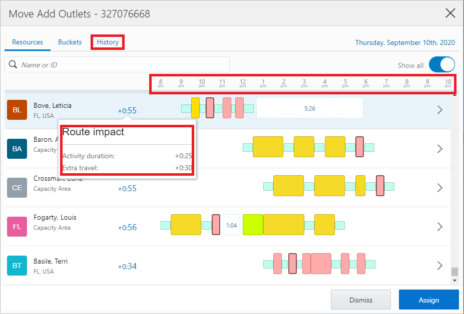

Assignment Assistant Improvements
Earlier, the Main screen of Assignment Assistant provided the overall impact of moving an activity to a route. Starting with Update 20D, the Assignment Assistant includes these improvements:
Hint for Route Impact
You can now see the duration of the activity being moved and the extra travel time required for the activity on the hint in the Route impact column. Click the column to see the hint.
This screenshot shows the main page of the Assignment Assistant with the History, time scale, and route impact highlighted:
Assignment Assistant with History, Time Scale, and Route Impact Highlighted
History Page
If you have moved at least one activity in the current session, you can see the History page. Use the History page as a quick access page to assign activities to the same resource several times. The page contains a list of technicians and buckets, and is sorted by the time of move, with the last moved activity on the top. For each resource you can see the route impact, activity date, and the number of activities moved. You may see some resources listed multiple times. For example, let’s say you have moved activities to a resource twice, for different dates. Then, the resource is listed twice.
Assign an activity from the History page:
- From the list of resources, determine the resource and the date for which you want to assign.
- Click Assign. The number of activities moved to the resource for the selected date changes. If there are warnings to move the activity to a resource, the date is displayed in red.
- To review the route details of the resource, click the details icon.
This screenshot shows the History page:

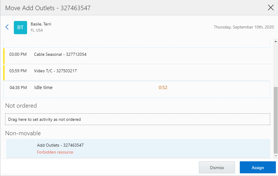

Non-Movable Section
You see the Non-movable section on the Route details page, when you cannot assign an activity to the current resource. For example, let’s say you try to drag-and-drop an activity to a resource that is set as 'Forbidden' for the activity. The activity is then displayed in the Non-movable section and you cannot drag it to other sections as well.
This screenshot shows the Non-movable section on the Route details page:

Earlier, there were two context layouts for printing a resource’s route. Further, the print layout generated by the application was not user-friendly. Starting with Update 20D, these improvements are made in the Dispatch Console:
One Context Layout for Printing Routes
There were two context layouts under the Application screens section on the Screen configuration page 'Activity fields for print' and 'Print Route'. The 'Activity fields for print' layout is removed and the 'Print Route' context layout is used to configure fields for the Print Route functionality. Further, there were a set of nine fields that were always included on the Print Route screen - Start, Type, Work Order, Service Window, Account Number, Name, Address, ZIP/Postal Code and Phone. These fields are no longer included by default. You must configure the fields to be displayed on the Print Route page, using the 'Print Route' context layout.
NOTE: The application can print a maximum of 1000 activities at a time using the Print Route function. If there are more than 1000 activities, only the first 1000 activities are displayed with a note.
All the configured fields for the selected resource or bucket are displayed and printed in this layout. In addition to the configured fields, the list of inventory in the Resource pool is displayed at the bottom.
This screenshot shows the activity details printed using the Print Route option:
This screenshot shows the inventory details printed at the end of the report:

Multiple Action Sections and Buttons in the Header
If you had configured any Actions and Groups of Actions separately under the 'List view columns' context layout, they now appear as separate actions or groups in the Dispatch Console header, if there is enough space.
This screenshot shows the actions and group of actions configured for the List view:
This screenshot shows the multiple actions and group of actions configured on the Dispatch Console:
As earlier, in smaller screens the Actions appear in the options menu in the top right corner based on the available space.
This screenshot shows the multiple actions and group of actions on a small screen:

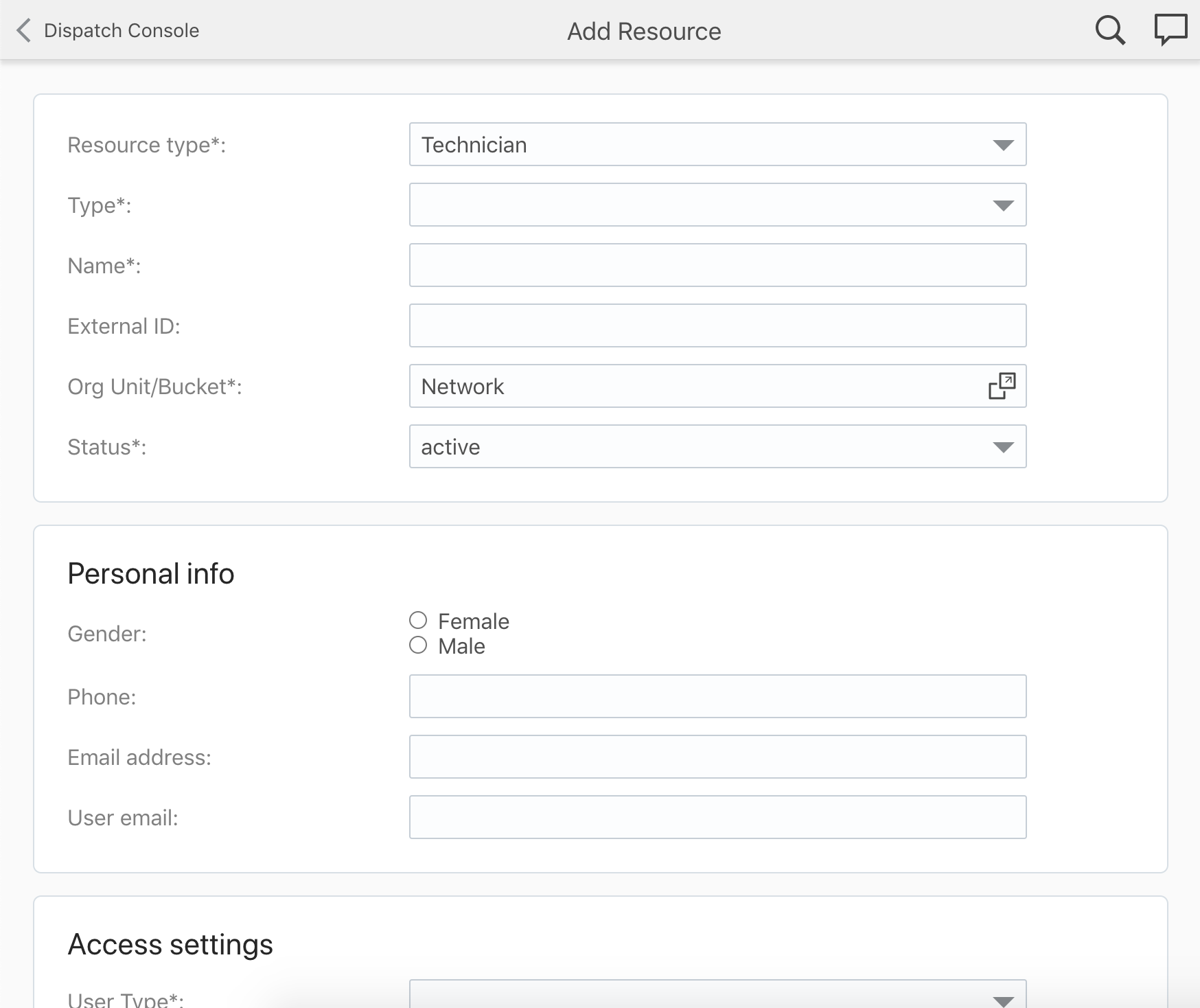

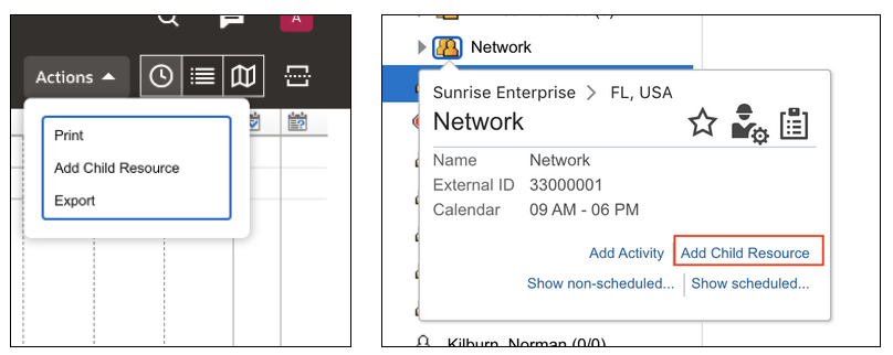

Add Child Resource Based on Core Application
When you clicked 'Add Child Resource' action from the Actions menu or the resource hint in the Dispatch Console, the screen displayed was based on the context layout from Legacy Manage. 'Add Child Resource' now displays based on the context layout of Core Application.
This screenshot shows the Add Child Resource option from the Actions menu and the resource hint:
This screenshot shows the Add Child Resource page based on the context layout of Core Application:

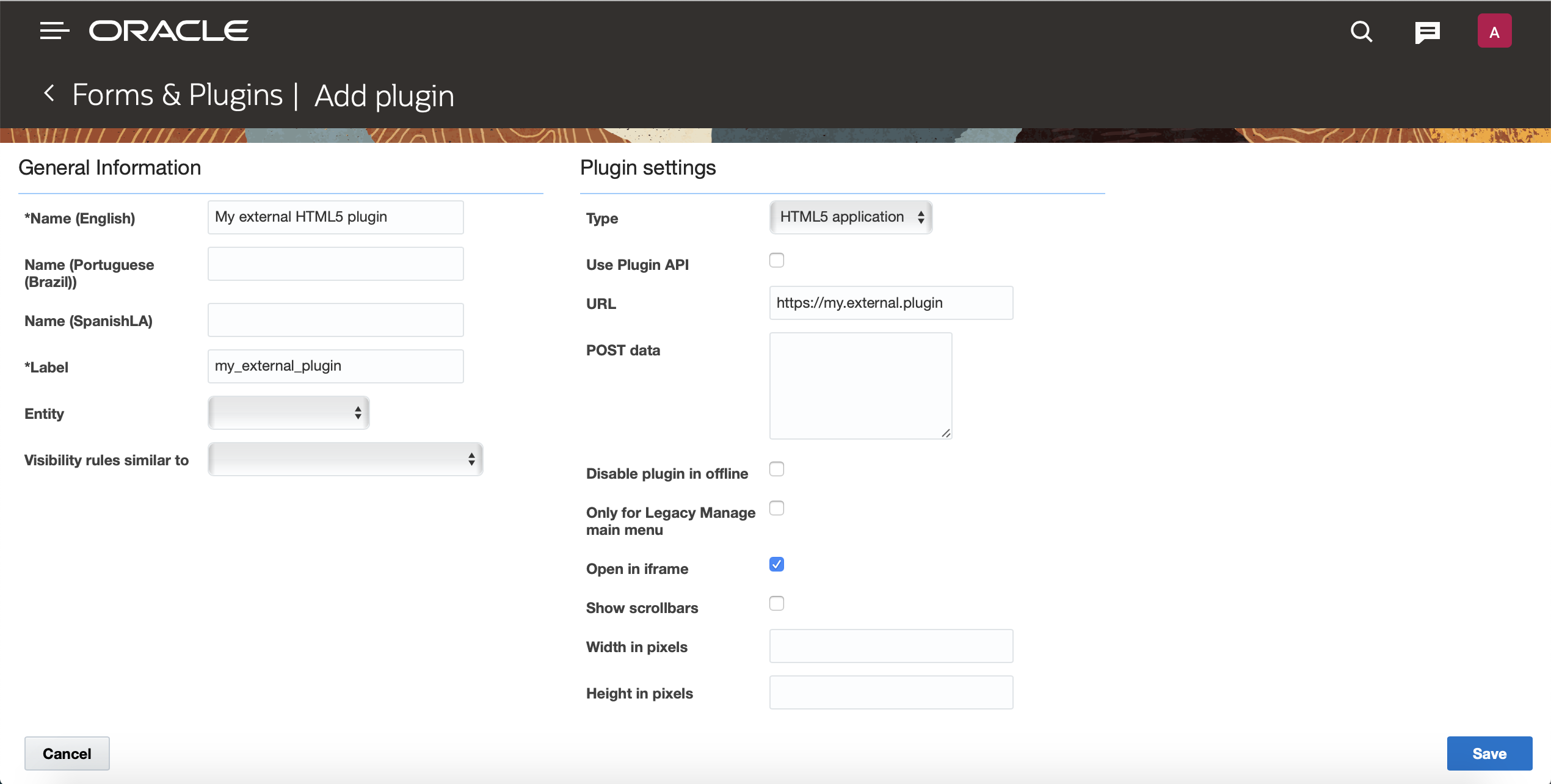

Configure a Plug-In to Add to the Main Menu
- Click Configuration > Forms & Plugins.
- Click Add Plugin.
- Complete these fields on the Add Plugin page:
| Field Name | Description |
| General Information section |
| Name (English) |
A mandatory field defining the plug-in name in the English language. The action or plug-in appears under this name in the actual context. |
| Name (other languages) |
Plug-in name translations to other languages, if used. |
| Label |
A mandatory field defining a unique action or plug-in label. |
| Entity |
Entity (activity, inventory, required inventory, resource, service request, user) to which the action or plug-in is to be related. For example, if you select Inventory, the action will appear only in the contexts related to inventory. Leave the field blank for the action to be available in all contexts of all the entities. |
| Visibility rules similar to |
The base action from which the plug-in is to be derived, if needed. When a base action is selected, the resulting plug-in functions per the same rules as the base action. The base action affects only the visibility of buttons and not the functioning of the plug-in. It appears only in the contexts in which the base action appears and is shown or hidden according to the same visibility conditions. For example, if start_activity is selected as the base action for a plug-in, the plug-in is only be shown in the context of a pending activity when there is no started activity in the same route, similar to the Start action. The list of available base actions is filtered according to the Entity that is selected. |
| Type |
The type of plug-in you want to use. Select HTML5 application. This means, the plug-in uses an external application to extend the functionality. The HTML5 plugin is a URL of an external resource that is opened in a new window or in an iframe. |
| Fields for the HTML 5 Application Option |
| Use Plug-in API |
Determines whether you want the plug-in to communicate with Oracle Field Service using the Plug-in API. Clear this check box. When you do not use the Plug-In API, the URL is opened in a new tab, window, or iframe. To interact with Oracle Field Service you must pass some data (such as activity id, resource name) to the plug-in using the placeholders in the "POST Data" and "URL" fields. |
| URL |
The path to a URL (for external plug-ins). This URL executes the HTML5 application and it executes the plug-in in the entire browser window. The URL must start with the protocol (https). The URL must point to an external resource, which is opened either in a new window or inside Oracle Field Service in an iframe (if the “Tab or iframe layout” option is selected). |
| POST Data |
The data that you want to be sent to the external plug-in. You can use only User entity fields as placeholders. |
| Disable plug-in in offline |
Determines whether you want to disable the plug-in when Oracle Field Service is offline. Clear this check box for the plug-in to work in offline mode with Oracle Field Service Mobility Cloud Service. |
| Only for Legacy Manage Main menu |
Determines whether the plug-in can be set as a Main menu item through the Main menu context layout. Clear this check box. |
| Open in iframe |
Determines whether the plug-in uses the iframe layout. If you clear the field, the plug-in’s URL is opened in a new browser tab or window. |
| Show scrollbars |
Determines whether the window in which the plug-in runs has scroll bars. This setting is applicable to the Legacy Manage application. |
| Width in pixels/ Height in pixels |
The width and height of the plug-in window in pixels. This setting is applicable to the Legacy Manage application. |
- Click Save.
This screenshot shows the Add plugin page where you configure a plug-in to display on the Main menu:
Configure a Plug-In on the Add Plugin Page

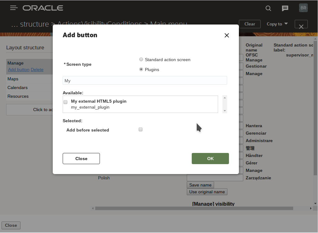

Add the Plug-In to the Main Menu Context Layout Structure
- Click Configuration > User Types.
- Select the type of user for which you want to add the plug-in.
- Expand Application screens and click Main menu.
- Select an existing button and click Add button.
- On the Add button dialog box, click Plugins.
- Select the plug-in that you want to add and click OK. This screenshot shows the Add button dialog box:
Add Button Dialog Box to Select a Plug-In to Add to the Main Menu
- Click Add new visibility, and then click Save.

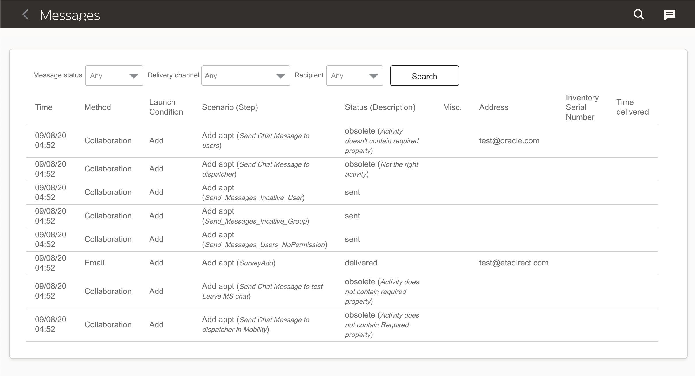

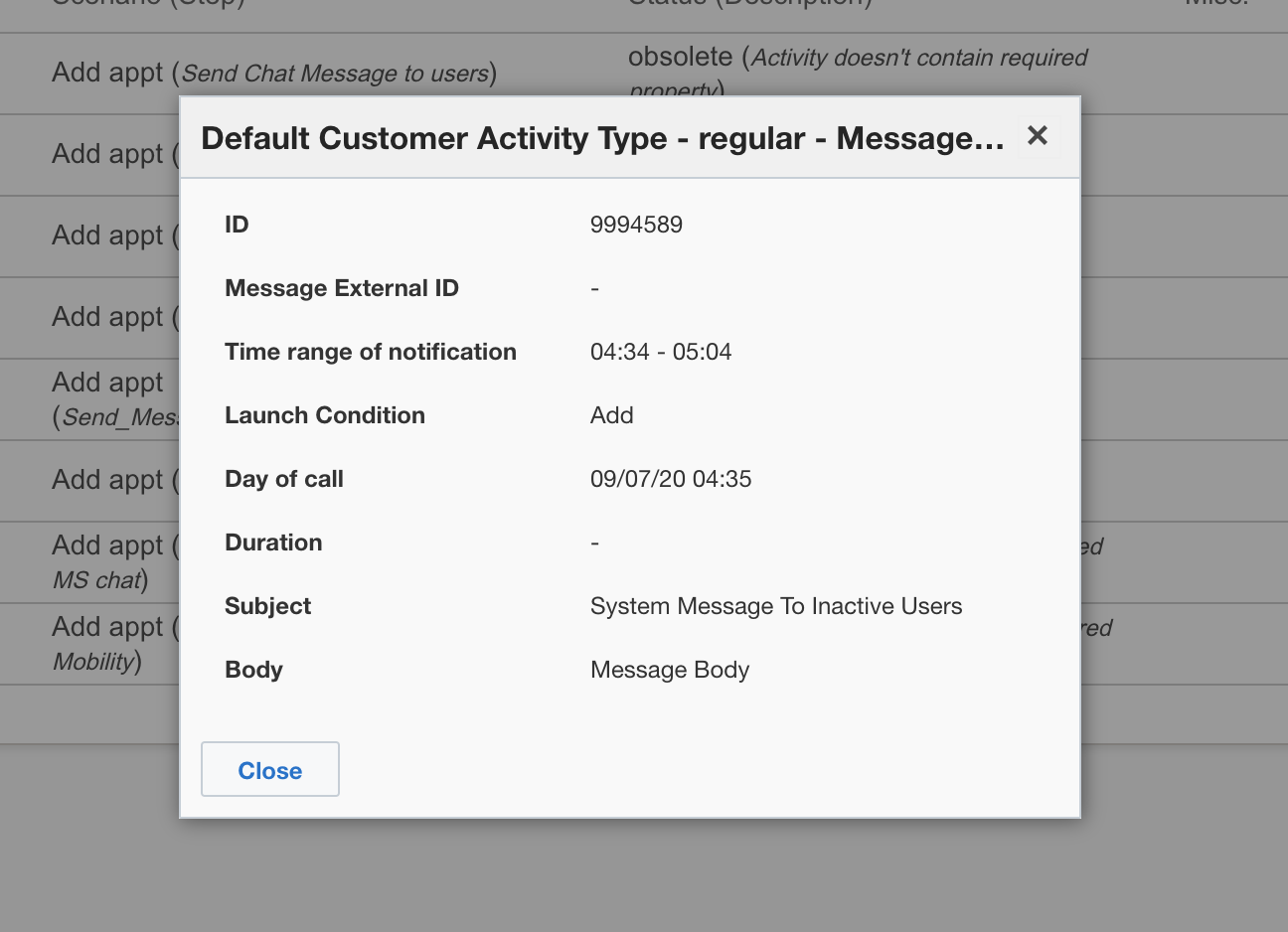

Earlier, the width of the columns on the Messages page was the same, regardless of the content. You had to zoom in to read the content. Starting with Update 20D, the column width adjusts automatically based on the content and the screen size.
This screenshot shows the redesigned Messages page:
Redesigned Messages Page
The option to resend messages that was available for everyone who had access to the Messages page is removed. You can resend a message using the 'Resend' option on the Messages Report. For all users who resend data, you must provide access to the Messages Report. You can search and select the required message from within the Messages Report and resend the message using the 'Resend' option.
This screenshot shows an individual message opened from the Messages page:
Individual Message Opened from the Messages Page
The best practice is to configure the Messages Report within the Dashboard for all user types that would resend messages.

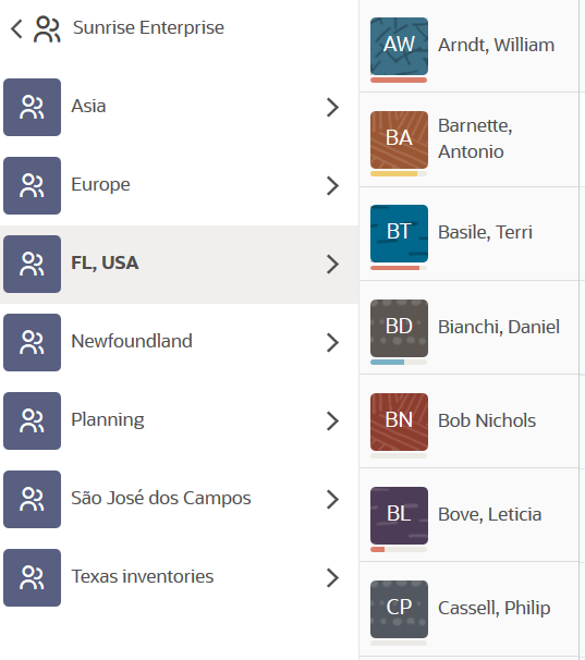

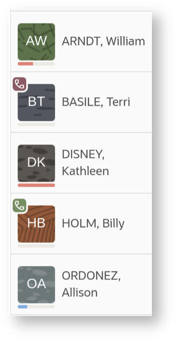

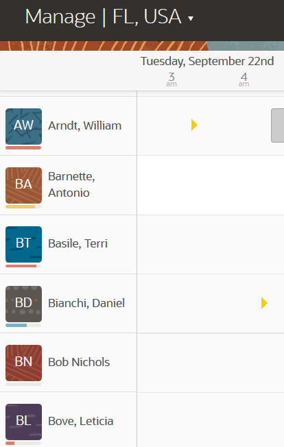

Use the Resource Tree on Manage, Calendar, and Map Pages
Earlier, you couldn’t see the hierarchy of resources and search for resources on the Calendars and Manage pages in Core Application. In addition, the steps you performed to manage groups in the Dispatch Console was different from those on the Calendars and Manage pages. Starting with Update 20D, you can perform these functions with the resource tree:
- Access the hierarchical resource tree on the Manage, Calendars, and Map pages.
- Go to any level of a resource’s hierarchy using the breadcrumbs in the resource hint.
- Manage groups in the Dispatch Console and on Manage, Calendars, and Map pages the same way.
- Use the date editor to select the date to view the Manage and Calendars pages.

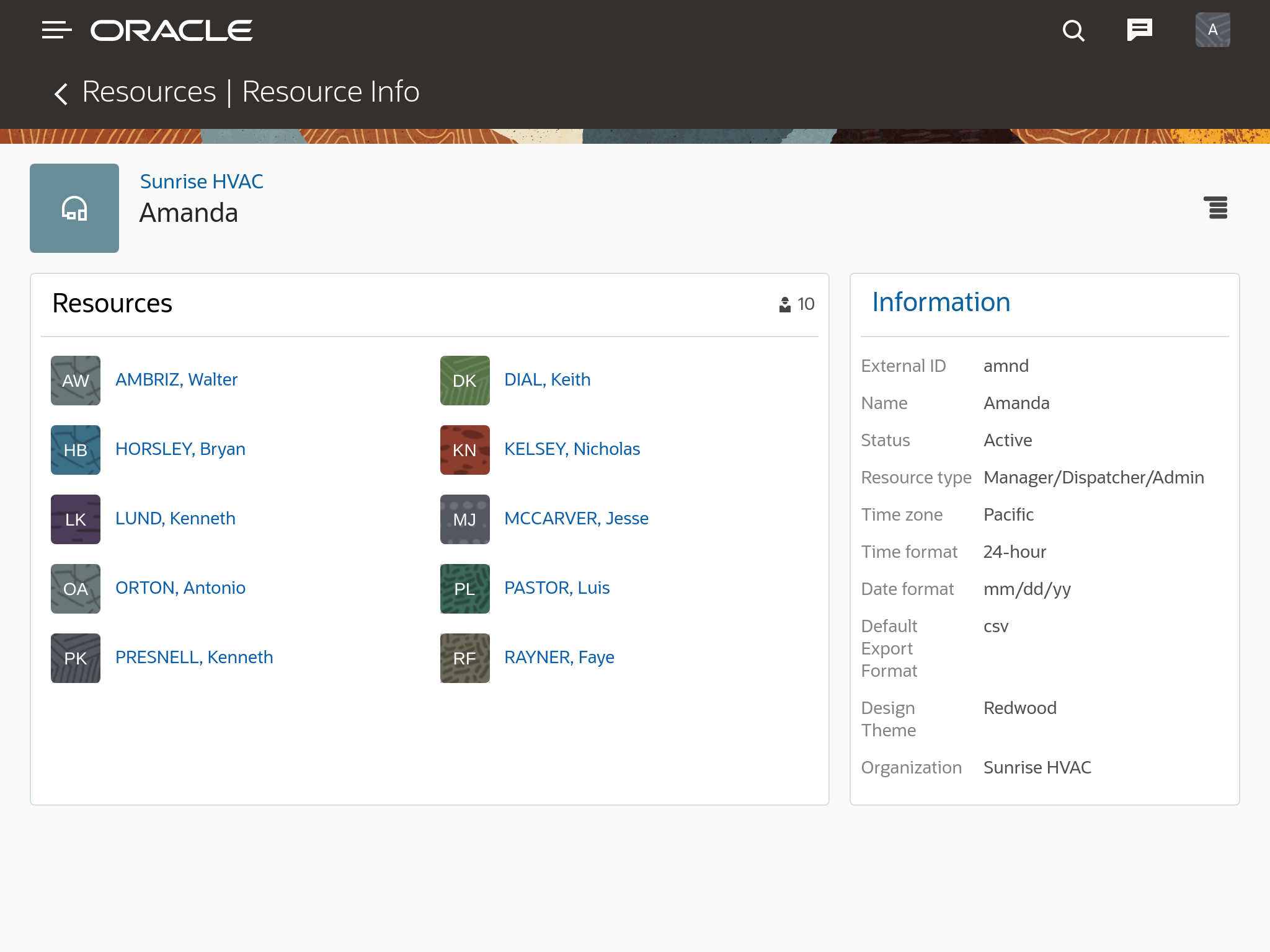

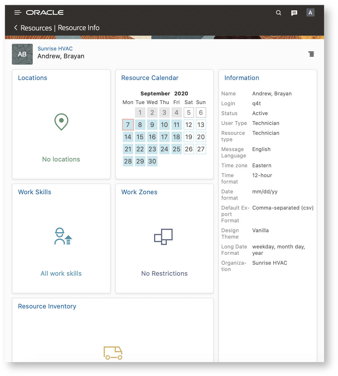

- View the Resource info page for the users with the Manager/Dispatcher/Admin role.
- See the style of avatars and badges in Redwood theme.
- See the style of tiles and icons on the Resource info page in Redwood theme.

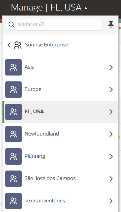

Access the Hierarchical Resource Tree on the Manage, Calendars, and Map Pages
You can navigate from a parent to child resource and a child to parent resource, and select the required resource to see the activities or schedules.
- To go to a child resource of an Organization Unit, a Bucket, or a Group, click the arrow in front of the resource.
- To go to a parent resource, click the arrow before a resource (one level up). Or, click the 'organization' icon to jump to the root level in the resource tree.
- To open resources on the Time, Calendar, or Map view, click a resource. The resource’s child resources are displayed on the right. The selected resource is highlighted with bold font in the resource tree.
- To open a resource hint, click the avatar.

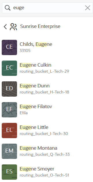

- To find a required resource in the resource tree, enter the name in the Search field.
- To hide the resource tree, click X next to the Search field. To show the resource tree, click Manage and then click the pin icon.
- To go to a different level of hierarchy of the resource tree, open the resource hint and use the breadcrumbs.
This screenshot shows the resource tree for the Florida bucket expanded:
This screenshot shows the Manage page where the resource tree hidden:
Resource Tree Hidden on the Manage Page
This screenshot shows the unpinned resource tree:
Unpinned Resource Tree
This screenshot shows the Search option for the resource tree:
Search Option for the Resource Tree

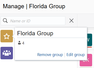

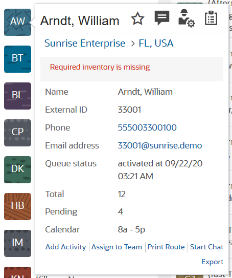

This screenshot shows the resource hint with breadcrumbs and the outline of the star icon, which indicates that the resource has not been added to a favorite group:
Resource Hint with Breadcrumbs
Use the Date Editor to Select the Date to View the Manage and Calendars Pages
You can use the date editor and select a date to view the Manage and Calendars page.
Manage Groups on Manage, Calendars, and Map Pages
Whether you are in the Dispatch Console, or the Manage, Calendars, or Map page, the way you work with favorite groups is the same. You can create a Favorite group. You can edit the group, add and remove resources to it, and modify the Favorite group.

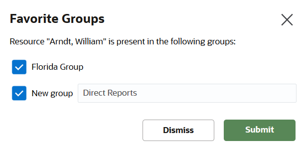

Create a Favorite Group
- Determine the resource that you want to be in the new group.
- Open the resource hint.
- Click the star icon.
- Select New group and enter the name of the group. When you add a resource to a group, the star icon on the resource hint is filled.
NOTE: You can add Org Units, Buckets, or individual resources to the group. When adding an Org Unit or a Bucket, note that the OrgUnit/Buckets is a dynamic entity. This means that the child resources within this group may change over time, and these changes show in your group content. Therefore, if you want to have specific resources in your managed group, assign those resources individually. Selecting a group resource automatically selects all the resources it contains.
Add a Resource to an Existing Favorite Group
- Determine the resource that you want to be in a group.
- Select the desired group and click or tap Save. The resource is added to the selected group and the star icon is filled. This screenshot shows the Favorite Groups dialog box:

Edit a Favorite Group
Follow these steps to rename a group, change resources in the group, or add a filter:
- To rename a group:
- Click the star icon next to the group name.
- Click Edit group.
- Change the name in the Group name field.
- Click or tap Submit. This screenshot shows the Edit group and Remove group options:
Remove or Edit a Favorite Group
- To remove a favorite group:
- Click Remove group.
- Click or tap Submit on the confirmation dialog box.
- Select a filter that applies to the group.
- Ensure that your administrator has created a filter for the resource entity and selected the List/Time/Map/Daily checkbox. This filter is used when displaying the members of the group on the Manage screen.
- Select the desired checkboxes to add or remove resources to the group.
- Click or tap Submit to save your changes.
View the Resource Info Page for the Users with the Manager/Dispatcher/Admin Role
The users with Manager/Dispatchers/Admin role can now view the Resource info page. You can see the details on the Information tile and all the resources you manage on the Resources tile. Work zones, Work skills, Locations, Inventory, and Resource history are not available for this role.
This screenshot shows the Resource info page for the users with the Manager/Dispatcher/Admin role:
Avatars and Badges
The resources avatars are now displayed with a square shape for all the themes. Redwood theme shows avatars and on-call badges with Redwood colors and structure.
This screenshot shows avatars and badges in Redwood theme:
Resource Info in Redwood Theme
The Resource Info page is now displayed in Redwood theme.
This screenshot shows the Resource Info page in Redwood theme:

Starting update 20D, when an activity has required inventory and the resource assigned to this activity does not have that required inventory in their resource pool, Routing can automatically create a Warehouse Visit activity. The Warehouse Visit activity is scheduled prior to the customer activity so that the resource can pick up the necessary inventory before traveling to the job site.
Each Warehouse Visit activity includes a list of all the required inventory that needs to be picked up, including that for other jobs on the resource’s route if necessary. The required inventory that needs to be picked up is listed in the Customer pool on the Warehouse Visit activity’s Inventory screen. When the Warehouse Visit activity is created, the required inventory to be picked up is reserved/booked within the warehouse resource pool so that OFS won’t commit that inventory to other activities.
Additionally, Routing optimization runs can automatically update Warehouse Visit activities throughout the day, as activities are added, removed, and reassigned. This might include adding or removing Warehouse Visits as well as updating the required inventory list for each Warehouse Visit activity.
