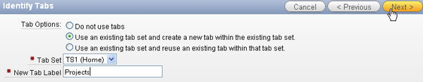

Select Use an Existing tab set and create new tab for Tab Options,
enter Projects for New Tab Label and click Next.

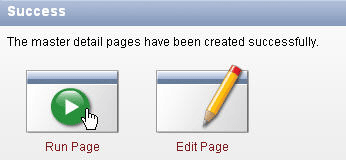

Click Create.
Your application was created successfully. Click Run Page.

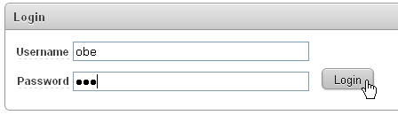

Because you created an Instant Application, Application Express authentication is used. Enter your login information and click Login.

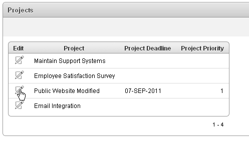

A report containing the list of projects is automatically displayed. Select the Edit icon next to one of the projects to view the Master Detail Form.

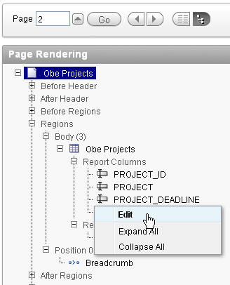

You see the Tree View on Page 2. In the Page Rendering section, under Regions node, locate and expand Report Columns under the Obe Projects node. This displays the report columns. Right-click PROJECT_DEADLINE and select Edit.
Under Column Attributes, select Standard Report Column for Display As field and enter DD-MON-YYYY for the Number/Date Format field and click Apply Changes.

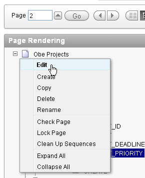

In the Page Rendering section, right-click Obe Projects page title, and select Edit.
In the Name section, enter Projects for the Name. In the Display Attributes section, enter Projects for the Title. Then click Apply Changes.

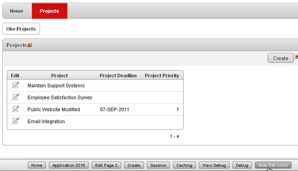

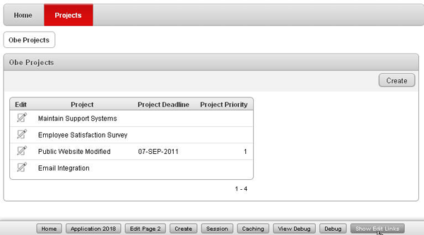

Click Run.

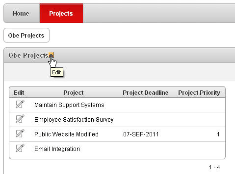

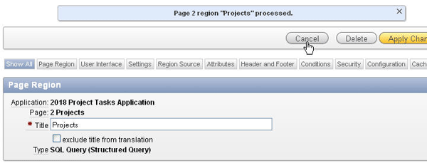

Notice that the date format of the PROJECT_DEADLINE has changed. You notice that the Region title is still set to Obe Projects. Click Show Edit Links in the Developer links area.
Click the Edit (
Change the title to Projects and click Apply Changes.
Click Cancel to close the Page Region window.
Refresh your browser to show the change you just made. Click Hide Edit Links in the Developer Links.

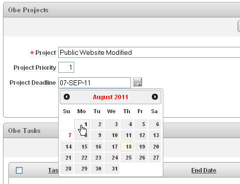

Select the Edit icon in front of the row for the Public Website project.
If you move your mouse over Project, Project Deadline, or Project Priority item label, you see a ? symbol. If you click any of these item labels, you see a help window. You can add edit text by editing the item. Close the Help window.

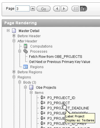

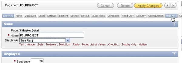

In the Page Rendering section, under Regions, double-click P3_PROJECT .
Select Text Field from the dropdown list for Display As field and click Help Text subtab.
Change the Help Text to something else and click Apply Changes.
Click Run.
Click the Project label again and notice that your help text is displayed.

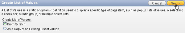

For Create List of Values, keep the default value From Scratch, and click Next .

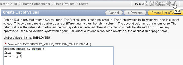

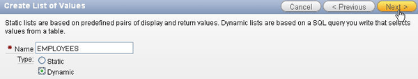

For the Name field, enter EMPLOYEES. For Type, change the type to Dynamic. Then click Next .
For a dynamic LOV, you need to enter the SQL Query you want
to execute when the page is rendered. To find out what the names of
your columns are, you can select the item finder (

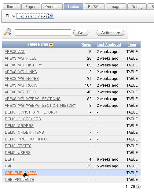

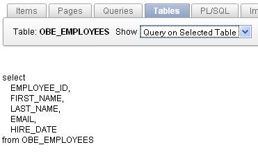

Click the Tables tab.
Select the OBE_EMPLOYEES table link.
Note the names of the columns. select Query on Selected Table from the Show pulldown window.
The query is displayed. You will use a slightly modified query for the List of Values. Close the window to return to the List of Values window.

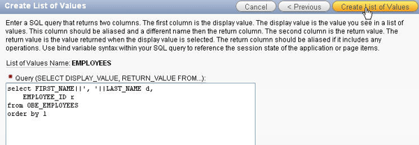

Enter the following SQL statement and click Create List of Values. The first column in a dynamic list of values is the column displayed to the user. The second column is the corresponding value to be stored in the database. They can both be the same value when appropriate. select FIRST_NAME||', '||LAST_NAME d,
EMPLOYEE_ID r
from OBE_EMPLOYEES
order by 1

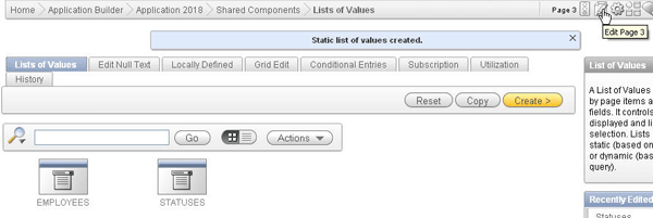

Your LOV was created. Note that the List of Values does not appear like an expandable node because you haven't yet associated it with this page. You want to create one more static LOVs. Right-click and select Create again.

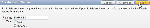

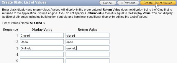

Enter STATUSES for the Name and make sure Static is selected for the type and click Next .
For Display Value and Return Value, enter the following:
Click Create List of Values.
The STATUSES LOV was created. Now you can associate the LOVs with

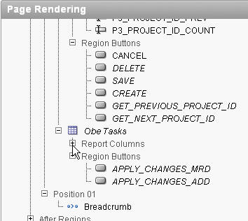

the page. Click the Edit Page 3 (
In the Page Rendering section, under Obe Tasks node, expand Report Columns.

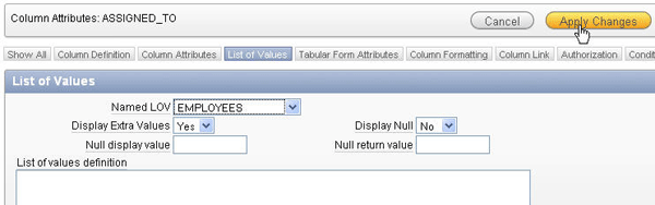

Then, right-click ASSIGNED_TO column and select Edit.
Click the Column Attributes section button.
Change the Display As to Select List (named LOV) and click the List of Values section button.
Select EMPLOYEES for the Named LOV and click Apply Changes.

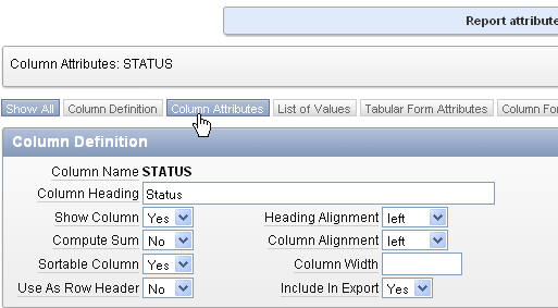

Click the Edit ( >

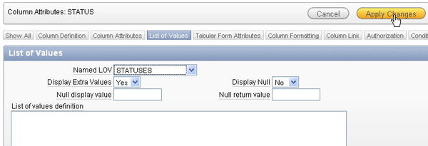

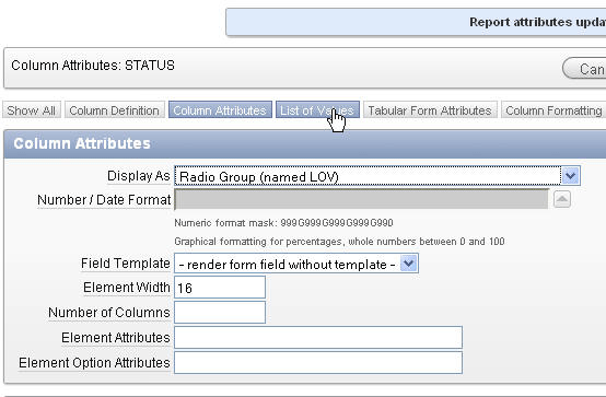

Select Radio Group (named LOV) for the Display As and click List of Values section button.
Select STATUSES for the Named LOV and click Apply Changes. Then click Apply Changes again.

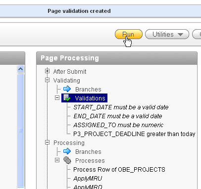

In the Page Processing section for Page 3, review the list of validations already available. Notice that there are some validations already available. You want to create an additional one for the PROJECT_DEADLINE item.

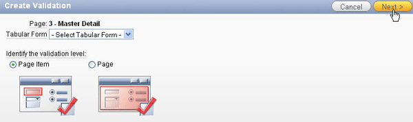

Right-click Validations and select Create.

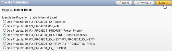

You want to create a validation on the P3_PROJECT_DEADLINE page item. Accept the default and click Next .
Select the item Obe Projects: 50. P3_PROJECT_DEADLINE (Project Deadline) and click Next .

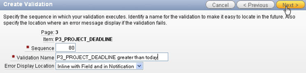

Enter P3_PROJECT_DEADLINE greater than today for Validation Name and click Next.

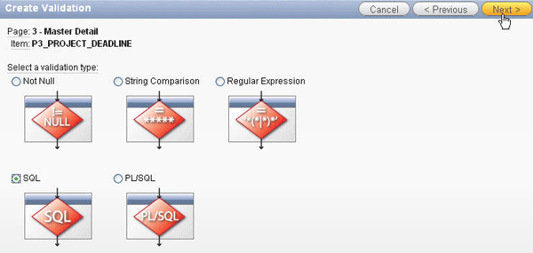

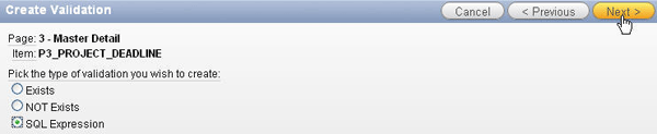

Select SQL for the validation type and click Next.
Because you want to specify the condition when a PROJECT_DEADLINE is incorrect, click SQL Expression and click Next .
Enter TO_DATE(:P3_PROJECT_DEADLINE,'DD-MM-YYYY') >= SYSDATE for the Validation Code and Date needs to be greater than today for the Error Message and click Create Validation. .
The validation has been created successfully. Click Run.
