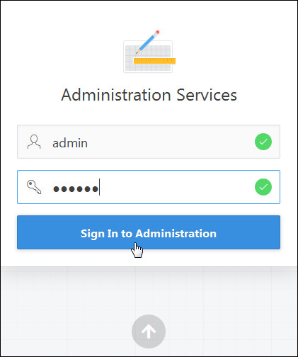

Enter admin for Username. For Password, enter the Instance administrator account password you specified when you installed Oracle Application Express. Click Sign In to Administration. Note: admin is the default Instance administrator account. You can also create additional Instance administrator accounts.

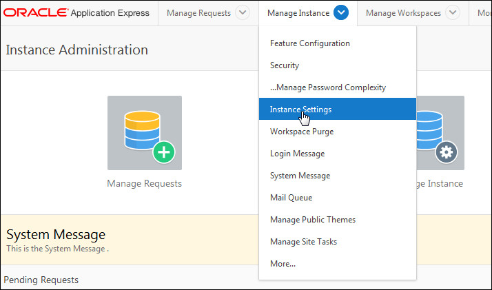

Under Manage Instance, select Instance Settings.

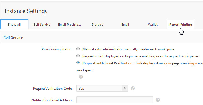

In the Instance Settings page, click Report Printing.
Select Oracle REST Data Services for Print Server. Click Apply Changes.

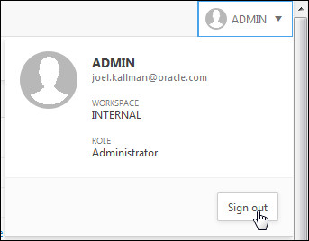

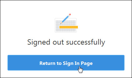

Click Sign out to log out of Application Express.
Click Return to Sign In Page.

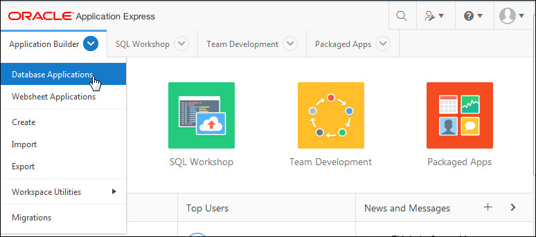

In the Application Builder drop down, select Database Applications.

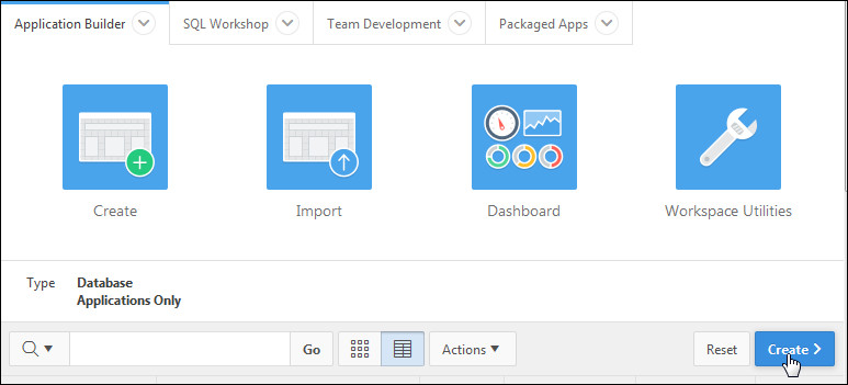

Click Create >.

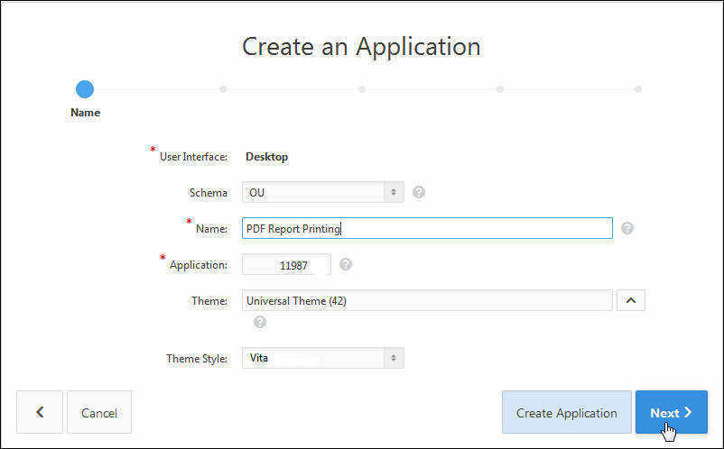

Enter PDF Report Printing for Name and click Next >.

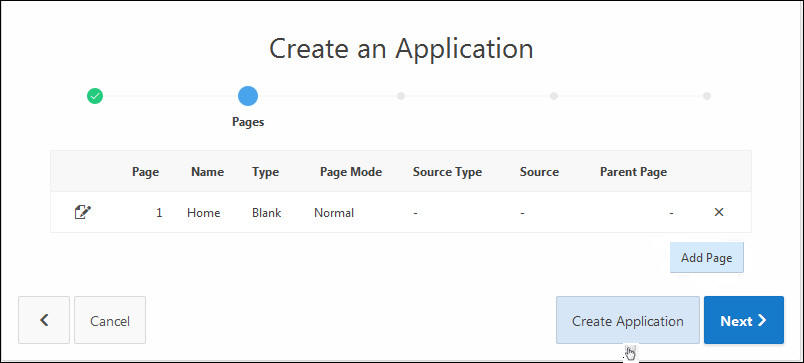

Click Create Application.

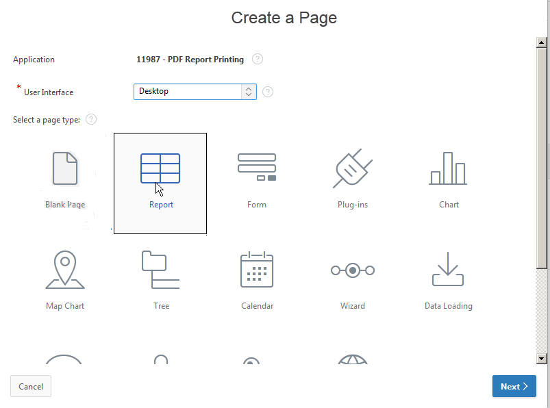

Navigate to PDF Report Printing application. Click Create Page.

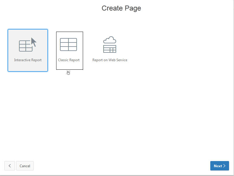

Click Report icon.
Click Classic Report icon.

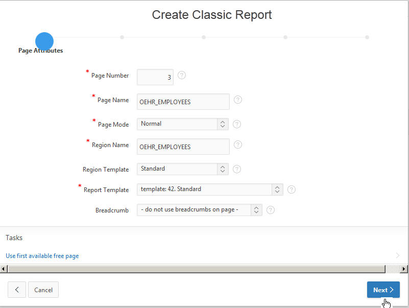

Enter OEHR_EMPLOYEES for Page Name and Region Name. Click Next

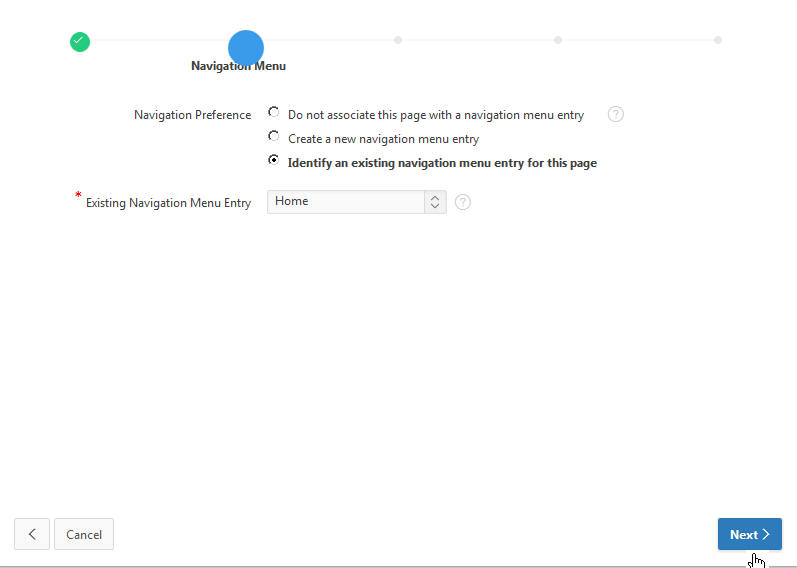

On Navigation Menu window for Navigation Preference, select Identify an existing navigation menu entry for this page. For Existing navigation Menu Entry select Home from select list. ClickNext

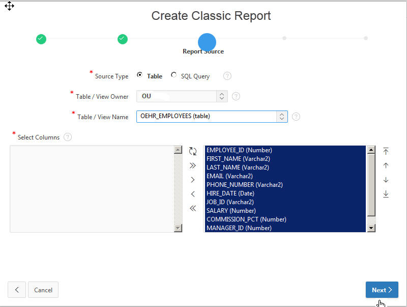

On Create Classic Report window for Table/View Name select OEHR_EMPLOYEES. Click Next
Click Next

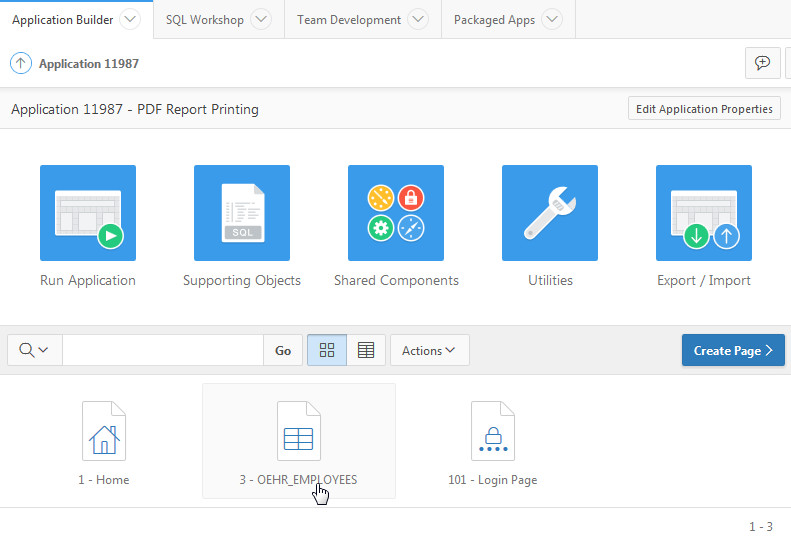

In the application's home page, click OEHR_EMPLOYEES page.
Click the Attributes under the OEHR_EMPLOYEES report.

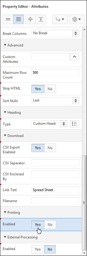

In the Property Editor - Attributes section, select Yes to Enable Report Printing.

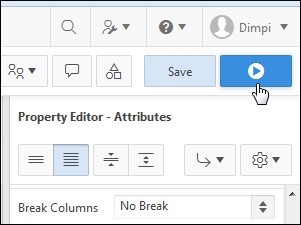

Click Save and Run Page.

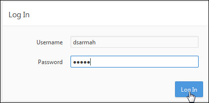

Enter your login credentials. Click Log In.
