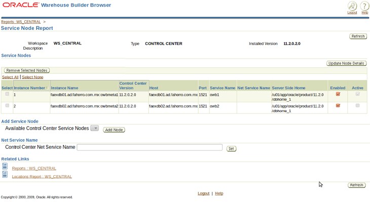

Una vez que se realizó la configuración correcta de los servicios se procedió a asegurar que warehouse builder era realmente capaz de mapear a ambos nodos como candidatos a correr el servicio del Control Center.
Para validar y levantar esta aplicación de visualización web nos basamos en el blog oracle oficial de warehouse builder.

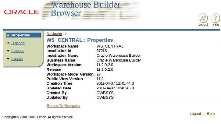

http://blogs.oracle.com/warehousebuilder/2010/01/how_to_start_oracle_warehouse_builder_repository_browser.html, se procedió a habilitar el servicio del OWB Browser Listener y a través del Warehouse Builder browser checar si los servicios efectivamente eran visibles para la herramienta, asi como las características generales del workspace (versionamiento, fechas de creación, etc.)
Se puede realizar una conexión remota hacia este browser mediante la siguiente liga.
https://faexdb01:8999/owbb/RABLogin.uix?mode=runtime&def_host=faexdb01&def_port=1521&def_service=owb1
“Enabled
If Enabled is checked, then the node is a "candidate" to run the Control Center Service
If Enabled is not checked, then the Control Center Service is not allowed to run on the node.
NOTE: So when a node is "Enabled", it does not mean that the Control Center Service is really running on that node. It is only marked as a "candidate" to run the Control Center Service. The only column where can be seen that the Control Center Service is really running on the node, is the "Active" column.
If a node is "Enabled", a job "check_service" will be spawned in the database for each node.
- For node 1: check_service(1)
- For node 2: check_service(2).
Both nodes check every 6 minutes if the Control Center Service is still running ('Active') on one of the nodes. If it finds the Control Center Service inactive, then it will try to start it.
Active
Active means: The Control Center Service is running on the node
There can only be one Active node at a given point in time! That is the reason why in a RAC, the script "start_service.sql" might show:
ORA-20001: The runtime service is already running in a different process
This just indicates that the service is already "Active" on one of the nodes in the RAC.”
Las características citadas las podemos ver en el snapshot siguiente:
