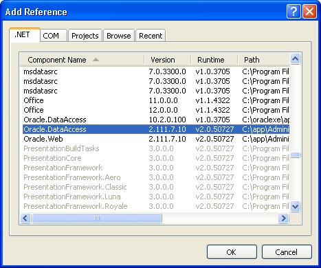

     Add .NET Assembly Reference
  3. The Add Reference window will open. Under the .NET tab, scroll down and select Oracle.DataAccess under Component Name. Click Ok.
    Add ODP.NET Reference
  4. Oracle.DataAccess will now be present under the References node. You can now reference ODP.NET from within your .NET application.
