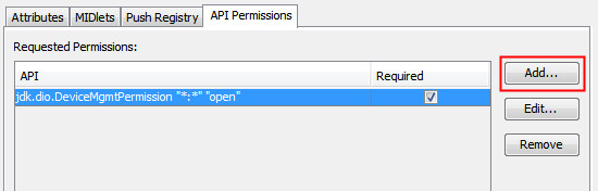

  4. Click Add to add another permission.
    Properties

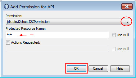

  5. In the Add Permission dialog:
    1. Select jdk.dio.i2cbus.I2CPermission from the drop-down menu.
    2. Enter *:* as the protected resource name.
    3. Click OK.
    Add Permission for API

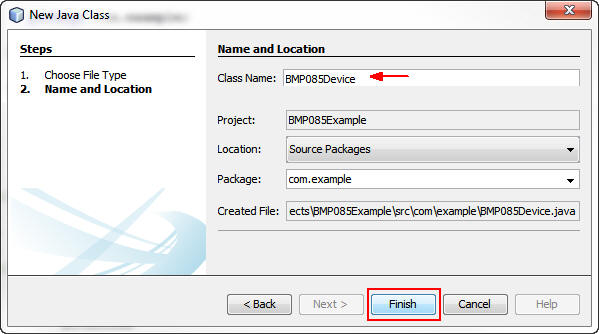

  2. Enter BMP085Device as the class name and click Finish.
    New Java Class dialog

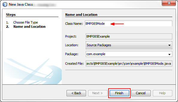

  3. Right-click com.example and select New > Java Class.
    NetBeans Projects tab
  4. Enter BMP085Mode as the class name and click Finish.
    New Java Class dialog box

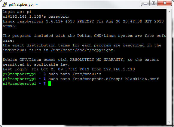

  1. Perform the following steps:

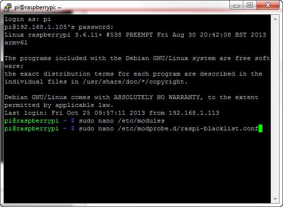

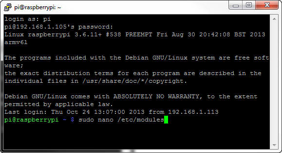

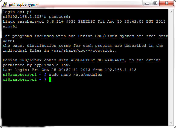

    1. Connect to your Raspberry Pi with PuTTY.

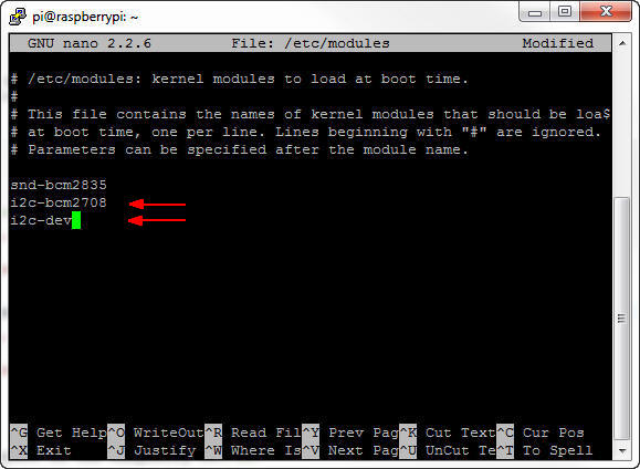

    2. Enter sudo nano /etc/modules.
    PuTTY Window

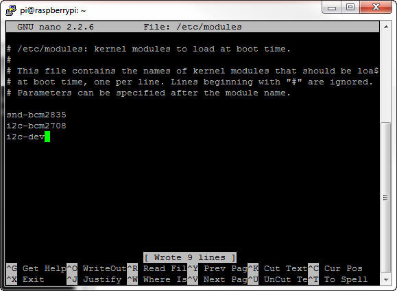

  2. Enter i2c-bcm2708 and i2c-dev after the snd-bcm2835 line.
    PuTTY Window

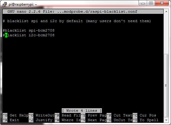

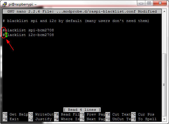

  5. Enter sudo nano /etc/modprobe.d/raspi-blacklist.conf and press Enter.
    PuTTY Window
  6. Comment out the two blacklist lines in the file by adding a comment sign (#) at the beginning of each line.
    PuTTY Window

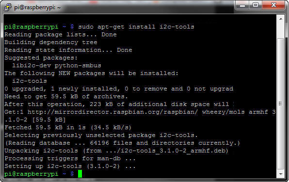

  1. Enter sudo apt-get install i2c-tools and press Enter.
    PuTTY Window

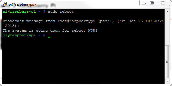

  2. Enter sudo reboot and press Enter.
    PuTTY Window

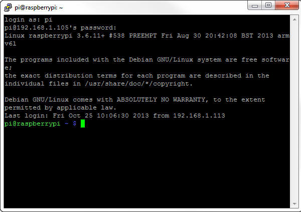

  1. Reconnect to the Raspberry Pi by using a PuTTY connection.
    PuTTY Window

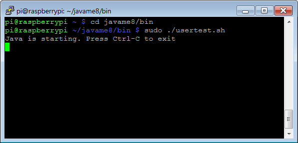

    1. Connect to it with PuTTY.
    2. Change directories with the cd javame8/bin command.
    3. Start the AMS with the sudo ./usertest.sh command.
    PuTTY Window

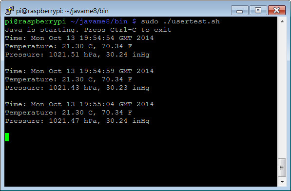

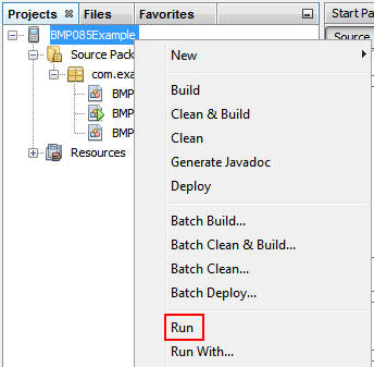

  2. In NetBeans, right-click the BMP085Example project and select Run.
    NetBeans

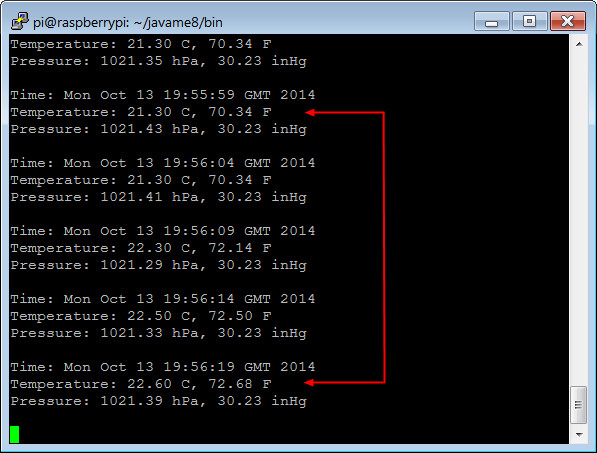

    In the PuTTY window, the temperature and barometric pressure that are read from the BMP085/BMP180 device are displayed and updated every 5 seconds.
    PuTTY window
  3. Gently put your finger on the sensor (the square in the center of the BMP085/BMP180 device) to increase the temperature.
    PuTTY Window
