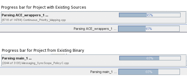

Figure 4 shows a comparison of the parsing progress bars for Project with Existing Sources and Project from Existing Binary:
Figure 4. Comparison of Parsing Progress Bars
You can see the project created from the binary has fewer files. The project created from existing sources includes the complete ACE+TAO source code, while the project created from existing binary includes the code for one component of ACE+TAO.
