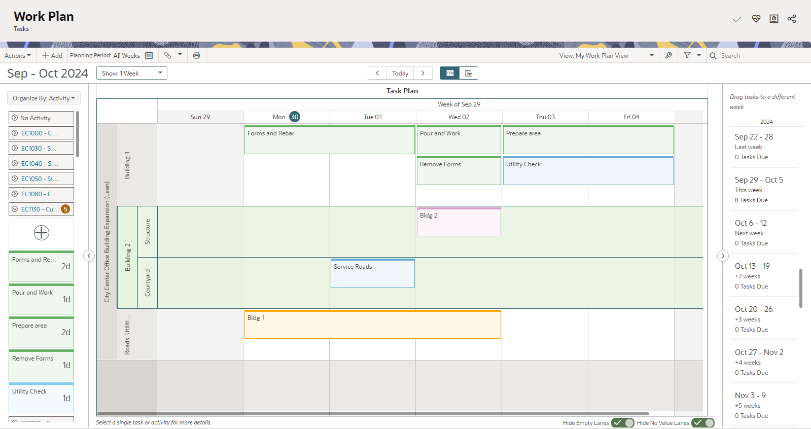

You can create tasks and task milestones on the Work Plan, Hand-offs, and/or Task List page in the browser-based version of Primavera Cloud There are various ways you can add tasks or task milestones, but a common way is to select the Add button in the upper toolbar.
If desired, you can organize tasks into swimlanes on the Work Plan page. Swimlanes break down tasks by the user or company assigned to complete them, which aids in project planning and optimizing workload distribution. Add a task plan, and then choose to add swimlanes by user and/or company.

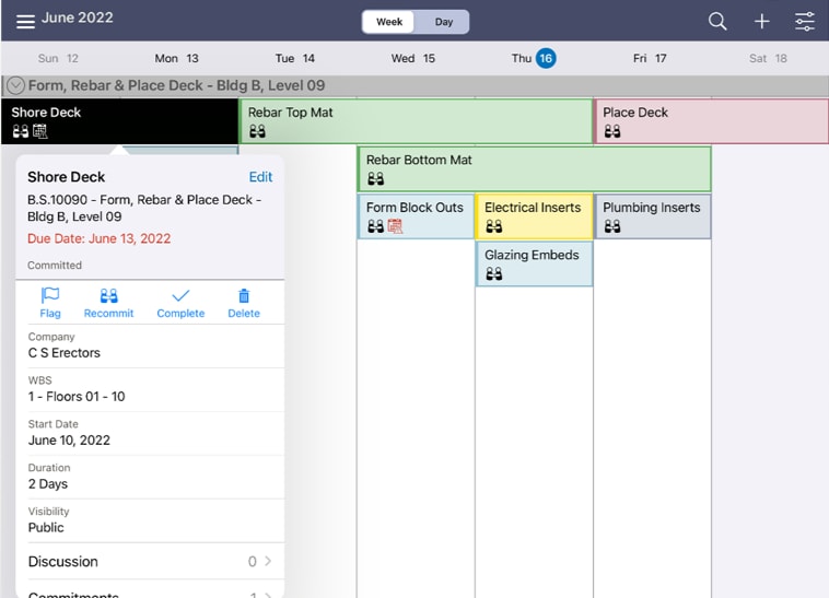

You can also create your work plan on-the-go with the Oracle Primavera Cloud mobile app. Select the Work Plan tile from the project homepage, and then the Plus icon to add a task or task milestone. We recommend using a tablet to see a calendar view of your work plan.
Task information
While only a few fields are required to create a task or task milestone, we recommend adding as much detail as possible. For example, on the Work Plan page, Hand-offs page, or in the Primavera Cloud mobile app, you can associate tasks with an activity. Additionally, entering a duration and due date will calculate a start date for your tasks. On the Task List page in the browser or app, you can upload files, documents, or photos to help capture task details and progress.
