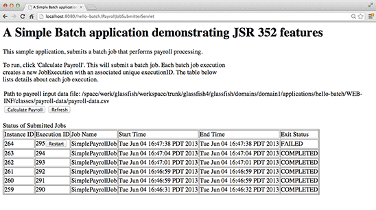

Running the Payroll Application
Once you deploy the hello-batch.war file, you can run the application by accessing http://localhost:8080/hello-batch/PayrollJobSubmitterServlet from a browser. Accessing this URL should present the screen shown in Figure 2.
Figure 2
Figure 2
Click the Calculate Payroll button and you should see a new entry in the table, as shown in Figure 3.
Figure 3
Figure 3
Click the Refresh button and you should see the Exit Status and End Time columns updated for the latest job (see Figure 4). The Exit Status column shows whether the job failed or completed successfully. Since our SimplePayrollJob doesn't have any errors (at least not yet!), the Exit Status displays COMPLETED.
Figure 4
Figure 4
Click the Calculate Payroll and Refresh buttons a few more times. Note that each time a job is started, a new execution ID (and instance ID) is given to the job, as shown in Figure 5.
Figure 5
Figure 5

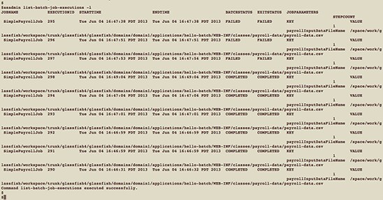

Restarting Failed Jobs
So far, we had been starting batch jobs using the jobOperator.start() method. Let's say that our payroll input file has some errors. Either the ItemReader or the ItemProcessor could detect invalid records and fail the current step and the job. The administrator or the end user can fix the error and can restart the batch job. This approach of launching a new job that starts from the beginning after recovering from errors might not scale if the amount of data to be processed is large. JobOperator provides another method called restart() to solve exactly this problem.

Save the file and quit the editor. Go back to your browser and click the Calculate Payroll button followed by the Refresh button. You would see that the recently submitted job failed, as shown in Figure 6. (Look at the Exit Status column.)
Figure 6
Figure 6
You will also notice that a Restart button appears next to the execution ID of the job that just failed. If you click Refresh, the job will fail (because we haven't fixed the issue yet). Figure 7 shows what is displayed after a few clicks of the Refresh button.
Figure 7
Figure 7

You should also notice that when you click the Restart button, a new job execution is created but its job instance ID remains the same. When you click the Refresh button, our PayrollJobSubmitter servlet calls a method named restartBatchJob(), which is shown in Listing 14:

While ensuring that your browser shows the page with a Restart button, edit the file again and remove the extraneous characters from the eighth record. Then click the Restart and Refresh buttons. The latest execution should display a COMPLETED status, as shown in Figure 8.
Figure 8
Figure 8

To view the list of batch JobExecutions, you can run this command:
asadmin list-batch-job-executions -l
You should see output similar to Figure 14:
Figure 14
Figure 14
The command lists the completion status of each execution and also the job parameters passed to each execution.
