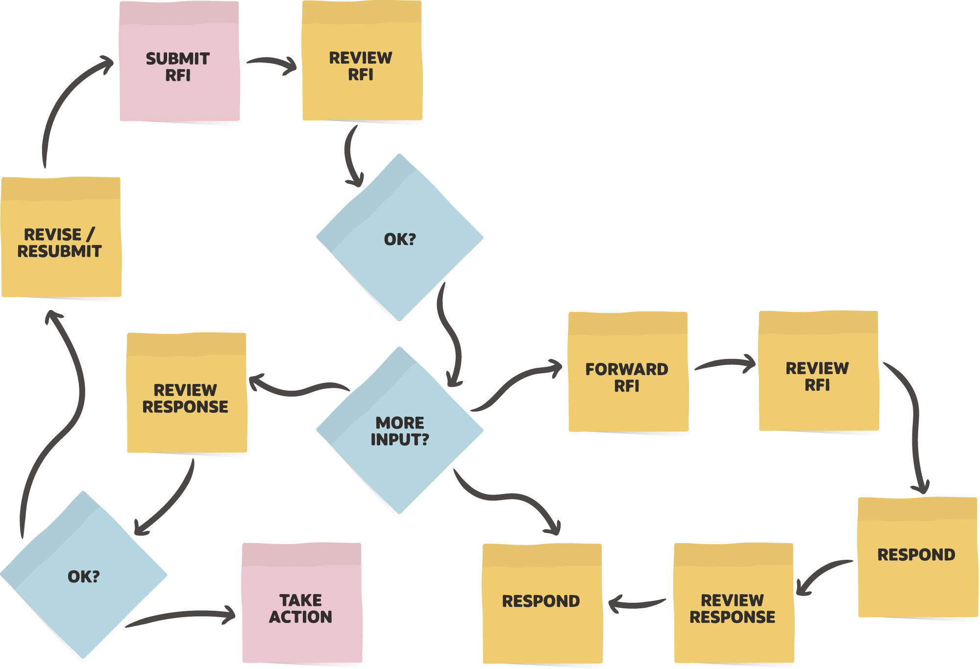

    Use a sticky note for each action and task. Place them on the whiteboard as you go. And... turn a sticky note 45 degrees to create decisions or questions. It doesn't have to be pretty. Concentrate on getting the elements right and, in the right order.
    Once you've got the basic elements in their correct positions, tidy it up and draw arrows that indicate the flow:
    NOTE: You don't have to use different coloured sticky notes but it can help with clarity.

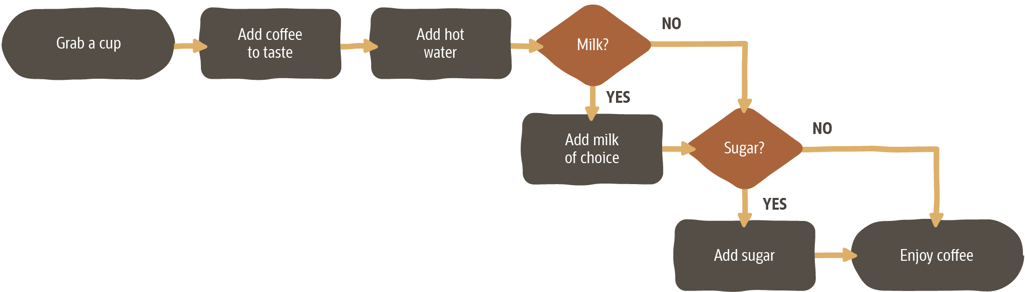

    Here's a very simple flow diagram for making a cup of coffee:
    It contains just three shapes. But no swim lanes, because they're not needed. Chances are that your processes will be more detailed than this one and include swim lanes so you can tell who's responsible for what.

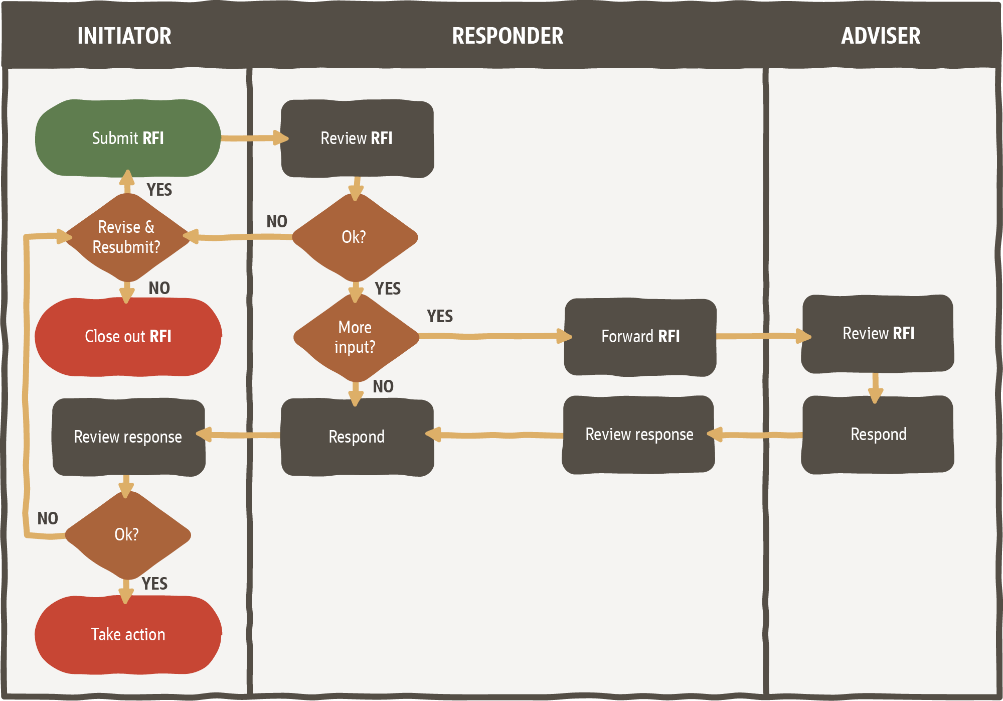

    Here's a basic RFI flow diagram:
    The swim lane headings are generic here. This means it could work for a number of different scenarios. For example, a sub-contractor might start the process or, maybe the main contractor does.
    Don't stress about colour. It's used here for legibility and the colours don't mean anything.
