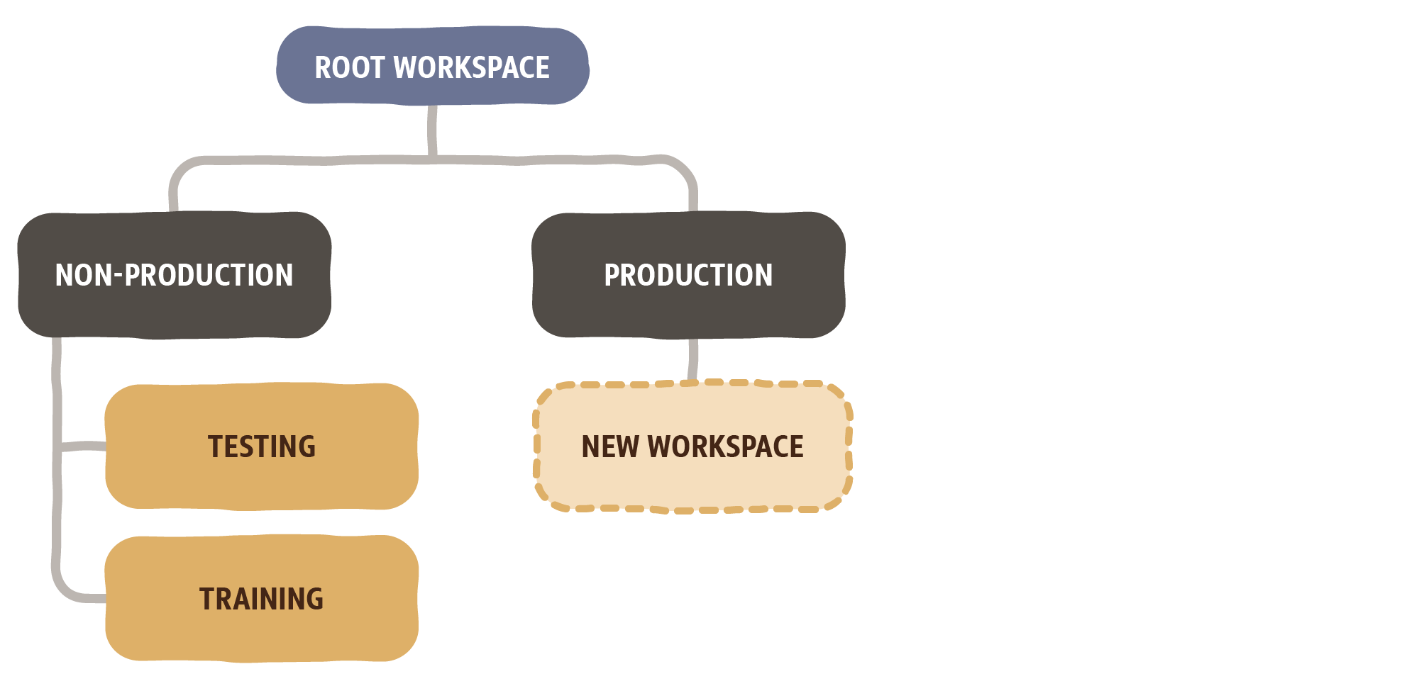

Primavera Cloud comes with a generic workspace configuration ready for you to build on. The image below shows what it typically looks like. In this Play we'll be concentrating on the "new workspace" part of the hierarchy.

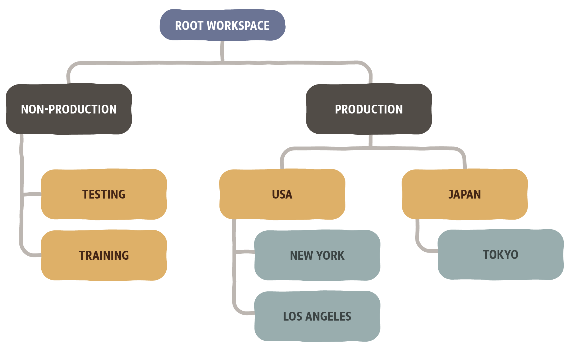

    Here's an example of a simple hierarchy using countries and cities:
    If your hierarchy is getting too extensive, you can always use codes and configured fields to attach additional information to your projects. Not everything has to be a workspace.
