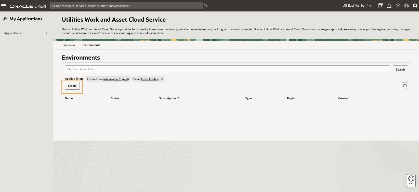

Create environments
From the Environment tab, select Create to start the create environment workflow.
Note the filters available. The Compartment filter allows you to view the compartment you wish to create an environment in.
Note: We're creating our environment in the Root compartment in this example.

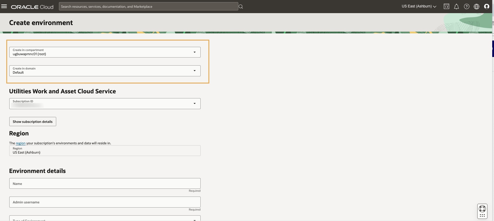

Select Compartment and Domain that control access to your environment.
Tip!
Remember to double-check that the identity domain selected is in the same compartment before creating your environment.
Creating environments using multiple compartments
There may be instances where you want to organize your environments to meet the needs of your business. Compartments are used to organize OCI resources.
When creating environments using multiple compartments, ensure that you have a corresponding identity domain that you plan to use for these environments.  The identify domain will need to reside in the same compartment that you will provision the environment in. This ensures that you can select the correct identity domain for the environment you're creating.

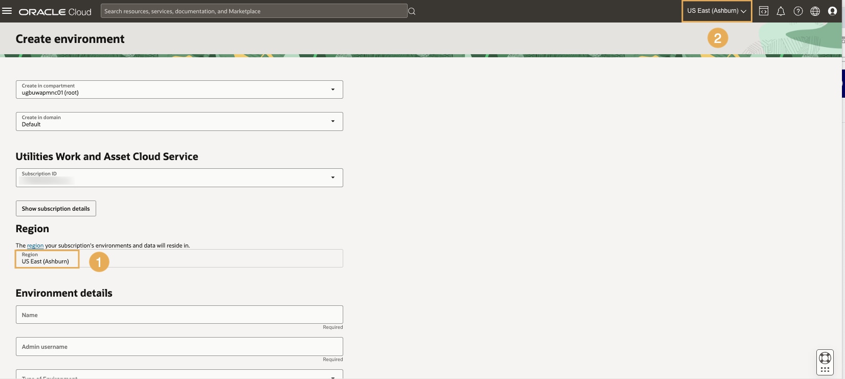

Select a region
Keep these items in mind when selecting the region your subscription's environment and data will reside in:
  • After an environment is created in a particular region, it cannot be moved or transferred.
  • Ideally, your home or tenancy's region, selected at activation, is the same as your provisioning region.
  • If the home region is different than the expected provisioning region, we suggest verifying the region with Oracle Support or your CSM before you decide. Review other key regional considerations.
In our example, the provisioning region (1) and subscription region (2) are the same.

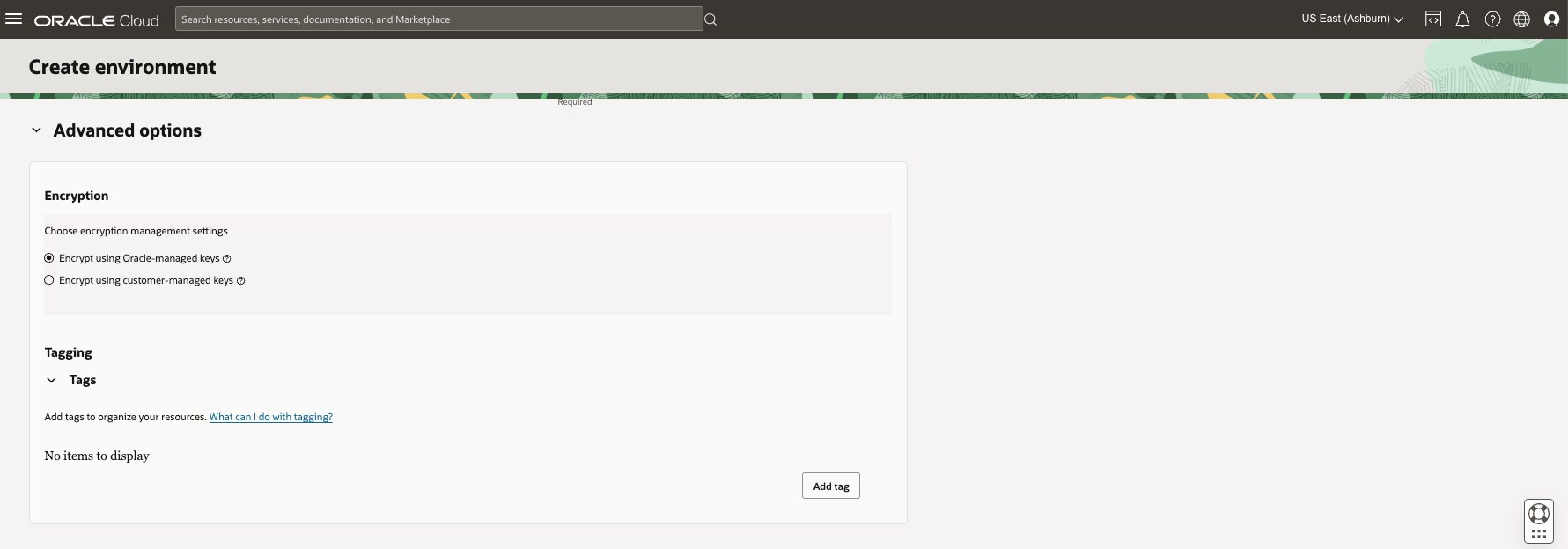

Advanced options
Encryption and tags are selected in Advanced options. Read more advanced options.

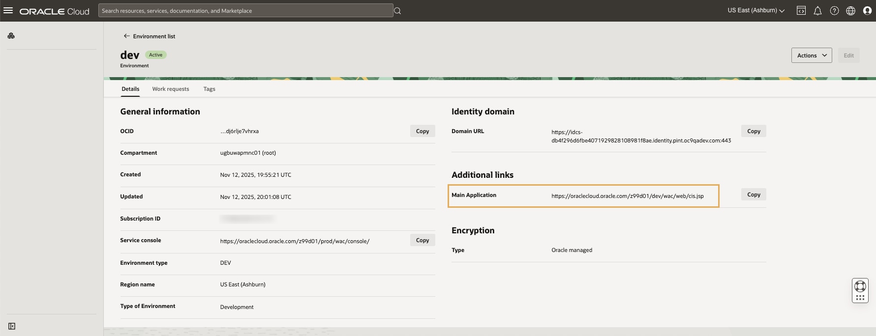

Application URL
Once your environment is Active, you can access the link to your main application under Additional Links
Copy the link into a new browser window to get to your application.

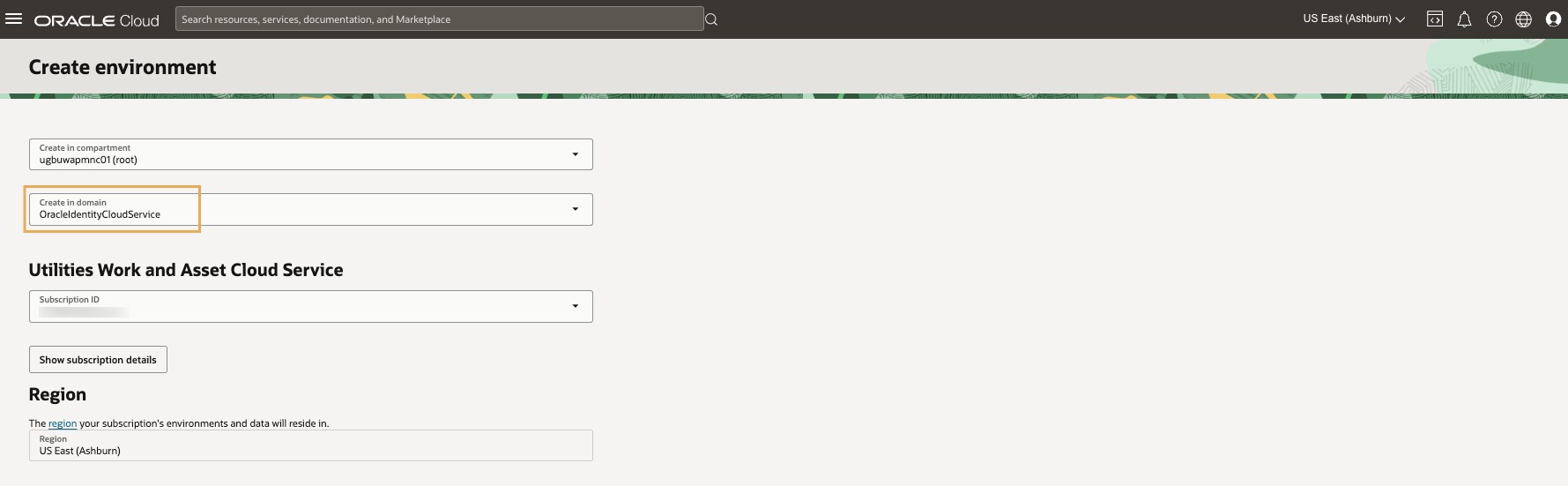

Legacy account security
Oracle has transitioned all legacy Identity Cloud Service accounts to Identity Domain accounts. During this transition an identity domain named OracleIdentityCloudService was created in the same root compartment as the Default identity domain. That domain has all the security settings of the legacy account.
For those who transitioned from legacy to Identity Domain accounts, you will find two identity domains within your root compartment. These are the default identity domains associated with your account. When you proceed to create a new environment, you have the option to choose from these two available identity domains. Note: the OracleIdentityCloudService will be selected as your default identity domain in App Manager.
In the example, we're creating an environment in the Root compartment using a legacy account as our identity domain.
