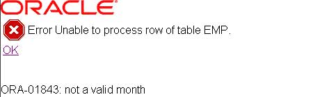

Run the report page and click on an edit icon. Notice the error you receive, similar to figure 3.
Date Picker Error
Figure 3: Date Picker Error
The exception is raised because the date picker format is MM/DD/YYYY, yet the value retrieved from the database is in the default date format for this database, DD-MON-YY. Now, click Cancel and then Create on the report page to create a new entry. Enter information for a new employee and click Create. You should receive an error similar to figure 4.
Invalid Month Error
Figure 4: Invalid Month Error

Figure 5 shows that the item called P6_HIREDATE is bound to the database column HIREDATE. The first error occurred because HIREDATE was retrieved from the database using the database default DD-MON-YY, but the item specified that it should use a date picker with the format MM/DD/YYYY.
The second error occurred because the process created by the wizard to insert data into the EMP table was expecting HIREDATE in the default format for this database, DD-MON-YY, but it was passed to the process in the format MM/DD/YYYY.
To fix both issues, you apply a format mask to the item. Enter MM/DD/YYYY in the Format Mask field as shown in Figure 6. The format mask should match the format of the Date Picker chosen for the item.

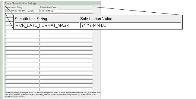

  • Create a Substitution String named PICK_DATE_FORMAT_MASK, giving it a Substitution Value of the format for the date.

To create a Substitution String called PICK_DATE_FORMAT_MASK with a value of YYYY-MM-DD:
  1. Navigate to Application Builder.
  2. Choose the application that has the form and report on the EMP table and click Go.
  3. Click Edit Attributes.
  4. Scroll down to Static Substitution Strings.
  5. Under Static Substitution Strings, enter PICK_DATE_FORMAT_MASK in the Substitution String column and YYYY-MM-DD in the Substitution Value column. (See figure 7.)
  6. Click Apply Changes.
Create PICK_DATE_FORMAT_MASK
Figure 7: Create PICK_DATE_FORMAT_MASK
