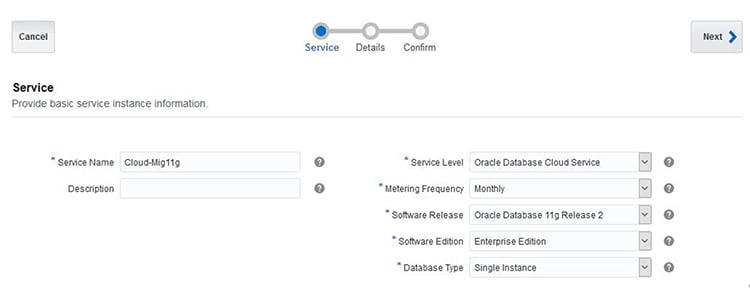

Create a New Instance of Oracle Database Cloud Service
  • Log in to your Oracle Cloud services account, go to the Oracle Database Cloud Service page, and create a new service:
    - For Service Name
     Cloud-Mig11g
    - From the Service Level list, select Oracle Database Cloud Service.
    - From the Metering Frequency list, select whatever frequency is appropriate for your environment.
    - From the Software Release list, select Oracle Database 11g Release 2.
    - From the Software Edition list, select Enterprise Edition.
    - From the Database Type list, select Single Instance
    Then click Next to continue.
Figure 1. Creating a new service (Cloud-Mig11g)

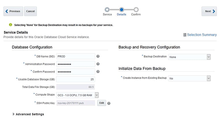

  • 2. In the Service Details screen, do the following:
    - For DB Name (SID), enter
    MIGORCL
    - Set an administrative password of your choice and confirm the password (this will be your sys password).
    - For Usable Database Storage (GB), enter 25.
    - From the Compute Shape list, select OC3 -1 OCPU, 7.5 GB RAM (this is the bare minimum required).
    - For SSH Public Key, enter
    rsa-key-20170111.pub

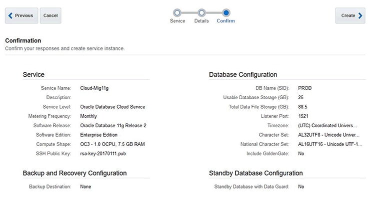

3. Finally, review the configuration and click Create to create your cloud database.
Figure 3. Creating the cloud database instance

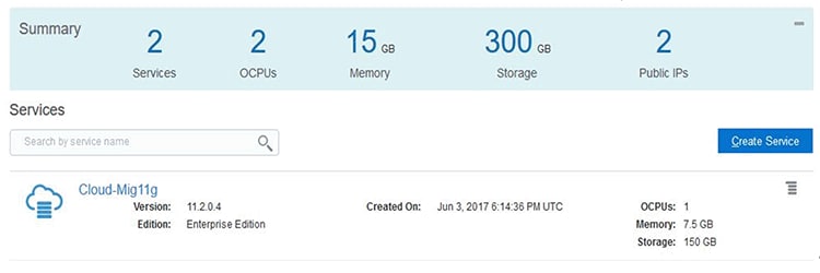

After a few minutes, the cloud database instance has been created successfully.
Figure 4. The cloud database has been created

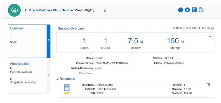

  • 4. Click the service name (Cloud-Mig11g) to open the main page of the database.
Figure 5. Main page of the cloud database

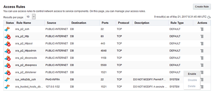

  • 5. Before trying to connect to the database instance on the cloud machine, you have to enable the dblistener access rule. Do the following:
    a. Open the database service and select Access Rules from the menu.
Figure 6. Selecting the Access Rules item
b. For the ora_p2_dblistener rule, select Enable from the Actions menu.
Figure 7. Enabling the ora_p2_dblistener rule

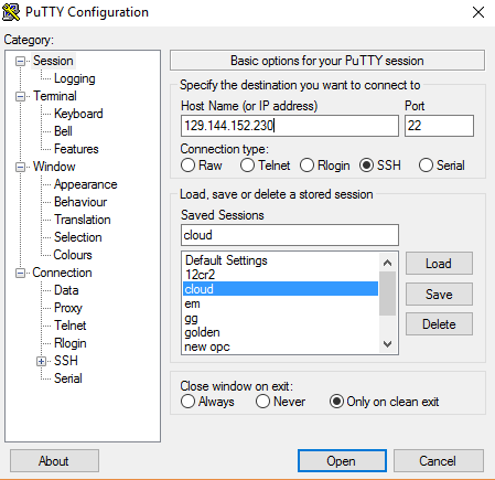

Connect to the Cloud Database, Transfer the Dump File, and Import the Data
  • 1. Open an instance of the PuTTY executable and connect to the Oracle Database Cloud Service compute node using an SSH public key.
Figure 8. Connecting to machine using PuTTY
