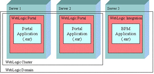

This shows a single, clustered application deployed to all three servers in the Application tier. This is the simplest way to deploy an application build on the WebLogic Platform, but there are many other possibilities. The next diagram illustrates another type of deployment:
Portal App and BPM
Figure 4. Portal application and BPM
This figure shows a portal application on two servers in a cluster and a separate application for Business Process Management (BPM) deployed to a single server. In this deployment the portal application provides high availability while the BPM application does not. Such a deployment might be appropriate if the portal application is critical and uses a non-critical BPM application.
These examples show three servers with one WebLogic instance on each. However, there could be any number of servers and one or multiple WebLogic instances per server. In fact, there is a tremendous amount of flexibility in the way that applications can be deployed on the BEA WebLogic Platform. Some deployment "rules of thumb" are:
