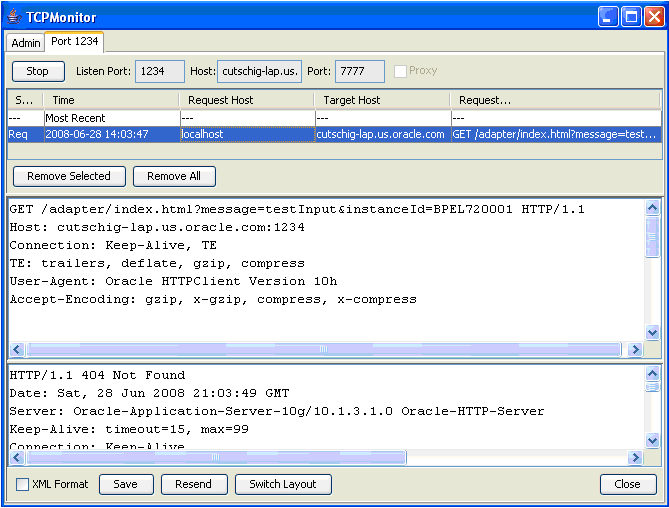

Testing the new sensor action
To test the new sensor action, we used an HTTP tunneling tool supplied directly with Oracle SOA Suite. It can be found in
$OH/bpel/bin and is named
obtunnel.
After starting, it listens on a specific port and forwards an incoming request to the dedicated provider port.
Figure 2. Testing the new http sensor publisher
