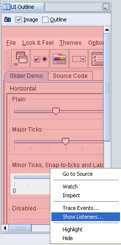

Click on the Jslider Demo icon and note how when you move the "Minor Ticks" slider there is a message showing down at the bottom of the screen with the value. How did they do that?
Minor Ticks
This is the time to get the UI Debugger into action. Without closing the running application, switch to the JDeveloper window. In the UI Outline debugger window in JDeveloper click the little camera icon to take a snapshot of your application. In the snapshot click the "Minor Ticks" slider to focus on it, you want to find out who is listening on events from this object. Right click the slider and choose "show listeners".
show listeners

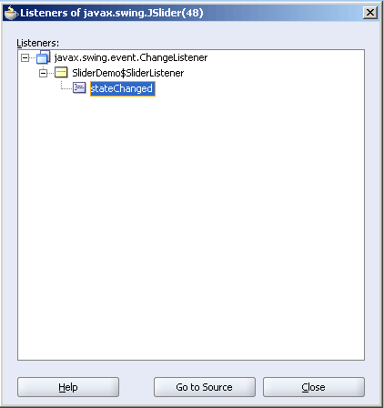

A window with the list of listeners for this object appear. You can choose the listener and click the go-to-source button that will take you directly to see the code that will be invoked.
go-to-source

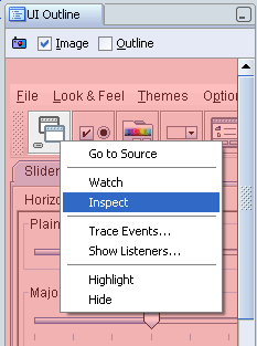

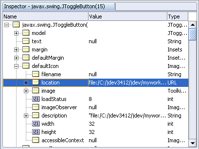

Another useful feature is the ability to inspect objects on the screen, for example lets say you want to find out the location of the icon for one of the buttons in the toolbar. Right Click one of the buttons at the top and choose "inspect".
inspect
The inspect window will appear and you'll be able to locate the value for the icon location.
icon location
